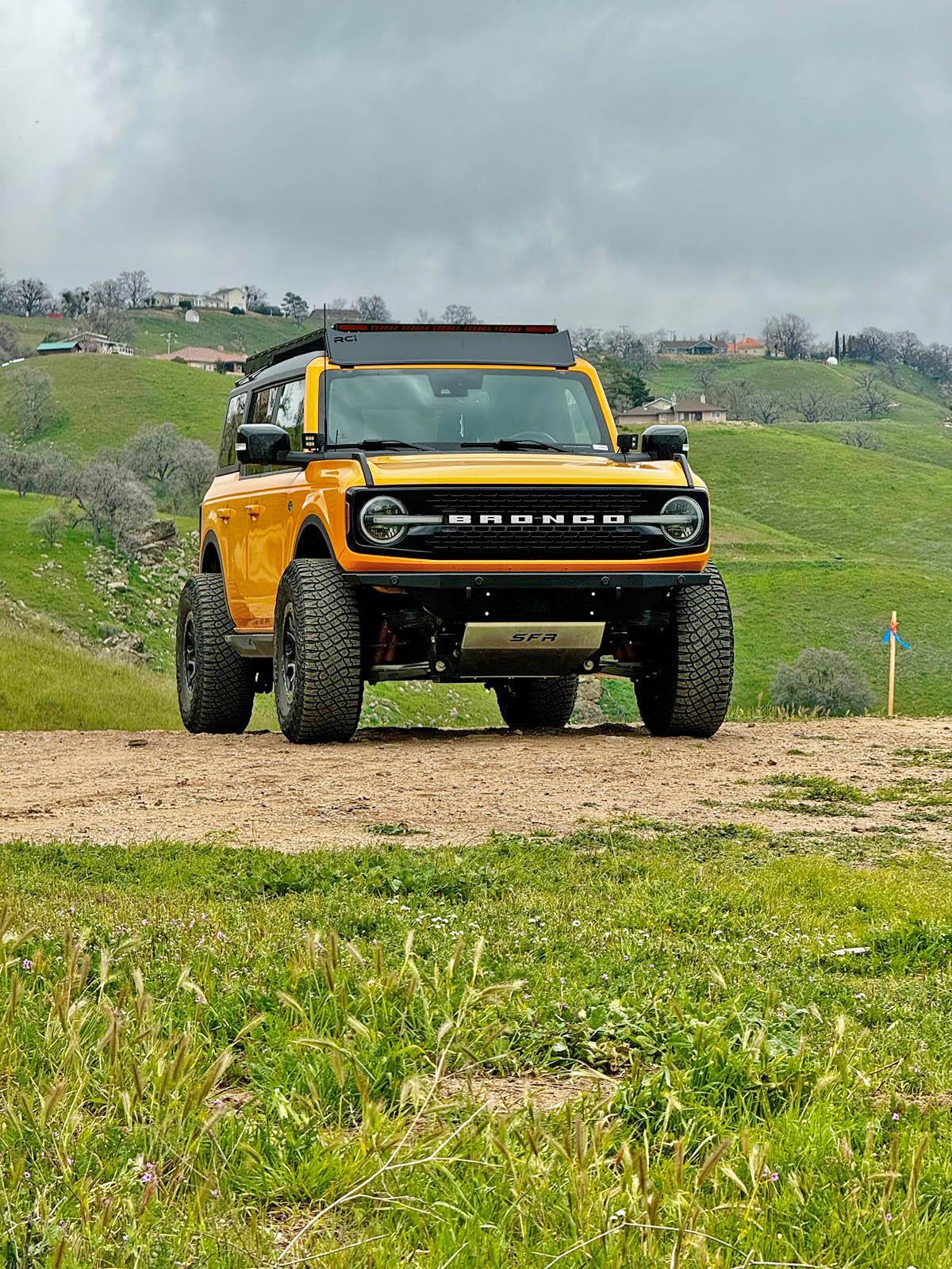

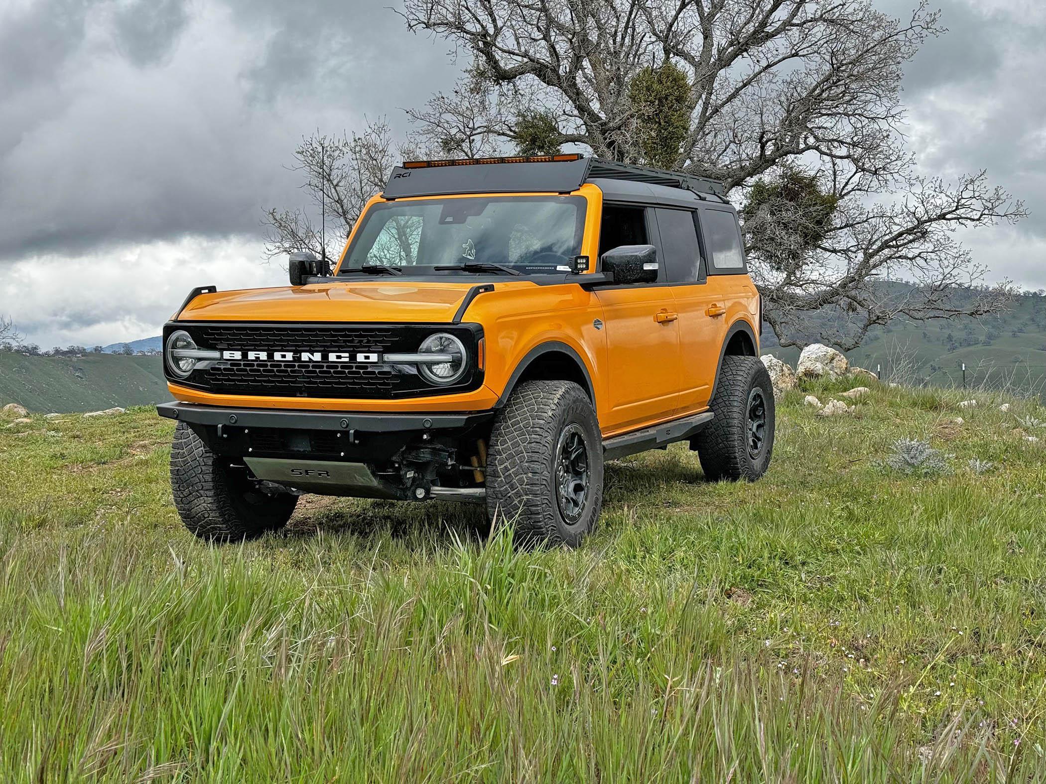

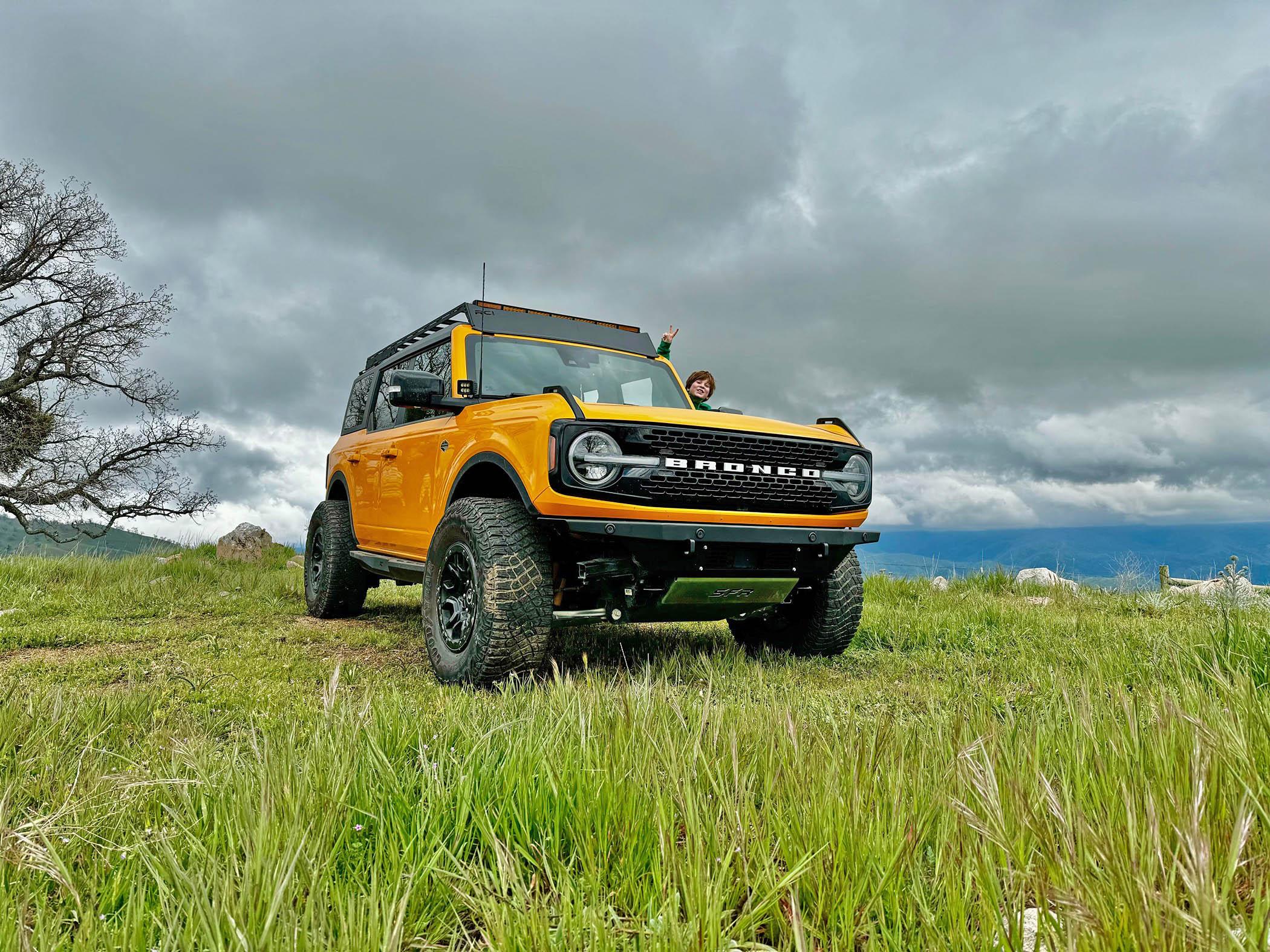

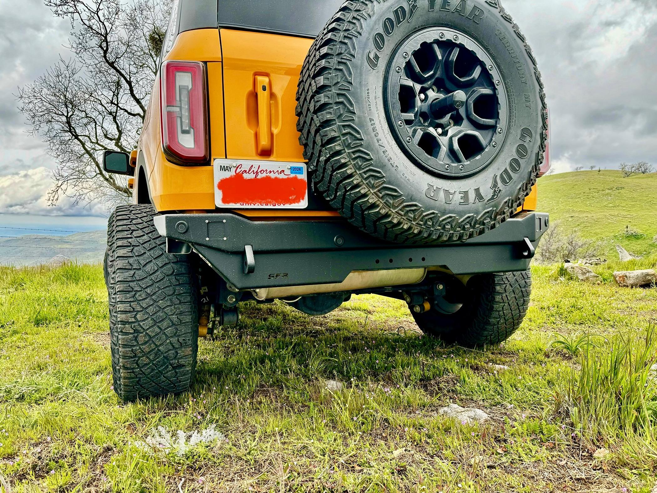

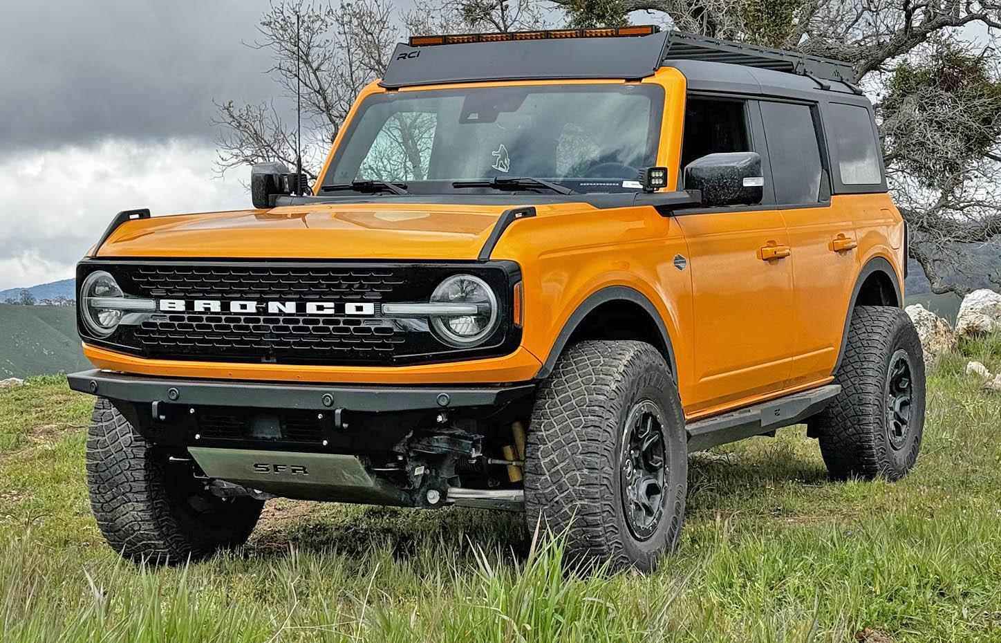

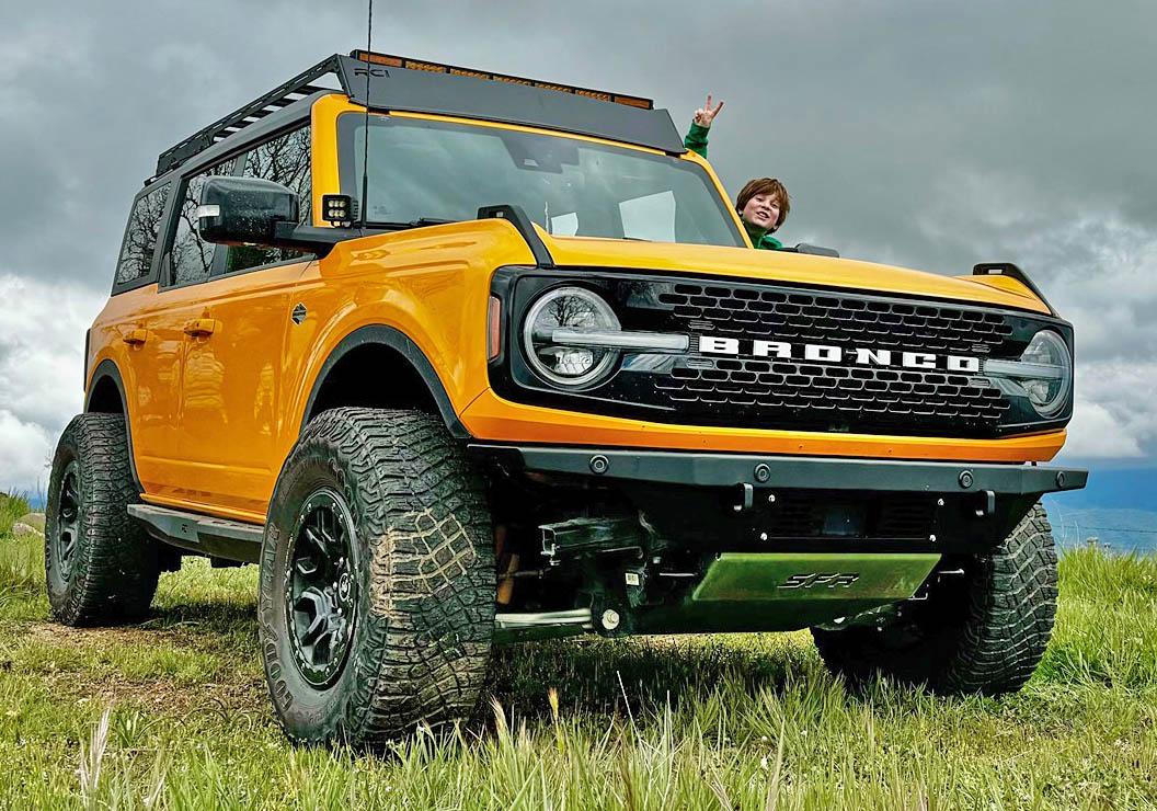

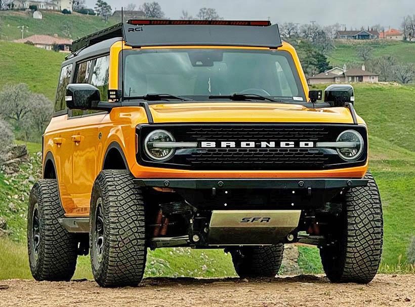

I recently installed Stinky Fab’s Sledgehammer front and rear bumpers, license plate relocation bracket, and the skid plate system. Install process was smooth and I’m happy with the quality and design. Up next is the stinky fab crash bar delete.

Nice! Really like that front end look.

Unfortunately, looks like the main skid plate and their A-arm skids leave the LCA alignment adjusters exposed. I had the same problem with the DV8 front skid and rolled the edge over on the lip of the driver side adjuster while rock crawling in Moab. Be careful or find additional shielding if you plan to do anything hard core.

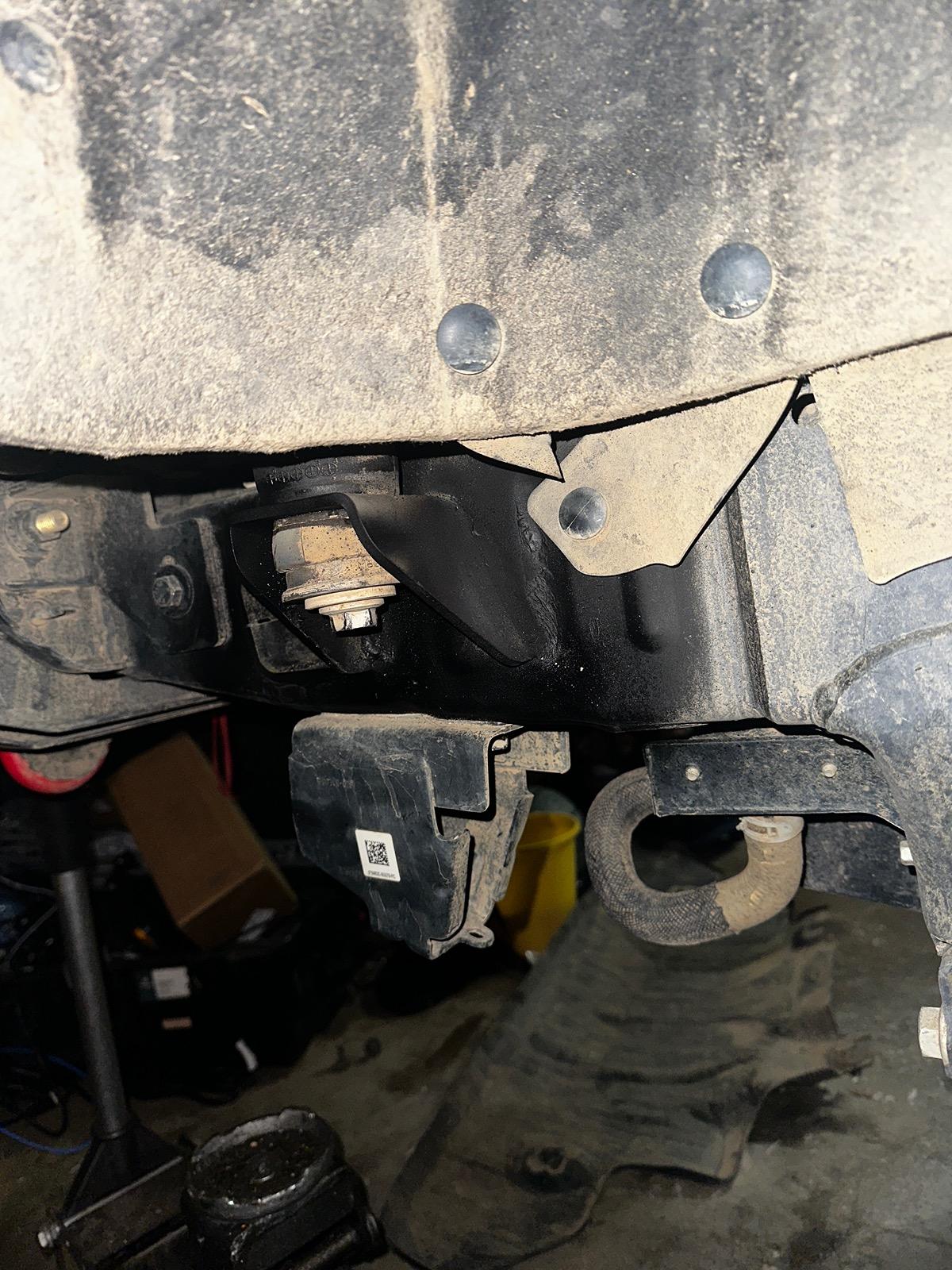

Crash bar deletes are easy enough to do. Use your sawzall from the rear of it and watch the top depth.. don’t hit your radiator.
they make a dramatic difference to the cleanliness as well as loads more tire clearance

I got the 2dr version of what you got, it seems. I've got the front bumper and rock sliders on, but it's been in service for a pinion leak I found when I took the stock plates off. It's beefy stuff.
Interesting you didn't put the A arm plates on. I've wondered whether I want to do that or not. Seeing the front skid with the lack of the tabs on either side, I wonder if I should now, since the corners look a little exposed.
How did you like putting the front bumper bolts on? I've had a heck of time getting a tool on them. I stripped them a little and need to loosen to retighten after leveling. It's been a challenge... lol
Edit: Just realized you don't have the SFR rock rails... lol
