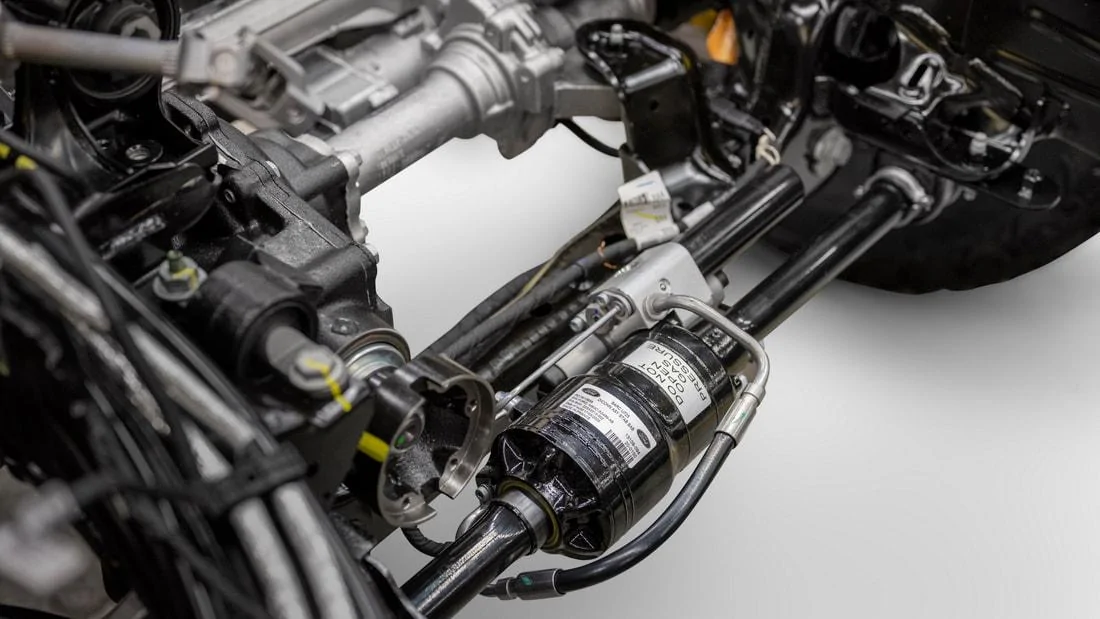

I don't find any OEM Bronco parts listed on the net yet but was wondering what the stabar disconnect would cost.
Parts are Parts, parts are not integration...
(and please don't be like the lazy car salesmen that did not know it was called a Stabilizer Bar Disconnect and call it a stabar, it is not to late to change the title of this thread, please.)

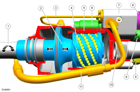

Bronco Stabilizer Bar Disconnect Operational & Service Information
Ford Bronco Stabar disconnect price 1624444311726-png
BWI Bronco Stabilizer Bar Disconnect Technical Information
Ford Bronco Stabar disconnect price bwi-bronco-front-stabilizer-bar-disconnect-jpg
I'll bet the factory stabar will never be able to be added later. It's hydraulically operated, so needs plenty of hoses and fittings and the electrical harness and control ECM. I really want it, but I also want the $6k difference in price from Basesquatch to do other things with. We'll see. Have to see how much money I have by the time the Bronco actually gets built and just do the SAS BL. :)
Bingo, with a caveat, some have pointed out they may try it and just use a manual switch to trigger power to the unit, however......... if it is a PCM, Can bus, or the like, that will not work, but I look forward to someone digging in to see what is possible.

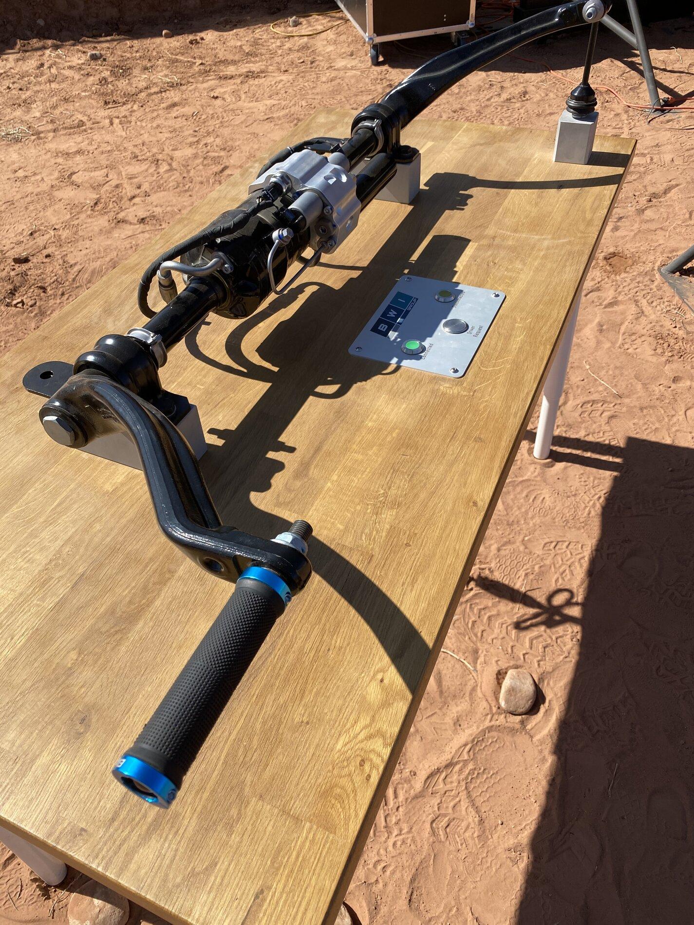

Well, it is ECM and can bus, all vehicles are. However, maybe it can be operated by a simple switch if not tied into all the other factory stuff. Is the hydraulic system totally separate from anything else on the car? Looks like it in that pic. Has it's own electric motor hydraulic pump? Hmmm....
We still have much to learn. I'm REALLY looking forward to Off Roadeo in a few weeks. Lots of questions for me will get answered driving those things and crawling all around vehicles that will have been used for awhile. Also curious how stable and capable they are with the sway bar connected.
One thing we'll need to learn is how does it handle without the sway bar at all. When there are two lockers, stability is the issue and not traction. The IFS inherently has more stability than a straight axle, resulting in somewhat less articulation, but also resulting in less sway when the sway bar is disconnected. What would it drive like with no sway bar? I had a conversation with someone very knowledgeable in the industry, and he said we could easily remove the Bronco sway bar at home, tow it to Moab, and wheel all week and it will handle fine. Put the whole sway bar back on when we get home for daily driving. It's six easy to get to bolts, only minutes with cordless driver. Back to Basesquatch............?
Correct, it is a self containd unit, aside from a few wires to interface to the Badlands.

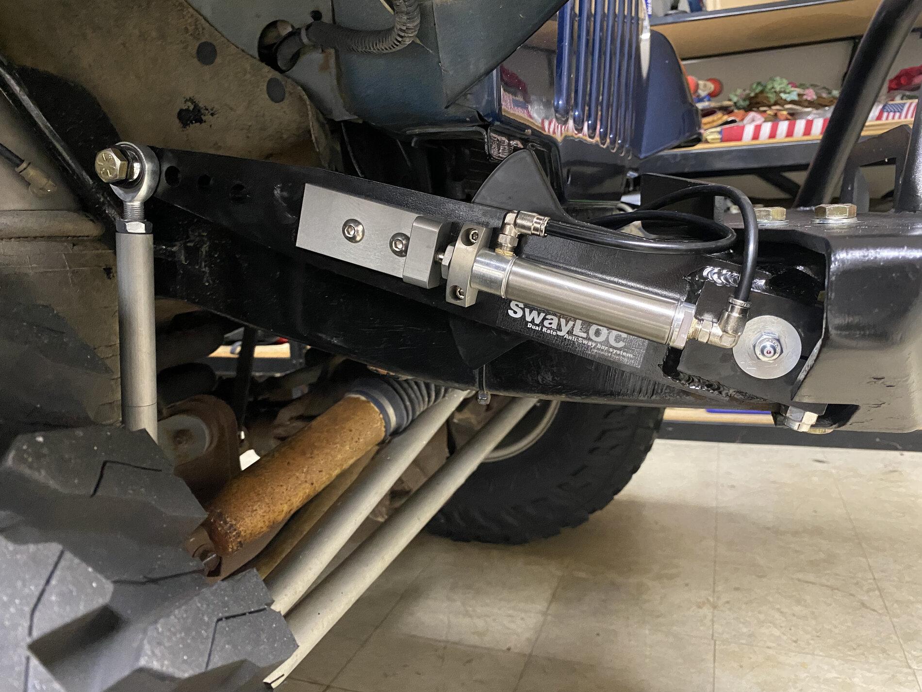

I just installed this on my Jeep
Ford Bronco Stabar disconnect price IMG_5031
It's Air Activated
Hopefully you can see the Movies as they are MOV format.
On the back side, the spade shaped arm has a notch that the piston fits into when it is off to keep the left and right side connected. When you turn it on, it moves the piston out and allows the arms to twist independently just like the hydraulic one on the bronco.
Maybe someone will be able to come up with a solution like this for the Bronco.
