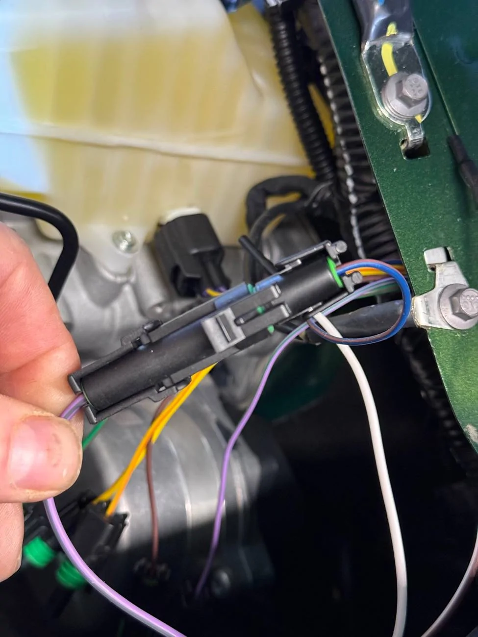

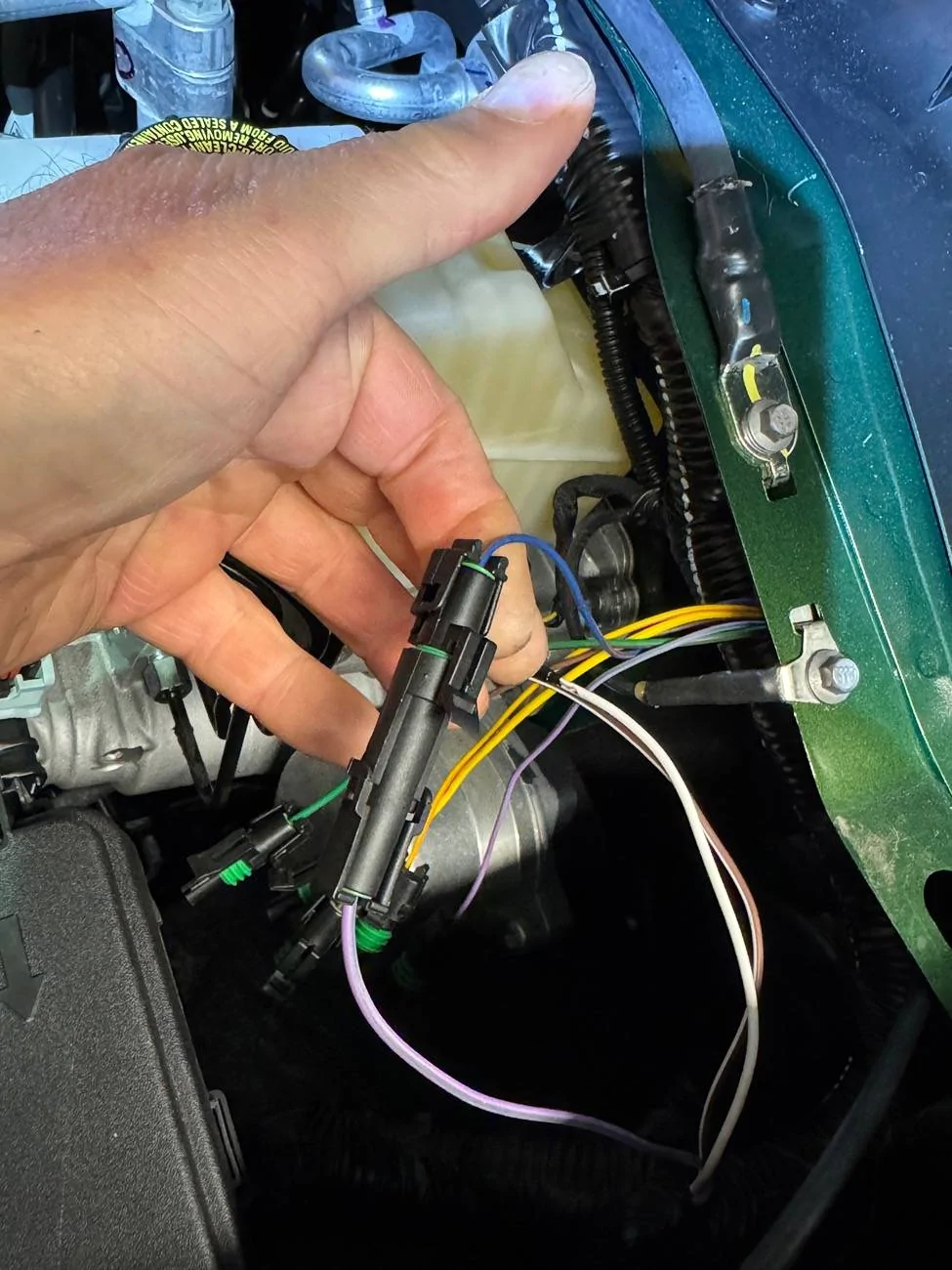

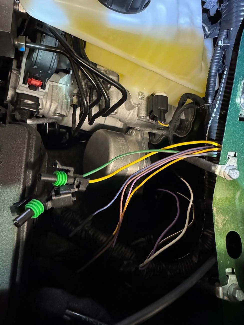

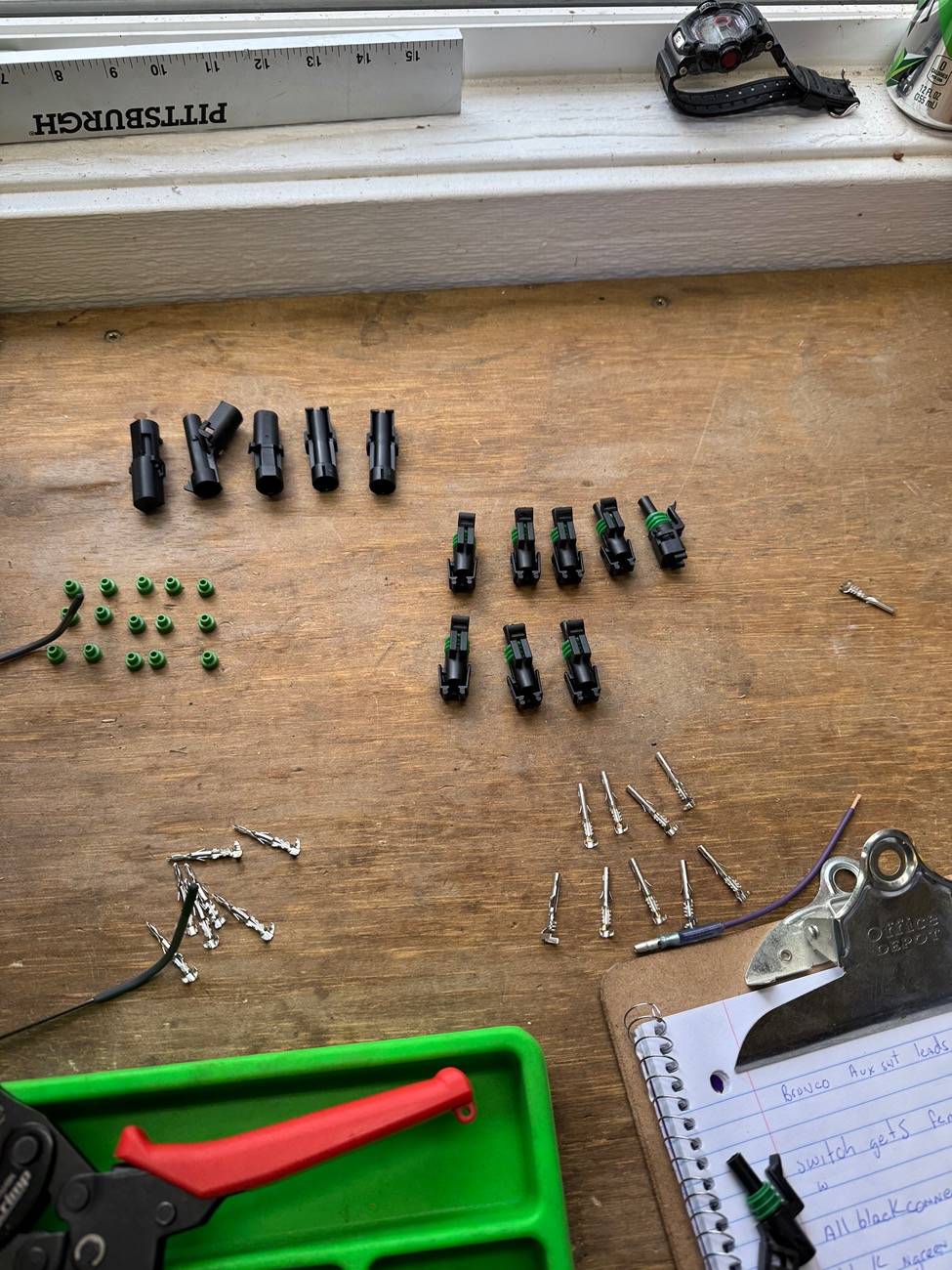

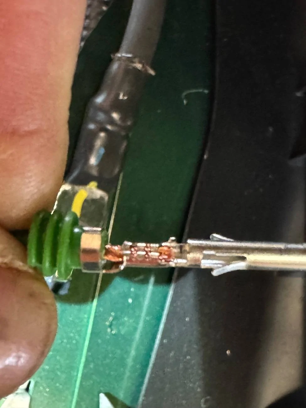

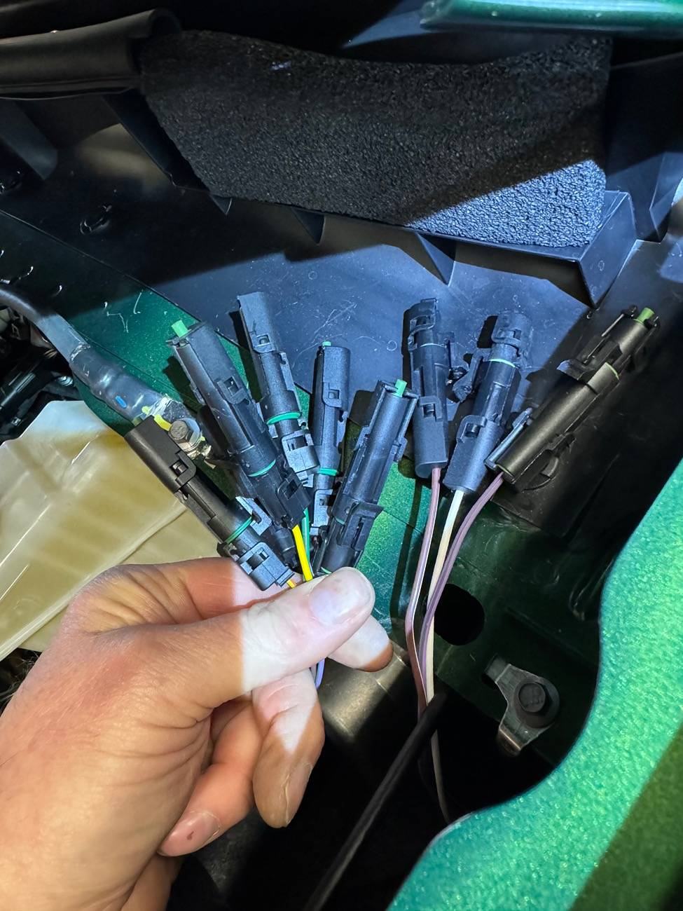

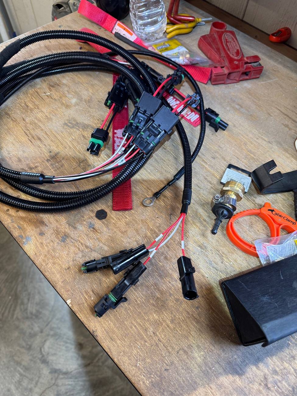

I can’t say enough good things about John Trischler at Specialty Performance Parts @SPVPARTS. Super knowledgable and helped me design harnesses for my 24 Bronco Wildtrak Aux stuff.
Some background I did 25 years in hybrid fiber coax and cell tower wiring and have always been OCD about wiring. Automotive wiring lives in a harsh, abusive environment. Extreme heat and cold, chemicals, corrosion and constant vibration are a recipe for disaster if you don’t take precautions. The wiring kits that come with most lights, EVEN THE NAME BRANDS is marginal AT BEST. I urge you to poke around his youtube channel SPV Performance parts look at his videos where he tests the harnesses of various lights with heat and open flame vs his harnesses. The results are eye opening. Inferior wiring is a quick way to burn a vehicle to the ground.
The beauty of his wiring kits is total plug n play. Change configurations, light brands etc is a simple easy adapter lets you change things without cutting wires.
Bronco connector kit
Ford Bronco SPV HARNESSES AND CONNECTORS - DO IT! IMG_1376
Ford Bronco SPV HARNESSES AND CONNECTORS - DO IT! IMG_1380
Ford Bronco SPV HARNESSES AND CONNECTORS - DO IT! IMG_1379
Ford Bronco SPV HARNESSES AND CONNECTORS - DO IT! IMG_1383
Ford Bronco SPV HARNESSES AND CONNECTORS - DO IT! IMG_1382
Ford Bronco SPV HARNESSES AND CONNECTORS - DO IT! IMG_1378
Ford Bronco SPV HARNESSES AND CONNECTORS - DO IT! IMG_1377
Ford Bronco SPV HARNESSES AND CONNECTORS - DO IT! IMG_1385
