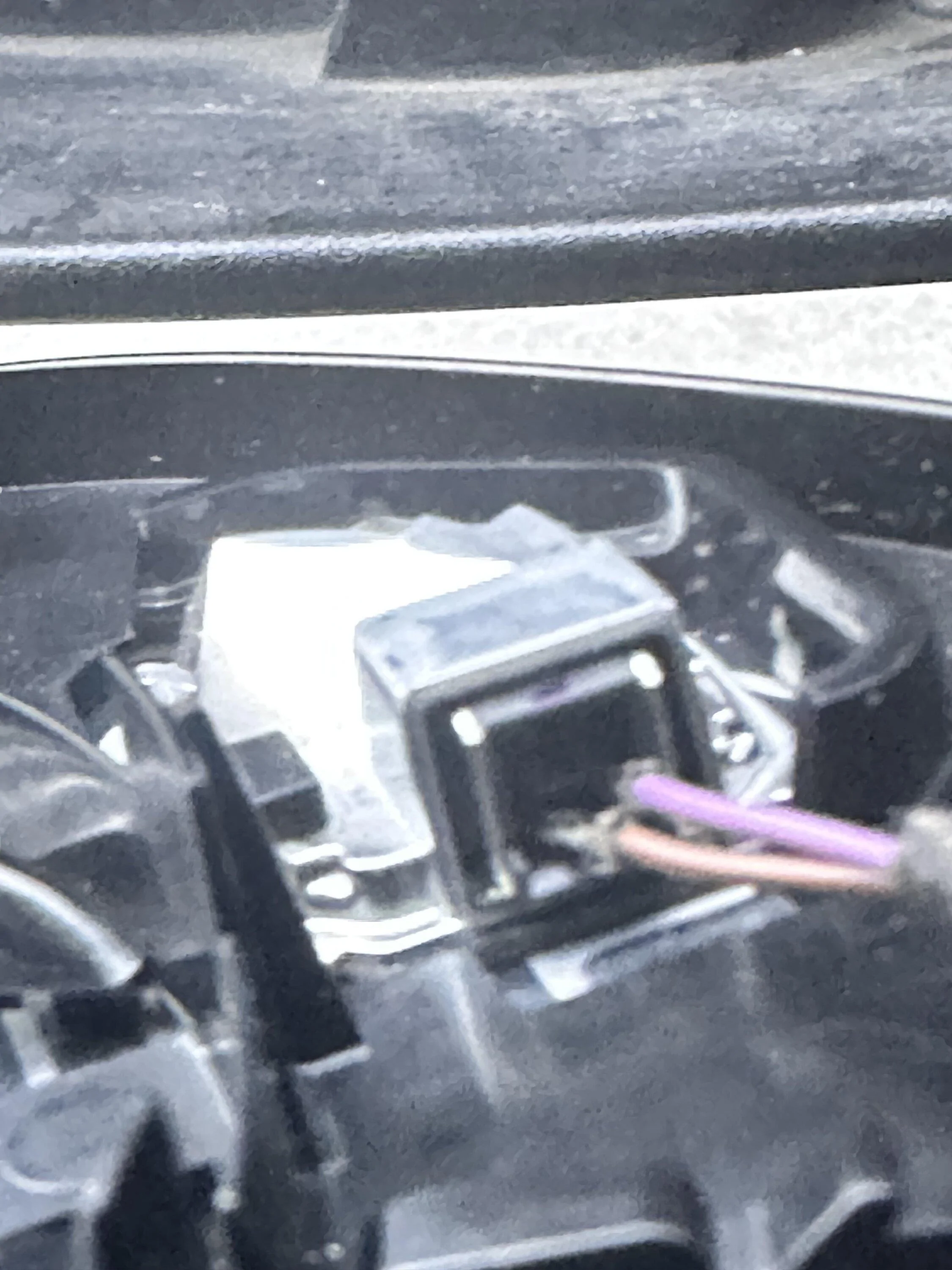

Hello!!

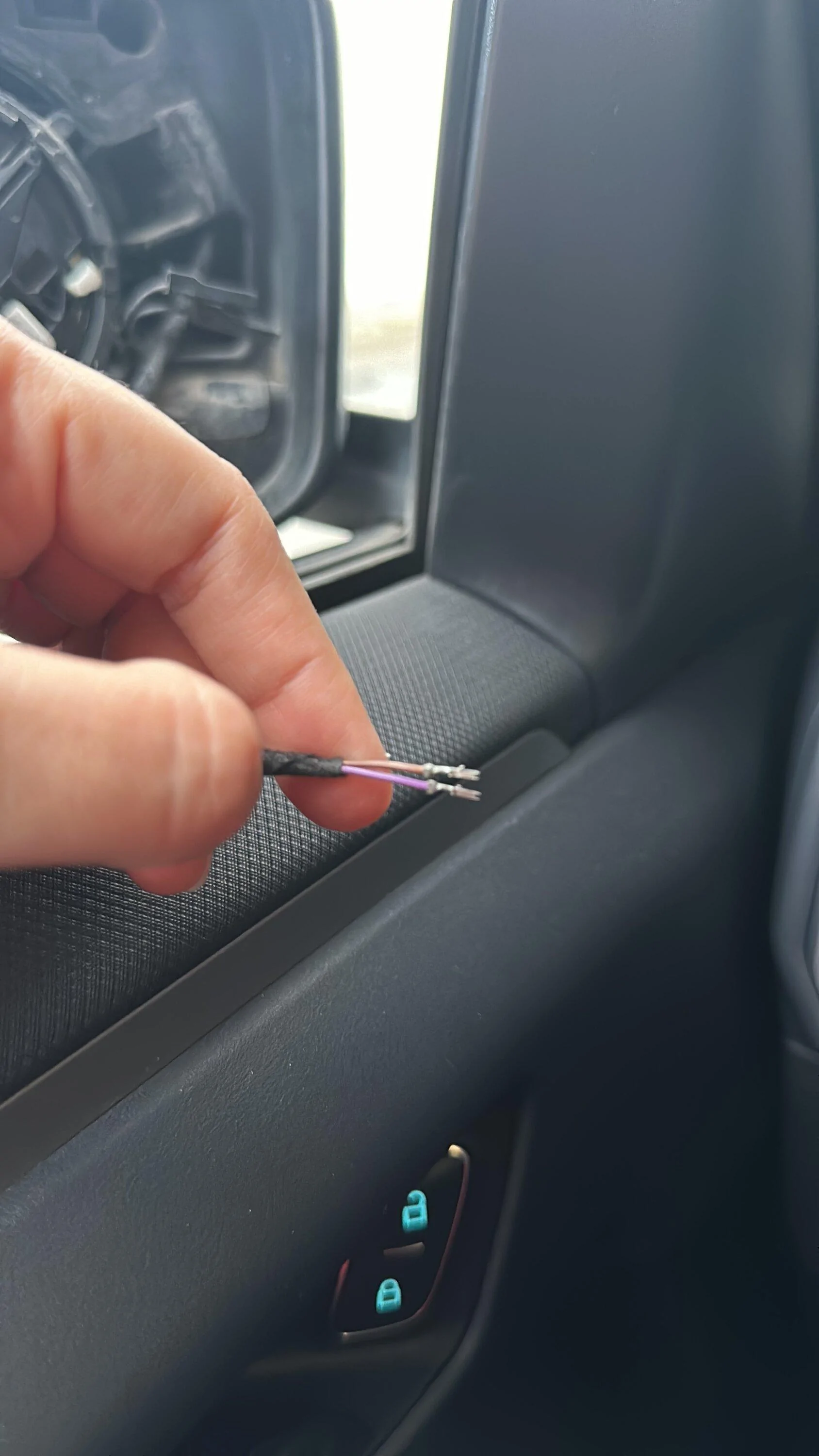

I have the same problem I need the connector/harness I try to make one by my self but at the end I can’t get the wires stay in place. Have someone found something?

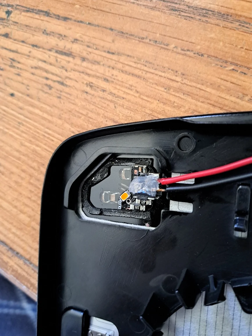

I didn't look at mine that hard when swapping to SUMA, but couldn't you just unalive the mirror connector and pigtail end, solder the wires on directly, and add a small QD connection inline?

Same issue with my blind spot light connector but screwed up mine switching to the Suma mirrors. I guess I’ll just splice directly the wires. On Bronco wires are green/purple and on Suma I think they are red/white. Would it matter which wire color pairs with which?
Tenetke
Oct 11, 2022
2022 Lightning Platinum
https://a.co/d/bDh1bPP
I just used a quick connector since the wires just came out after disconnecting it from the mirror. I just matched them up from the other mirror and it works fine now.

Hello!!
SAME!! wire pulled OUT of the clip like you show, i have the clip but wire wont stay in, did you ever solve this

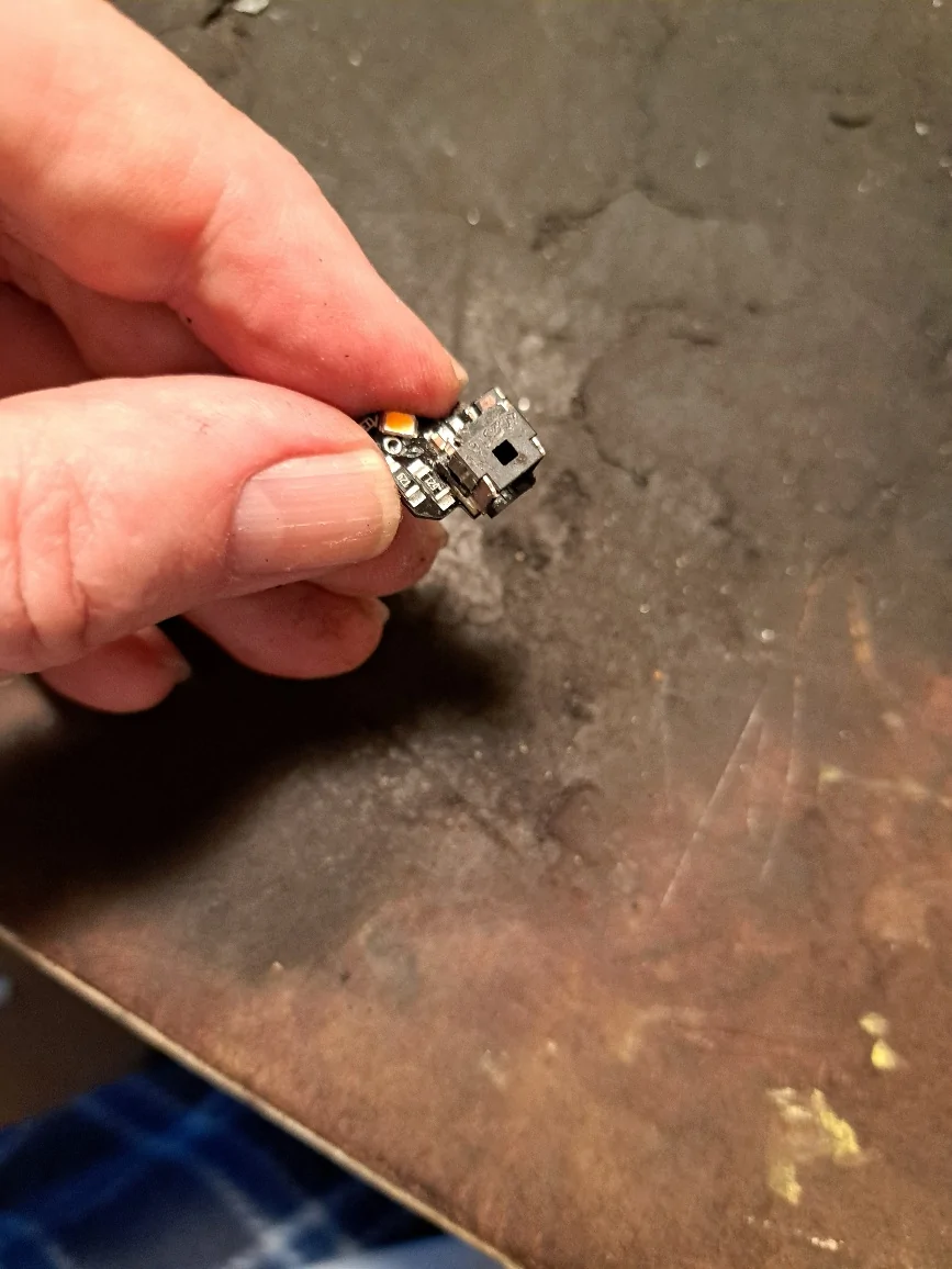

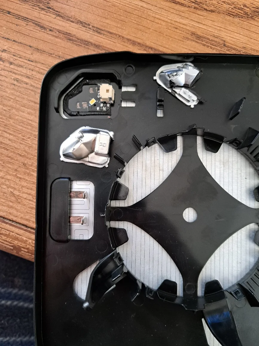

I know this is an old thread, but thought for history my experience might help someone one day. My mirror glass broke when the mirror was impacted. Bought a replacement glass on Amazon for $15. Used the old broken mirror to see how the wiring was to the circuit. The silvery piece is just a plastic reflector that can be easily removed (glued on) by heating it with a hair dryer. See one pic. Then the female connector on the board is exposed. Someone with fine micro soldering skills could then solder two wires to the board, but I used a Dremel tool to carefully grind thru the plastic connector to get more exposure to the 2 pins that wires need to be attached to. Then soldered small gauge wires, covered with silicone and replace the silvery reflector. Attach the new wires directly to the original purple and green mirror wires. I'm glad I had a broken mirror to work on first to see how to approach it. $15 instead of silly $1500 if Ford will only sell the whole mirror. If that was it, I'd do without blind spot light!
PS. The circuit board can also be removed with a hair dryer after the reflector and replaced by heating them in place when done. The orange led in the circuit is the light that shines thru the glass of the mirror when reflected by the silvery plastic cover piece.

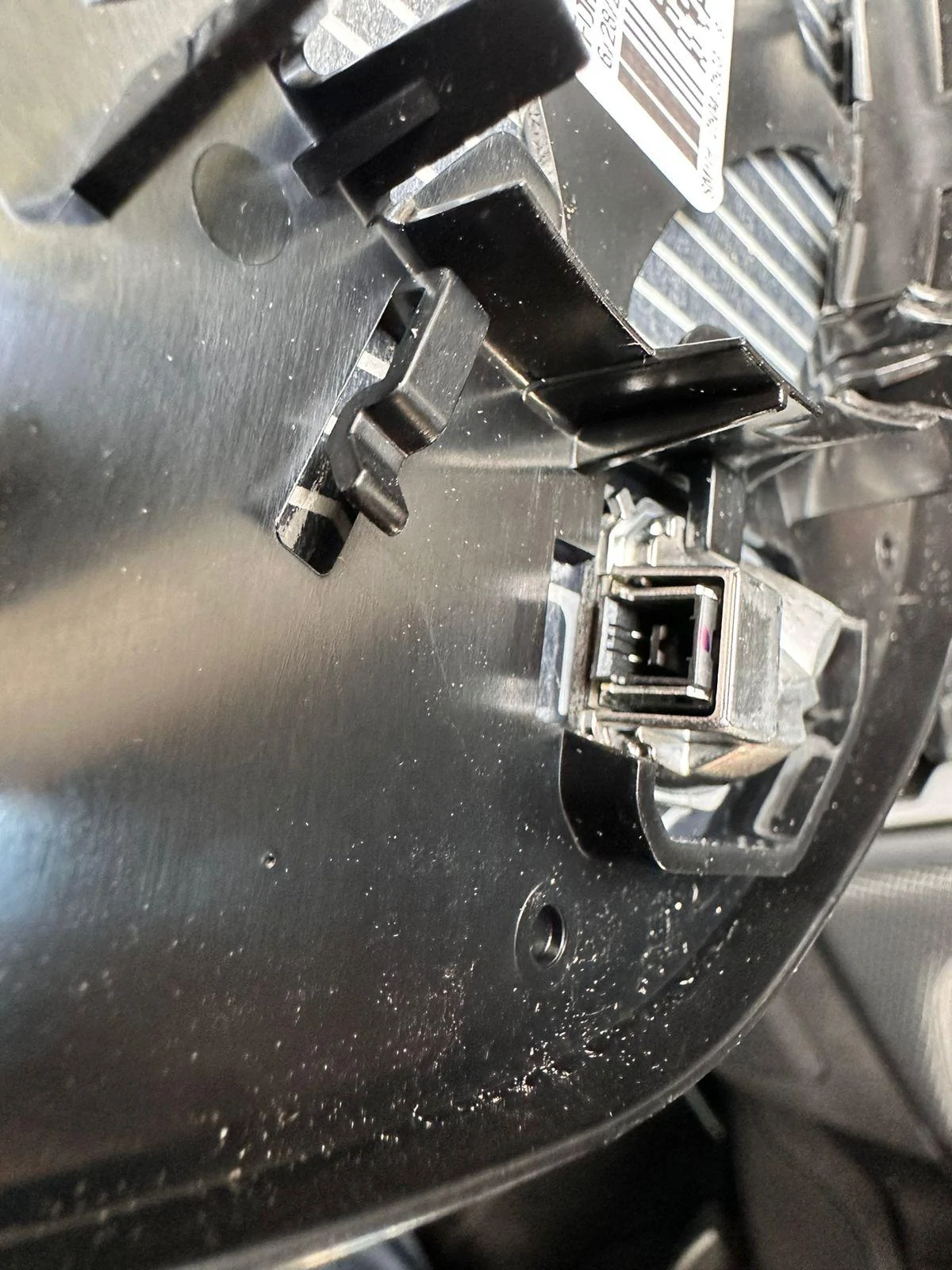

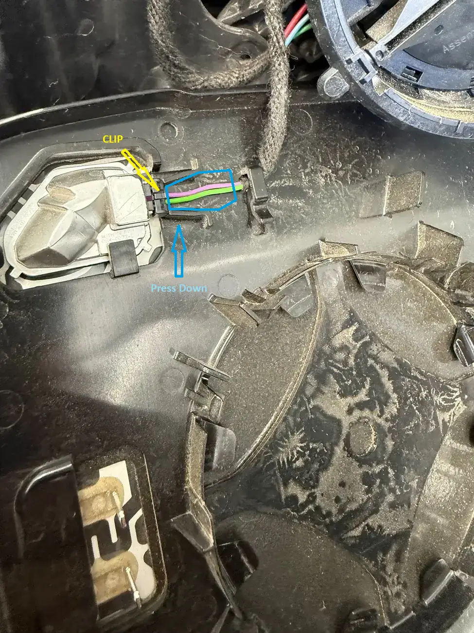

I wanted to share this on the pre-2025 redo for that clip.
The locking mechanism is not only the side slats its also the bottom flap between them.
The best way I found to remove the plug is:
  • Hold a flat head screwdriver horizontally and slide it up to the connector underneath the wires and in between the two "guide" slats.
  • Then press the tip of the screw driver down to get the plastic flap holding the bottom of the plug out of the way.
  • Next press down on the plug clip that is on top of the plug dead center.
  • Then easily and gently slide the plug out.
