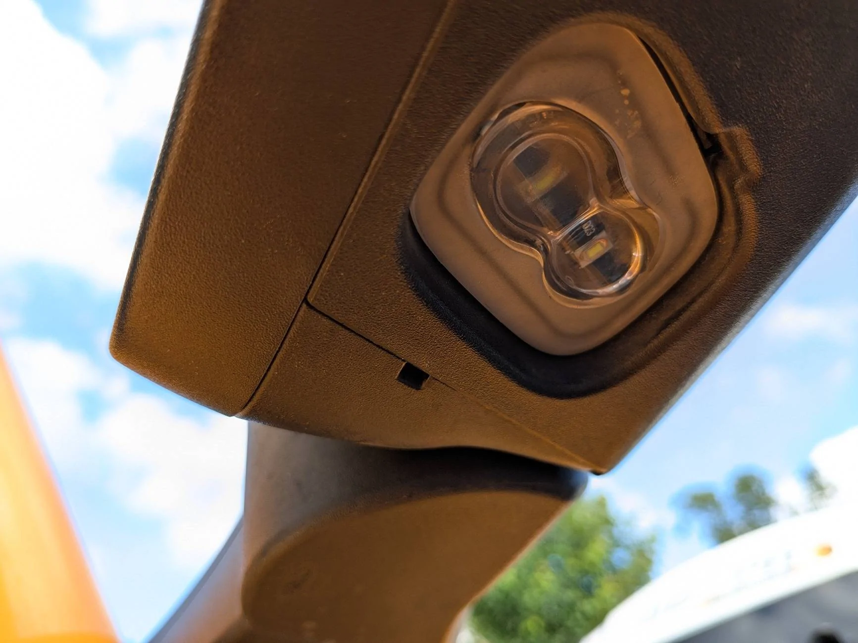

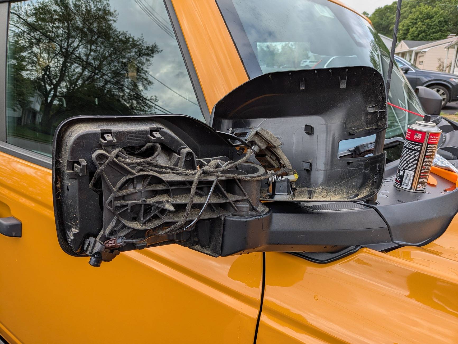

Take a trim removal tool, fit it into the notch under the outside mirror housing, and work your way around until the whole piece comes loose.
Ford Bronco Sporadic 360* camera blackouts possibly fixed PXL_20250607_212937262

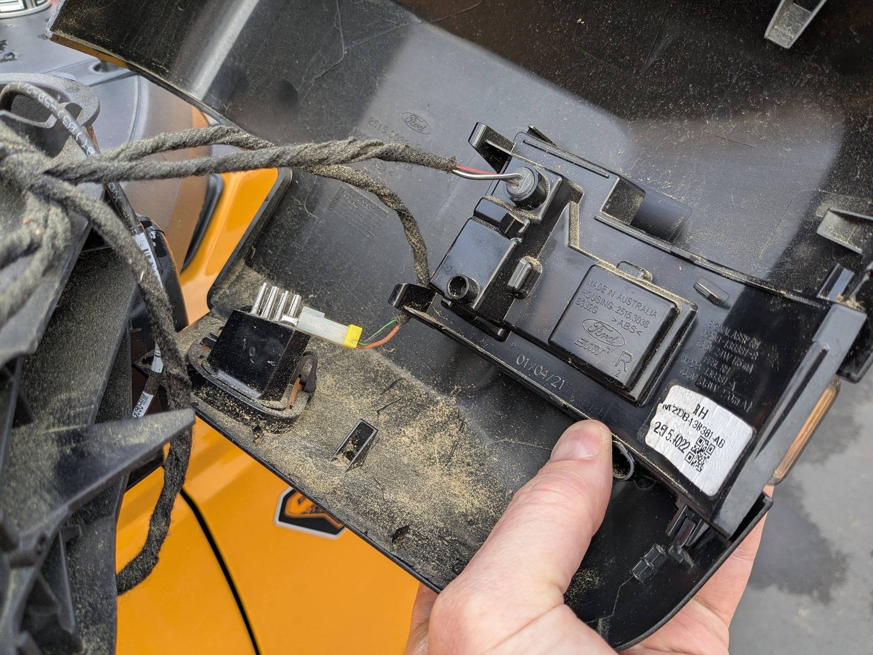

It was a dusty mess in there but I gained access to everything I needed.
Ford Bronco Sporadic 360* camera blackouts possibly fixed PXL_20250607_204818495

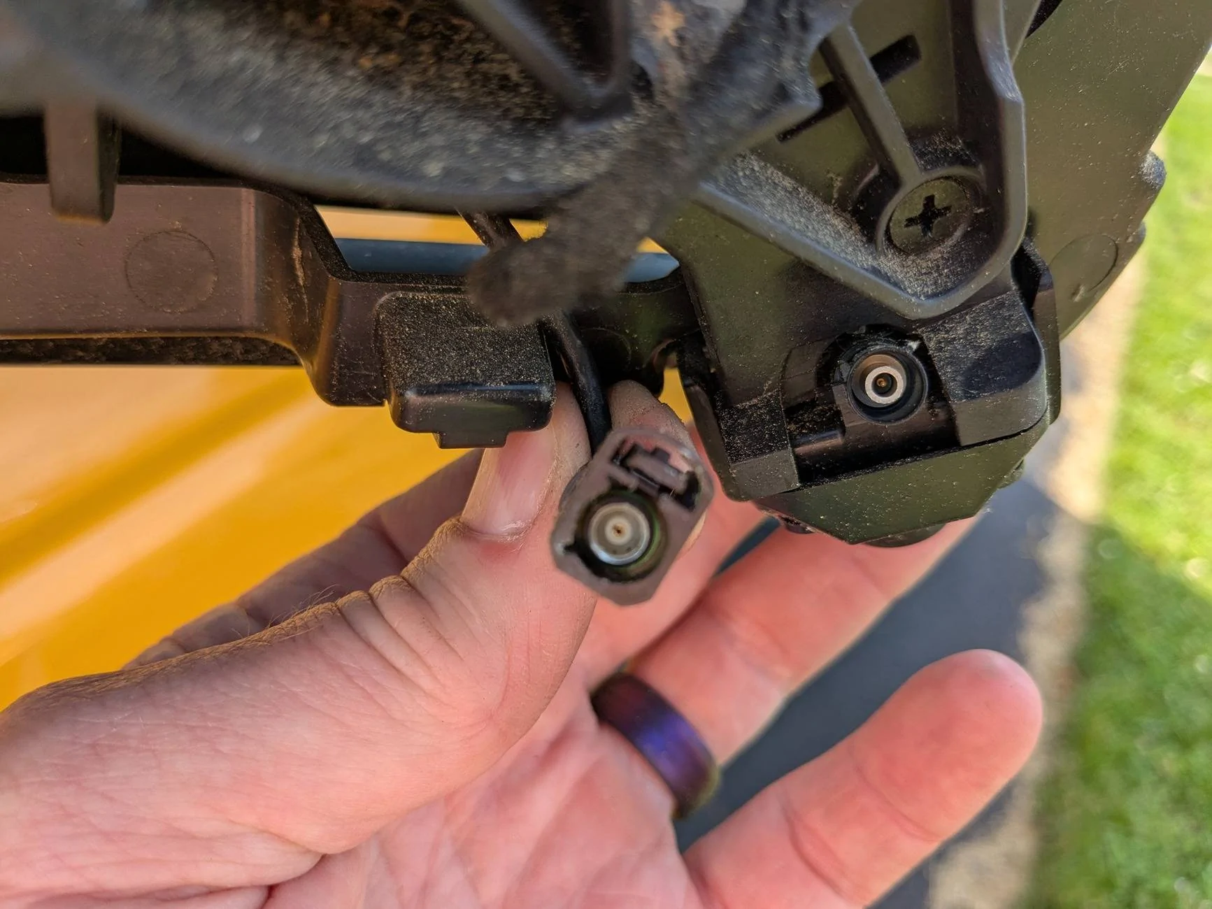

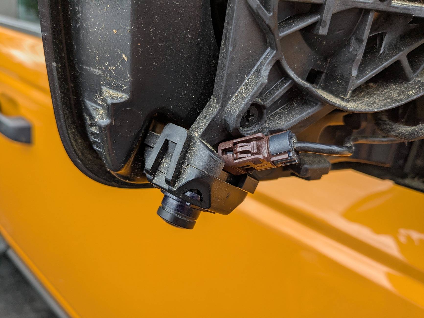

This is the connector I was after:
Ford Bronco Sporadic 360* camera blackouts possibly fixed PXL_20250607_204815110
Side note: if your turn signal separates from the mirror housing, it reattaches first from the outer edge under the little tabs and then snaps into place.
Ford Bronco Sporadic 360* camera blackouts possibly fixed PXL_20250607_205349420

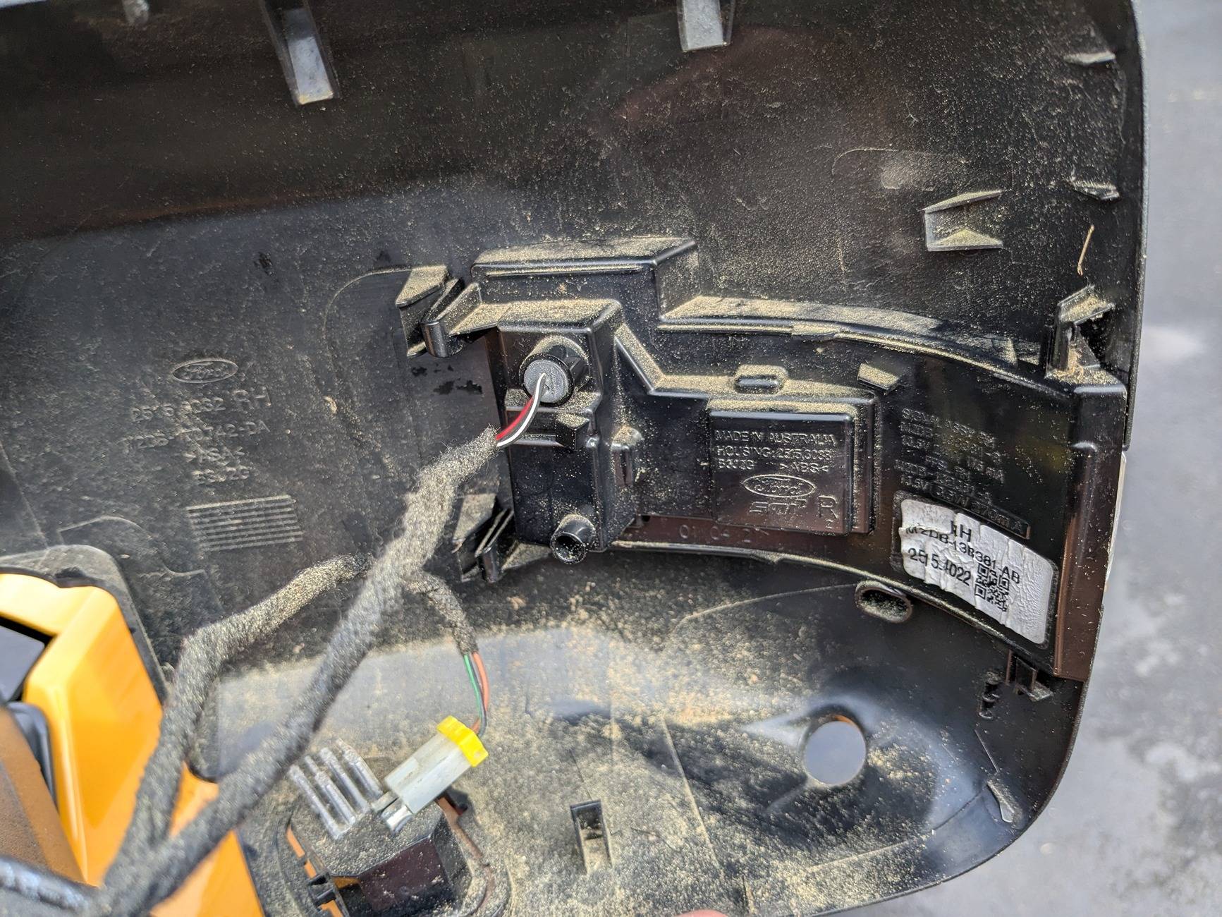

The following pics are from the other side of the vehicle. View of the connection itself:
Ford Bronco Sporadic 360* camera blackouts possibly fixed PXL_20250607_205948274

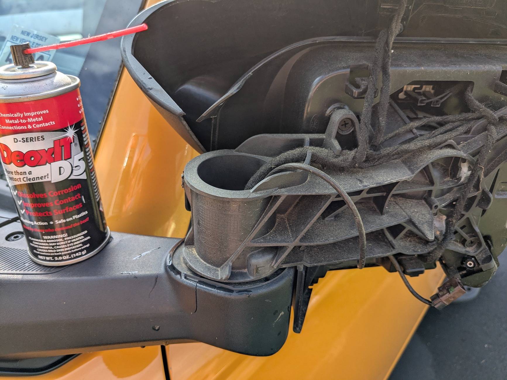

Sprayed with DeoxIT to ensure the contact points were all clean.
Ford Bronco Sporadic 360* camera blackouts possibly fixed PXL_20250607_210017831

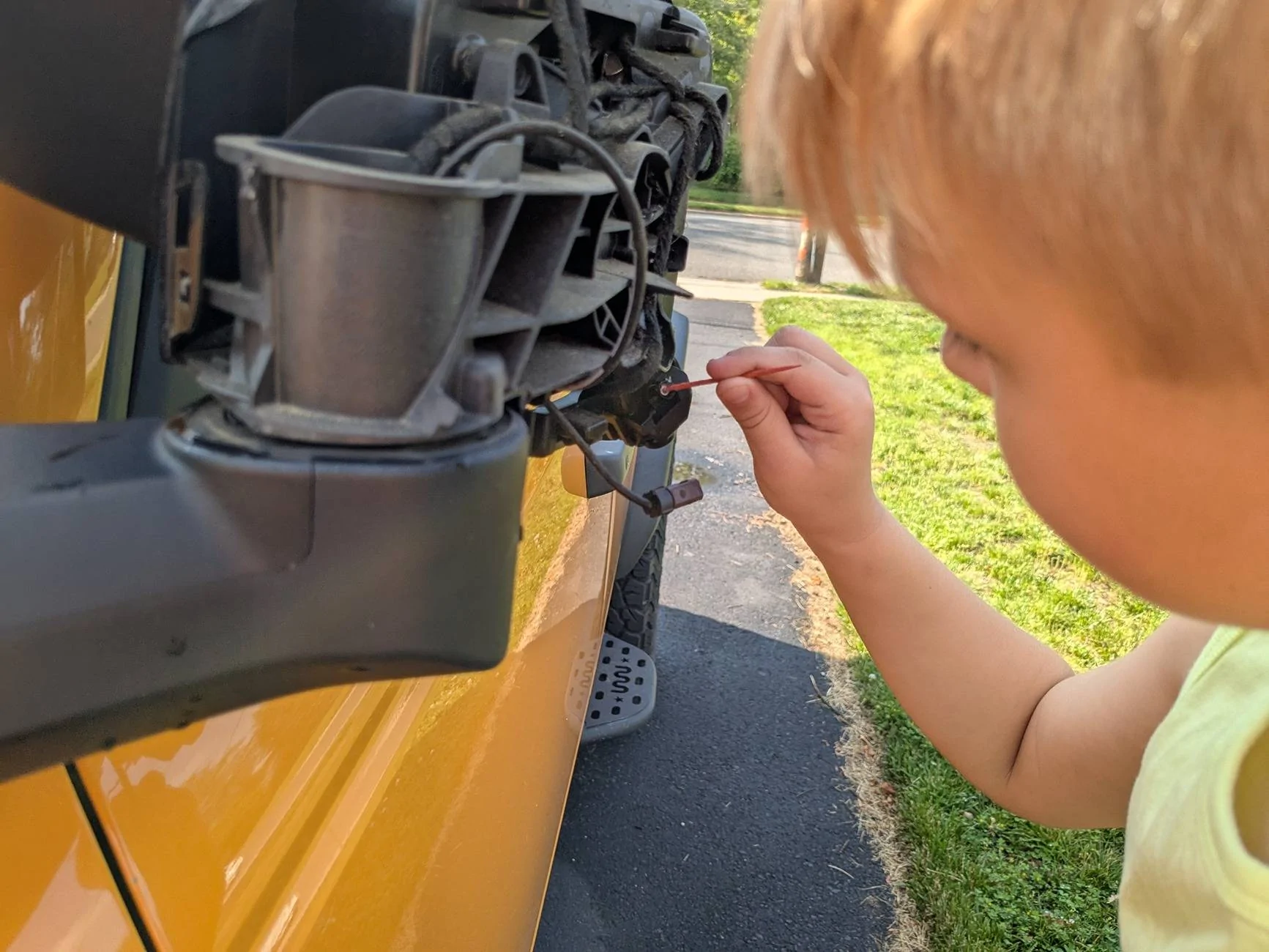

Using a toothpick, smear a little dielectric grease into the connector. I had small hands help me out.
Ford Bronco Sporadic 360* camera blackouts possibly fixed PXL_20250607_210216713

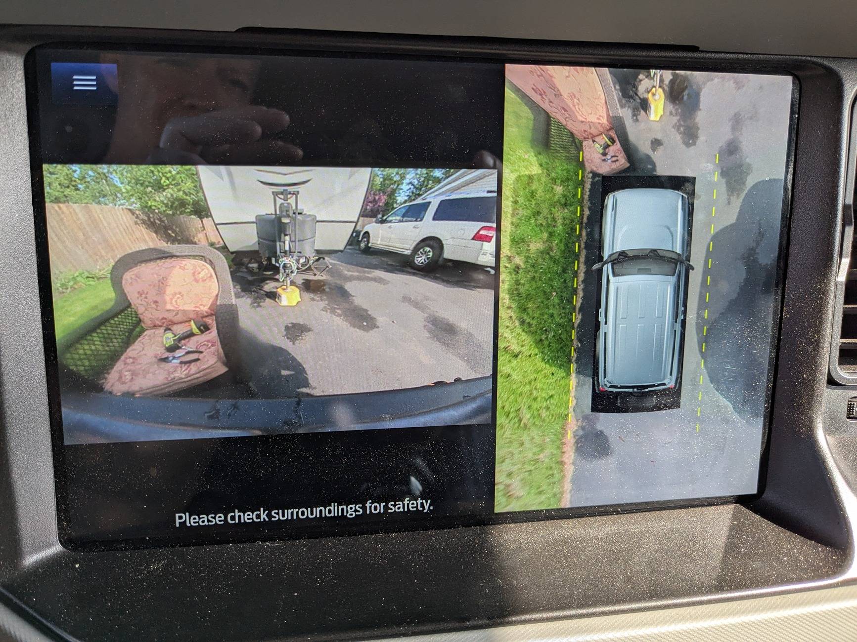

Reconnect and test your display before reassembling the mirror housing. If it's working, reassemble and move onto the next.

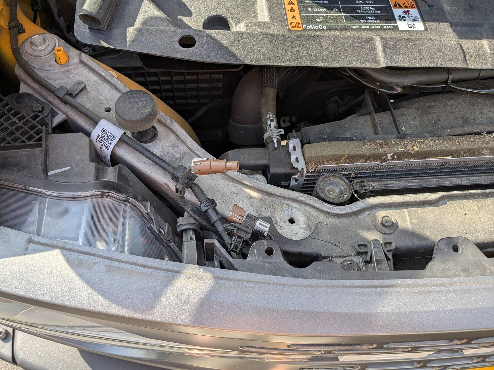

The connector for the front camera is hidden under the plastic trim piece above the radiator.
Ford Bronco Sporadic 360* camera blackouts possibly fixed PXL_20250607_212319049
Ford Bronco Sporadic 360* camera blackouts possibly fixed PXL_20250607_212119658
Follow the same process, reconnect, test, and put stuff back where it came from.
Results at this point are solid. We'll see how it holds up over time.
Ford Bronco Sporadic 360* camera blackouts possibly fixed PXL_20250607_212705528
Ford Bronco Sporadic 360* camera blackouts possibly fixed PXL_20250607_212719095

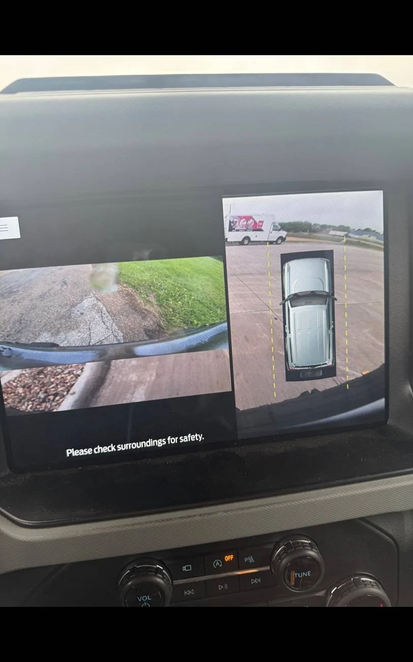

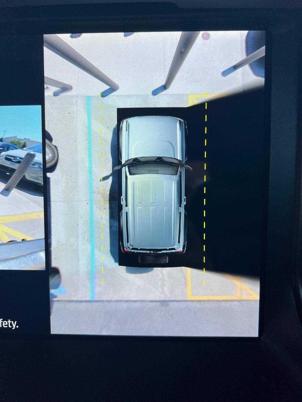

I got this the other day when I got back to my house.
The 360 view showed me going vertical in the gas station parking lot. The other view showed grass and road.
I was parked in my garage at the time. Lol
Hasn't done it since
Looks like IPMA or APIM had a full blown freak out argument about who's turn it was to make the pics.
