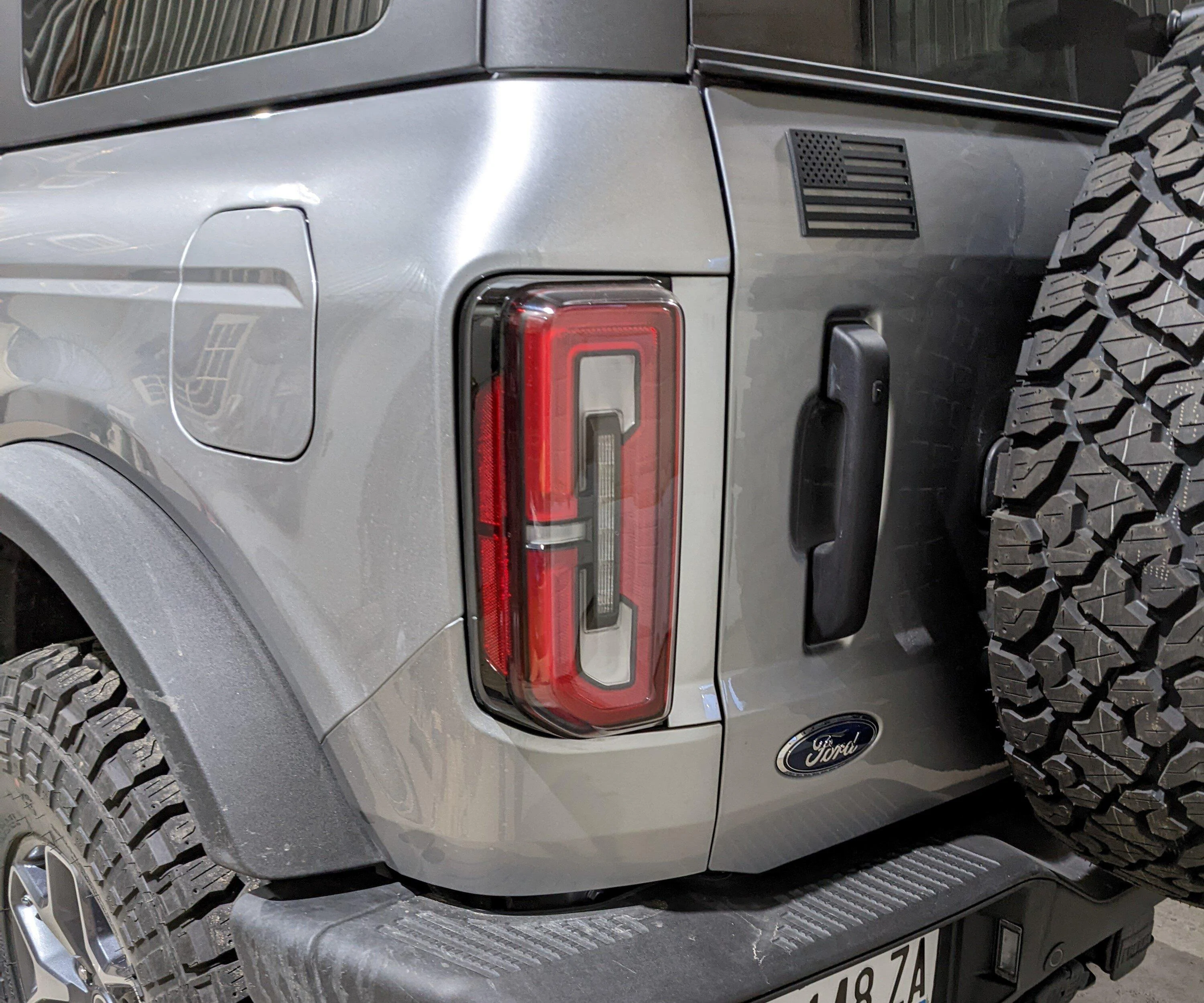

No splotchy spots here, just three different shades of silver...

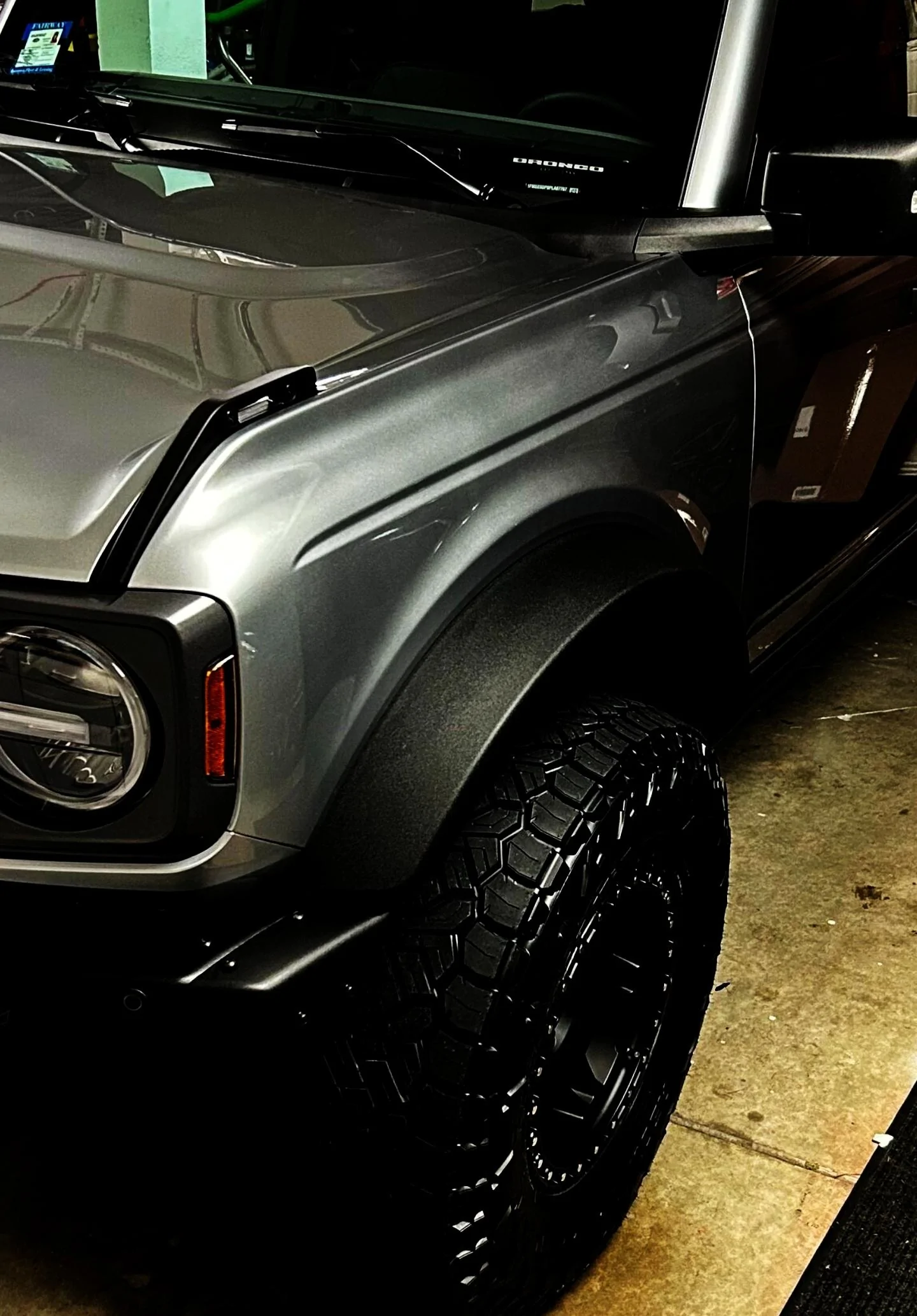

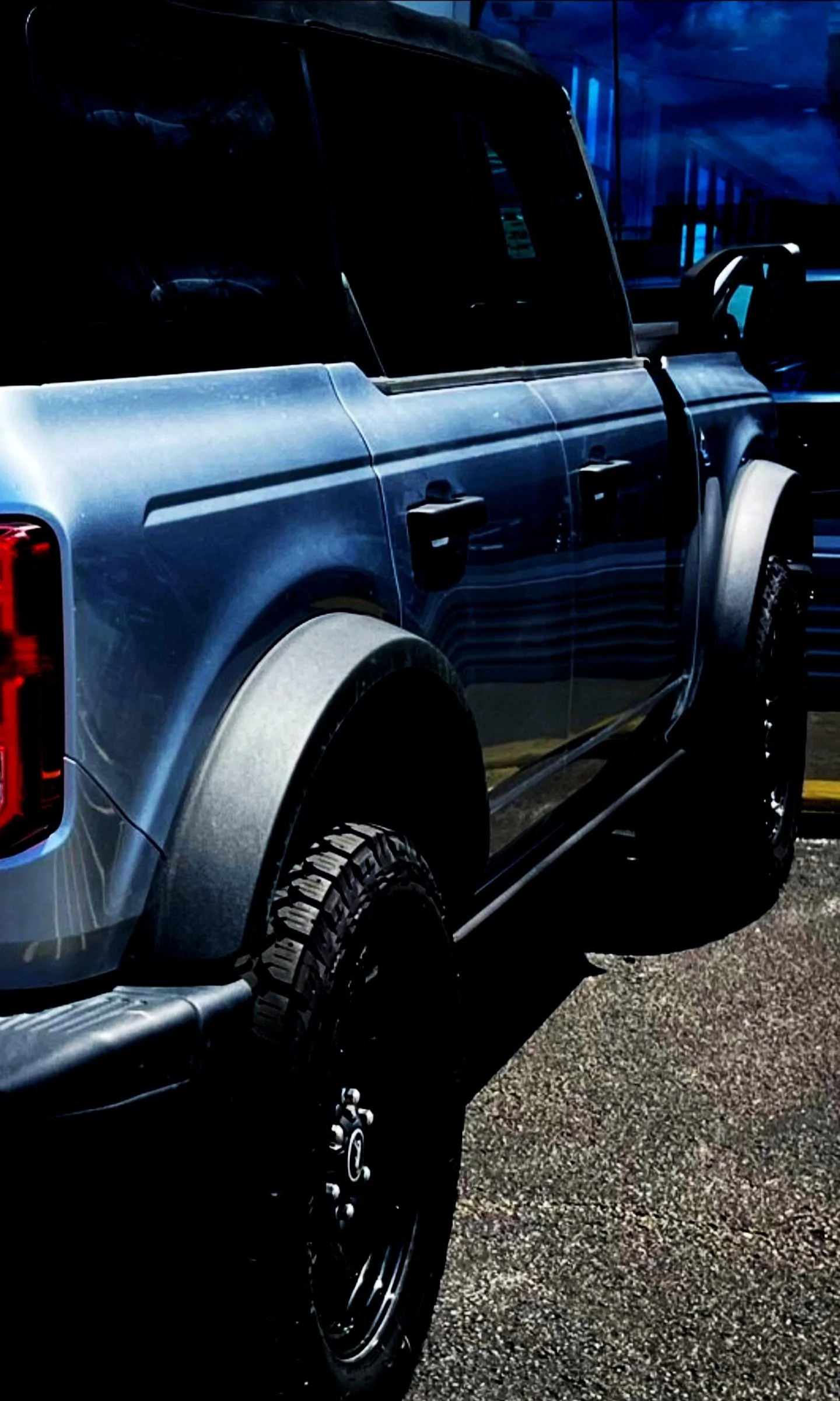

I have the same thing on my hood. It looks like two hand prints on my hood in certain light. My PDR guy noticed it a couple weeks ago too. I also noticed what kind of looks like zebra striping when I looked at my fenders at an angle. Like the spray was sequencing normal/light/normal/light coats. This isn't just on mine. When I see something on my car, I search to see if others have the same issue by looking at pics they post, and I've seen many like it. So it must be something about the paint application when going down the line. I haven't noticed it on other colors, but I find it hard to believe Ford sprays these any different. Maybe the other colors hide this thin coat zebra striping better than silver, which would be funny, cause silver hides so many things better than any other color (dirt, dents, scratches).
I had PPF applied to the whole car the week I got it, so there's no going back. Even if It wasn't wrapped, I would NEVER have the factory paint broken. Its hard for me to say this, being as meticulous as I am, but try to do your best to live with it. A Ford body shop once told me "I see the paint issue you're talking about. I can repair it, but keep in mind it's 95% perfect now. When we get done, it could very well be 90% perfect".
Here's a pic that I'm not proud to share, but it highlights what I'm talking about with the fender pretty well.

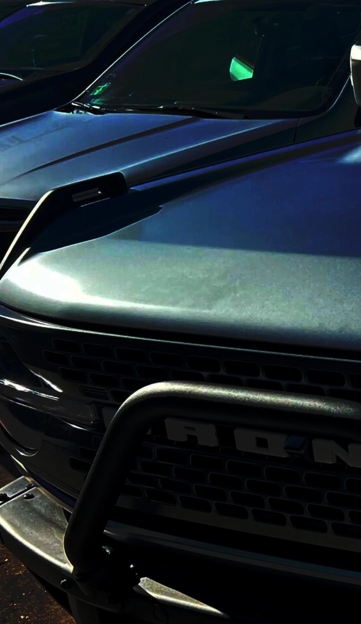

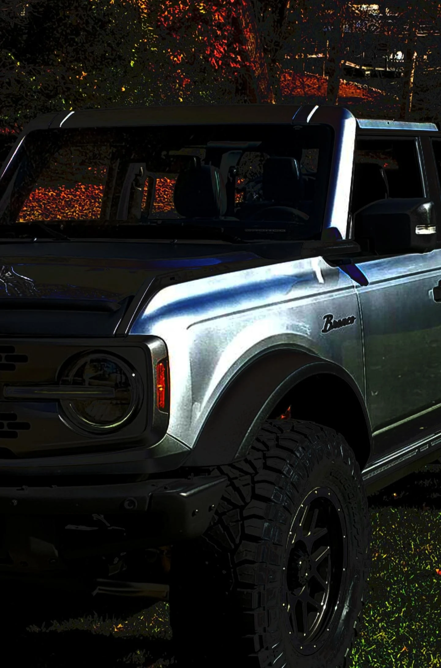

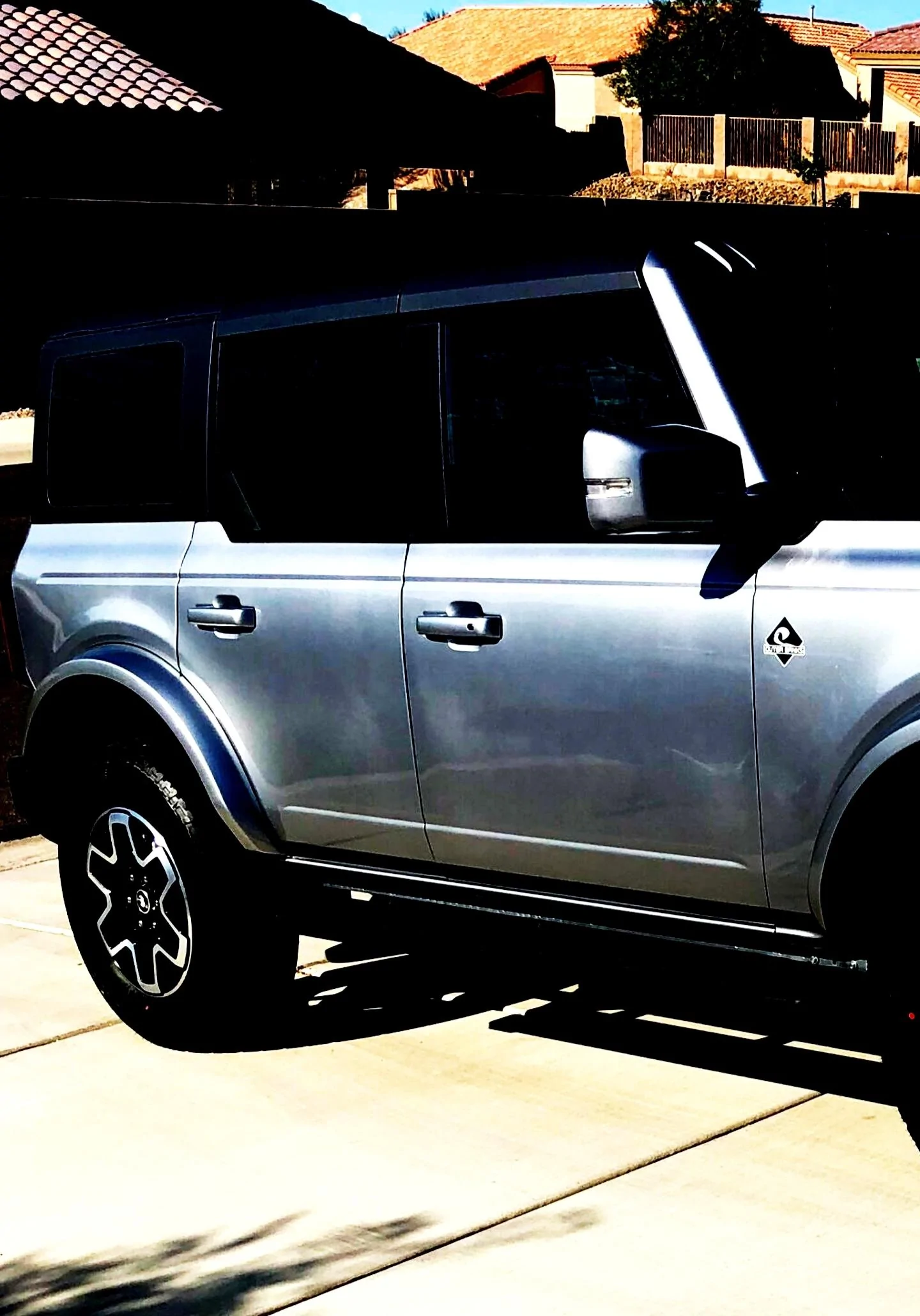

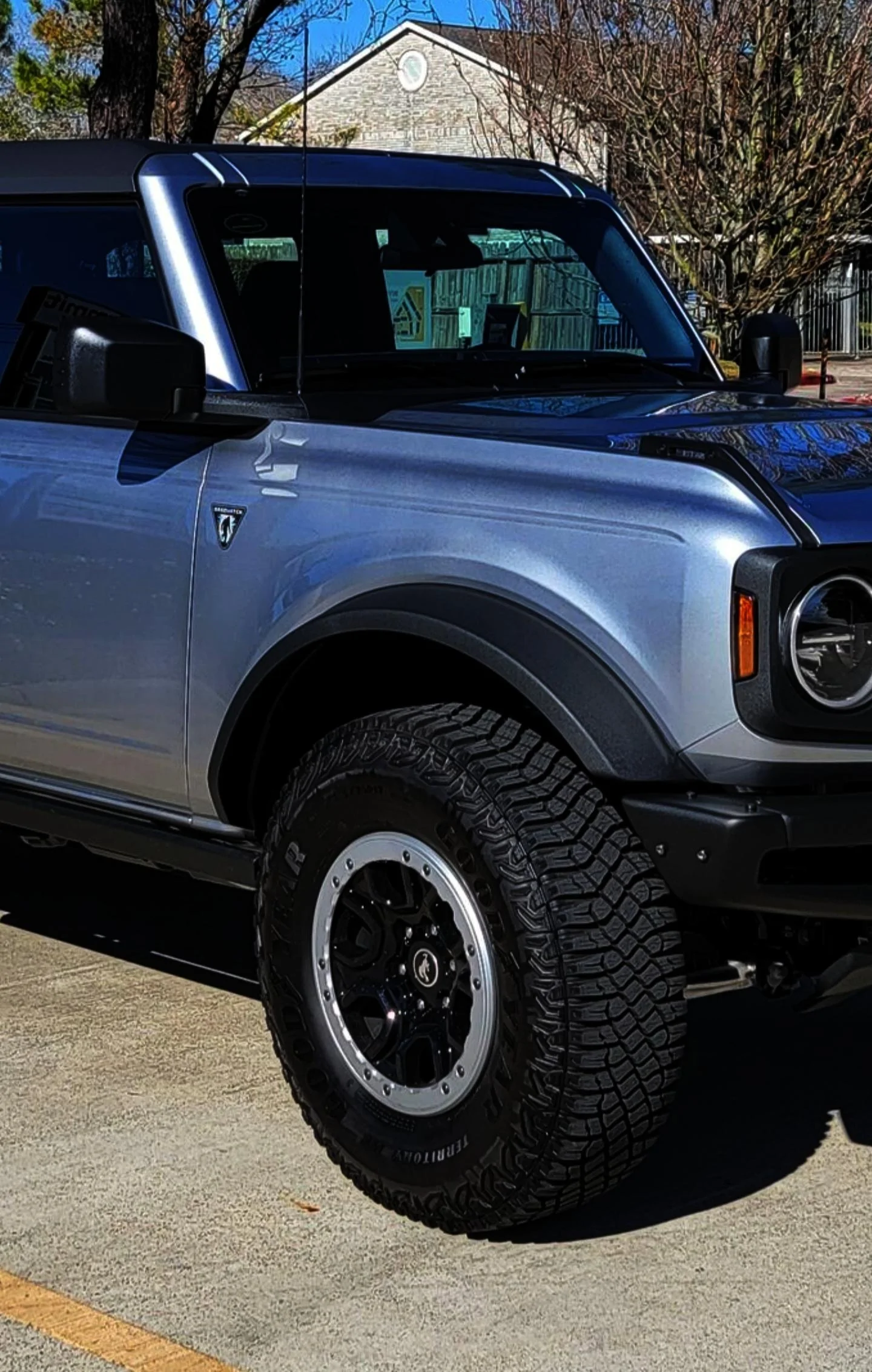

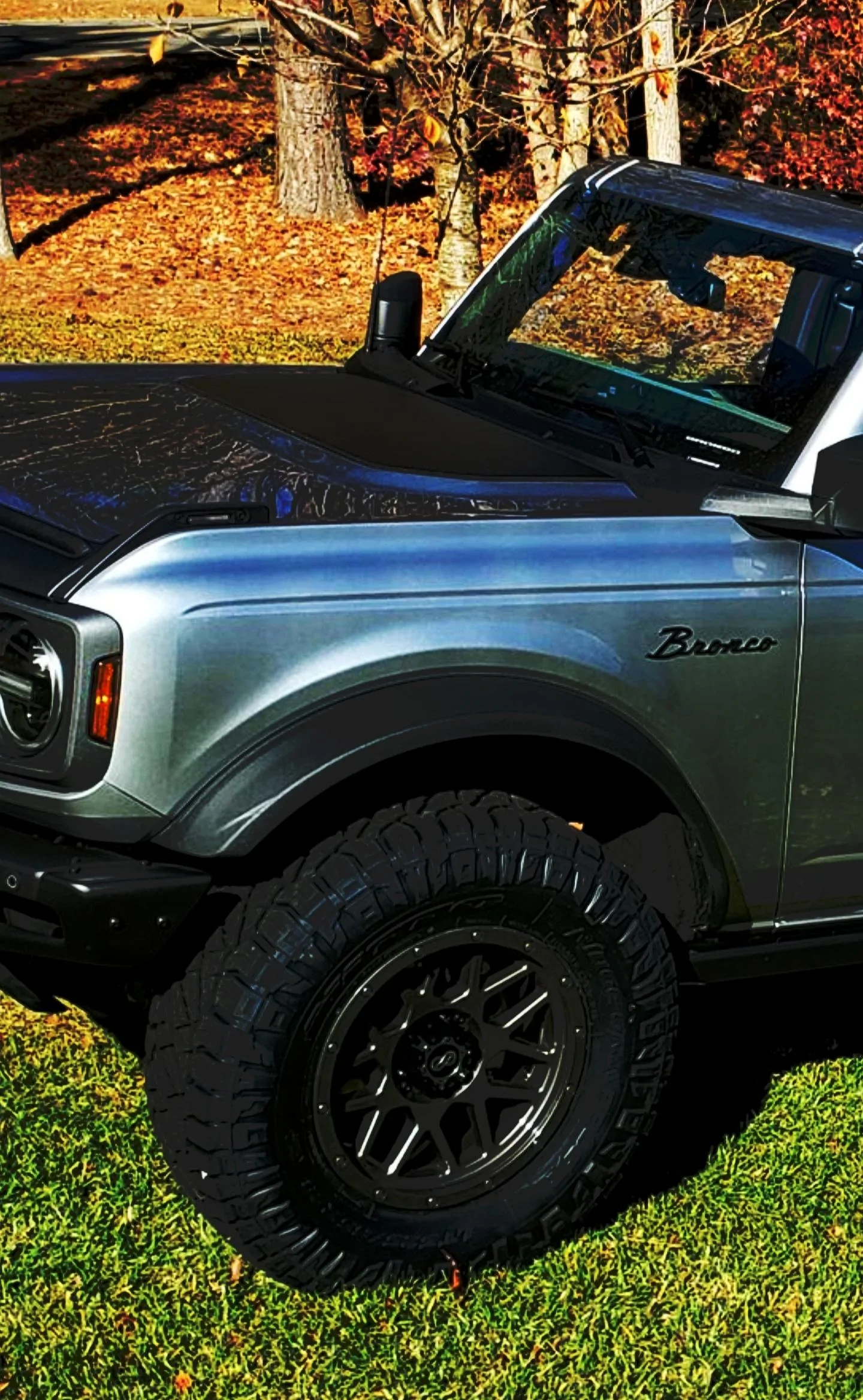

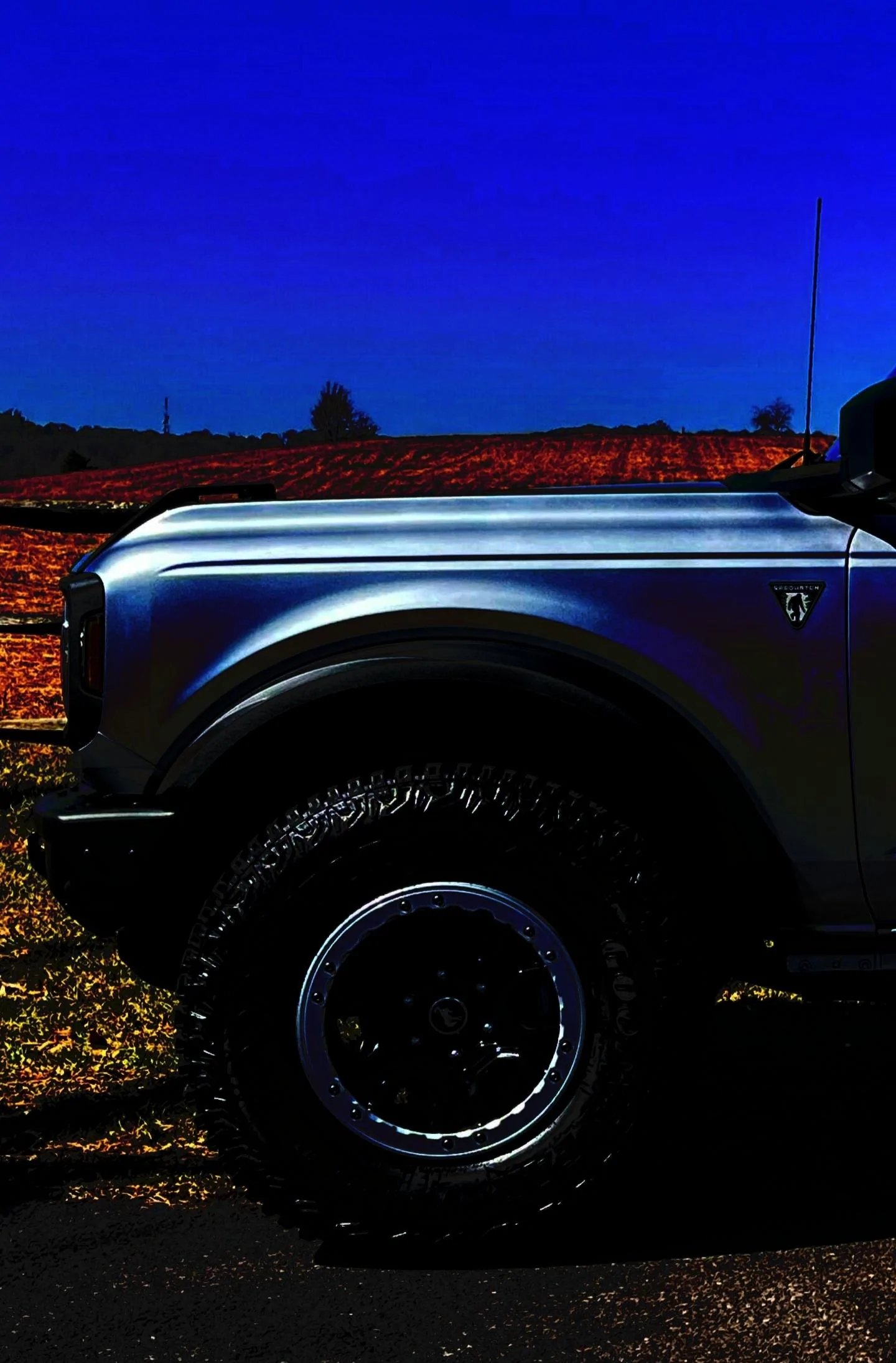

Speaking as a past dupont rep for automotive application at the mfg sites this is an application problem. Your probably seeing the flake which has moved as it drys. Could be a robotic problem or a final repair problem which was hand sprayed. The silver is known for this. Not much that you can do but have it sprayed again. Contact Ford but good luck.

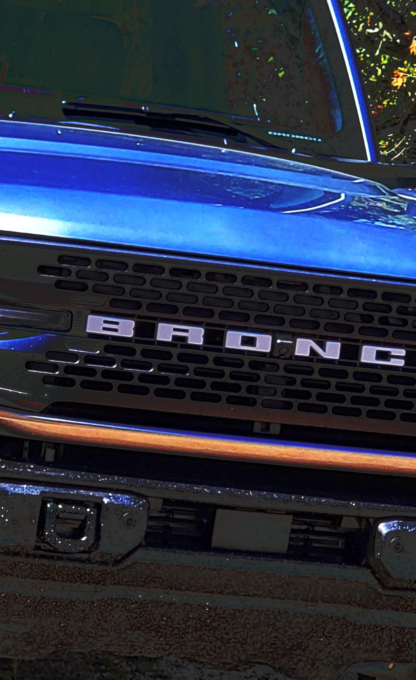

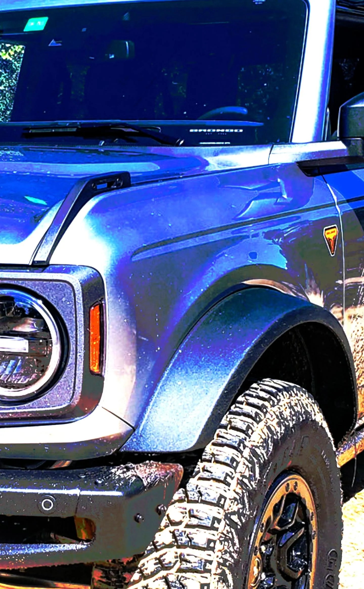

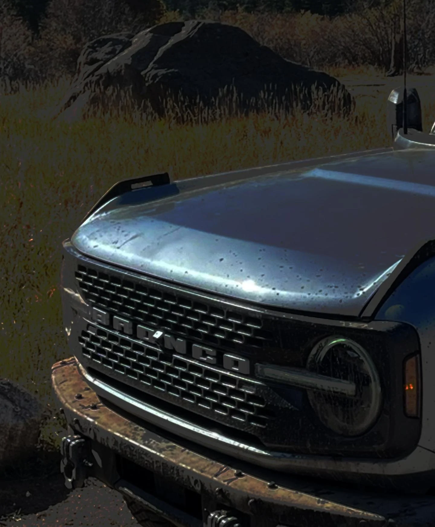

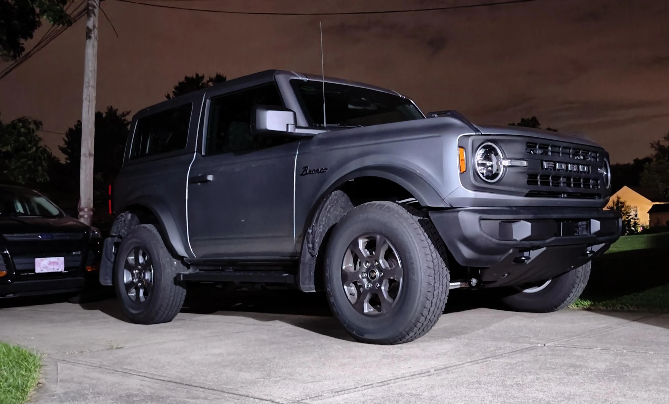

@TCB-1 if the pic of mine wasn't enough to let you know that you're not alone, I did a VERY quick search through the forums for other Iconic Silver Broncos with your concern. I tried to keep reflections/shadows to a minimum so that can't be falsely claimed as the cause of what's being highlighted. I used filters to make the issues easier to see. Being that I'm a fellow owner with this same issue, I am leaving my paint alone, as most wouldn't notice it and it would probably come back worse if repaired. Just enjoy the car.
To those who haven't looked to closely at your paint/noticed this, I suggest you don't go looking, you cant unsee it.
Sorry if one of these pictures is of your Bronco. My intention is only to show the OP that they aren't alone, not at all to point out flaws in your car.

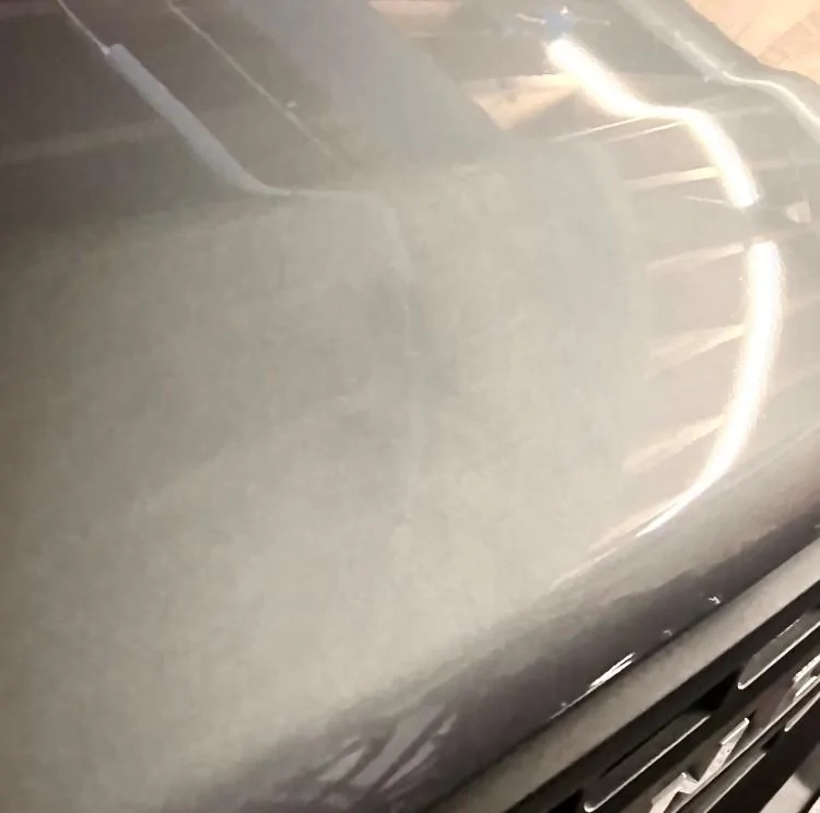

Gang. Just took delivery of my '23 Iconic Silver Black Diamond last week. First off, I FREAKIN' LOVE IT! First vehicle I look back at when walking away from!
Second day of ownership, I walk by the front of it in my garage and noticed a very faint dark patch on the front of the hood (about the size of a hand). I get to looking more and there's actually two faint dark patches. My garage has led lighting, btw. After studying the patches, it looks more like where the metal flake didn't "sit" in the same direction as the surrounding coat. It could also be that not enough silver base was not used. Or it could simply be an overlap of metal flake.... but regardless, it catches my eye every time I walk by it now.
I sent my dealer a text right away and asked if they could direct me to a customer service number or email so I can at least make my issue known. Of course I was told, "We I wiped the hood of rail dust for you, that must be it"... Well, actually no, it's not rail dust.
I'm a novice auto painter (novice at best, lol) and would at least like a case opened up. Am I nuts? I understand this isn't a show car and is an assembly line paint job, but I'd actually like a uniformly painted hood. The rest of the truck is darn near perfect with no flake splothes: I had time to evaluate it during applying graphine coating 3 days ago.
Thoughts? Should I just shut up and enjoy? Should I have it evaluated at my local dealer?
Terrible pic, I know. You can pick the faint dark spot out easier with a video.
