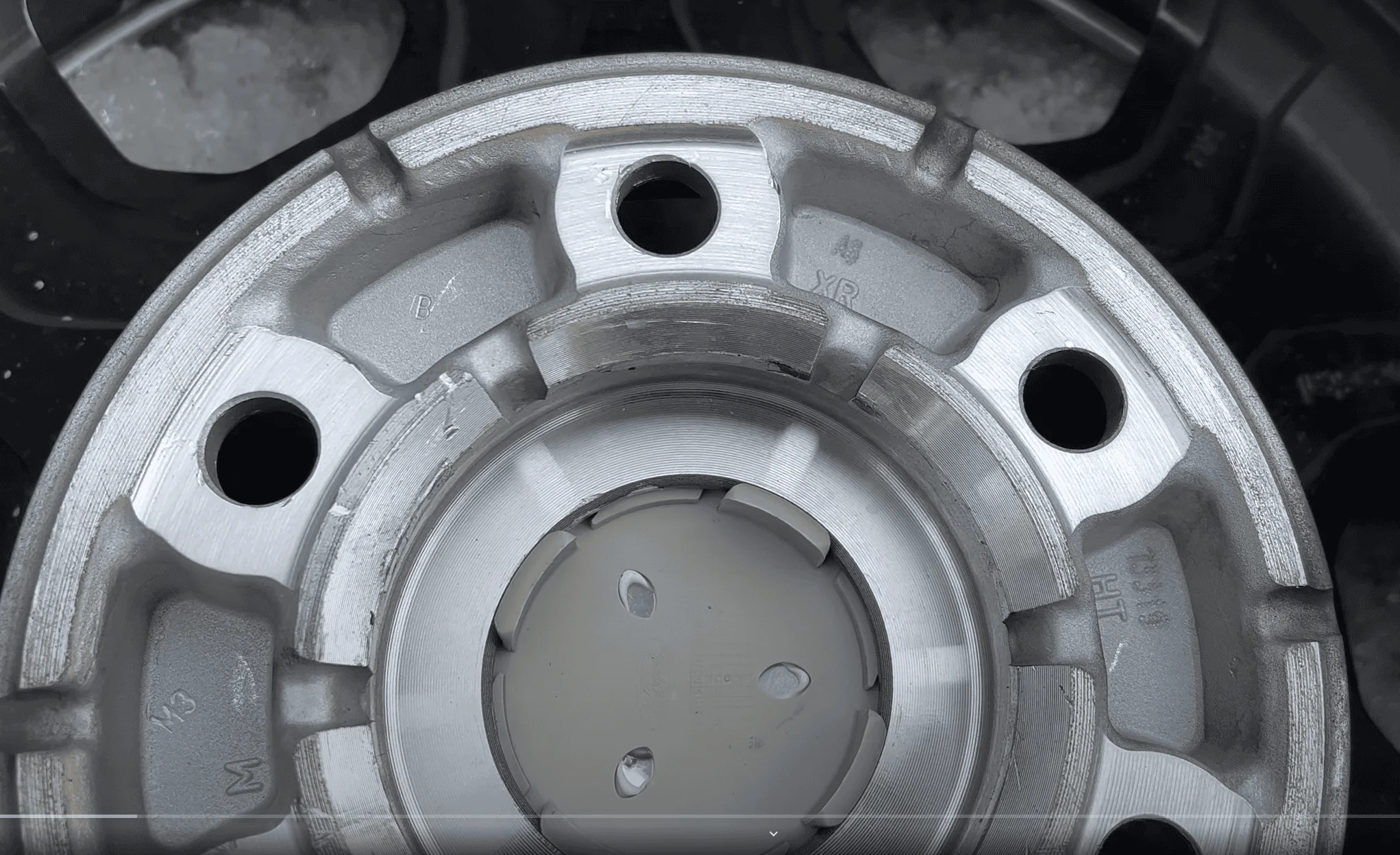

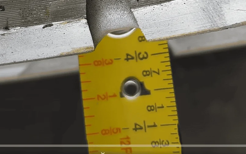

Ordering the 3/4"! I'll report back how it goes. Pics from the 3/4" video, thanks all!

Those pockets definitely look deeper than the ones on the optional BL wheels. I think you should be fine with the 3/4". Install the rears first as those studs are longer for some reason.
