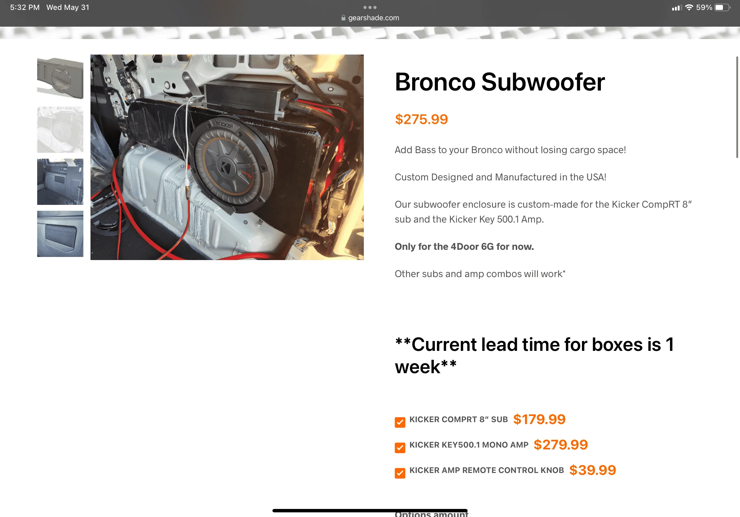

MTI makes a raptor specific rear speaker pod. I swapped those out and put Focal 6.5s in them, did the same with the kick panels, and then put 4" FOCALs in the dash.
I am in the midst of changing out the factory sub with an 8" kicker they make for small enclosures, and then add a kicker 500.1 key amp.
