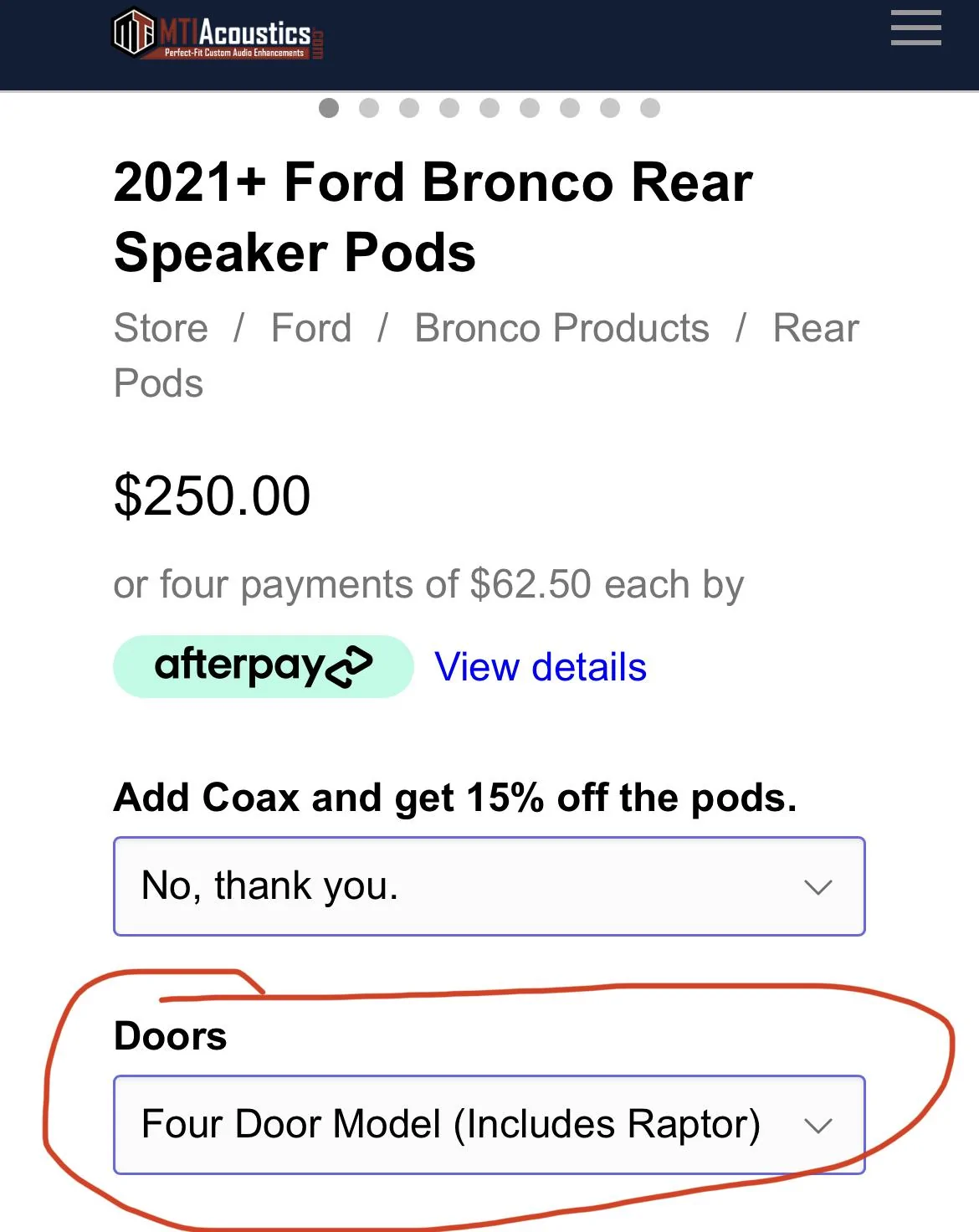

Rear speakers are just 4inch. You should replace with 6.5 speaker pods from MTI Acoustics. Almost any 6.5 speaker you go with will sound better than the stock 4inchers. Just warranty it if you can so you have the stock equipment in case you sell later.
Says on their website doesn't fit Raptor

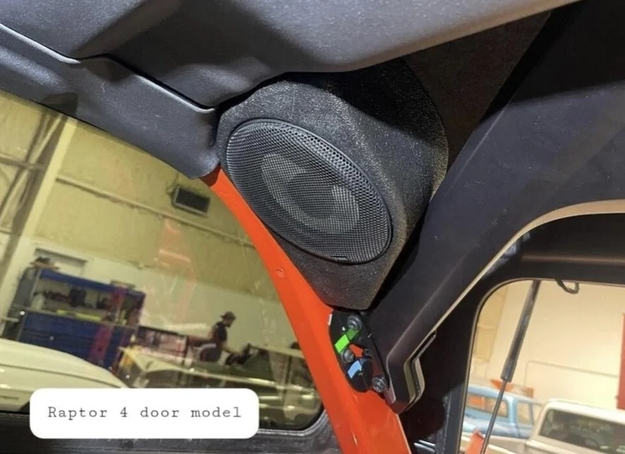

Click on the bar and choose 4 door model/raptor. Even their pics show it on a Raptor.
Great - now I need to spend more money.

I just replaced mine with JL C2's.
C2 650's in MTI pods in the rear.
C2 650's in the kicker
C2 400's in the das corners.
