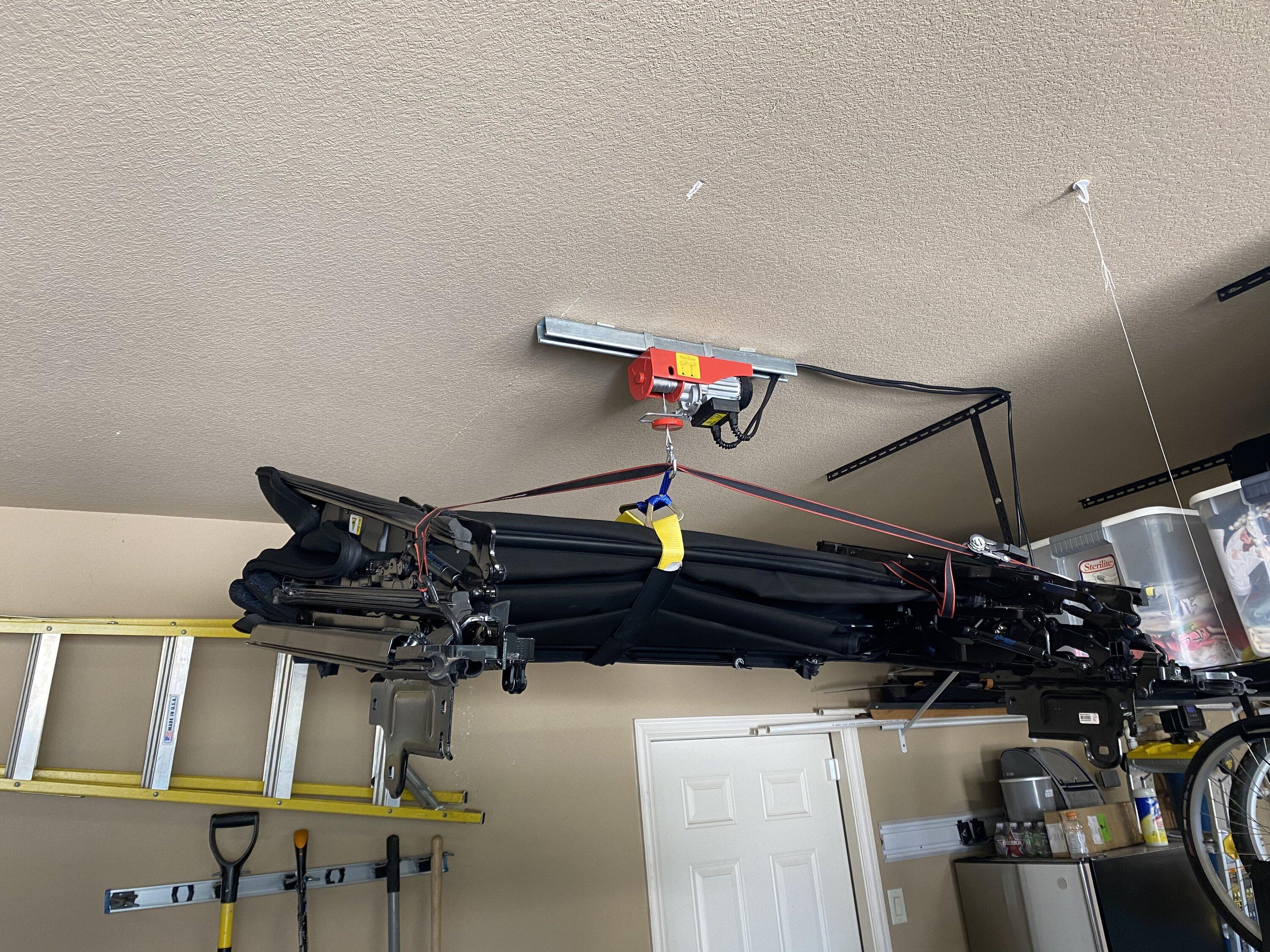

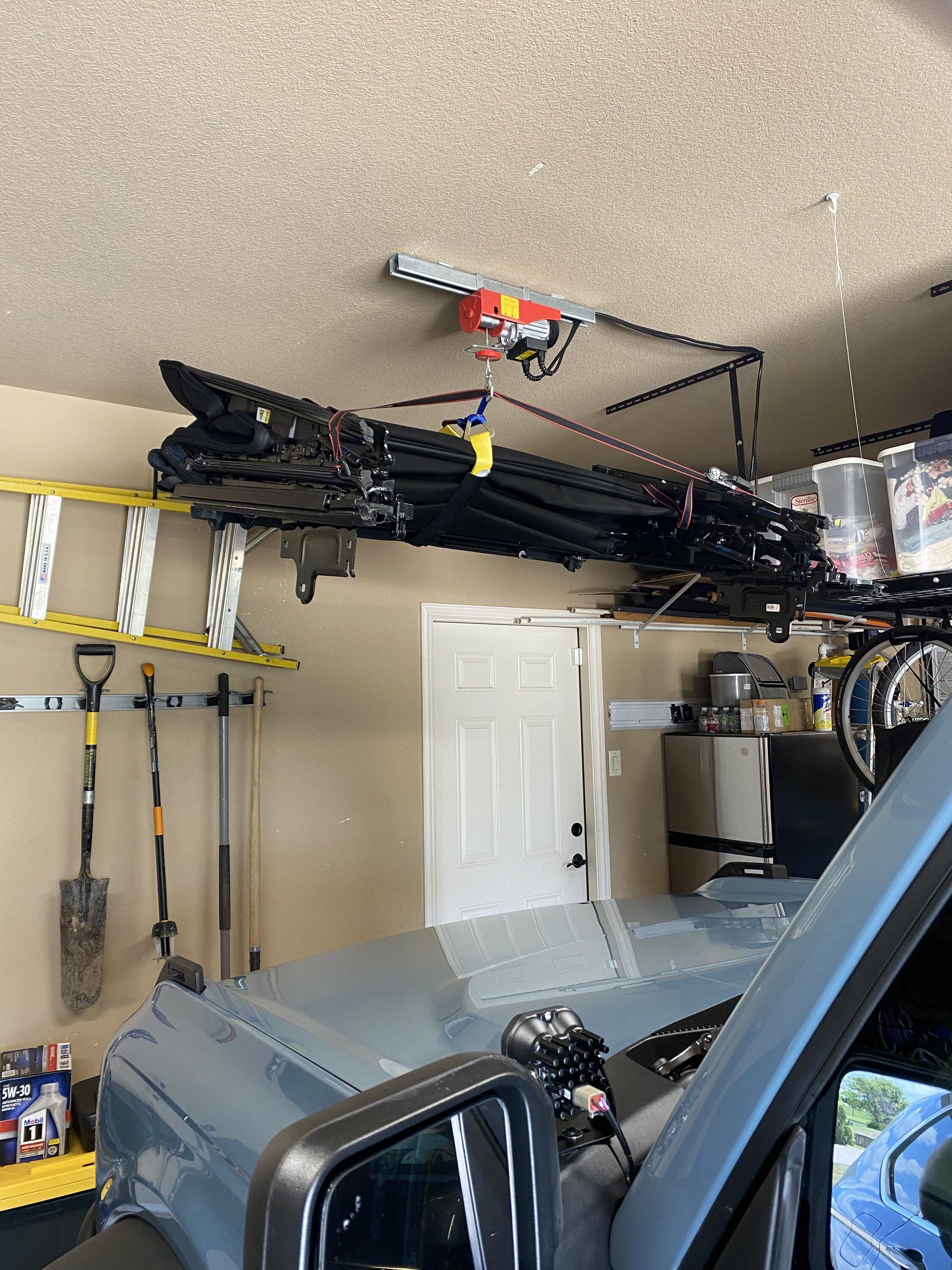

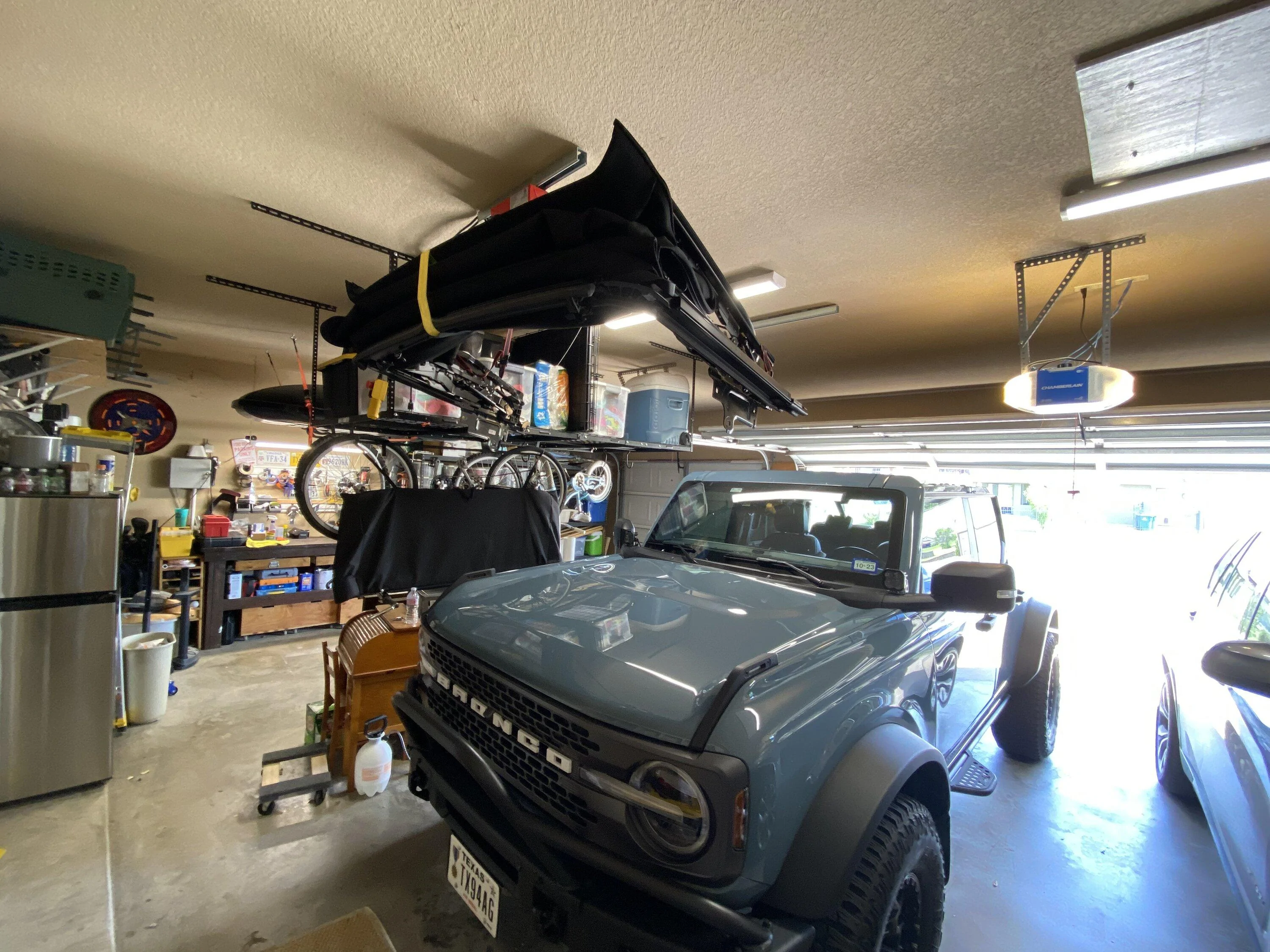

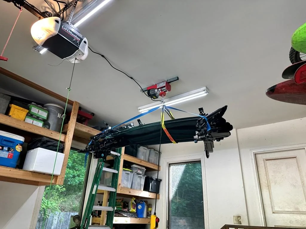

Here is my solution. Winch off of Amazon. Single piece of Unistrut 24”, lag bolted into ceiling joist. A couple of straps to hang and balance.
Ford Bronco Soft top storage BDC23DB1-45BD-4318-BB9D-F889674C9F5C
Ford Bronco Soft top storage 28DF2CD7-4A60-40C7-8C6B-26C4774AA791
Ford Bronco Soft top storage D281289D-6E1B-4737-AE48-4294073005C2

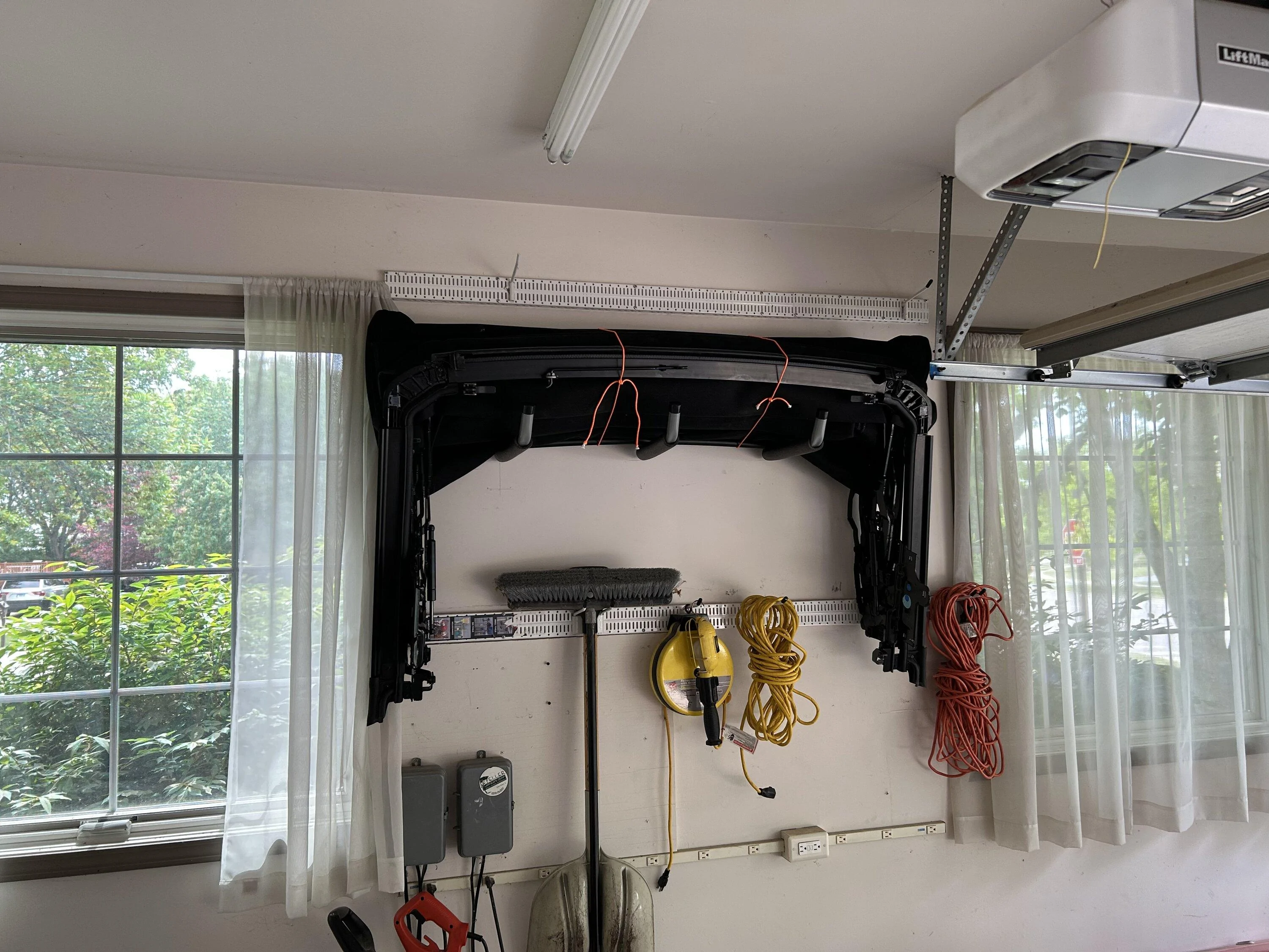

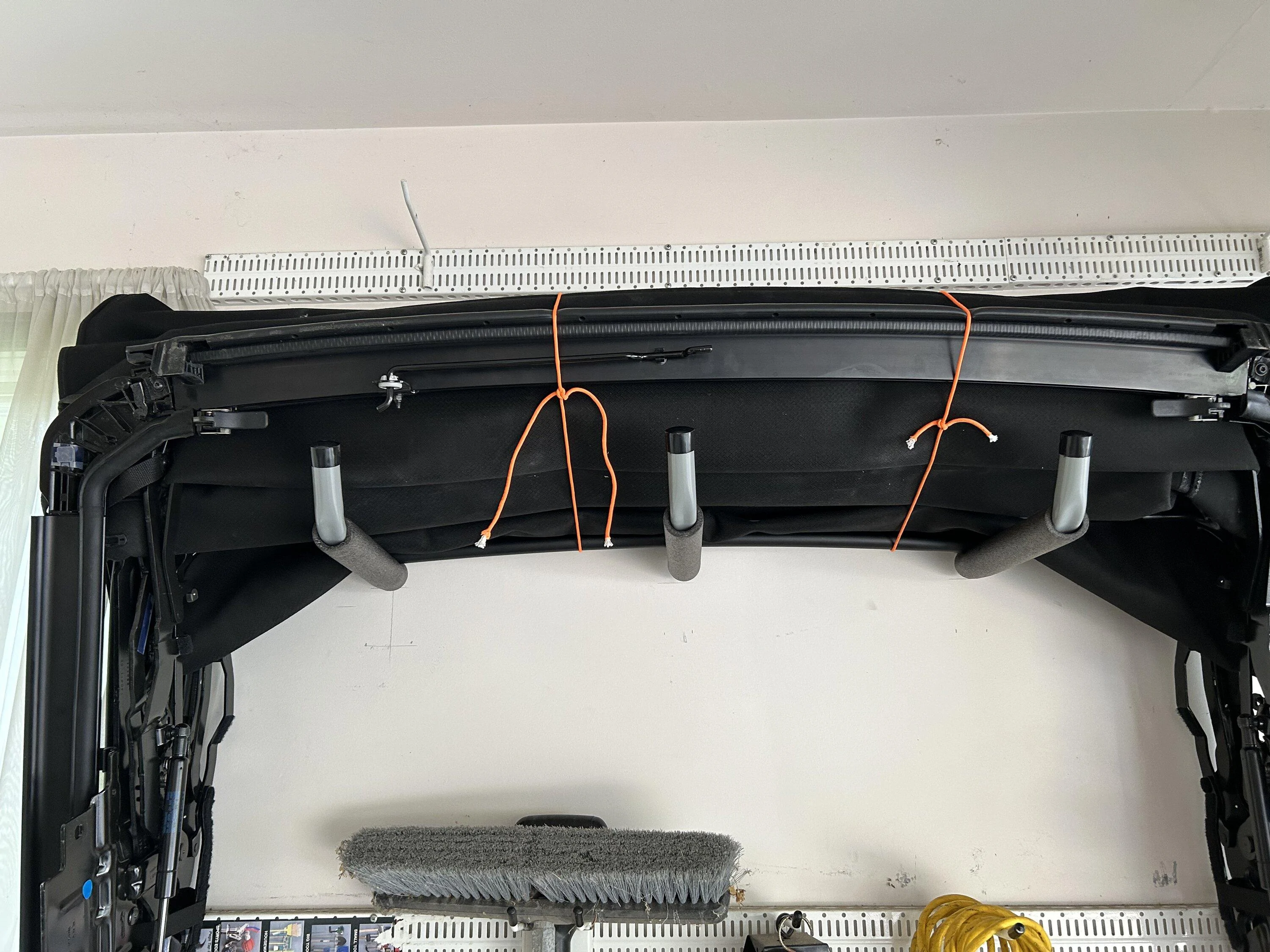

I tried @StyleGuy solution. Install was straightforward but getting the soft top off the Bronco took two people. Getting it up on the wall, I was on my own. What a PITA. 😂

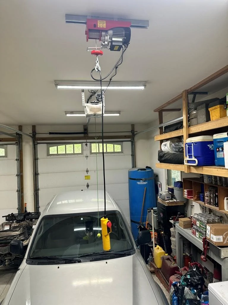

I used Essmith94 's idea and it works great, thanks for the inspiration!
Ford Bronco Soft top storage dLPeRO5
Ford Bronco Soft top storage YavK4Gr
Ford Bronco Soft top storage hZ48RE7

Do you have the links for the parts -to save a little trial and error on my part!
thanks!

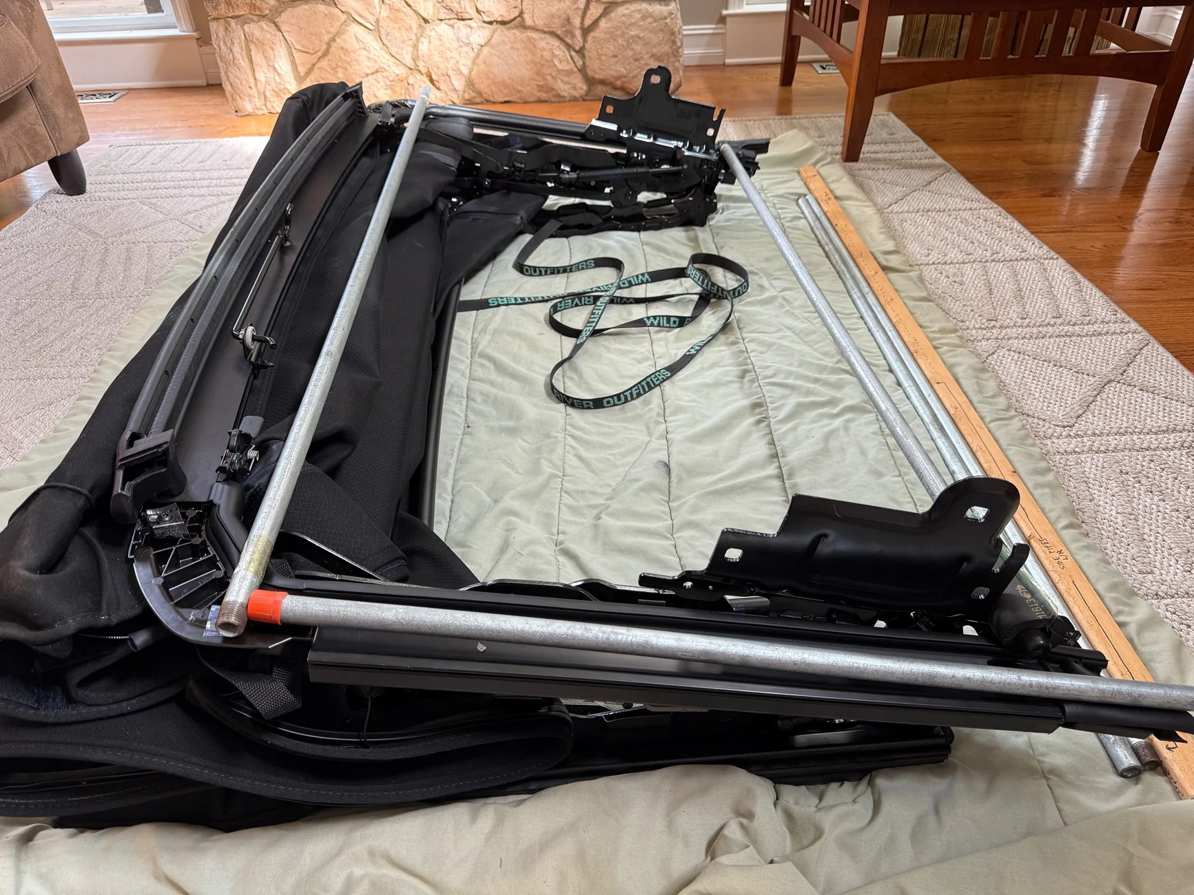

I'm looking to do the same with my Smarter Home hoist and a OEM soft top take-off I just bought.
I think I have a design worked up with some pipe from Home Depot and 90 degree elbows
I'll attach the pictures which will give you an idea (keep in mind the soft top is upside down).
The idea is:
* 1/2" galvanized pipe with 90 degree elbows
* build basically a "sled" that will go under the soft top
* the "front pipe" will lock into place (see the image) on the bracket
* the "back pipe" will support most of the weight across the back ledge
* The "Side pipes" will take some of the weight and hold it all together as a box/sled
* use the Smarter Home strap/net that lifts the Hard Top to lift the sled (just run the straps under the galvanized pipes - the back and front)
* the balance should be about the same as the hardtop (fingers crossed)
Ford Bronco Soft top storage IMG_4911
