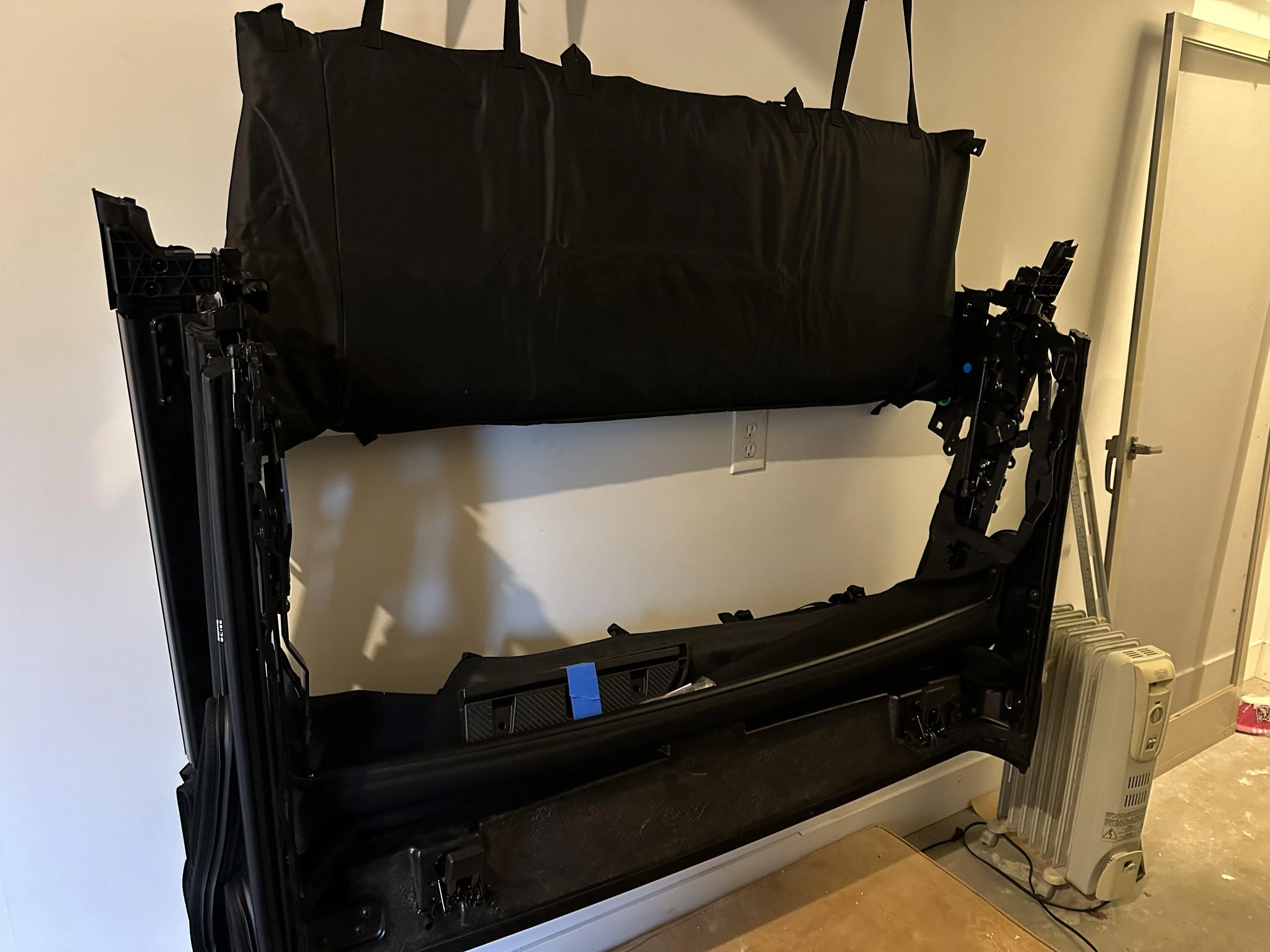

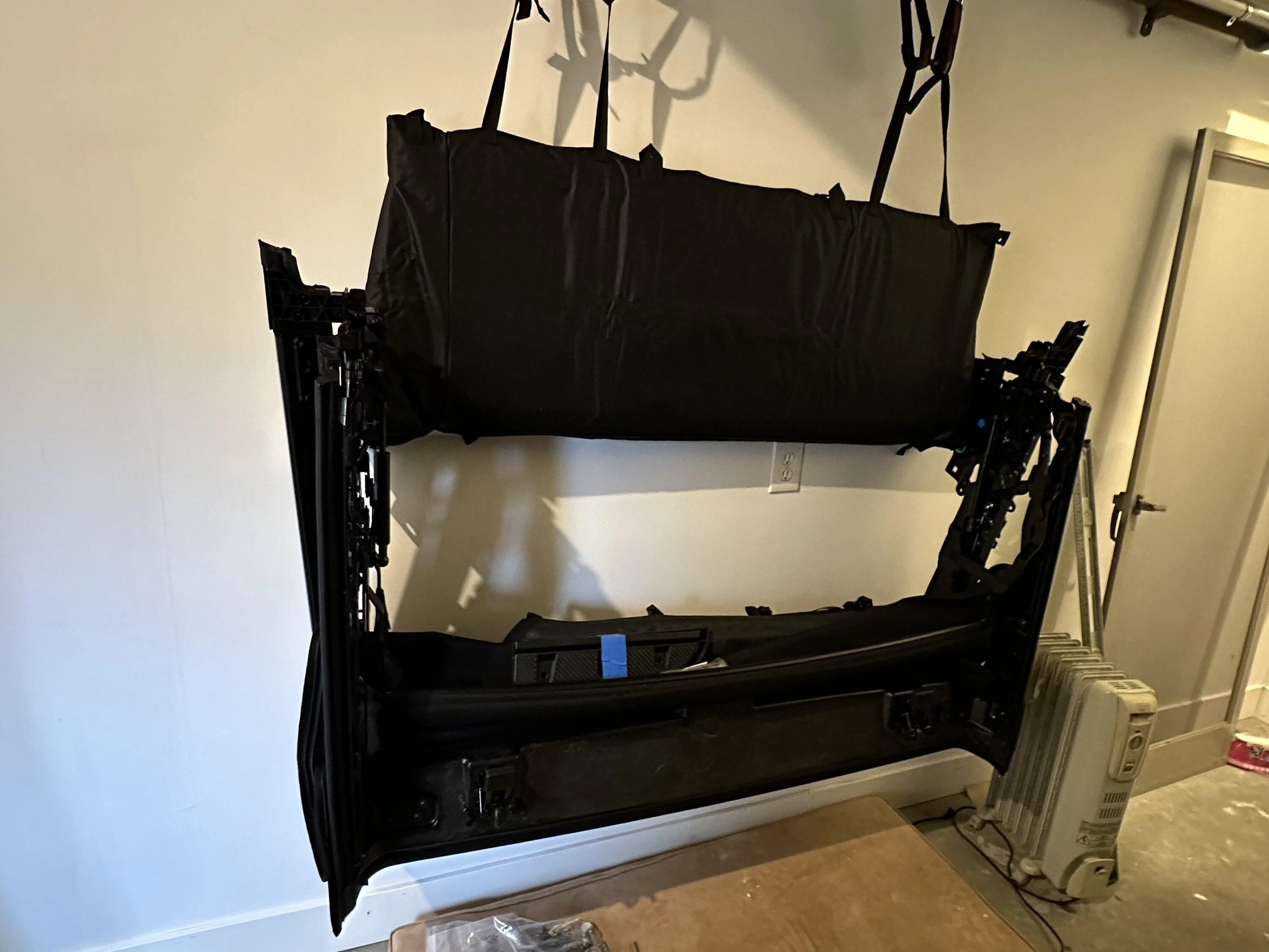

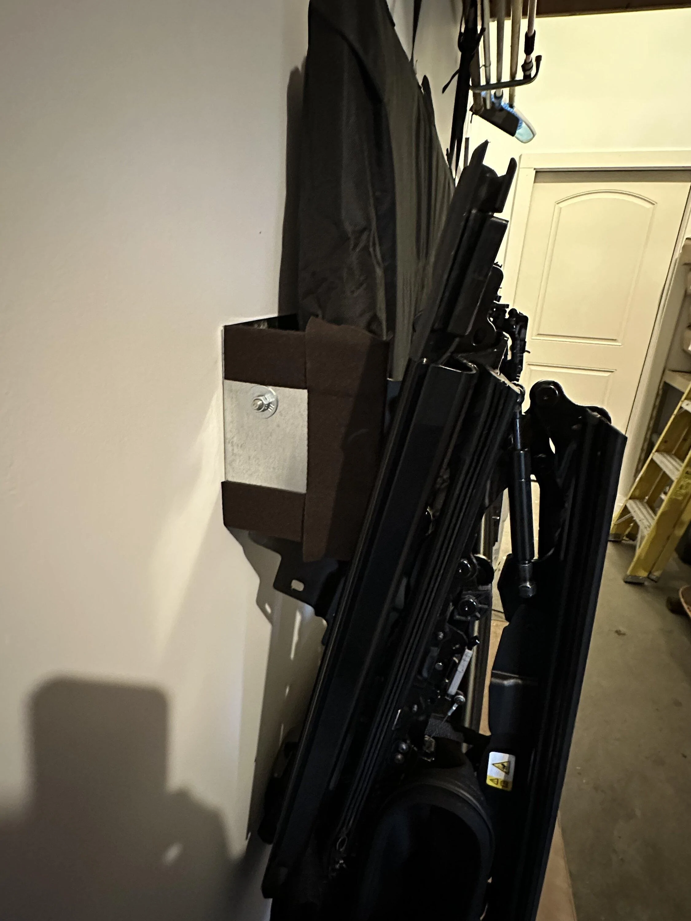

Nothing fancy here but I sorta stole the idea from a Jeep soft to storage company. Not exactly the same but same method. I just had work make me a U shaped piece of metal just wider than the top out of 14ga galvanized. Laid the top into it so I could drill 1 hole to match the brackets and then lagged it to 4 studs. I wrapped the ends in felt only due to the sharpness of the edges. Mounted it ‘wife’ height. Used the factory Velcro straps to hold it closed and then mounted to the wall. Used a 3/8” bolt on each end to hold it up. Windows are stored in a Mabett bag off Amazon just above the top.
