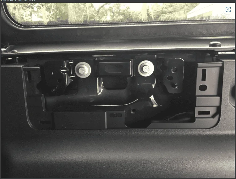

I’m having trouble getting my new soft top to latch up front. I adjusted the top roll bar mounts and got it to click but then it makes it too short to close up front. I’m thinking I may need to adjust the bracket in the cargo area. Is there a secret to the attached bracket when installing. It appears to have a significant amount of adjustment.
Ford Bronco Soft top install instructions? IMG_1039
Brian_B
Sep 14, 2023
65
8,942
15,962
Central CA
I tried looking up the factory adjustment procedure but didn't have any luck.
I have had to adjust these brackets before, but it was a trial and error thing, so not exactly optimal. Wasn't terribly difficult in my case, but I know how adjusting these things can go and wouldn't universally say that is the case because I don't know.
Fast Eddie
Ed
May 17, 2025
303
485
NY
2025 4Dr OBX, 2025 Navigator BL
Is your top brand new? If so it takes a little time to loosen and stretch into place. When I first put my top on it was tight as a drum, now it's a little loosy goosy 2 months later. I also couldn't get the front to latch initially. The solution was releasing the rear latches and raising the cargo section and then locking down the front latches, then lock down the rear section. After a few weeks on the truck I was able to do it without releasing the rear.

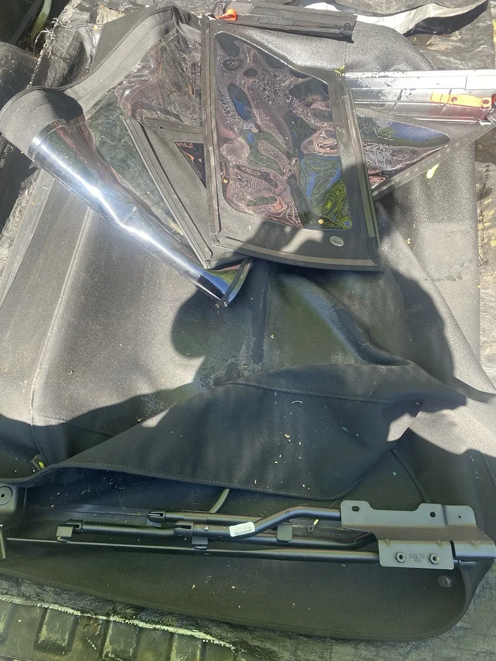

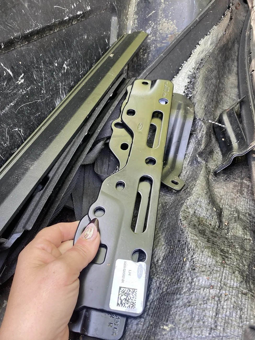

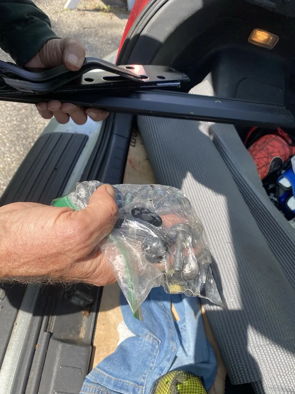

Do I NEED all those parts or do they have some of these in there?
