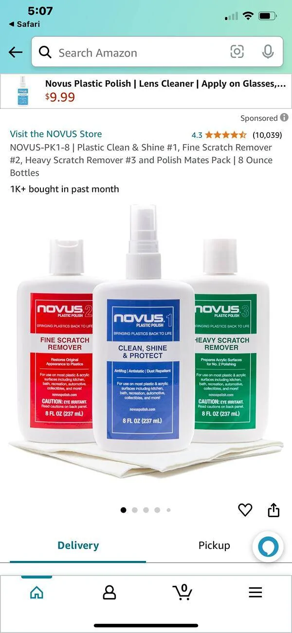

We use this to remove scratches on the helicopter windows. I used it with a DA Buffer on soft top windows and it worked really well. I laid them out on a blanket and buffed them on the floor.
Ford Bronco Rear Soft Top Window Too Stiff To Install IMG_0381
