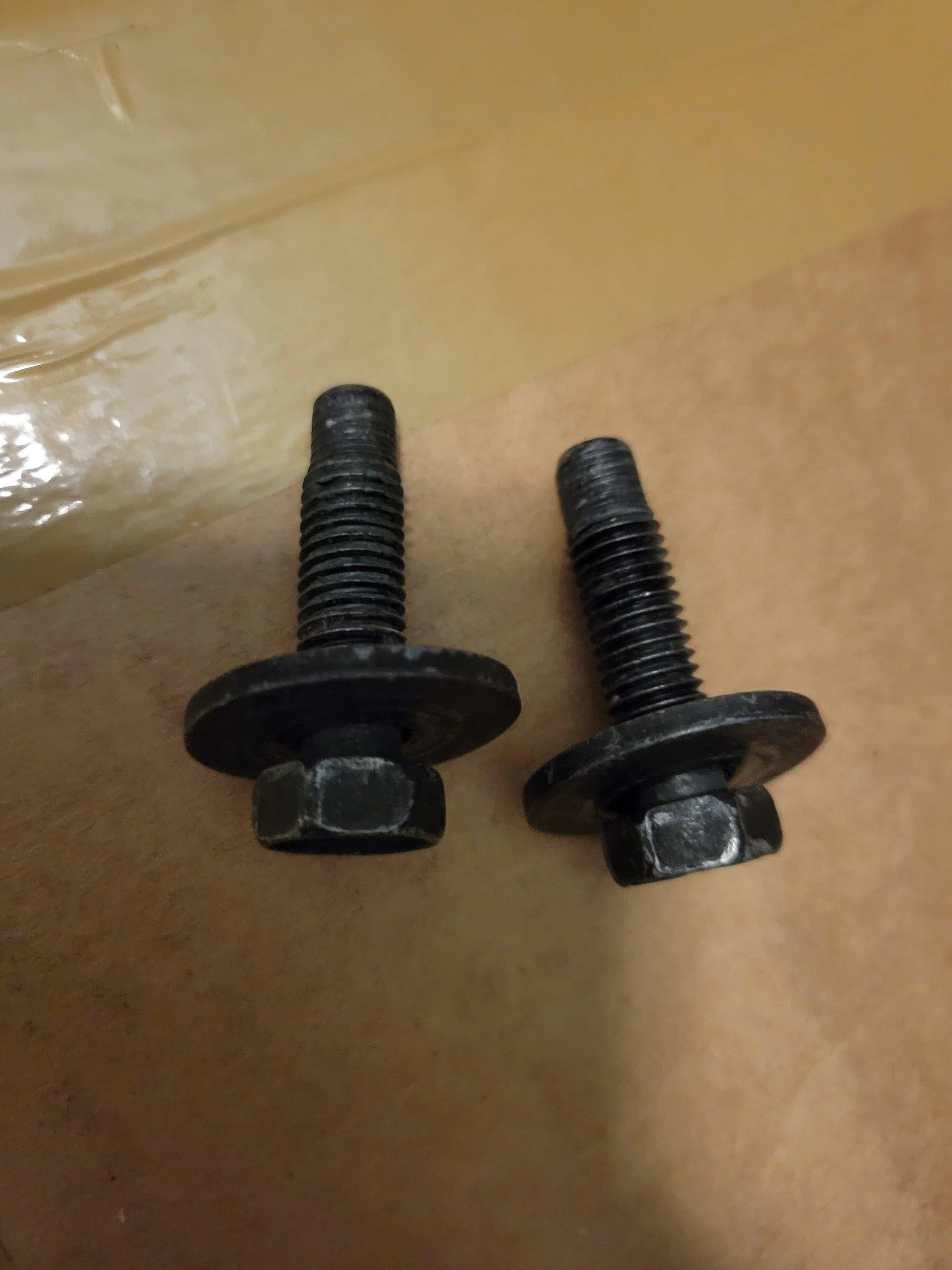

I have 2 left over from my replacement. I can take a picture of one if that will help or see if they have any numbers on them.

No markings on them.
Ford Bronco Skid Plate Bolt Size & Thread 20220404_213848
Ford Bronco Skid Plate Bolt Size & Thread 20220404_213913

M10x1.5 not sure how long though maybe 35mm
