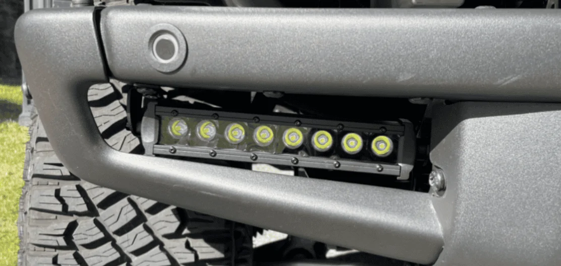

Or maybe a Rough Country 8" like NorthShoreBronco posted:

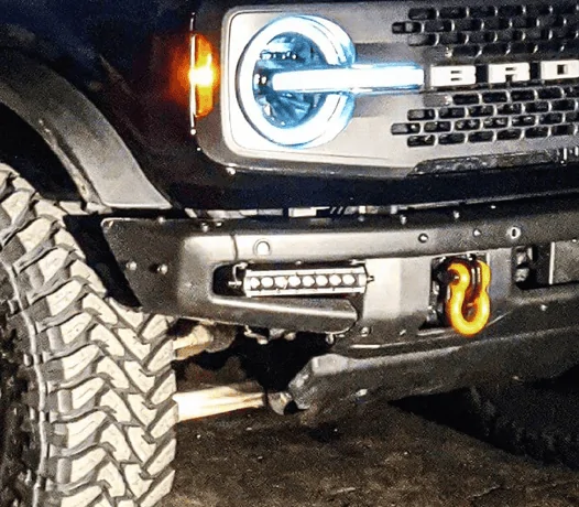

Or similar posting by Bschurr:

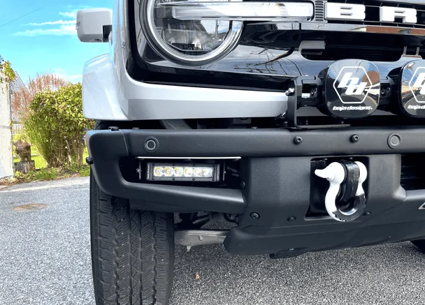

We already offer fog kits. The Baja Designs 10" is too big. But we've been offering (for about a month now) the Diode Dynamics 6" bars as part of a kit. We make a fog light mounting bracket already.
Lots of options here: https://www.4x4truckleds.com/vehicle-specific/ford-bronco/2021-bronco/
But the 6" Kit is here: https://www.4x4truckleds.com/diode-...-w-kr-off-road-brackets-for-2021-ford-bronco/

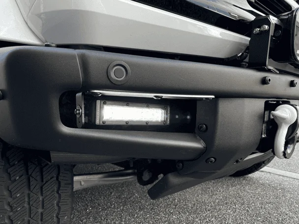

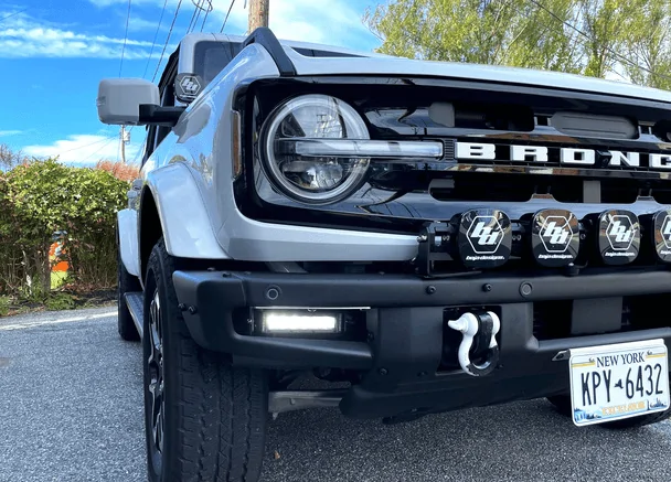

Our brackets are powder coated black, but what you see in the photos below is an unpainted aluminum one I was using to verify fitment.
