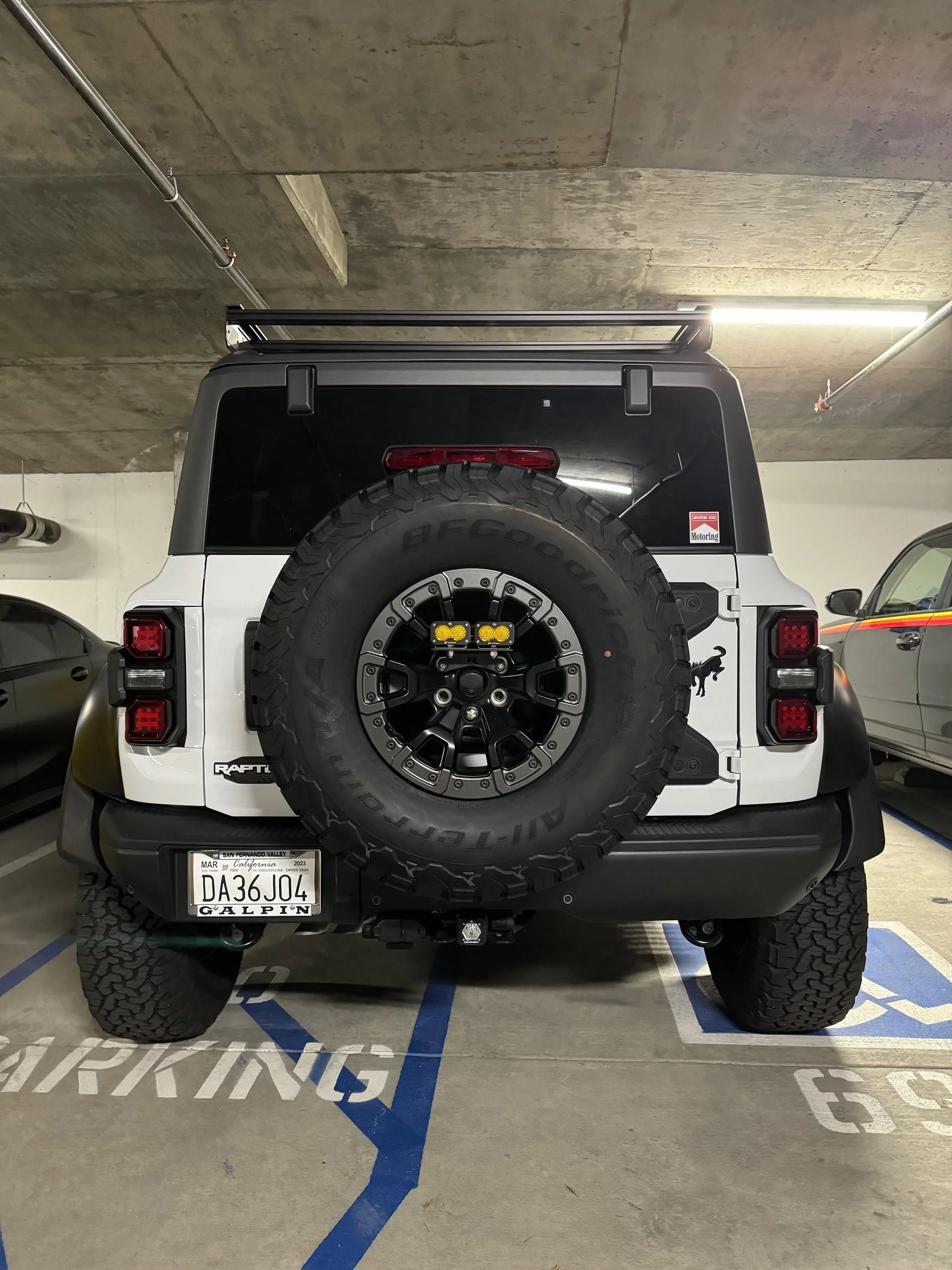

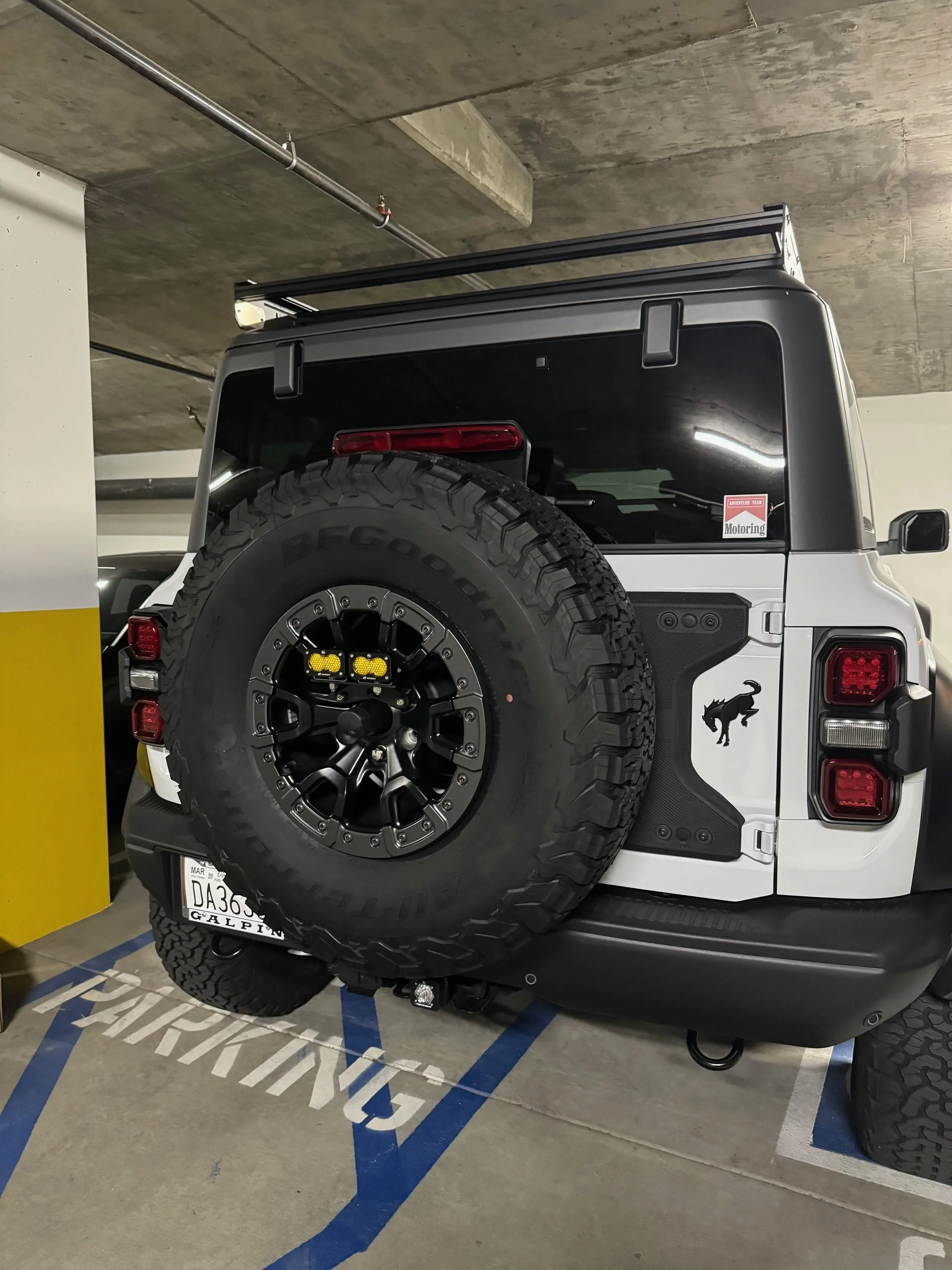

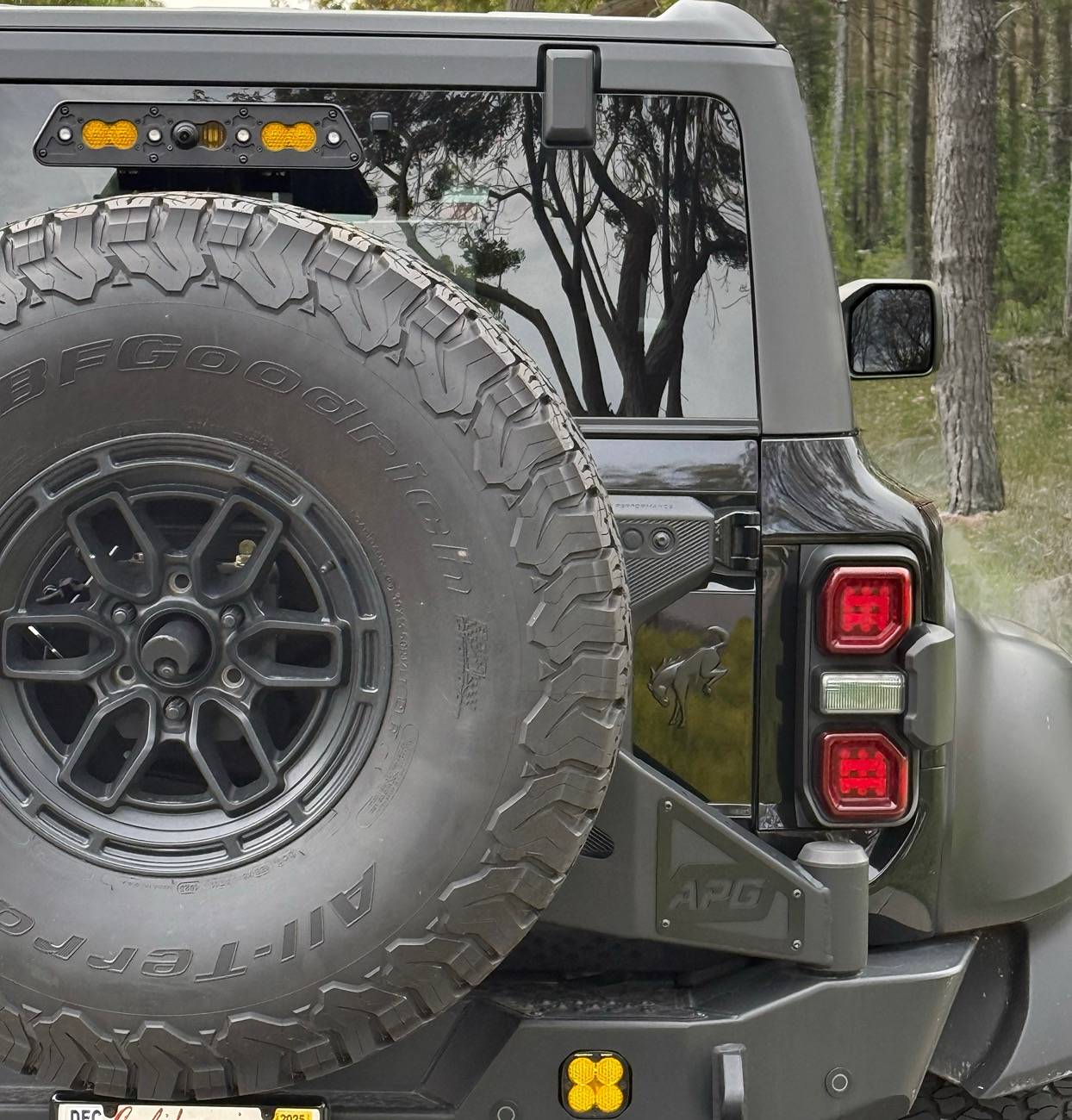

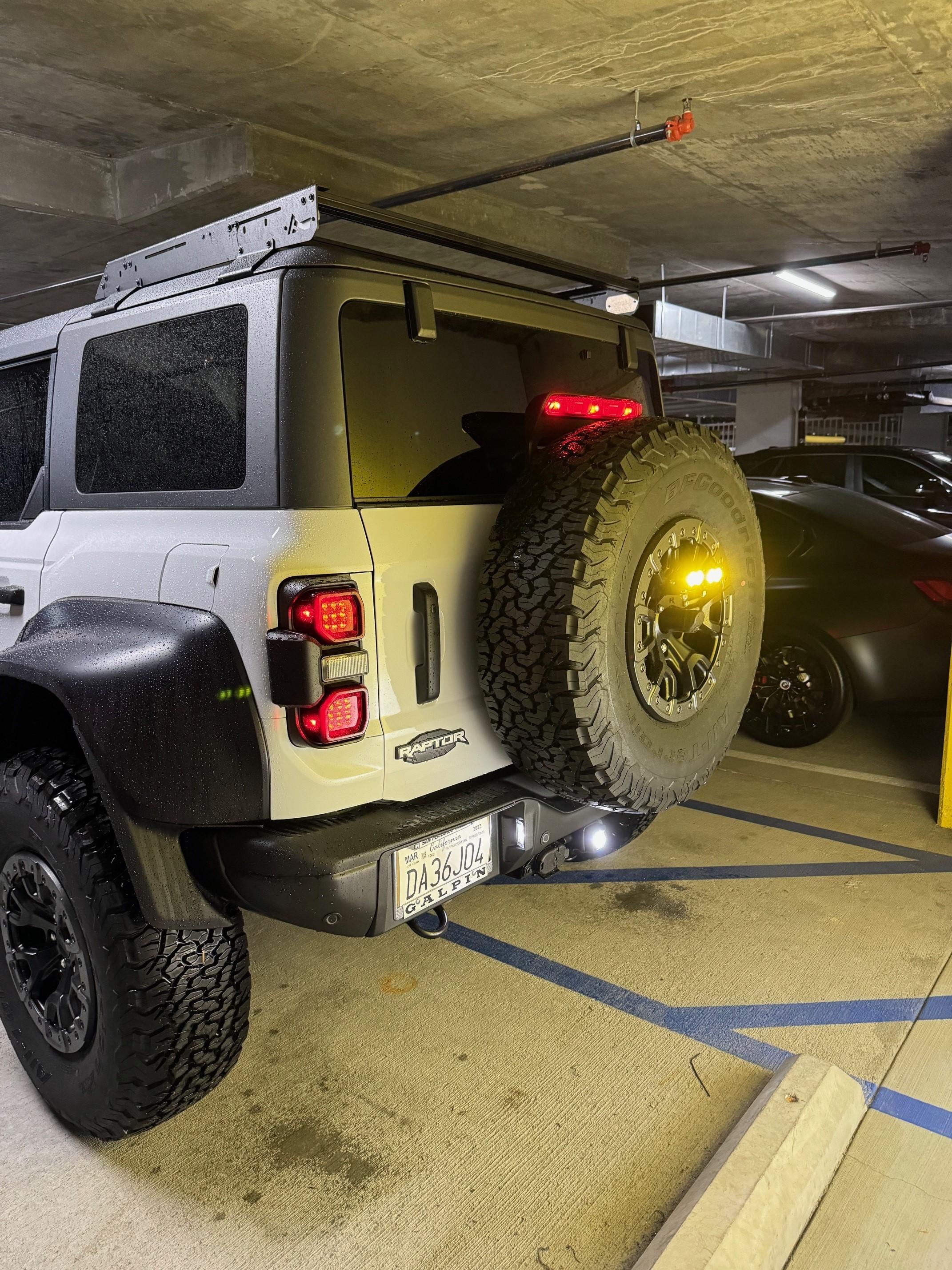

Fast Intentions bracket. S2 and wiring from 4x4LED.
S1 in the trailer hitch for reversing. All controlled by aux 5/6.

So, I don't have the factory installed tow package. However I had the 7 pin kit installed, think that would do the trick?
I'm not sure. The harness supplied plugs in between the 7 pin factory wiring and 7-pin plug. It would work you just may have to hard wire the light instead of plugging it in.
That is exactly what I’m doing. Install starts tomorrow (plus a lot more lighting up front).

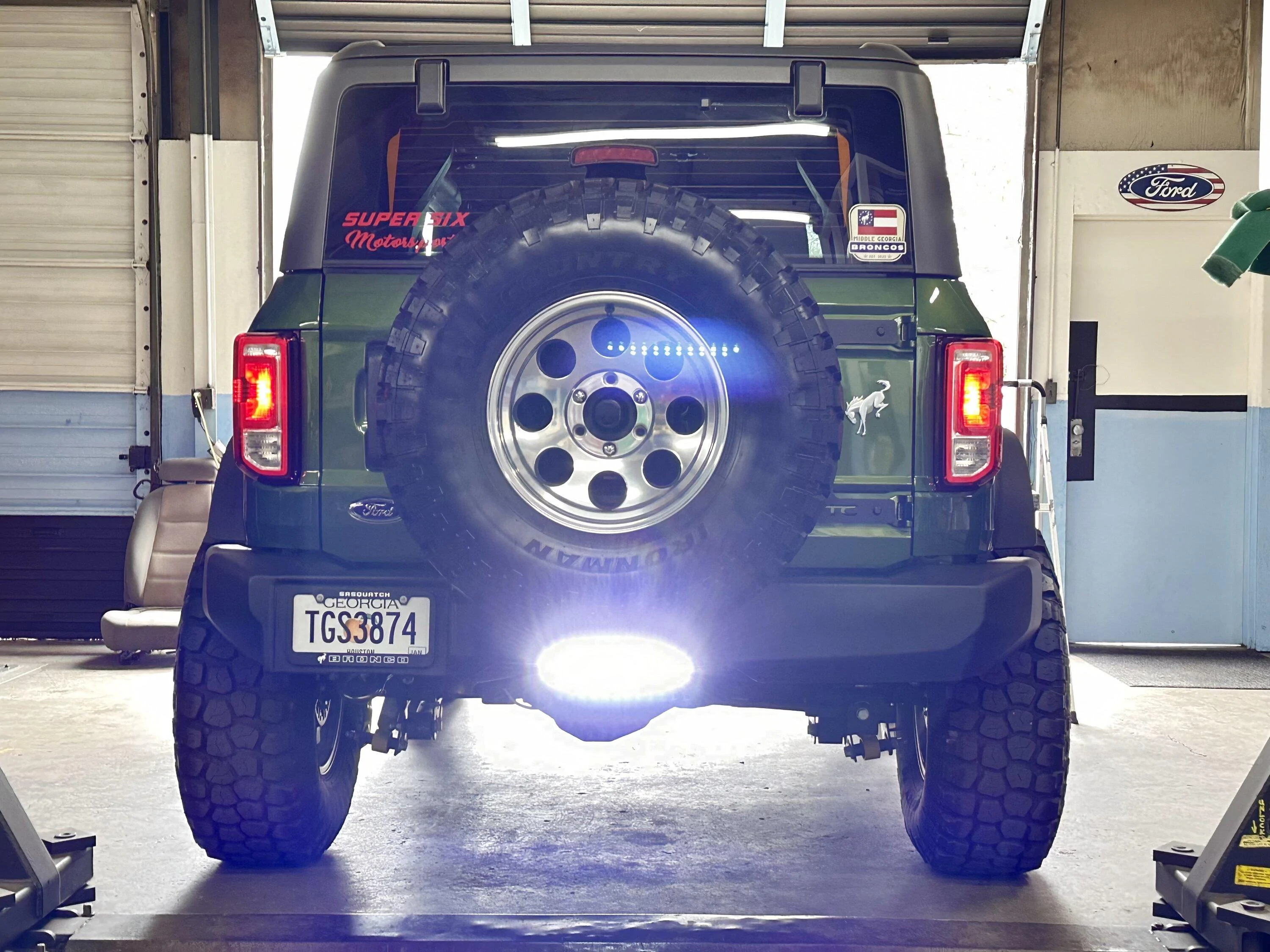

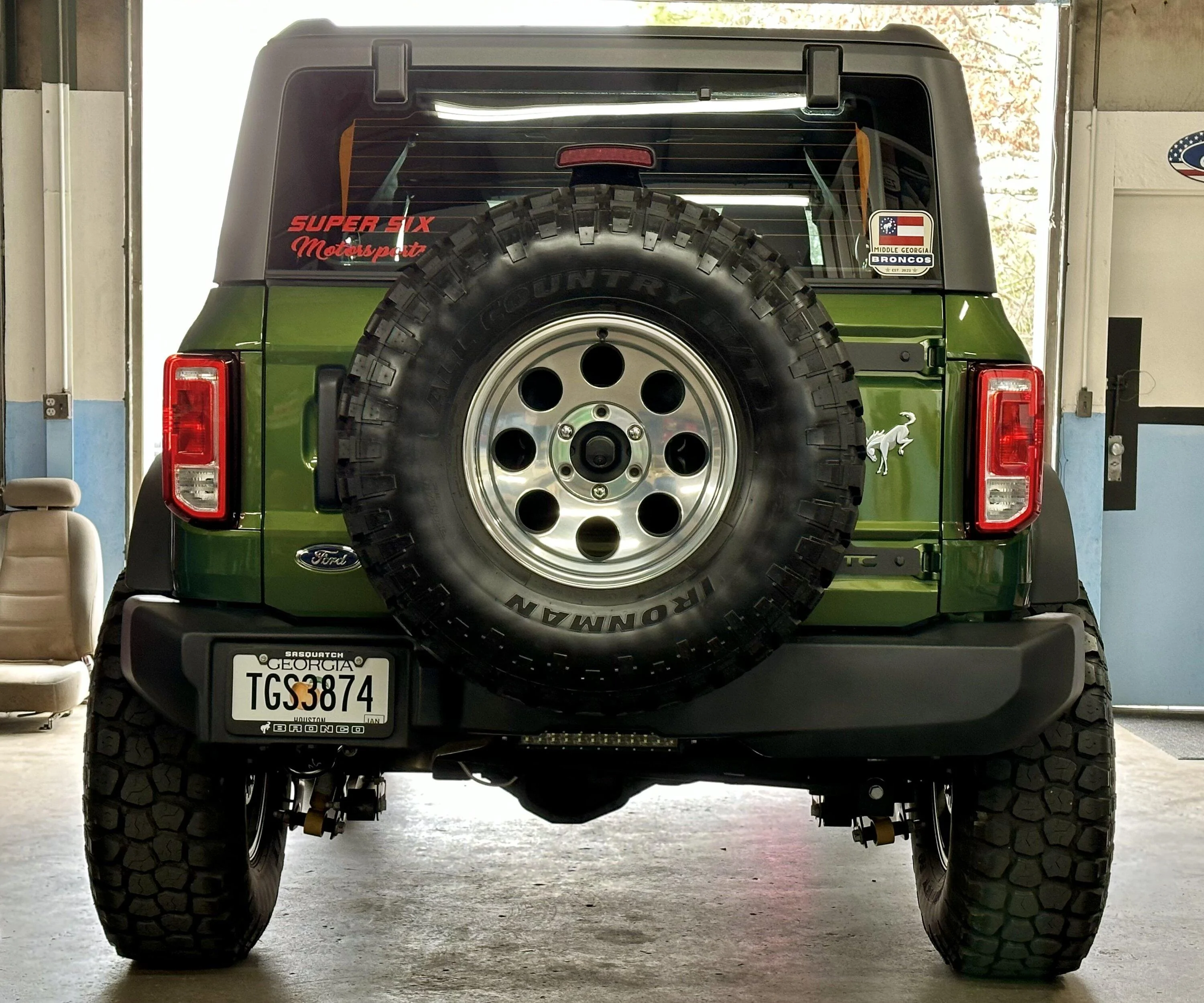

Here is mine. Made a simple L bracket to mount on the frame cross member to pick up the existing trailer hitch mounting holes (I dont have a hitch) and mounted a cheap Raxiom 14” super slim dual row LED bar. Cheap and works pretty good. This isnt the brightest light option out there, but it definitely works for this application.

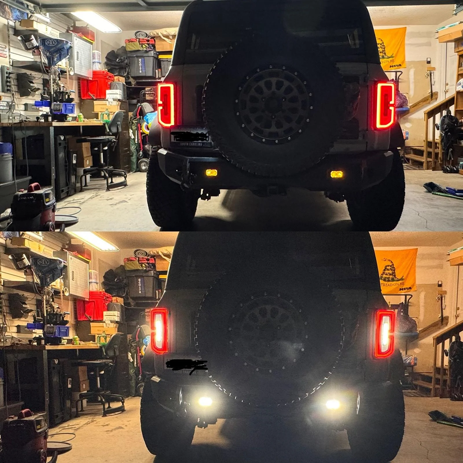

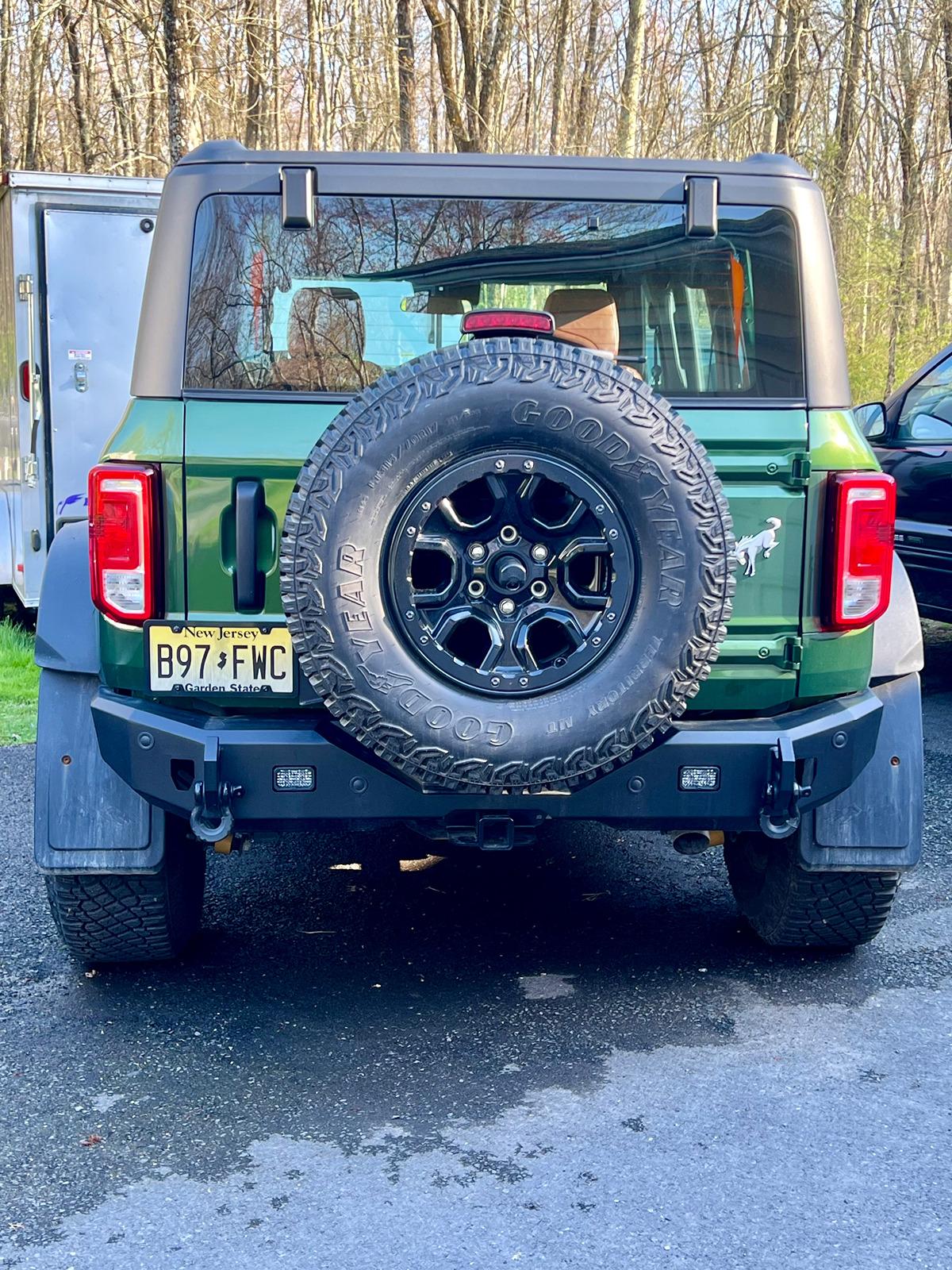

I bought my bumper 95% for the lights on it. I was sick and tired of not being able to see when backing up. The middle lights come on when I put it in reverse, the outside pods come on with AUX 5. I am very happy with the lighting now, can see much better from the side mirrors and the backup camera.
I didn't want lights attached to my tire, don't like the look. And then when backing up when out such at as a restaurant, blinding people in parking lot of eating on a patio because the lights would be so high.

What bumper is this? Love the light access on yours!
