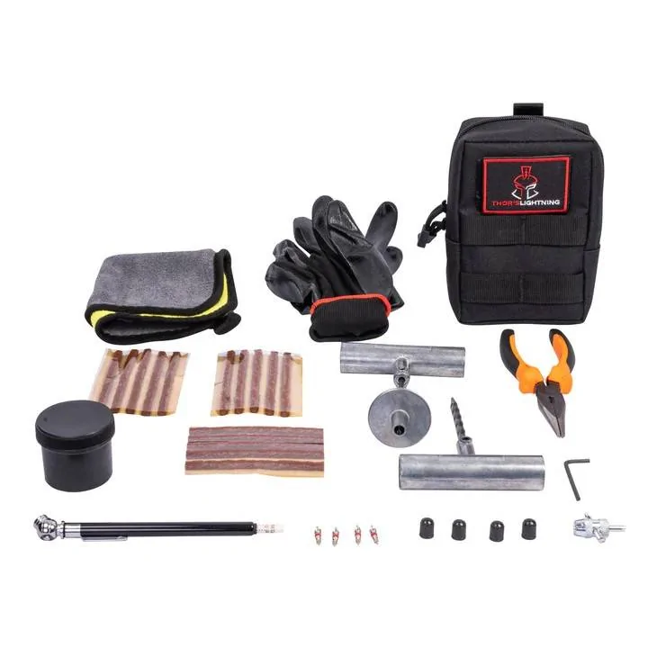

I have the Thor's Lightning kit.
Ford Bronco Self tire repair plug thors-lightning
