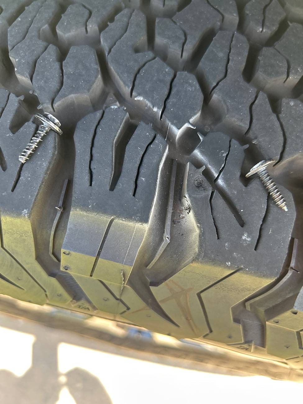

Thoughts on buying a kit from auto parts store. Never repaired tires myself. But very mechanically inclined. Looking more for opinions on these kits being safe good materials. I now have 2 screws. One on each vehicle. Figure I would save time and 50-70 bucks.

Worked. But what a sob to get plug into tire. Bent the t handle insertion tool. Teamed out the hole as instructed.

You are fighting with the air pressure. I deflated the tire - it was much easier and I have a twin ARB compressor underhood

I deflated it. Second tire isn’t leaking so not plugging it. Culprits.

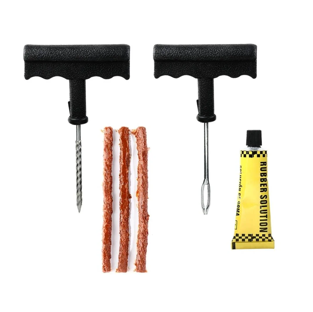

Be somewhat careful with "strip" plugs, they really aren't considered a permanent repair. I've had some last for just a few days, and some 5 years. But, these are very cost effective.
Ford Bronco Self tire repair plug Screenshot_20250410_133948_Firefox
"Mushroom" plugs are considered a more permanent repair, more cost up front but less long term hassle in my experience.
Ford Bronco Self tire repair plug Screenshot_20250410_133920_Firefox
Either way, both are extremely easy to use, especially on the trail.
