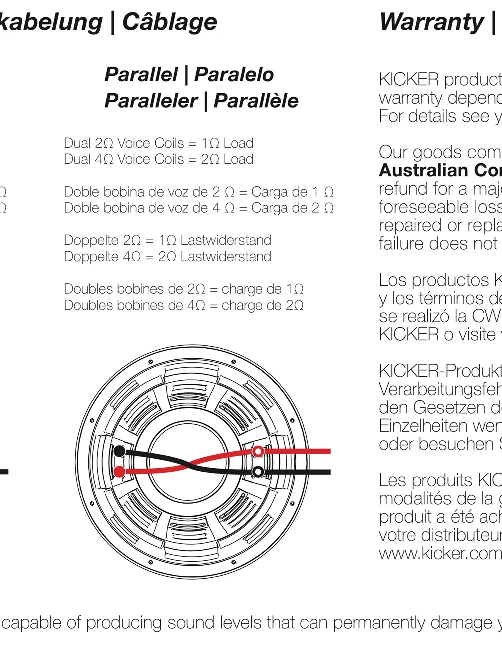

So I was checking out RagnarKon installation thread and YouTube channel last night and the one thing I did notice was he was using two wires for the positive and negative posts on the amp to the sub.
On the kicker Sun directions they show this
Ford Bronco Second Blown Subwoofer-What am I doing wrong? IMG_0280
could this be my problem? This the way I had it wired up with just a single line from each terminal on the amp.
I haven’t seen the Rag diagram, nor exactly how you have yours wired, but the Kicker diagram is ok provided you are using appropriate sized wire.
