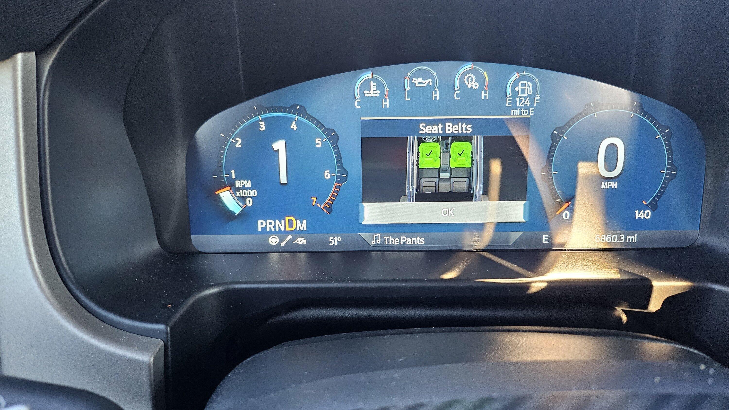

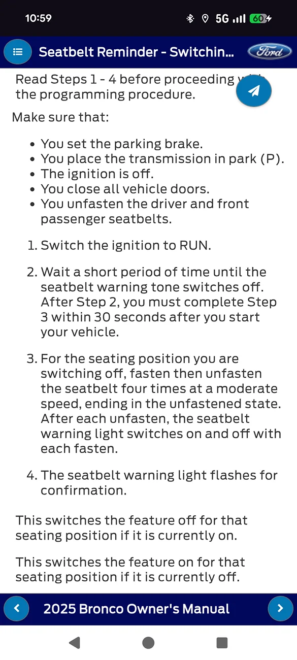

I found these instructions in the manual, and tried it twice, but it didn't work.
It worked for me, but it took a few times... because of step #2's "wait a short period of time until..." WTF is a "short period of time"?? I waited I think 5 seconds or so. Also, in #3 & #4 the "seatbelt warning light" is the little red dummy light, not the "ok" screen. The confirmation that it worked was the little red dummy light (#4) flashing rapidly 3 times. Then it is the same process to re-enable it if a person wanted to.

We’re talking about 2 things here. This hack does eliminate the chime, which in the past required forescan. However, unless I missed something, it does not eliminate the little 1 min infotainment message unless u press the ok button.
