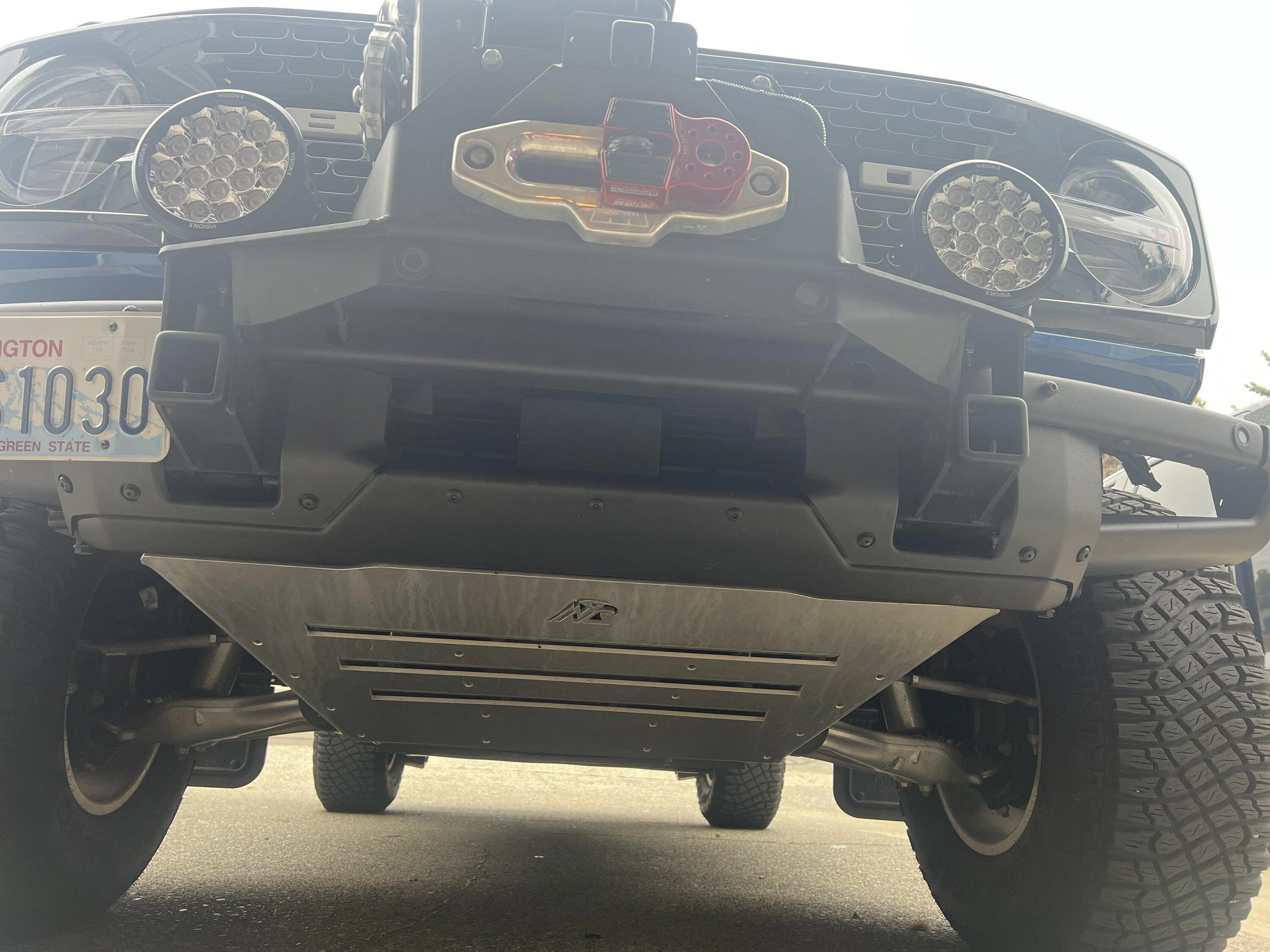

I am also looking at Metalcloak. That gold is bada$$!!!!!
My boss has them on his JL, The diff skids started rusting before he went wheeling. In their defense we do live in the Pacific Northwest
UGH!! Bummer. Thanks for the info. Talons Garage it is.

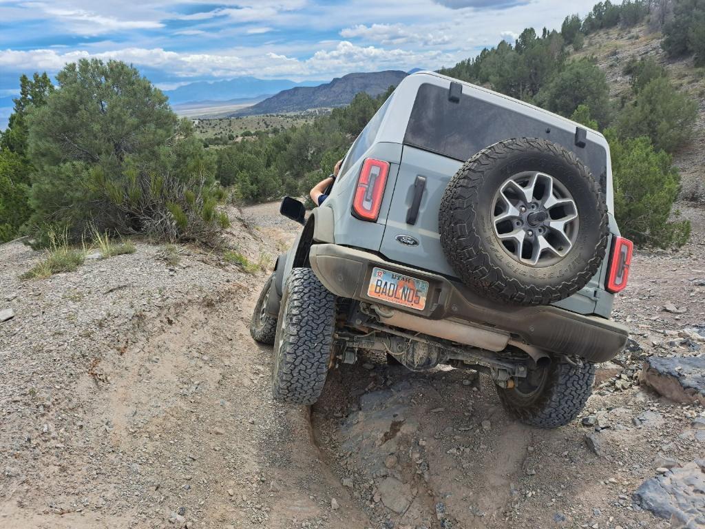

Ground clearance matters most. I have never contacted anything on NPS/NFS-style roads. The only time we've impacted is when doing difficult trails. The reality is that unless/until you do trails with significant obstacles, the skid plates are just mental peace of mind.
That said, I would start at the gas tank and transmission. But keep in mind that driving technique can get you over a lot of substantial obstacles without contact.
Over 20 degrees roll, 18+ pitch, coming down a rock ledge on three wheels and no contact with any object:
By far my biggest problems with hitting obstacles were with vehicles that didn't have great ground clearance. The S-10 I mentioned earlier had a frame 10" off the ground and a body 13" off the ground. On one stretch of USFS jeep trail that was filled with small loose boulders I really used those skidplates. Ditto on a NPS trail at Glen Canyon.
Since I got my T100 (which has the transfer case skidplate 13" off the ground and everything else higher except near the axles) I've had very few contacts with obstacles, though I did bend a nerf bar from underneath.
Of course skill and good judgment usually make the biggest difference, but there's always the chance of the unexpected happening.
