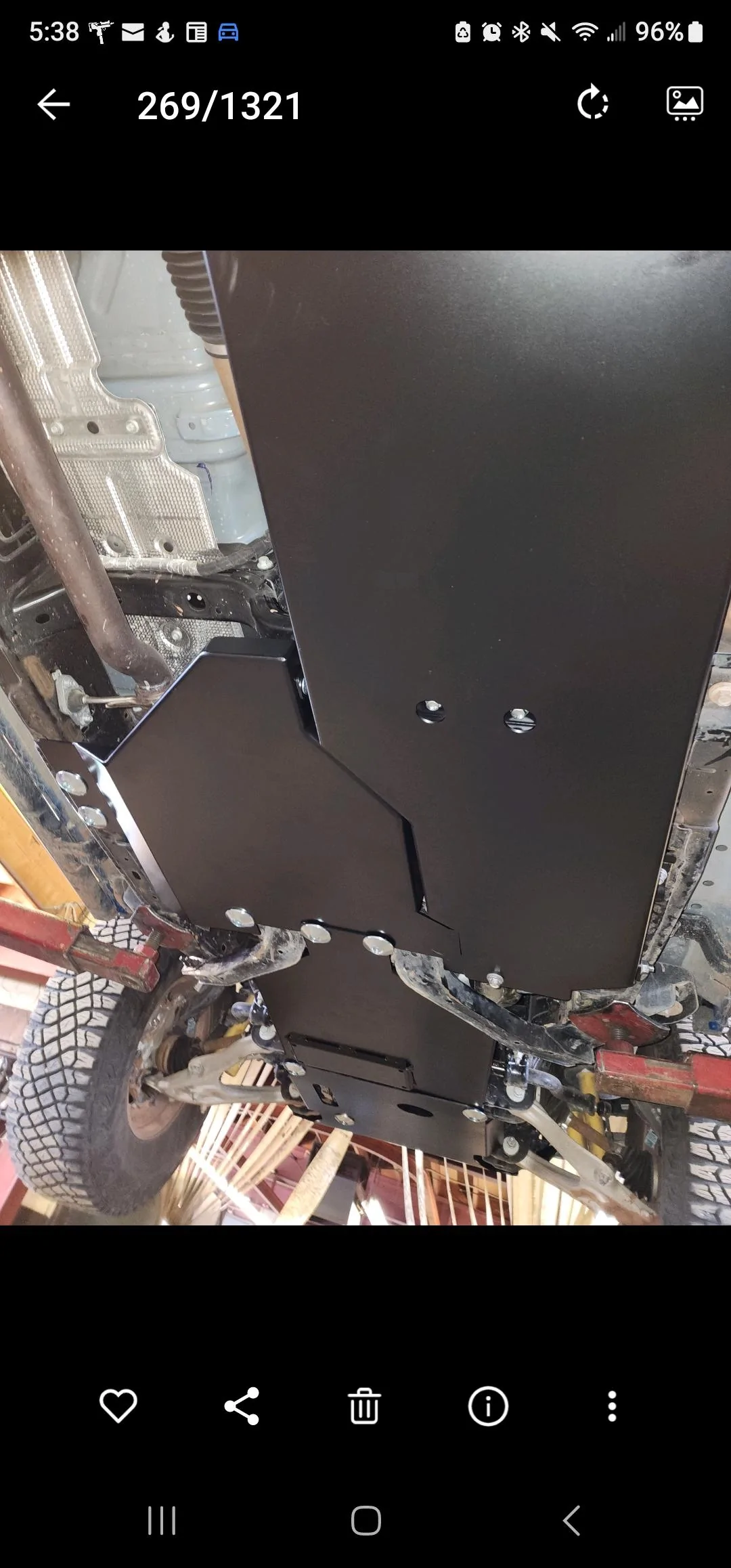

I wanted a smooth surface skid that covered the control arms and gas tank. The area that seems to catch the most. I went with steel belly pan skids from Rock Hard since I like to go on rocky trails in the Rockies. 😂
Ford Bronco School me on skidplates IMG_3989

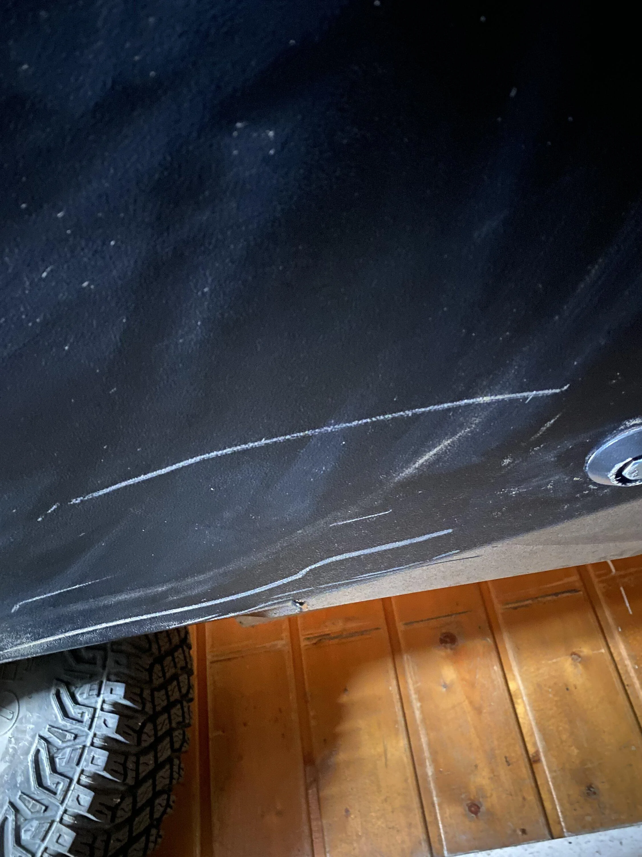

Squashed

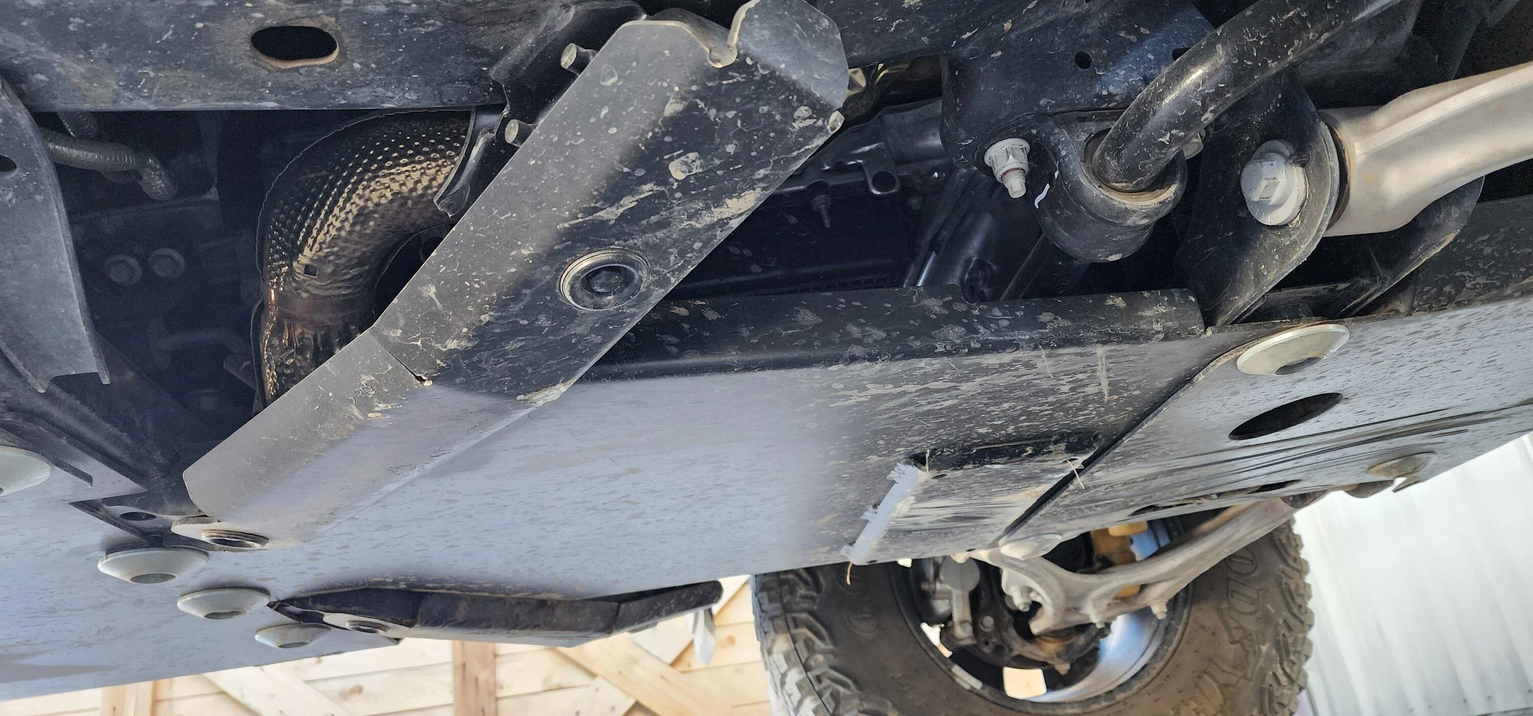

Asfir transmission bracket guards are steel also

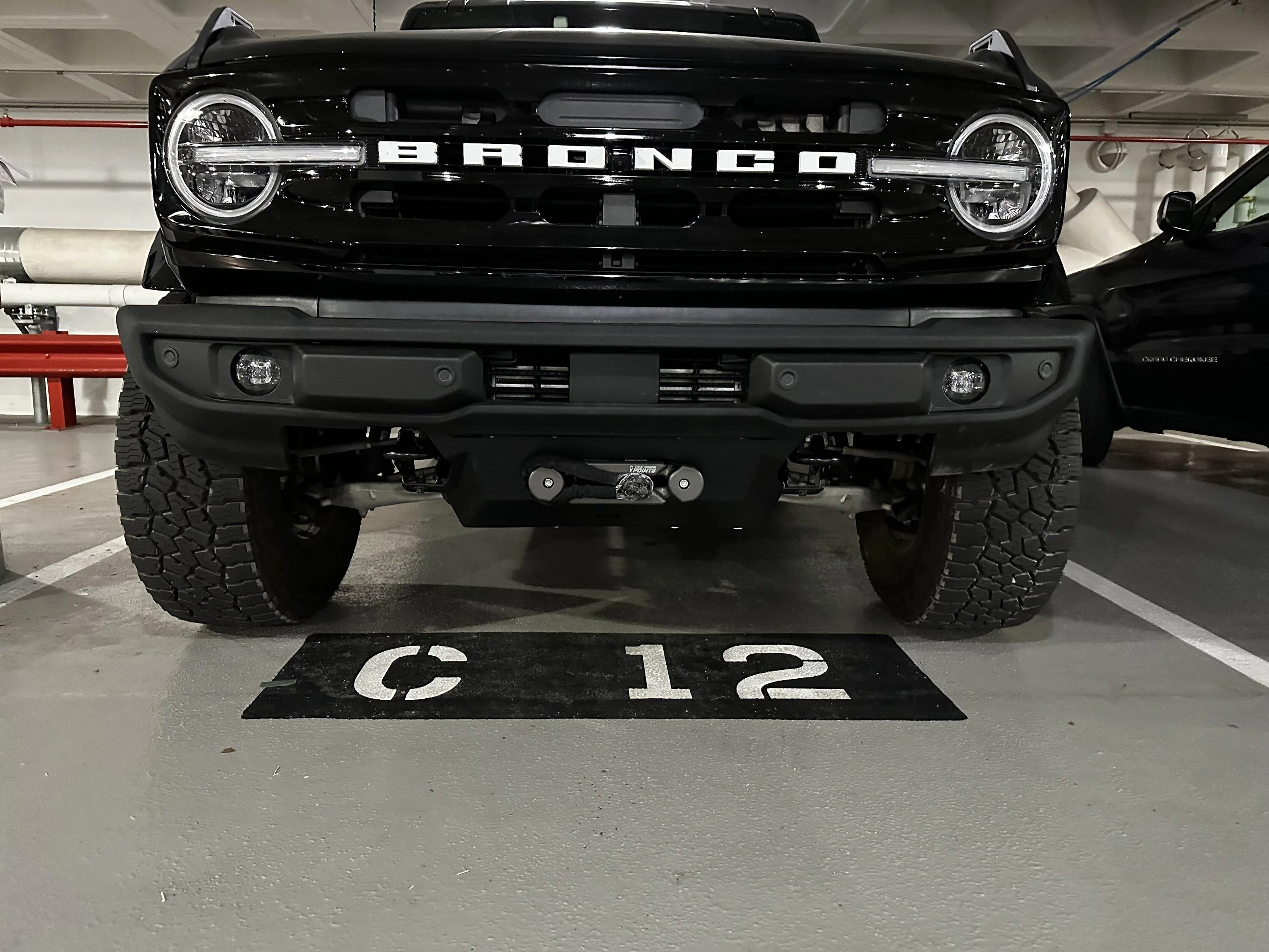

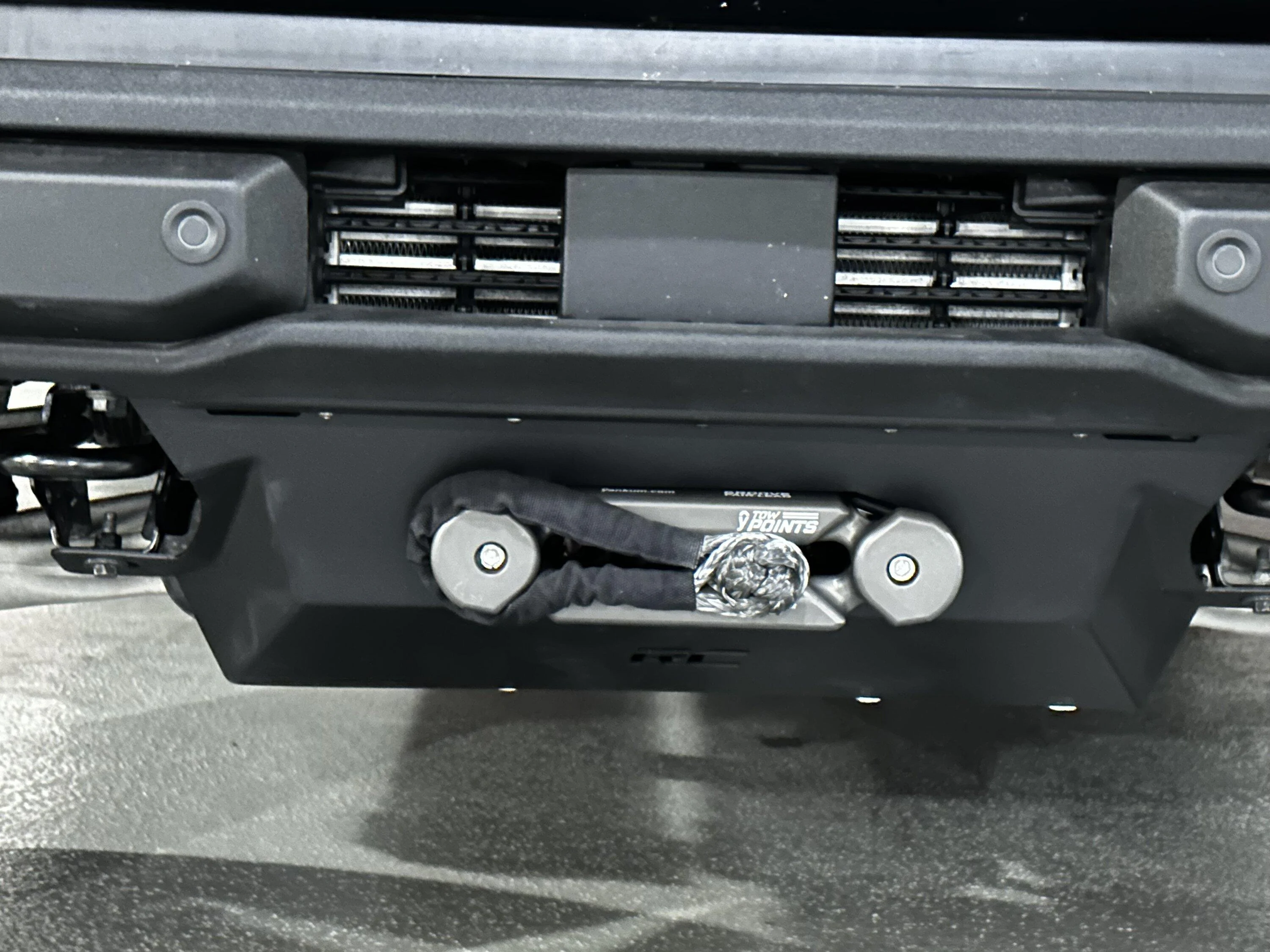

I started pricing some of this out and realized along the way that this is going to be a hurdle. I’ll try to snap a pic of the underside of my hidden winch mount for you guys, but any recs here would be helpful.
I’ve got some time. We’ve pretty much mapped out our big trips this year, and the only one that I’ve been told absolutely needs skids will be The Pilgrimage in VT in October. So plenty of time to try to figure out what works, but trying to plan ahead a bit.
