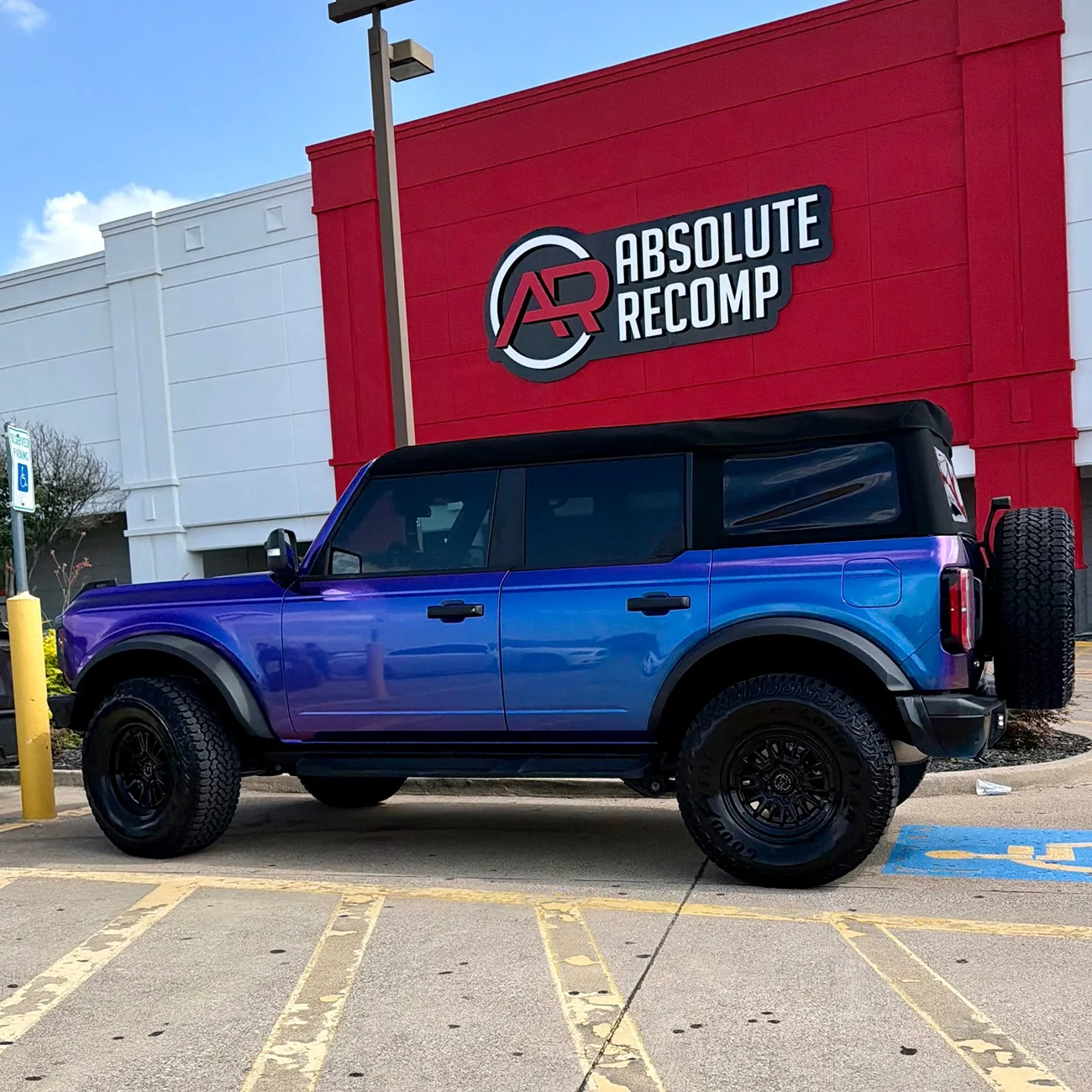

So I just recently jumped into the off-road world and seeing a lot of different information on what is needed to run 37's.
I have a 2025 Badlands SAS that has aftermarket wheels but are the same as stocks except for the 0 offset. I want to run coil overs and get a 2.5" or 3" lift (the shorter the better due to garage and parking garage heights) to run the larger tires. Can I just get the Fox 2.5 Performance Series shocks and Icon UCA'S? Would that be enough clearance for no rubbing and still good Offroad performance? I was also told about a JKS max tire clearance kit, is that also necessary?

Yes, that should likely do nicely. The max tire jut will give you the clearance and since the coilovers are adjustable, you can set the height.

The JKS Max Clearance kit will definitely be necessary if you really want to clear obstacles without the rubbing. Once you install 37s, your confidence will increase but you want to make sure you your Bronco is ready to match that confidence. Also, for the price of the Fox 2.5 suspension, I would take a look at the Dobinson's MRRs. They are slightly cheaper but offer more adjustability and less maintenance.
