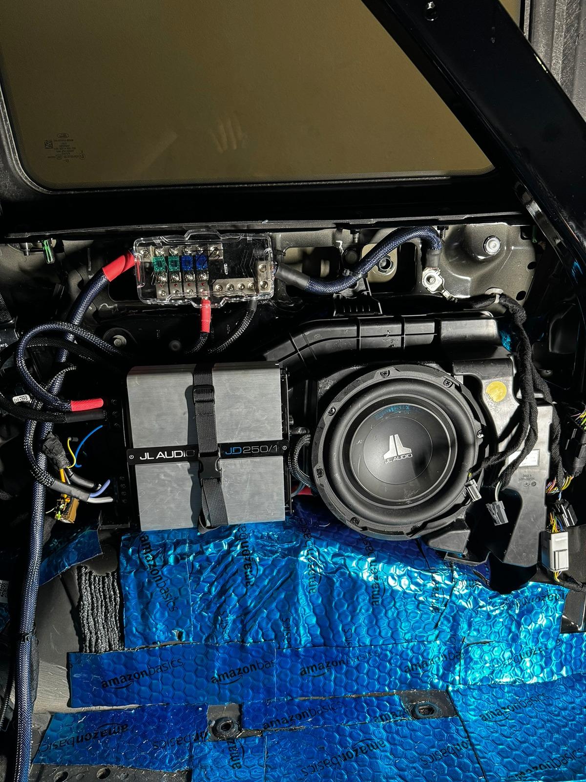

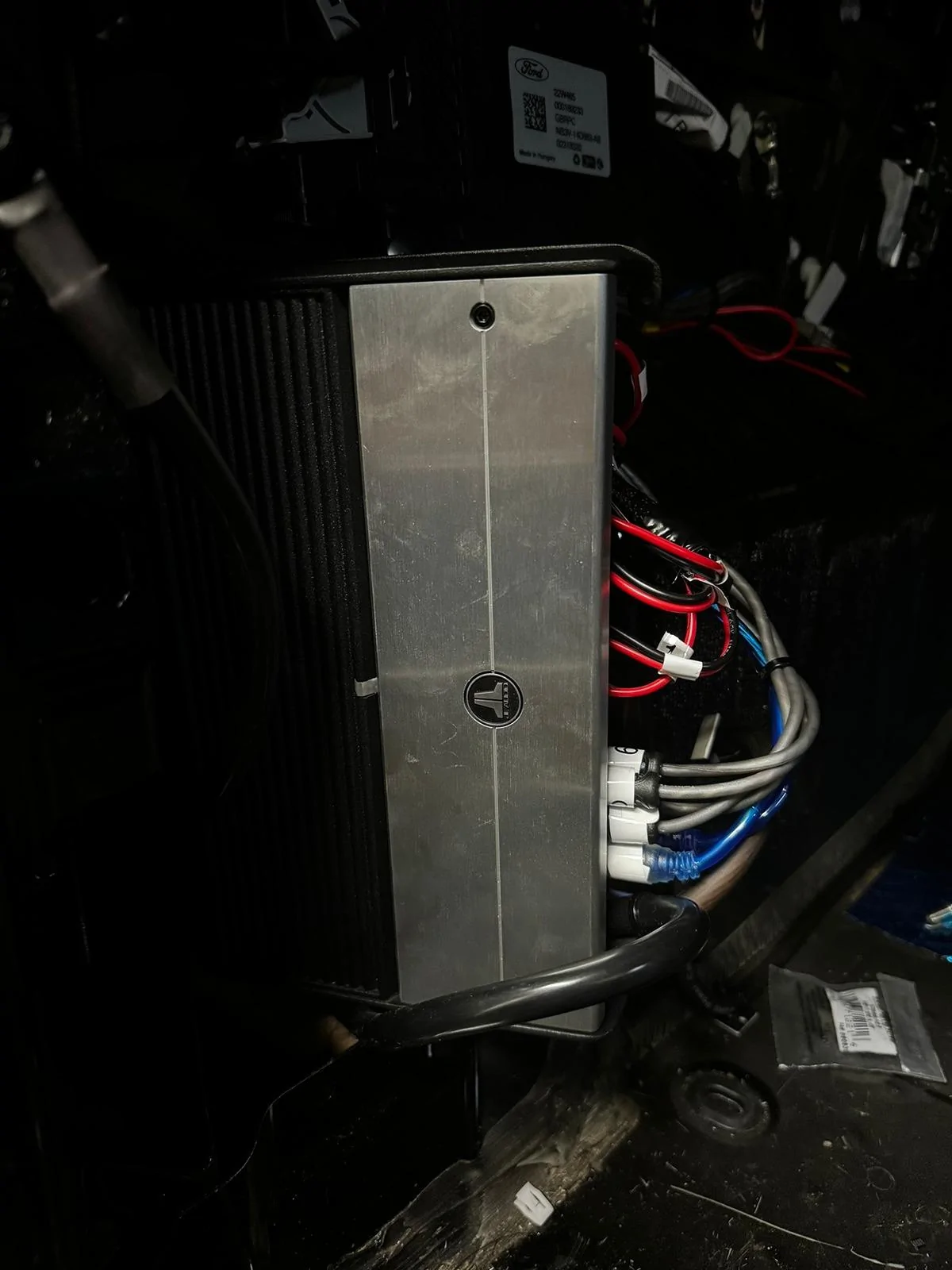

- JL Audio XDM600/6
- JL Audio C1-650se Componets (components with tweeters in dash and drivers in kicks are the money as many have indicated)
- JL Audio C1-650x Coaxils For the rears and Mabbet enclosures to fit them
- JL Audio JD250/1 Subwoofer amp
- JL Audio 8W1v3-4 Subwoofer in the stock enclosure with some trimming

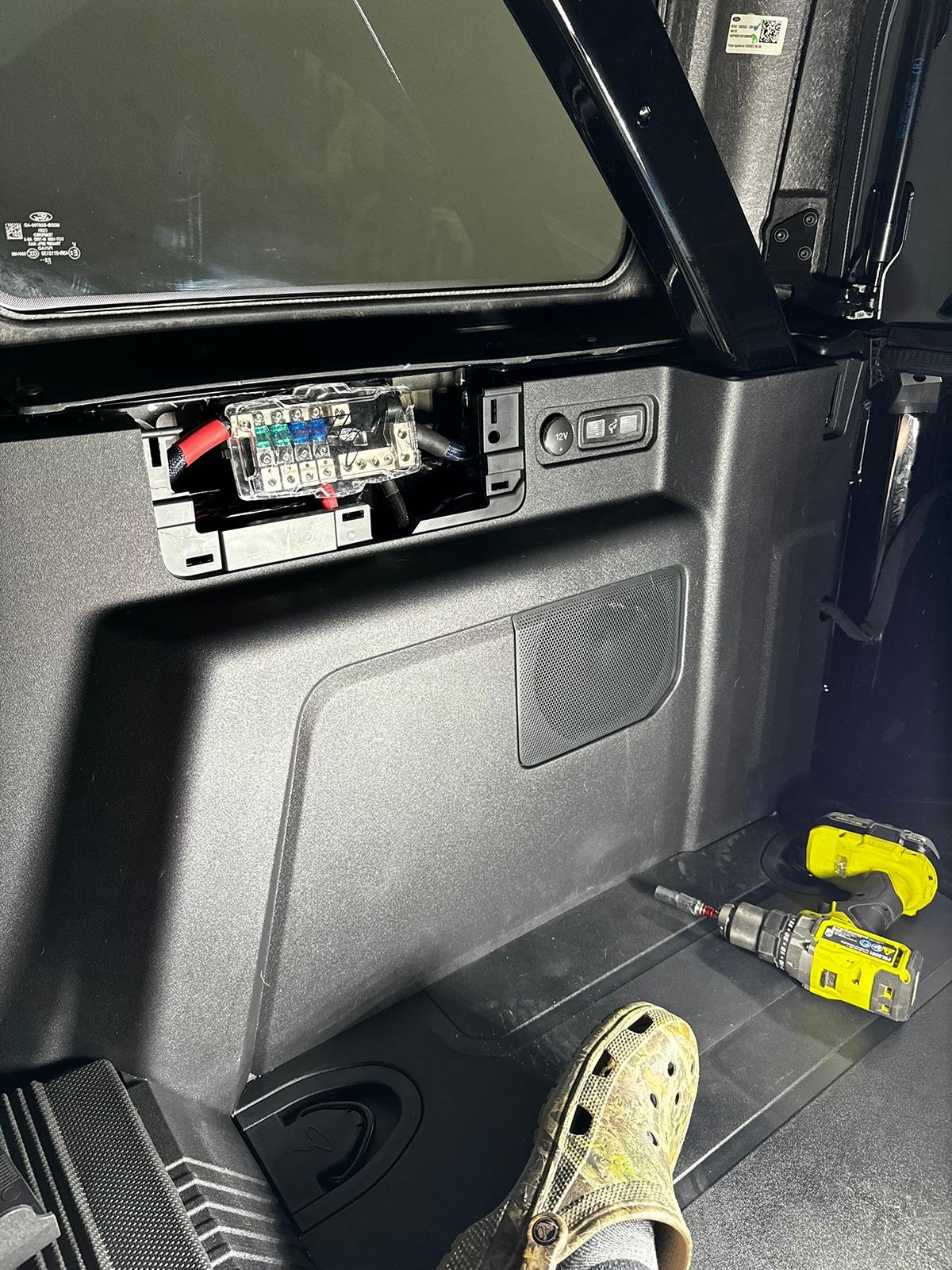

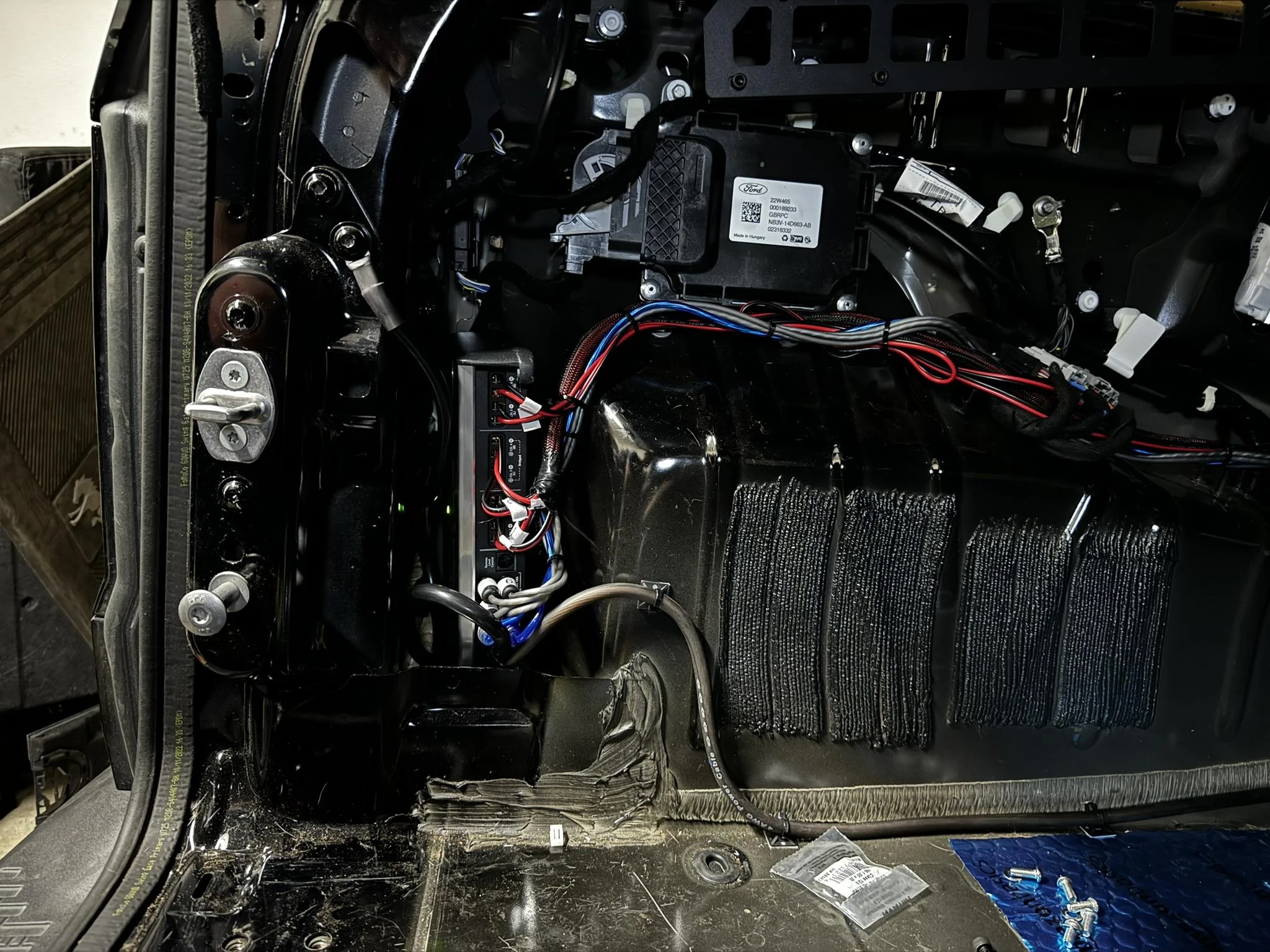

- Ran Aux/all new speaker cables back to the Amps while I was bringing power back
- Since I was running it, went ahead and did 0 gauge wiring kit and a distribution block strategically mounted behind the passenger side access panel in the cargo area for easy access/future accessory power. At $70 the 0 gauge kit is a STELLAR deal.

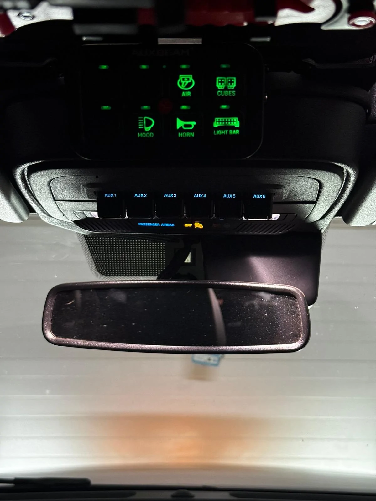

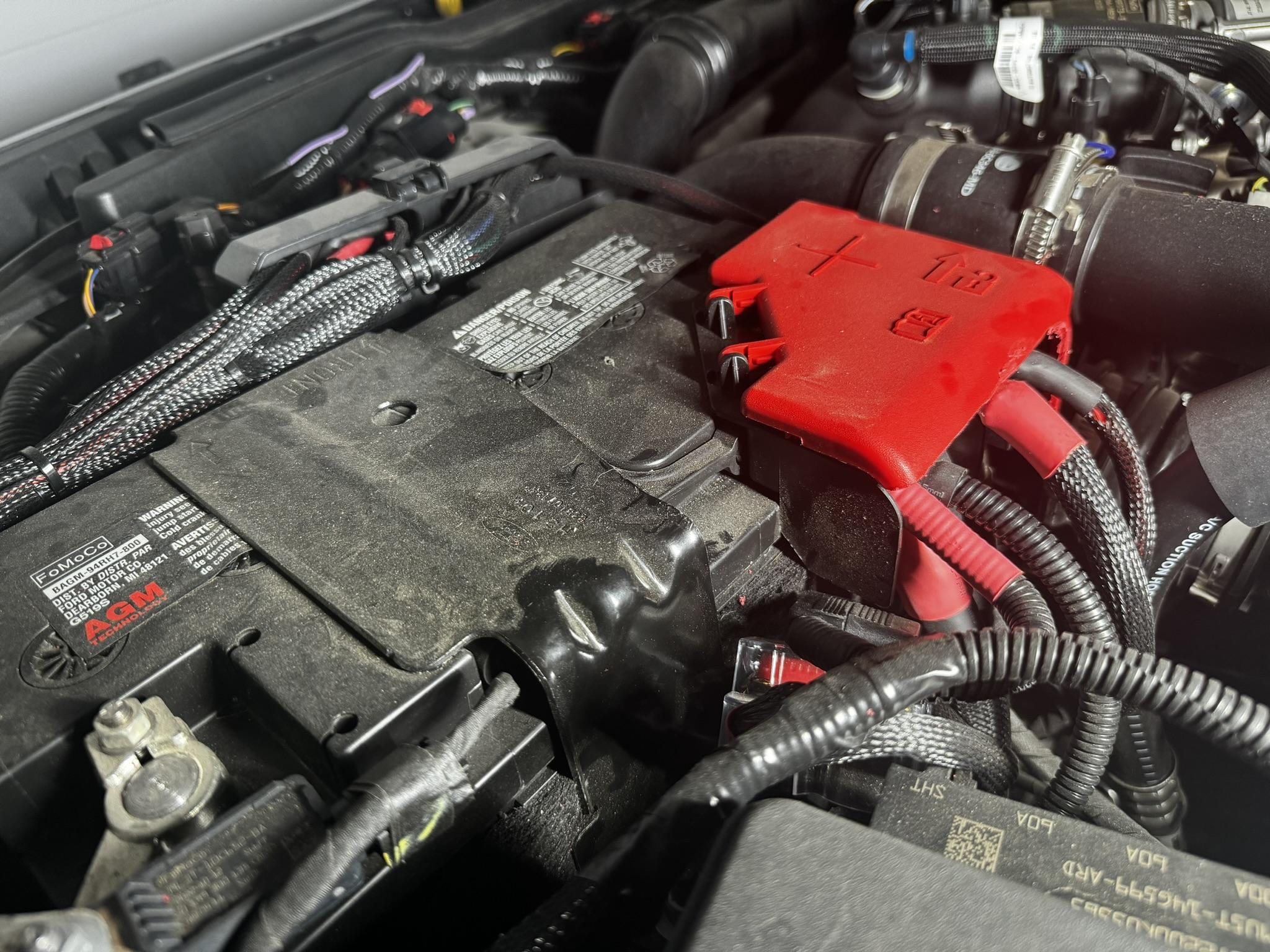

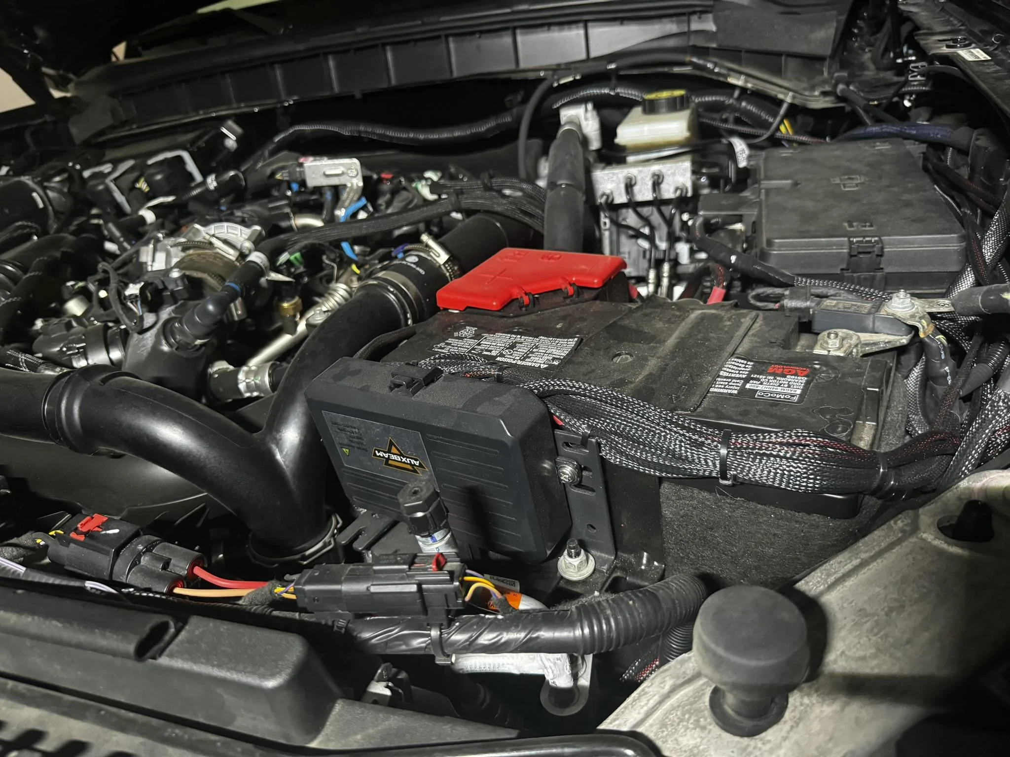

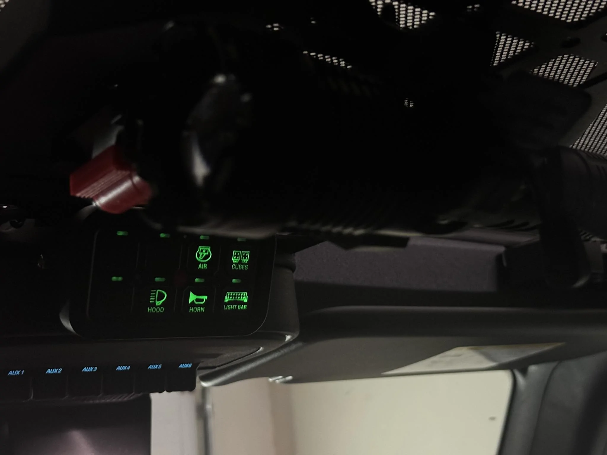

Despite having upfitter switches, I put an eight switch auxbeam in as well knowing the upfitters would run out quickly. Some under hood wiring shots. I've used cable sleeve and heat shrink on everything. All connections are waterproof & soldered using these awesome connectors.
Ford Bronco Rusty Shackleford's 2023 Badlands Build IMG_0820
Ford Bronco Rusty Shackleford's 2023 Badlands Build IMG_0859
y
the included bracket worked great to mount to the battery:
Ford Bronco Rusty Shackleford's 2023 Badlands Build IMG_0822
Trimmed the back of the terminal cover to accommodate wires:
Ford Bronco Rusty Shackleford's 2023 Badlands Build IMG_0824

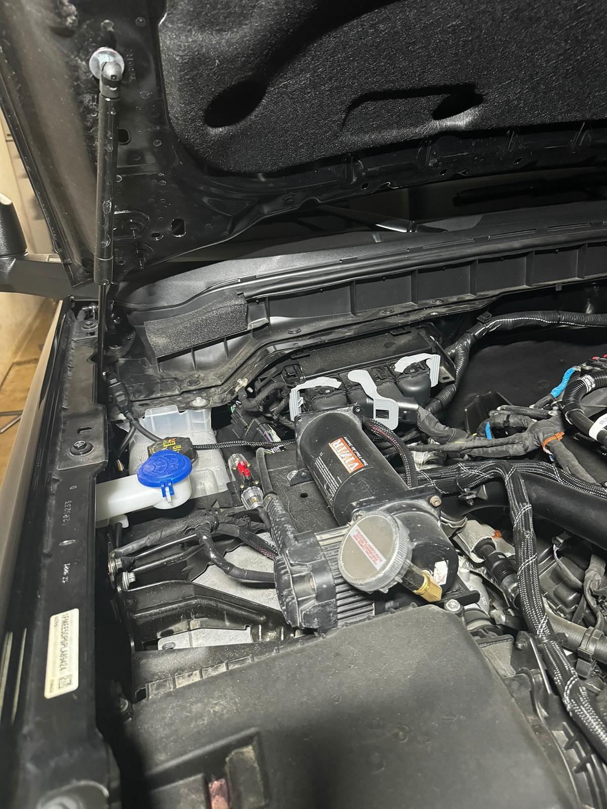

Viar Compressor mounted under hood. The Compressor switches on if pressure switch on the air tank detects less than 150 PSI only IF I have the respective Auxbeam switch on:
Ford Bronco Rusty Shackleford's 2023 Badlands Build IMG_0825

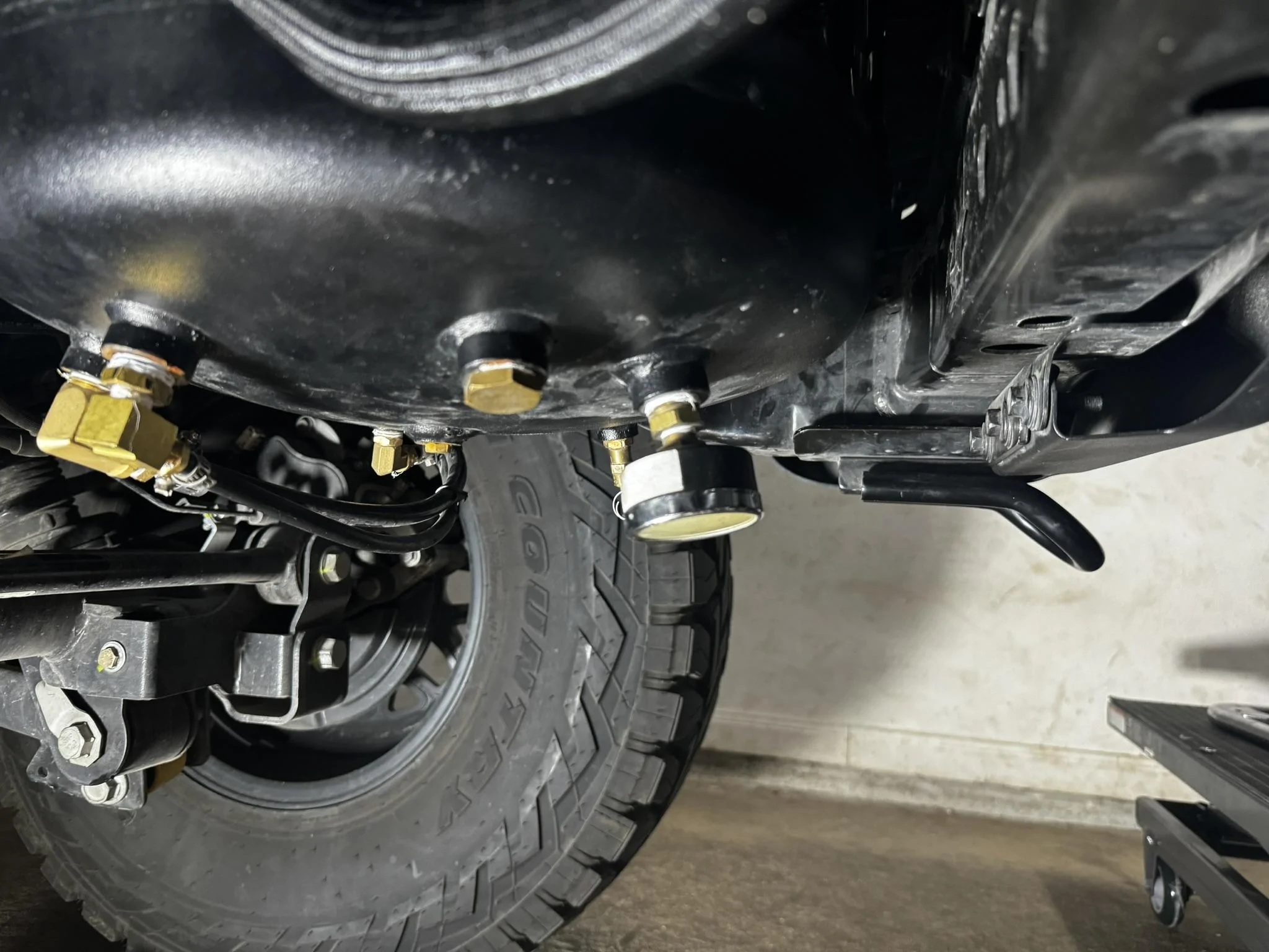

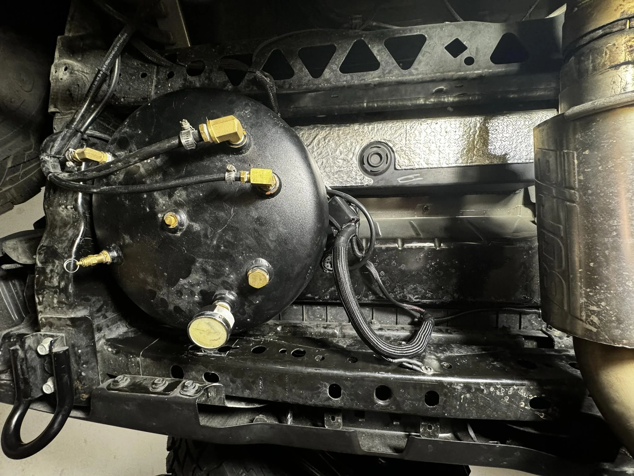

4 Gallon Pancake tank from horn blasters. 5 gallon that came with the kit was slightly too tall. Snapped the pic before reinstalling heat shield, and don't mind the pressure gauge, needed something to plug that port :)
Ford Bronco Rusty Shackleford's 2023 Badlands Build IMG_0848
Notably, the tank and muffler extend slightly below the bumper, maybe 1/2-3/4". But still less than the ridiculous stock muffler, so not a concern in that regard:
Ford Bronco Rusty Shackleford's 2023 Badlands Build IMG_0850

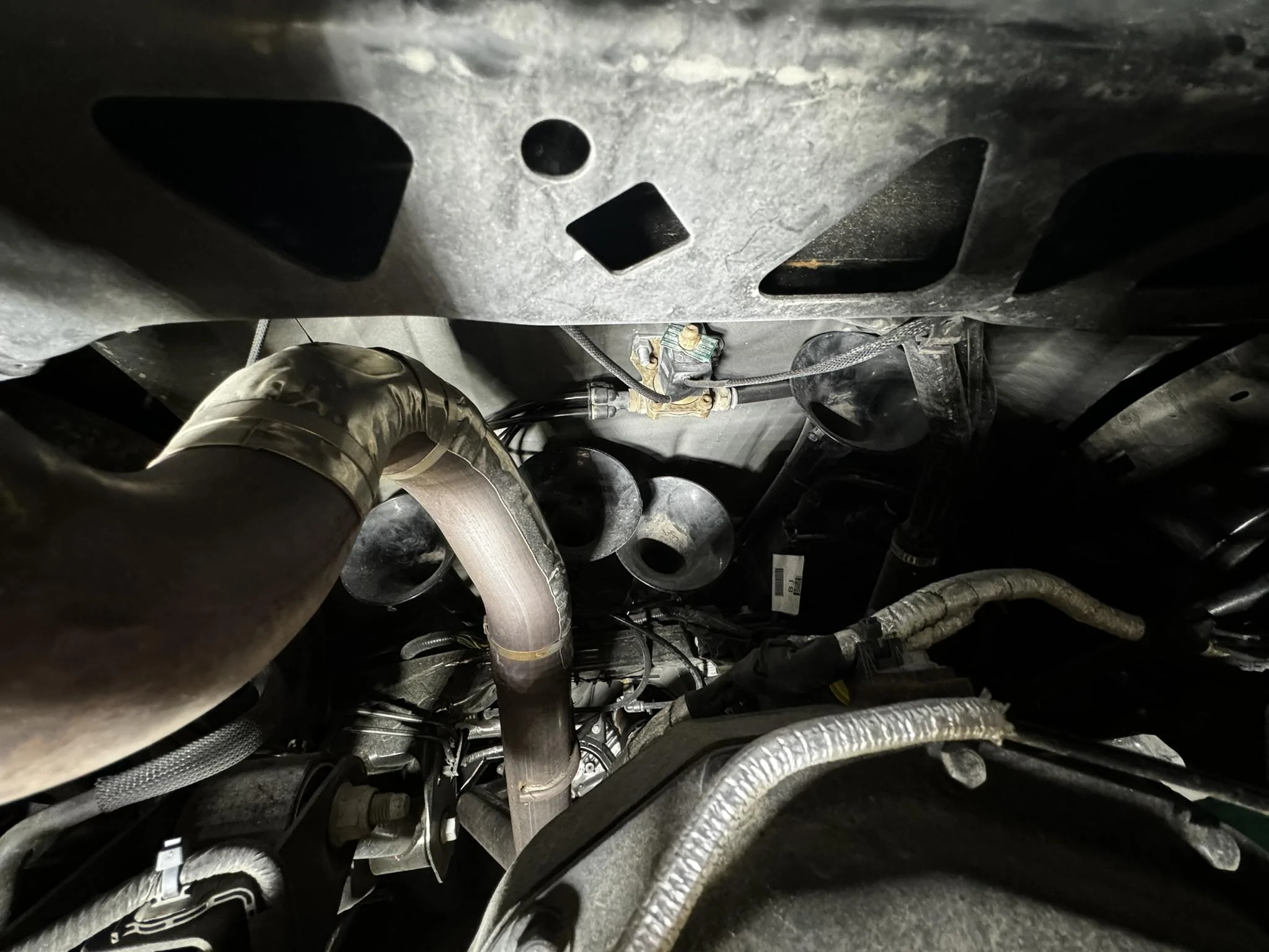

One line goes to the air valve that controls flow to the four horns (picture taken from rear of truck looking forward, just past the axle there's tons of space:
Ford Bronco Rusty Shackleford's 2023 Badlands Build IMG_0839

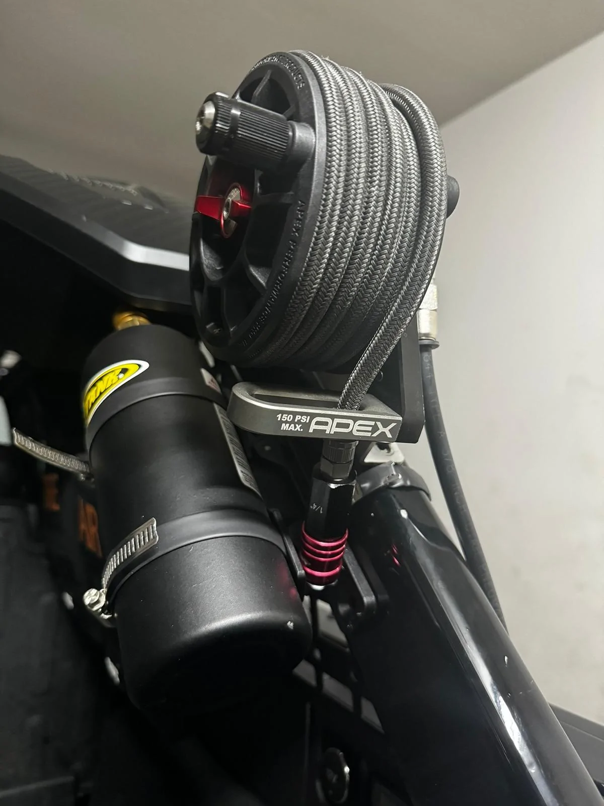

The other line goes up in the cargo area to the Apex CRS, where I have a high flo female QD:
Ford Bronco Rusty Shackleford's 2023 Badlands Build IMG_0840

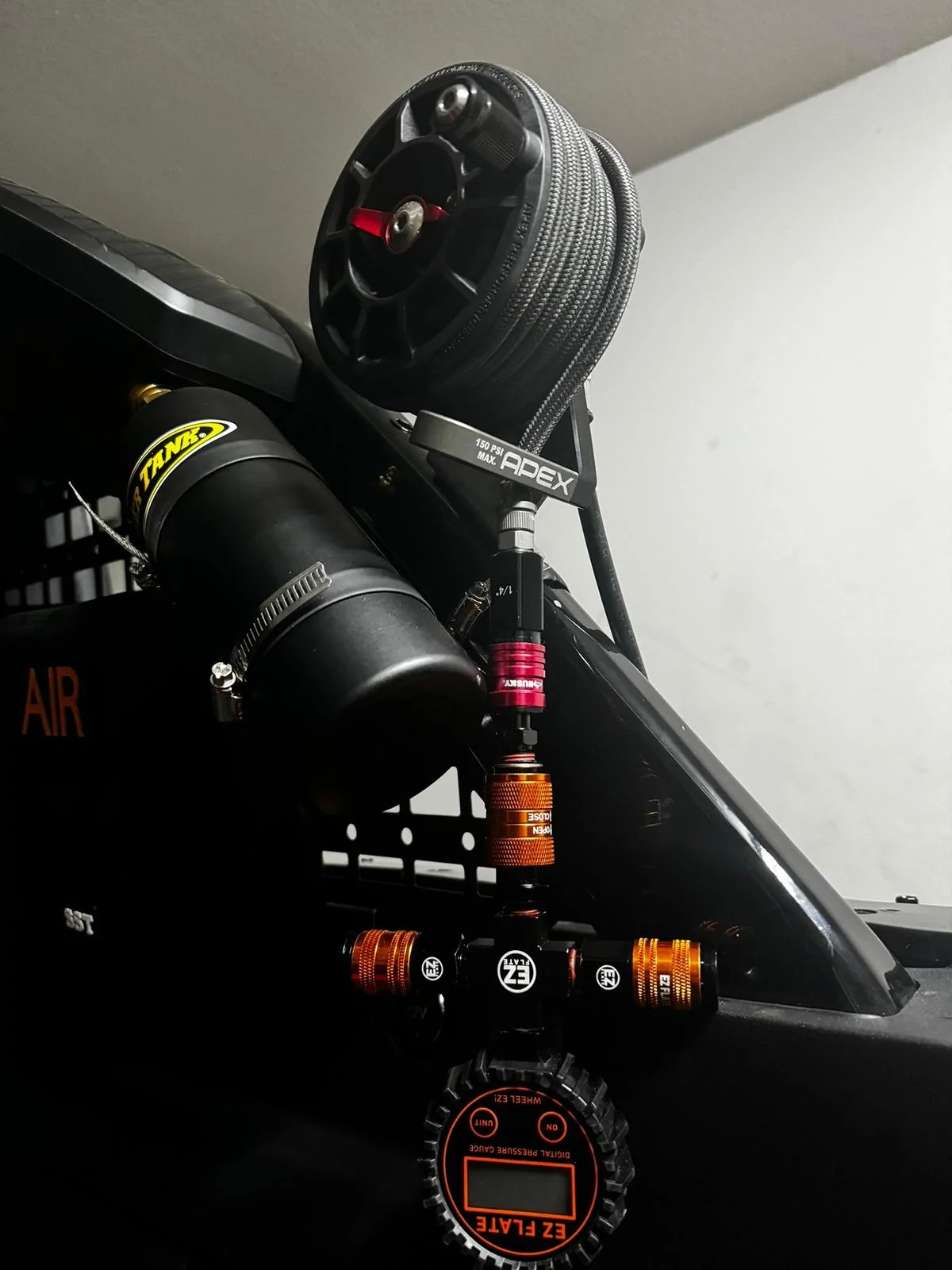

QD makes it easy to plug in the EZ Flate system, amongst other things:
Ford Bronco Rusty Shackleford's 2023 Badlands Build IMG_0841

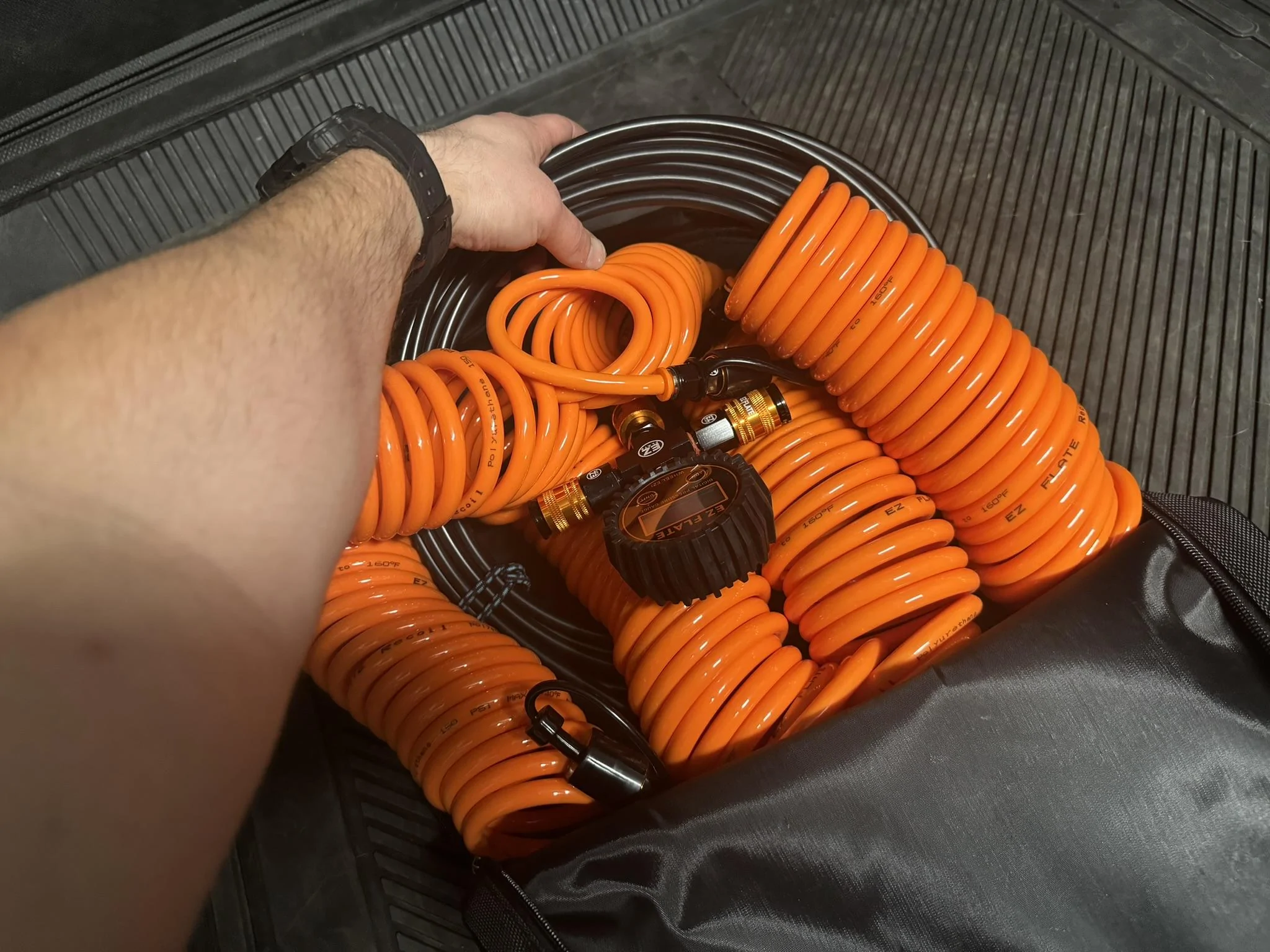

In the EZ FLATE bag I keep a reel of spare DOT approved air line should the need arise to repair in the field. I have fittings and couplers, hose clamps, etc. in the MOLLE bags:
Ford Bronco Rusty Shackleford's 2023 Badlands Build IMG_0842
