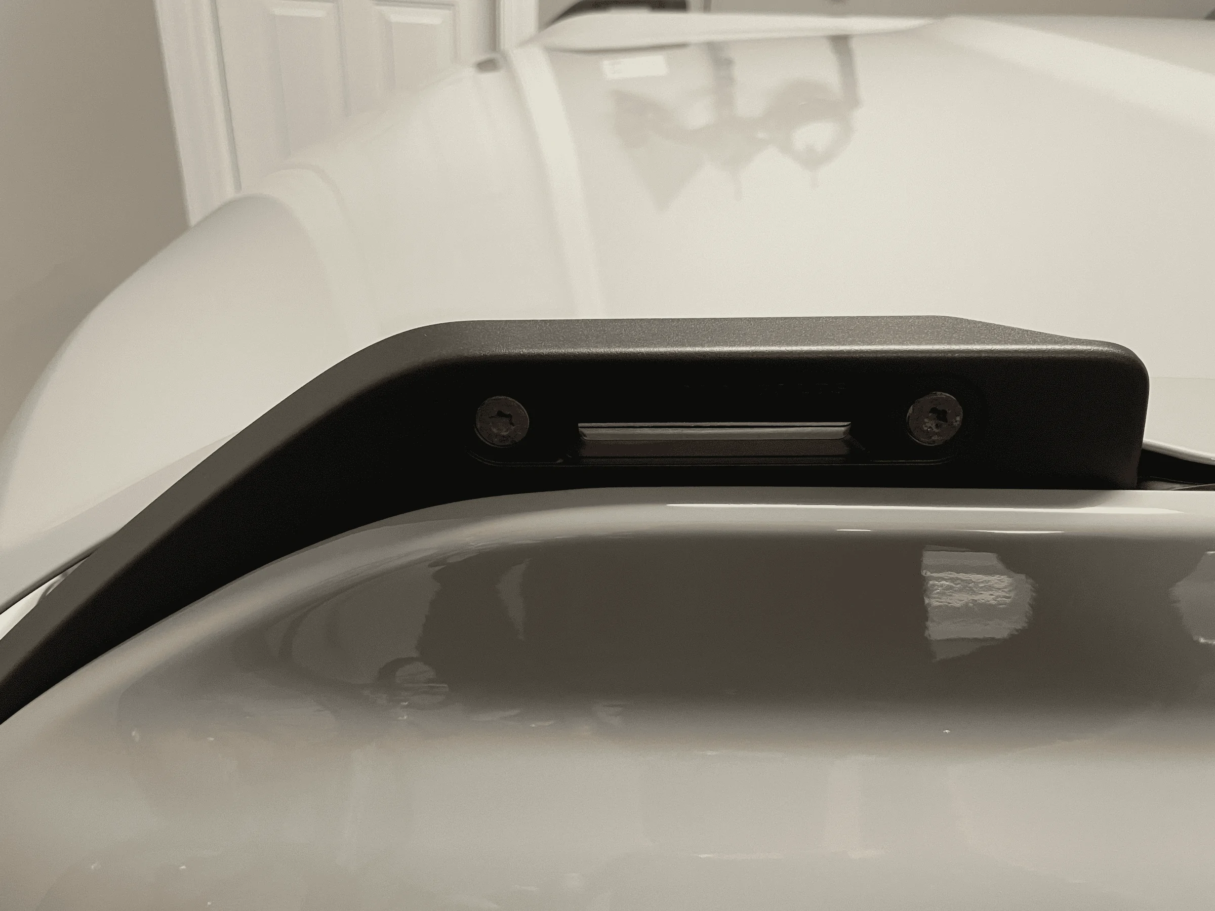

Passenger side only, on the outer hex bolts here as well. Plan to take them out and coat them myself.

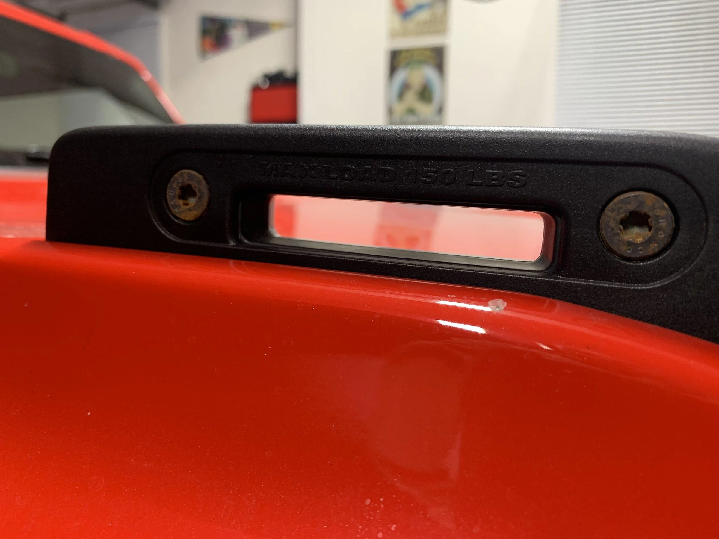

Took delivery of my badlands yesterday and noticed some rust already on the screws on the front tie downs. Anyone else have this happen? Any suggestions beside soaking them in vinegar?

Thanks. Sounds like a bad batch of bolts. Any easier source to replace them then filing a warranty claim?

Looking for help. Love the new Bronco but I noticed that two of my trail site bolts already show surface rust (a week old). Anybody know the part number OR a better/upgraded version that might be available? Seems a bit silly I know, but dont want the rust to drip onto the paint. Thanks.
This is a nice DIY project . . . I never assume a new release car or boat is perfect. You can remove the fasteners, buff them out with a non-metalic steel wool, spray several coats of a clearcoat, and reinstall. If you don't like the natural metal color, paint with several light coats of rusteoleum black, maybe a clearcoat and reinstall. Or have even more fun: paint them body color. Here in SC, Parks Auto Parts will mix up a can of any Ford paint color for $26. The clearcoat is in the paint.
When I was a boater, occasionally there'd be stainless fasteners that were not up to spec, slipped through the system or came from a cheap source from a manufacturer cutting corners. There are several grades of stainless, I've had boats I replaced fasteners on. In the Bronco case, its probably a supply chain issue.
FINALLY, if the Trailsite is made of aluminum, there will be a built in electrolysis issue with those steel fasteners, which are the less "noble" metal. Paint or clearcoat will help that, too, providing a barrier between metals.
