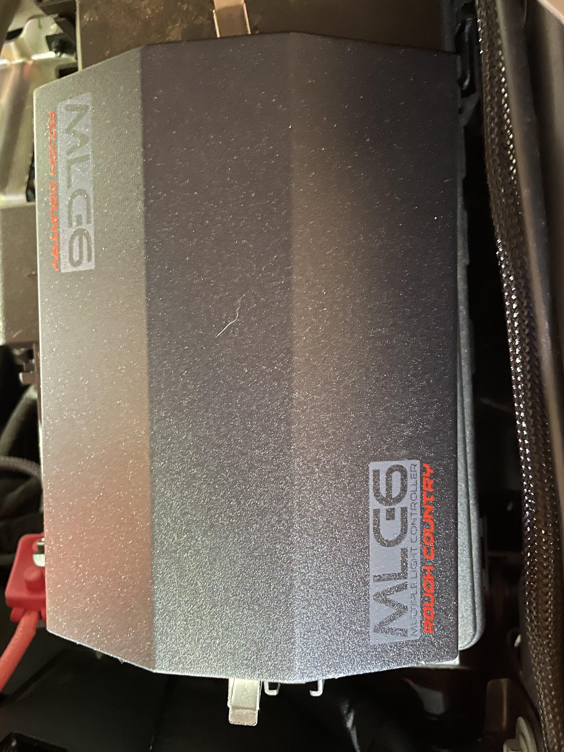

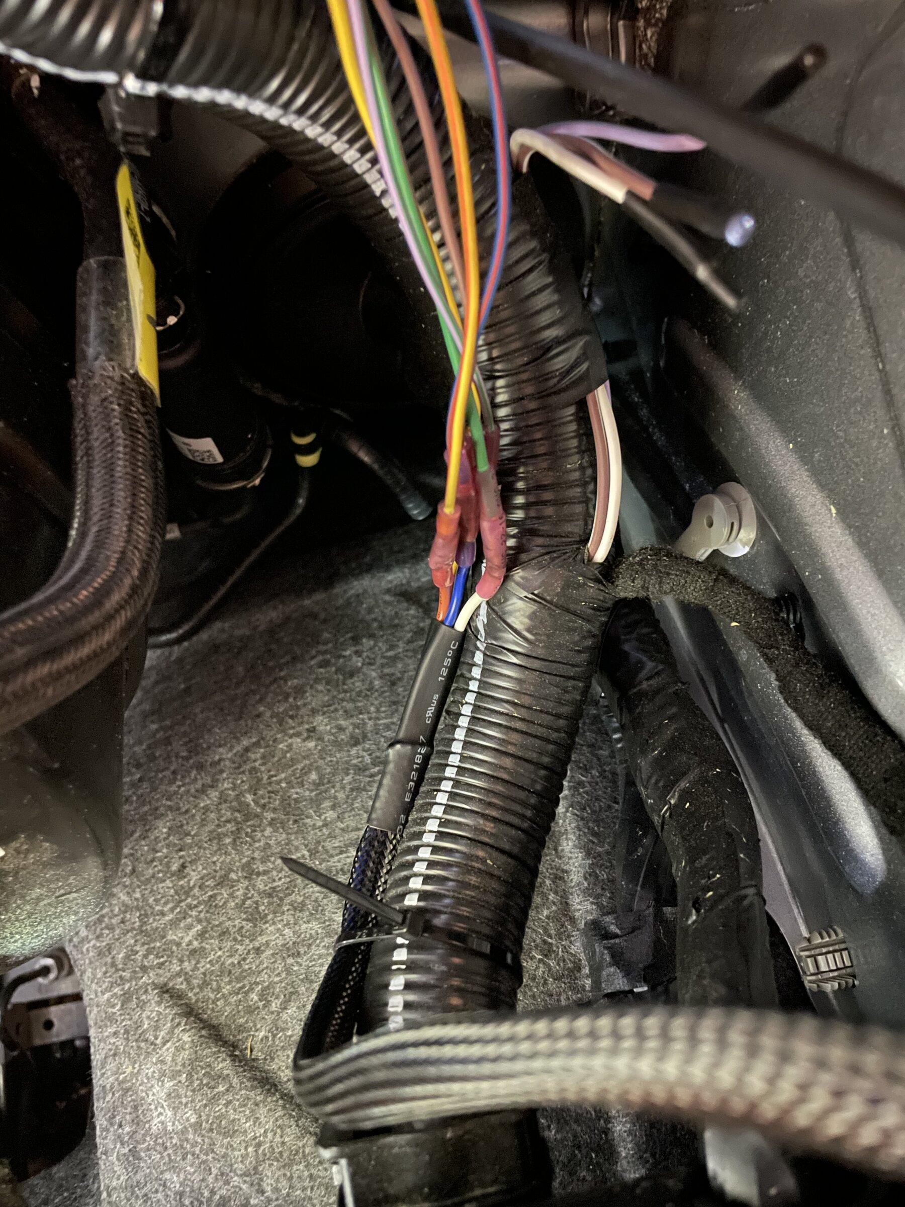

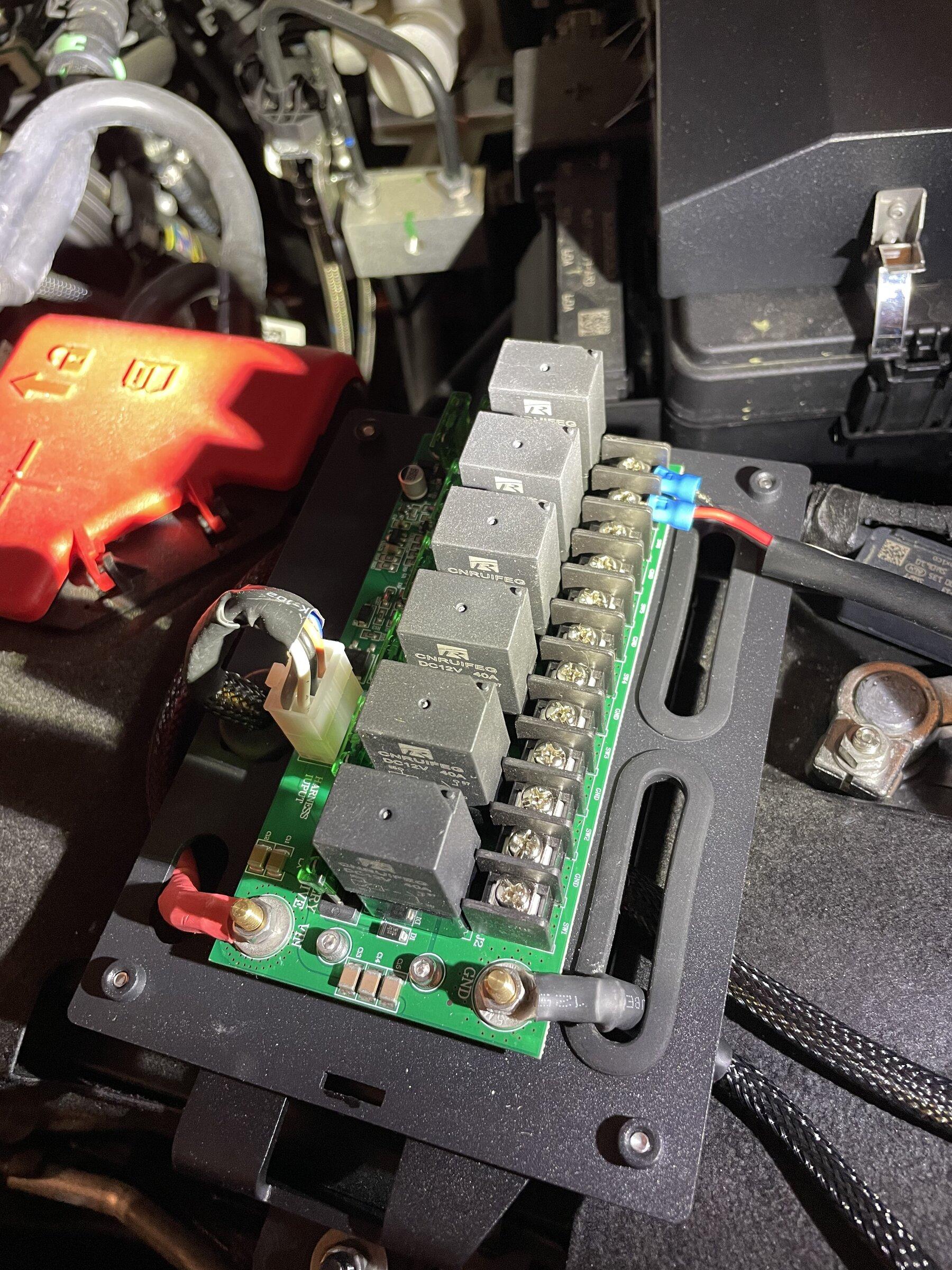

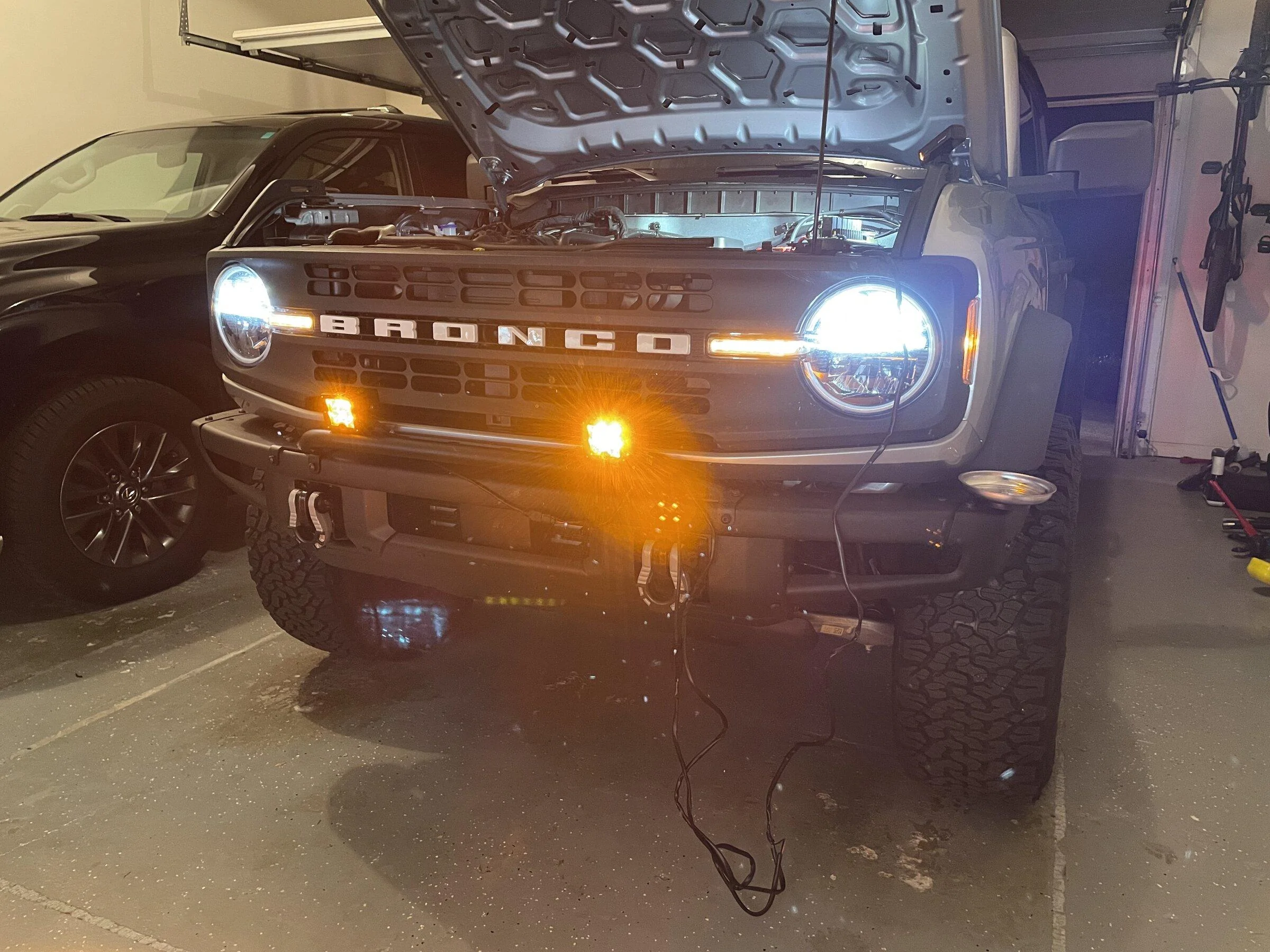

Hadn’t seen anything on the forum about this do I thought I’d post. DISCLAIMER I’m not an electrician and have never done any of this before. Was trying to figure out how to install some uses for my Aux switches myself, and came across this solution that’s made for 2021-2022 broncos. This multiple light controller installs over the battery using existing hardware and wires directly to the Aux pigtailed wires at the firewall. I just attach ground and power to the terminals on the switch - I can remove all relays and fuses in the harness for the lights and make it a really clean installation. Just testing in the photos (4 more lights coming in for the light bar on the bumper). Will post the final installation with all the wires tucked away. Pretty cool solution, I think.

This unit would be great for anyone running multiple higher amp accessories (30amps per switch, 50amp max simultaneously) compared to the lower amp ratings of the upfutters themselves.
As far as multiple light controller... I don't see the benefit. If you needed multiple lights on one switch, that's an easy splice. If you needed multiple lights on one switch that exceed the amp rating of that switch, a $5 relay would be the ticket.

I know this thread is a little dated, but I recently installed a MLC-6 in my bronco and noticed that it does not clear the hood/hood liner, causing the side of the hood to remain open about 1/4” higher than the other and is not resting against the seal. Has anyone that installed this product observed the same thing? I am not about to cut out the liner (not even sure that it would be sufficient anyways). Thank you.
