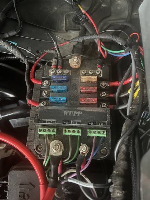

Got that WUUP relay box set up. I reckon 25amps should be sufficient for any lights I’ll add. A compressor or winch will need to be on its own relay anyways. I just drilled out some holes on the battery tie down..cut some bolts down shorter and that’s really it. I’ll clean up the wiring a bit more but I ran out of sunlight.

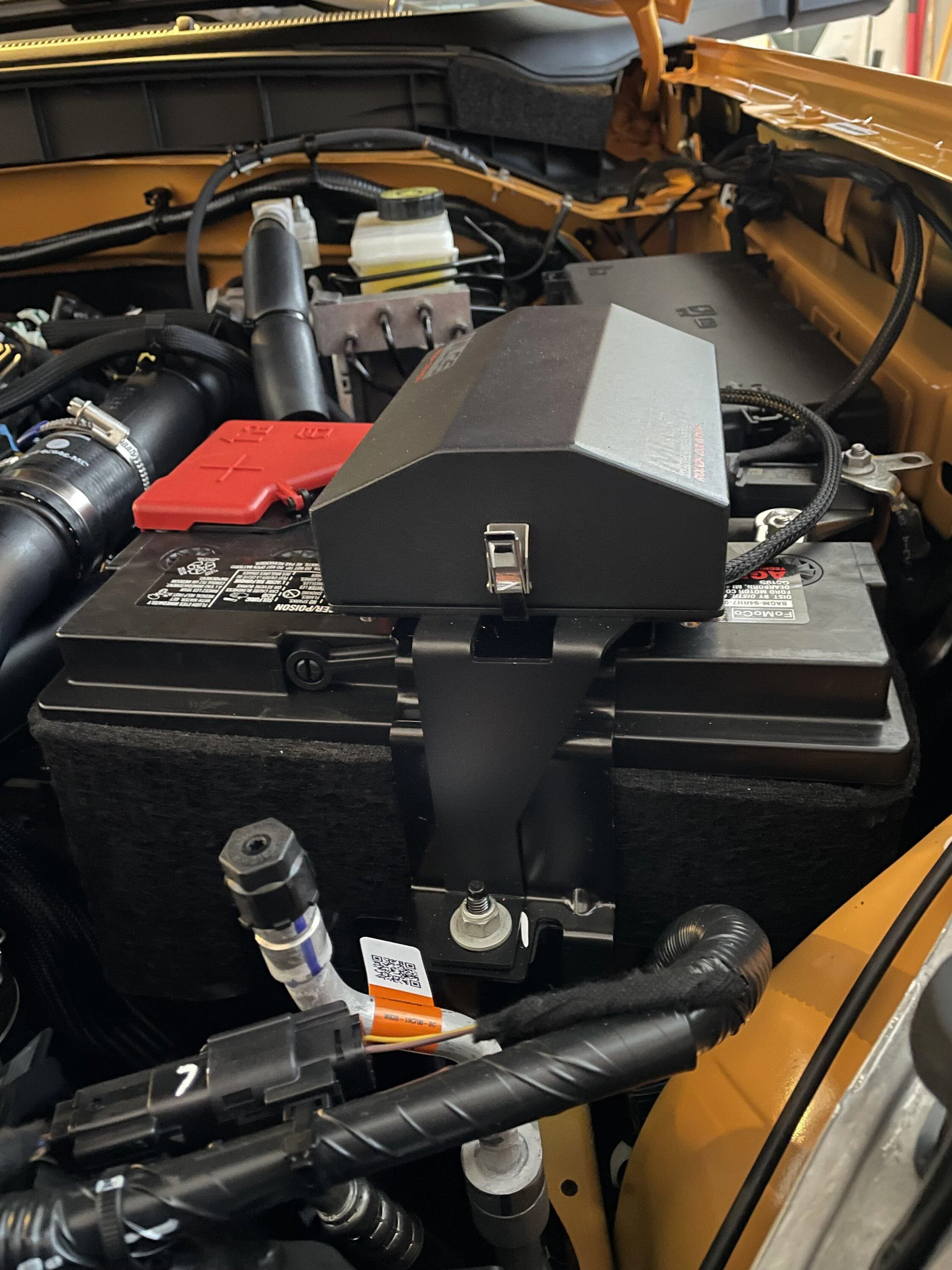

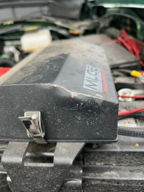

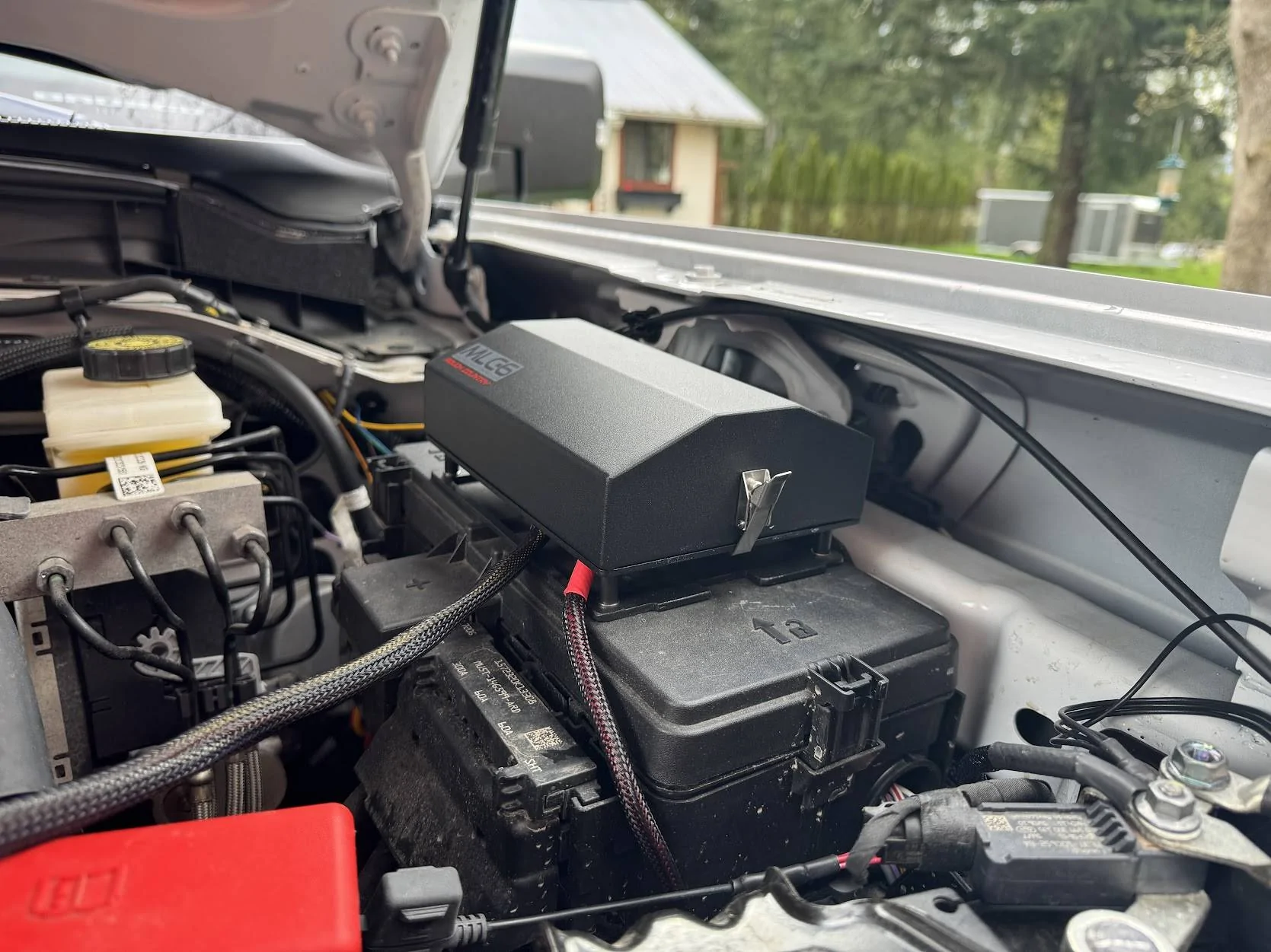

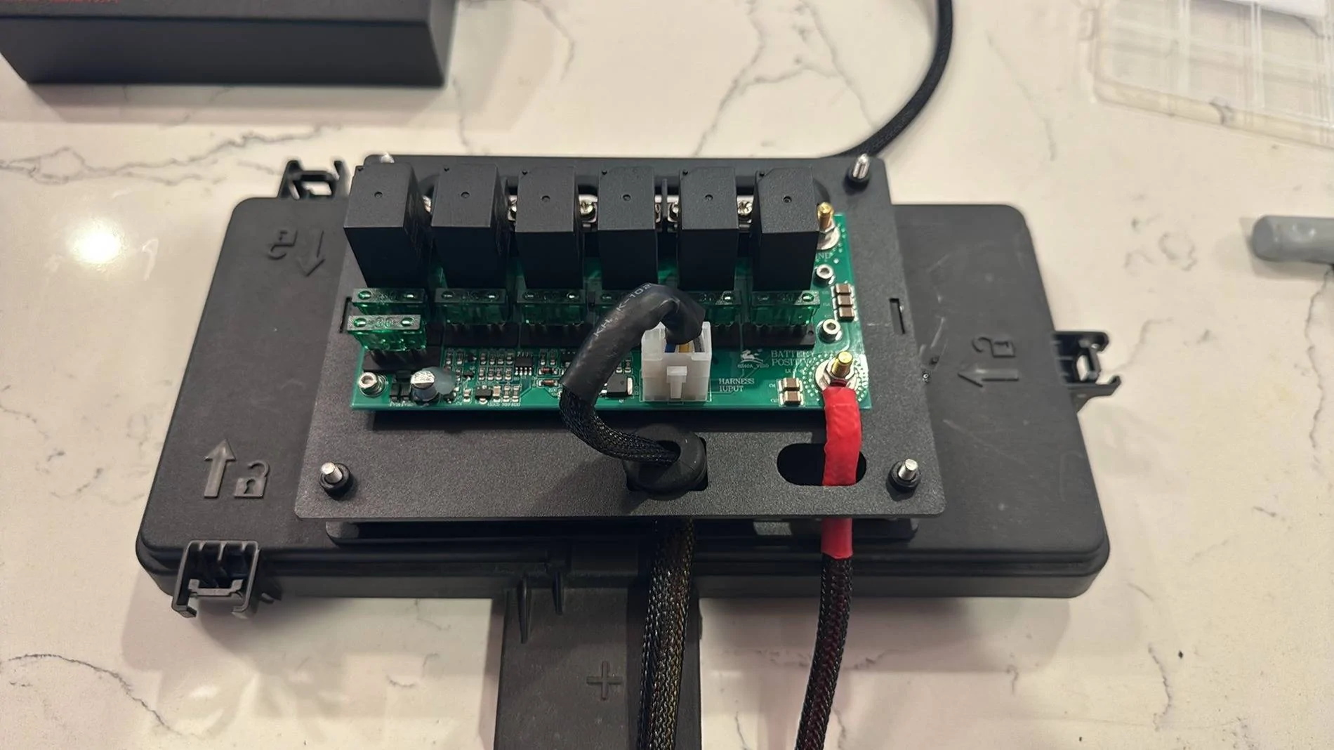

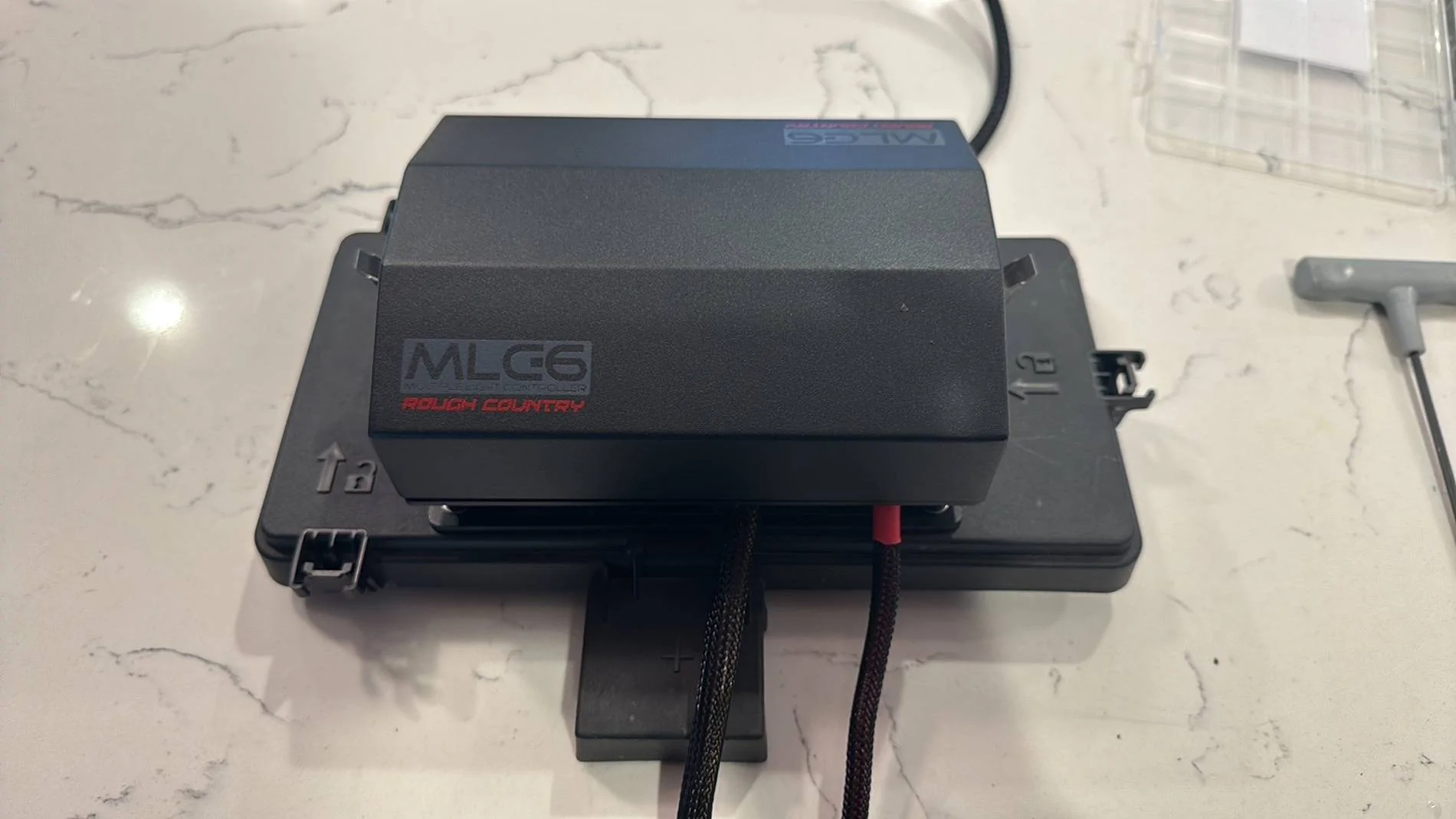

Figured I'd share here since I made the MLC-6 work. I got an insanely good deal on one of these, so I figured I'd just give it a shot, knowing damn well it does not fit my Bronco Raptor. I modified it to fit on top of the fuse box, cutting the base plate and using home wall outlet spacers with longer bolts to mount it. And you know what? It works GREAT! I've had it installed for about a month now with no issues and it's made wiring a breeze. It's not worth the full price considering it just plain doesn't f***ing fit and they should have designed it properly, but if you can find one on sale or from someone who doesn't want to deal with it, then I have no complaints. So, for about $5-10 in parts and paint and a cut off wheel, you can make this little thing work great. You do have to be careful when you drill up threw the fuse box since there is very little clearance within the box itself, but if you mess it up that cover is around $20.

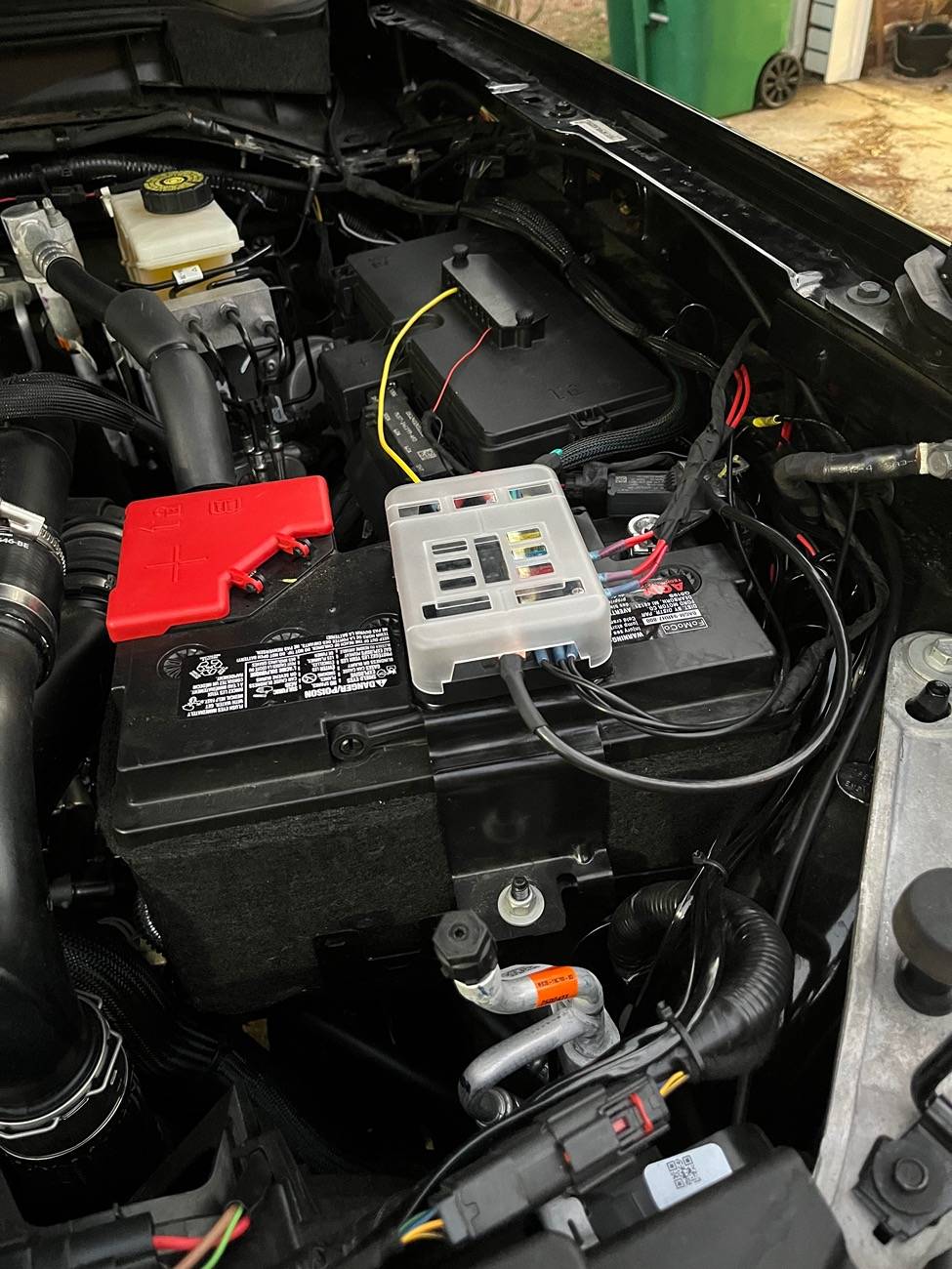

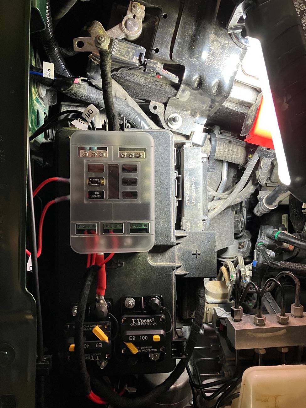

I did something similar to Dan, but instead of the MLC, I mounted this $30 Amazon box on top of the fuse box cover.
https://www.amazon.com/dp/B0DKJ7JW99?ref_=ppx_hzsearch_conn_dt_b_fed_asin_title_2&th=1
That is an awesome little device !! Few questions:
1) How's the quality? I'm always so apprehensive when it comes electrical system purchases and their propensity to catch on fire...
2) I am trying to install 4 bumper lights split onto 2 circuits/relays. Each relay/circuit will support 2 lights triggered through its own individual upfitter switch. Each light pairing draws 35.6A. I see that each relay supports up to 40A however there seems to be only one inline fuse rated for 40A. Do you think I could replace one of the other fuses to a 40A rating ? so I would now have 2 fuses rated for 40 amps each.

I've only had it in for 3 months or so, but I have 2 40 amp fuses on switches 1 and 2 and......so far so good.

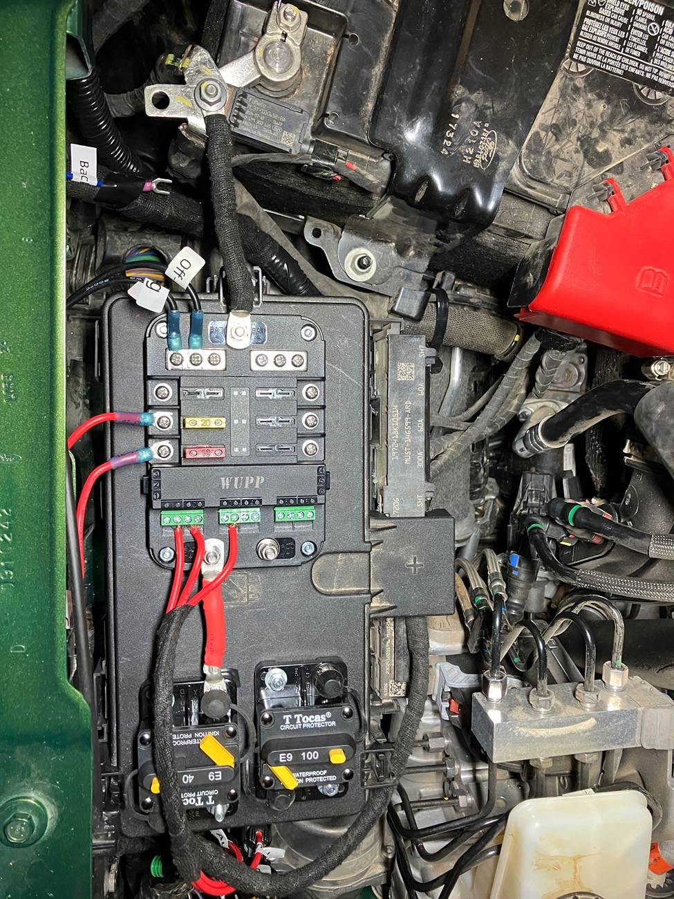

Here is another layout with the WUUP. Powering fog and offroad lights from Diode Dynamics.
Feedback welcome.
The 100A breaker is for a future project not on the WUUP.
This ended up so much cleaner than the wiring harnesses custom for these lights.
Plan to add a light bar next.
