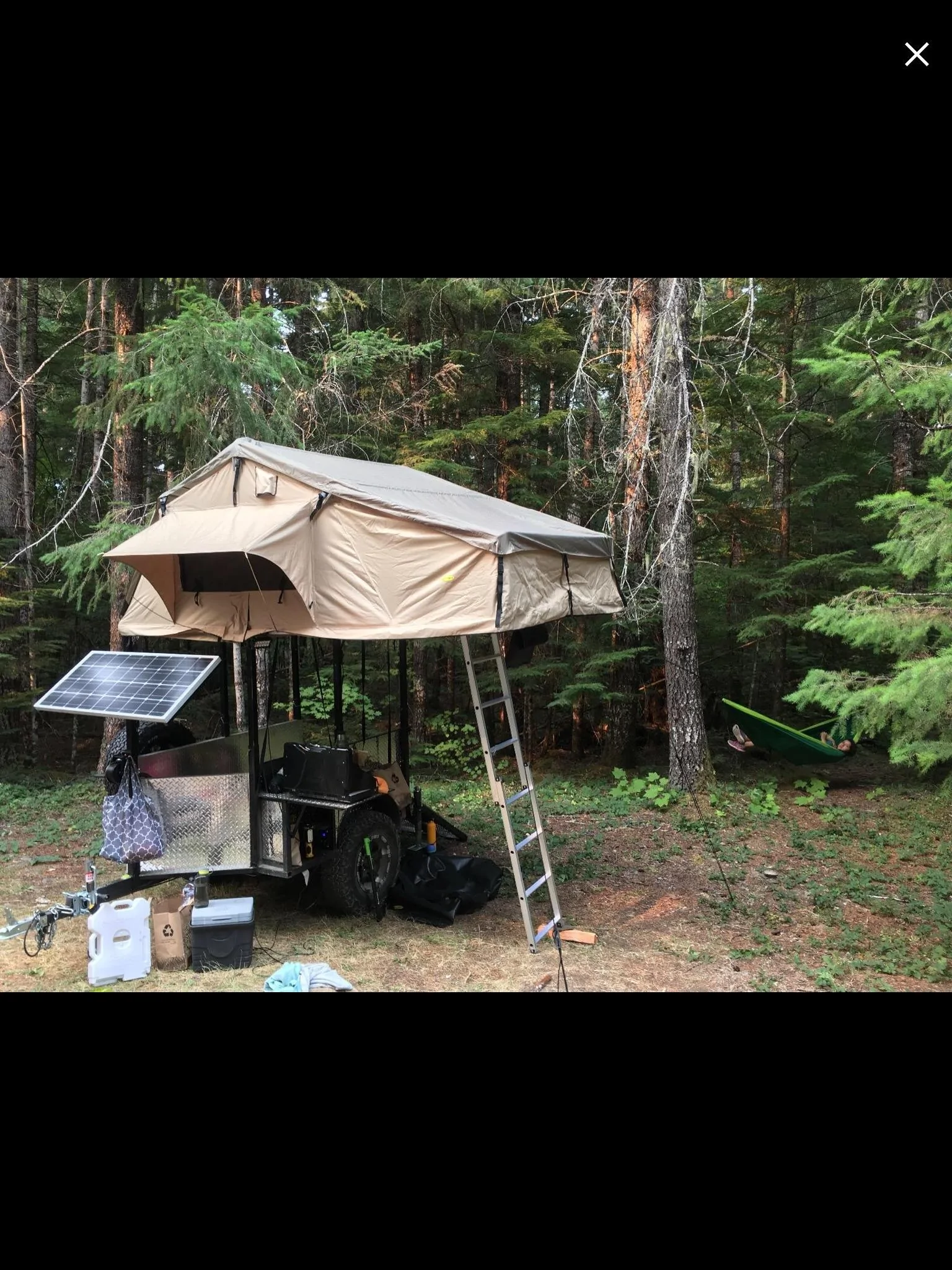

I am thinking the Trailer Mounted RTT is the Way to go, with the Plastic Roof Top, of the Bronco…
I am beginning a build, similar to this, with a Smittybilt RTT…just planning to build it lower to the ground…

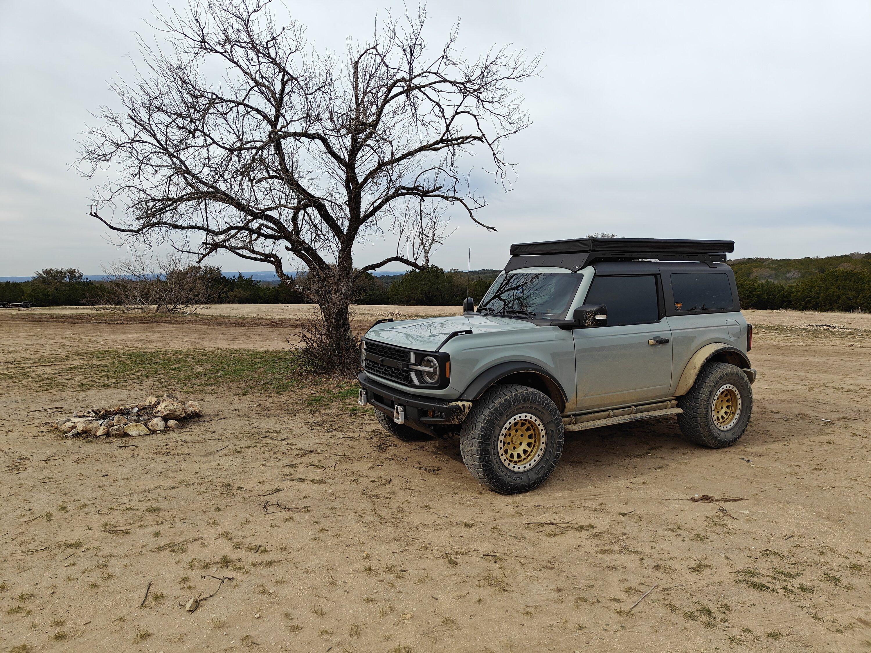

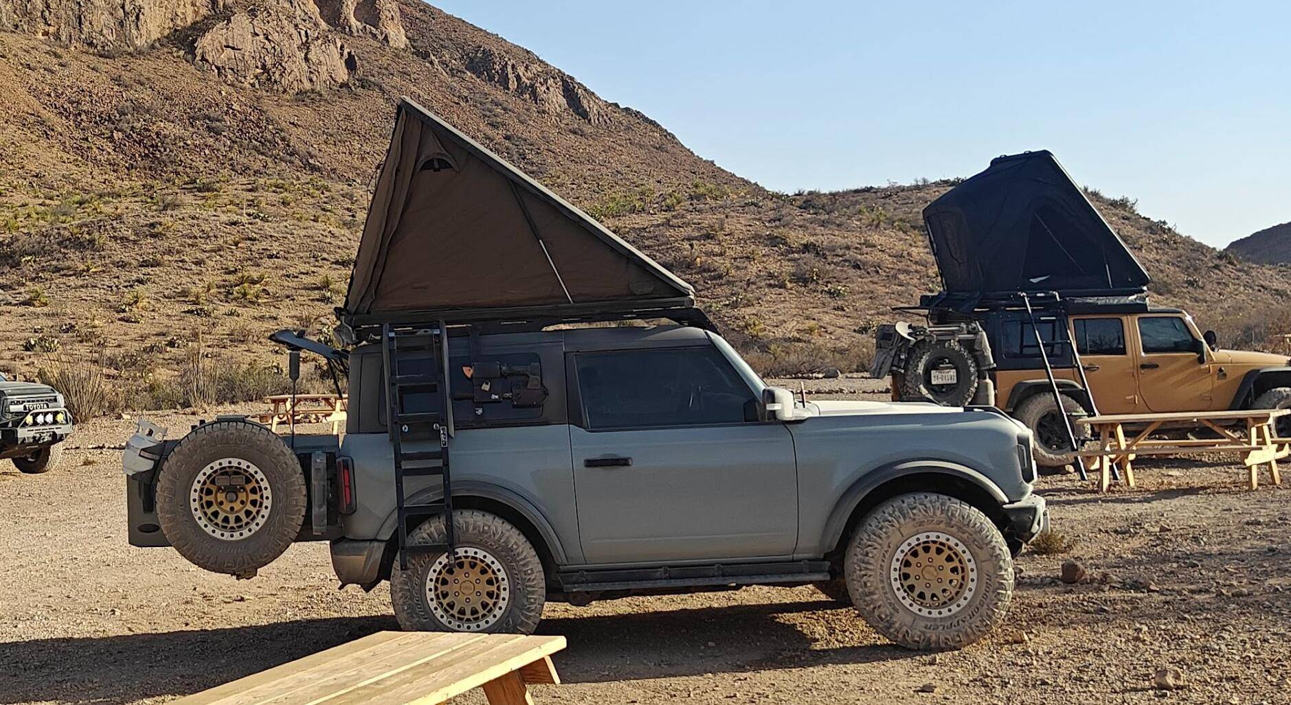

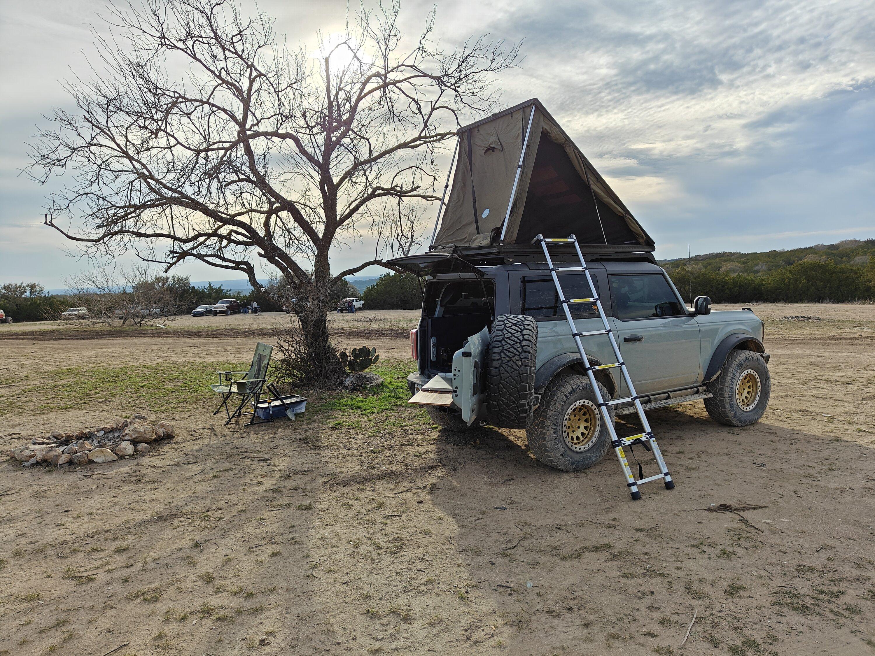

I know this is an old thread, but your Bronco is showcased on their website. Now that it's been a couple years how is the tent holding up, especially the soft cover instead of a plastic clamshell?
JaxDiego
Jul 30, 2020
148
329
Granbury TX
22 Badlands
I remove it when I'm not going on trips for extended periods. Its good as new still. I armor-all it when I want to shine the black back up. Just last month in big bend-
