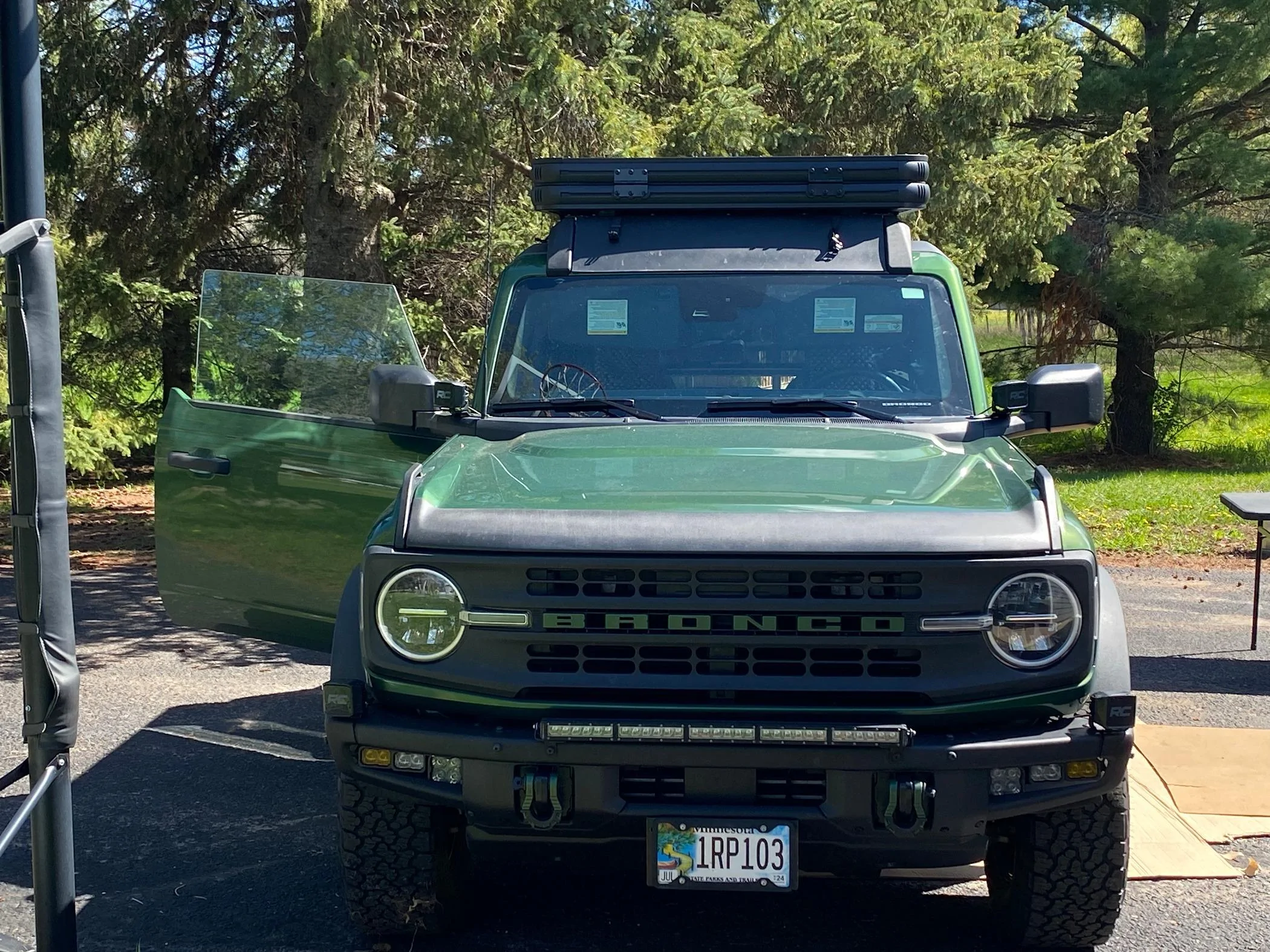

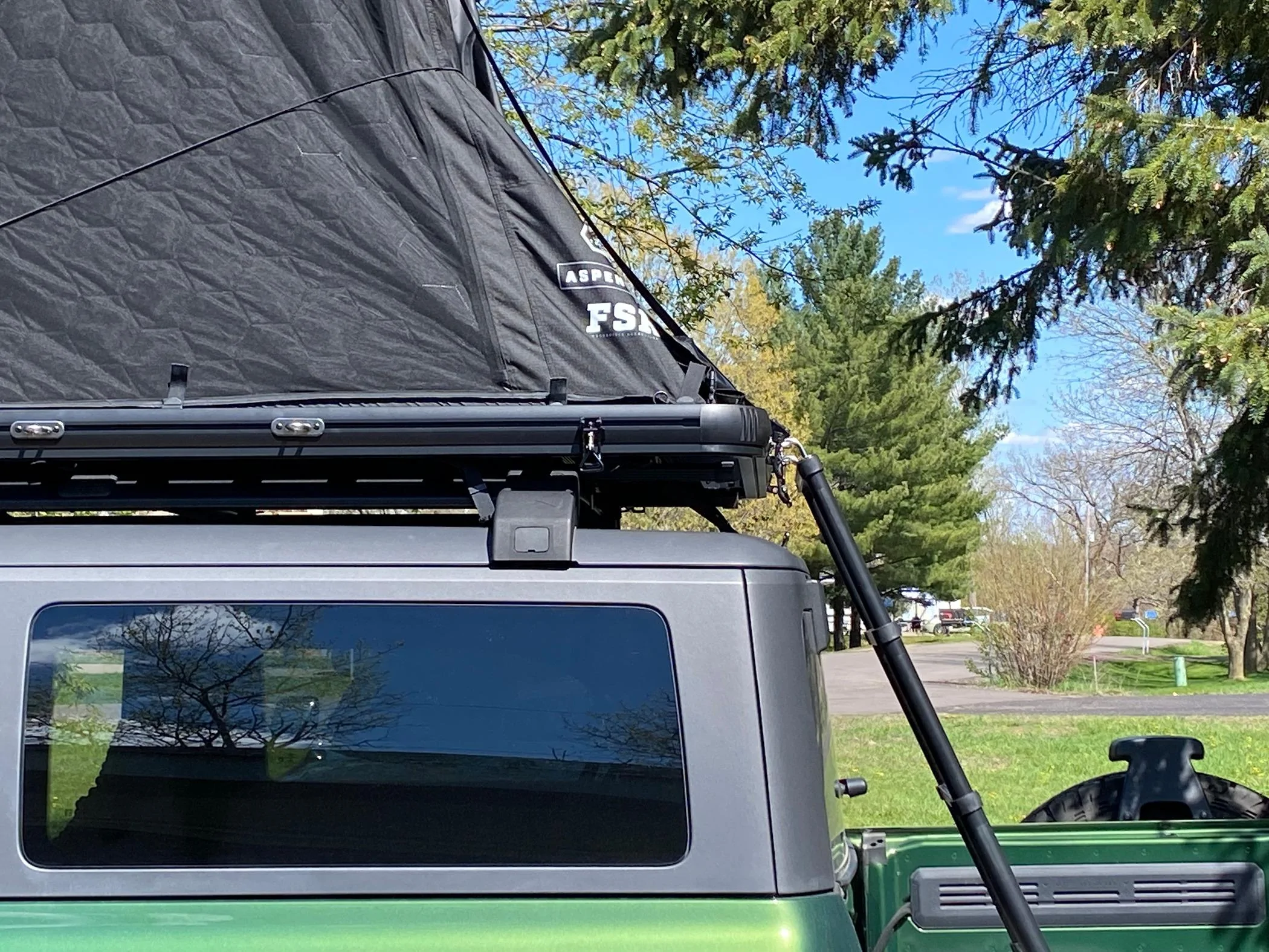

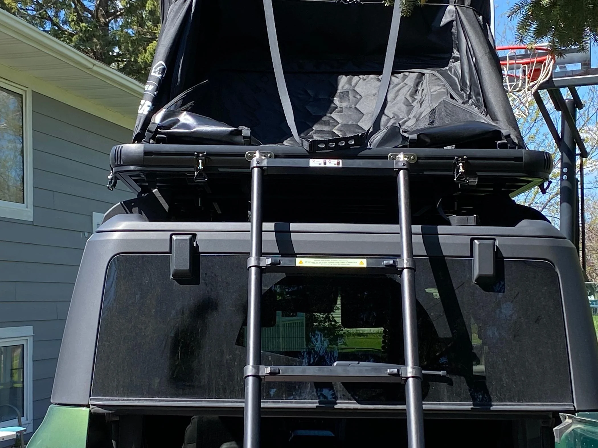

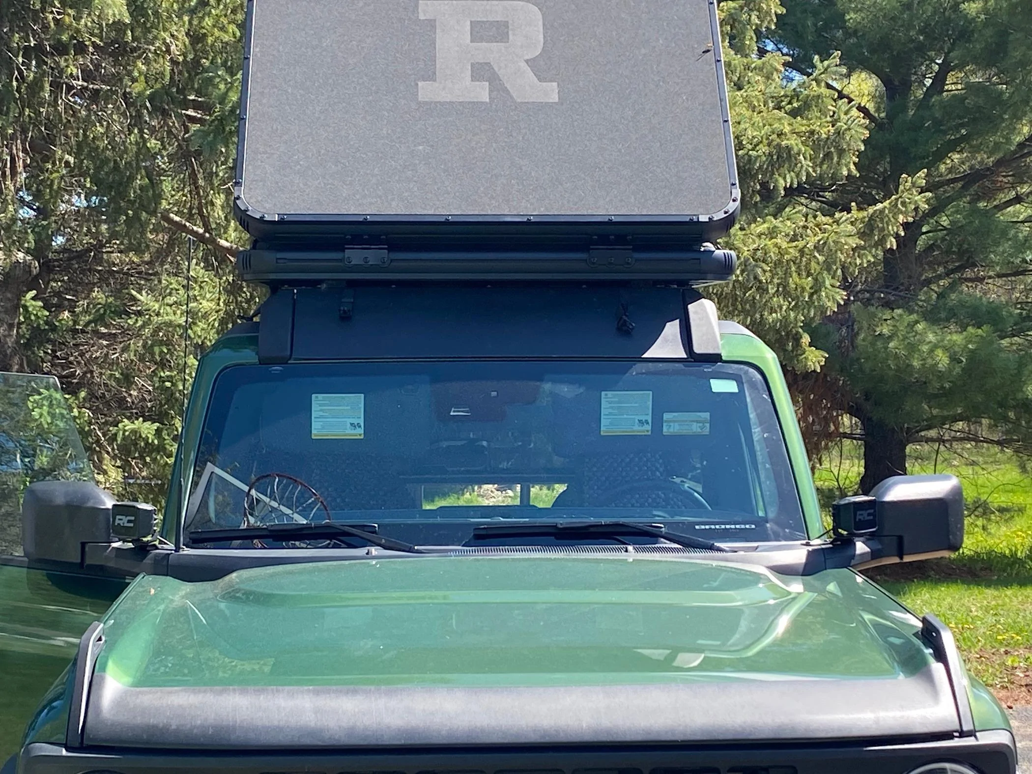

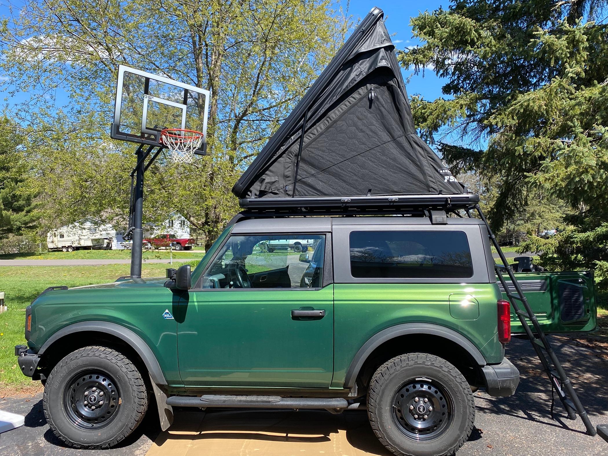

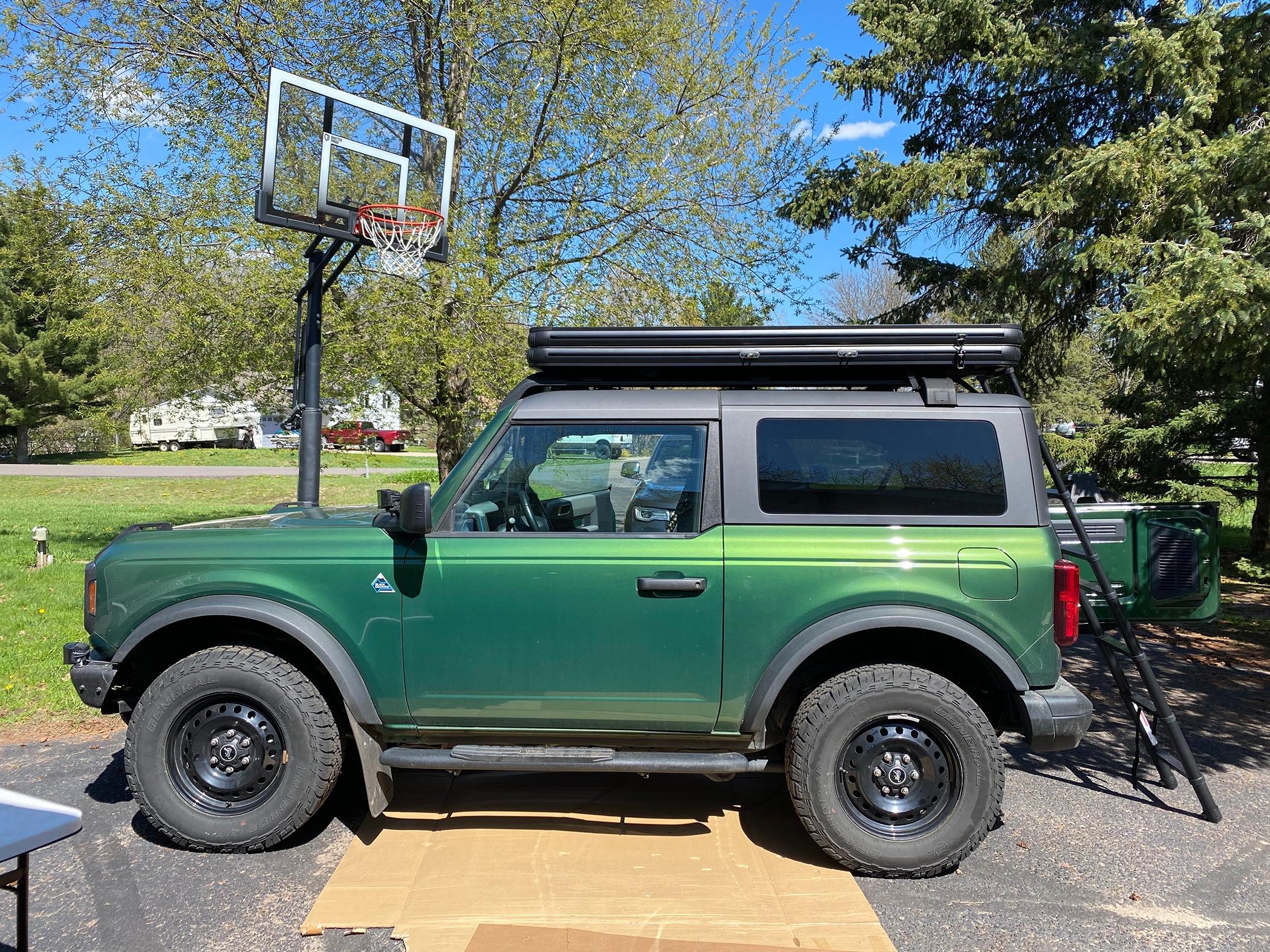

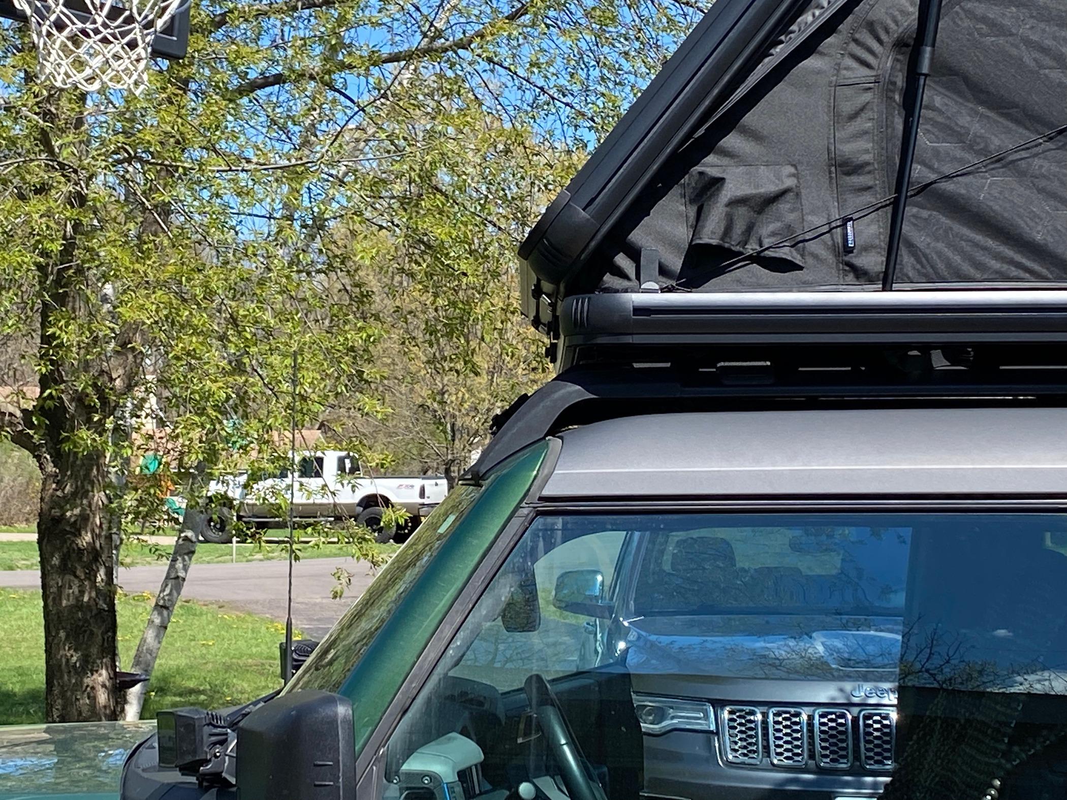

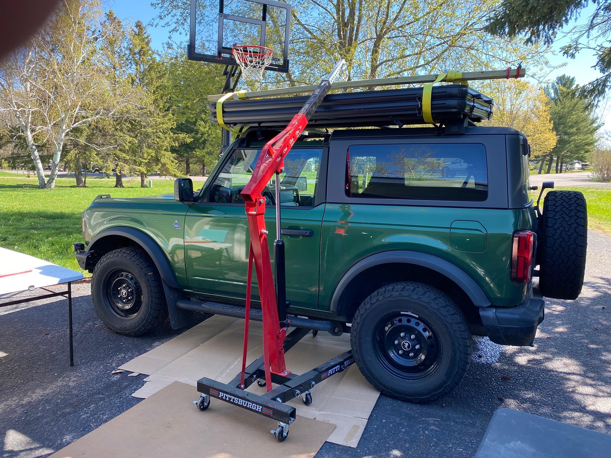

Finally installed my Aspen Lite. Not an easy task, especially the middle cross bar. Too tall, can't fit into my garage. I dread this fall when I need to remove it for the winter.

Looking good! Nice replacement for a second set of hands

Hi! I installed the 3rd crossbar from Ford, for weight distribution. The tent only comes with 4 mounting brackets, I had to order another mounting kit from FSR. So 2 brackets for each crossbar. FSR mounting kit/brackets work great. They even include the ratcheting wrench.
I have the 2-door. If you have a 4-door, getting to the middle crossbar mounts will probably be easier. The install of the mounts to the front (remove the Bronco front roof panels) and rear were fairly manageable. The middle crossbar was the pain. Luckily, the way the Aspen Lite is built (slats across the bottom rather than a full aluminum panel), you can access the middle crossbar mounting through the tent frame. Get the front and rear brackets installed. Open the tent, loosen the velcro straps underneath the tent where the middle crossbar is. This will allow you to lift up the bottom of the tent up away from the frame. Then you can reach down to install the mounting brackets.
