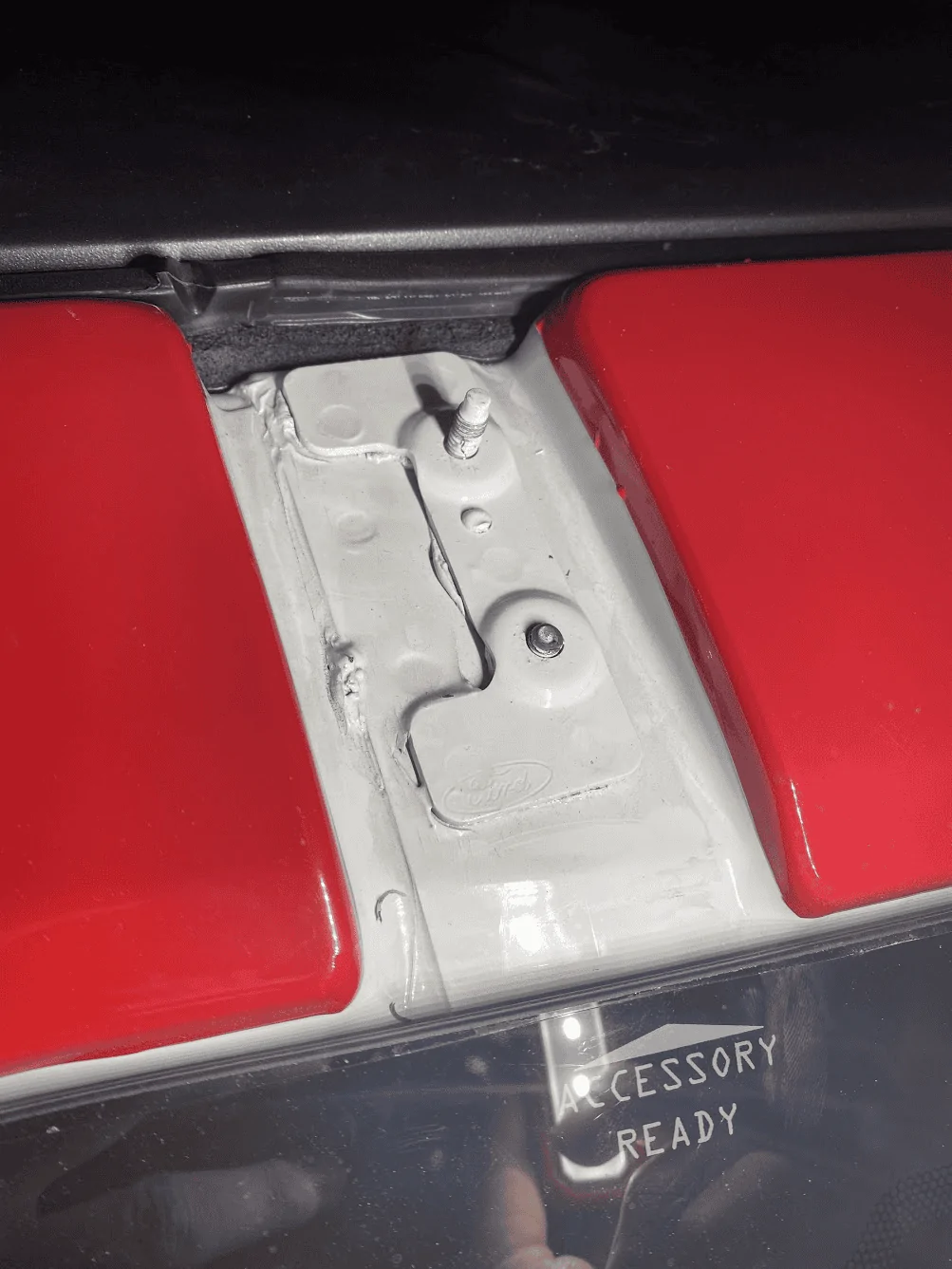

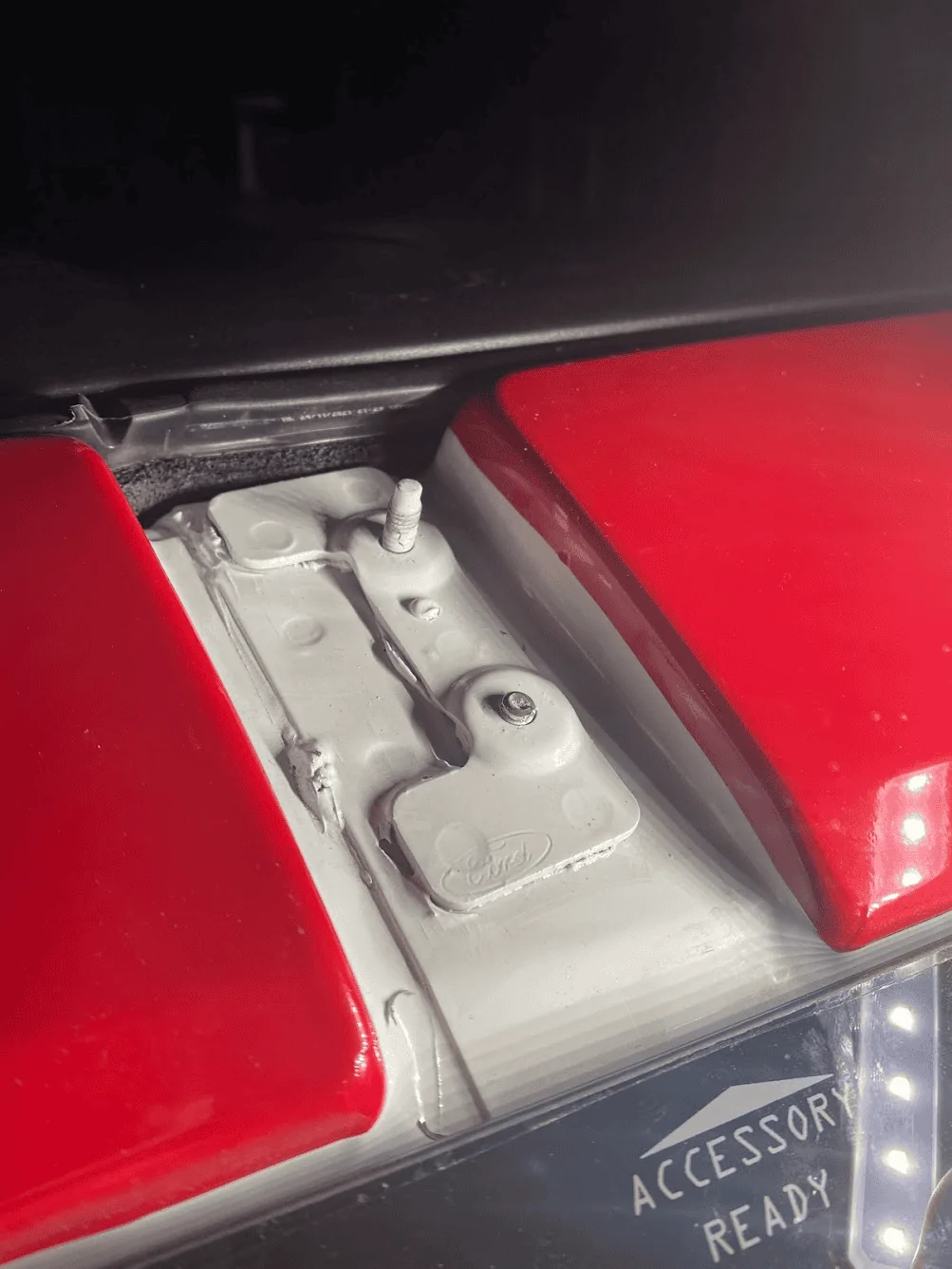

Welp... I feel like this is going to be a really painful fix. No idea how this happened, I was tightening the last nut for my light bar mount (Using OEM nut it came with) and no tighter than the rest..... BOOM, snapped in half. Didn't even feel really right :| I'm going to say it was over torqued, but didnt feel like it was when I was tightening.
So the question is, are there any easy fixes or is this going to cost an arm and a leg? Looks like the metal plate holding the bolts are welded on.
Here are pictures of the damage:
Any advice/help with this would be appreciated
Why not just have it welded back on. The break is at a pretty low point. It shouldn't interfere with you roof rack or other accessory. Just an idea.

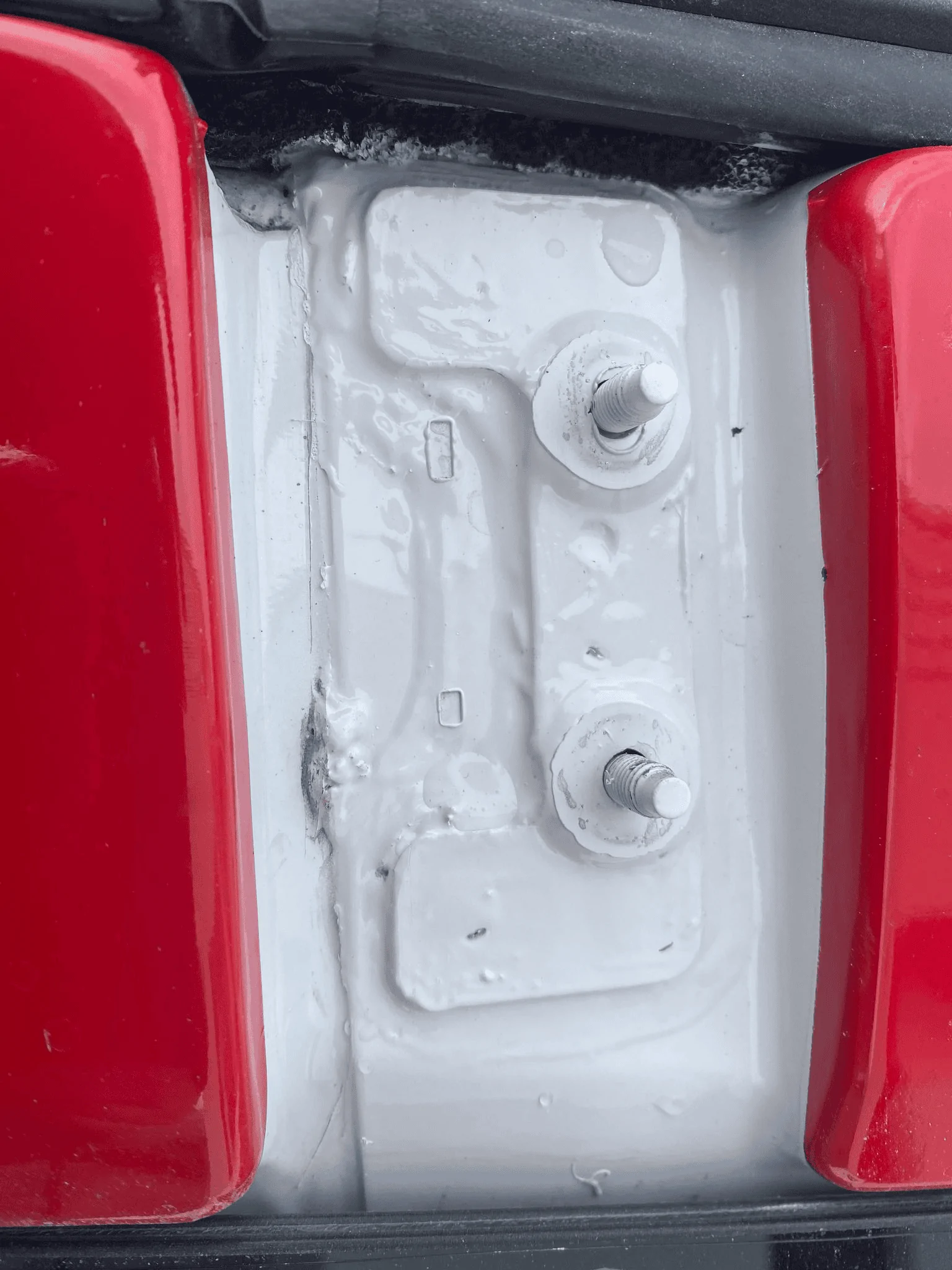

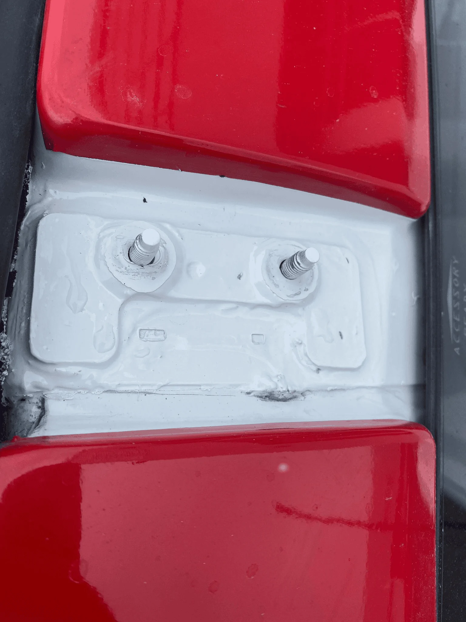

After reading this, I was super careful when installing my new light bar. I was pretty surprised to see how small the studs are and I’m a lot less confident they could support any kind of load if I ever used them for a roof rack.
Anyway, the instructions said to torque the nuts to 7.7 ft lbs. sure enough, at about 6 ft lbs one of the nuts started getting easier to turn. I backed it off and the threads were stripped clean. I guess I can get it rethreaded but hopefully Ford will acknowledge these studs are practically made of silly putty and come up with a fix.

Same thing almost happened to my Bronco. One of the nuts wouldn’t tighten to spec, either the stud was spinning free or the stud was stretching out. Glad mine didn’t break, but I’m sure it was close. I left it on very loose.. Not too confident about the strength of my roof rack though. Seems so simple, why would ford use such small cheap metal studs

For anyone looking for a update. Ford approved the Warranty, sent parts immediately and it went to the body shop. Body shop took about a day to repair. No damage to my vinyl or the screen protection I had on the windshield from the tack welds.
The plate requires 4 tack welds to be put back in place.

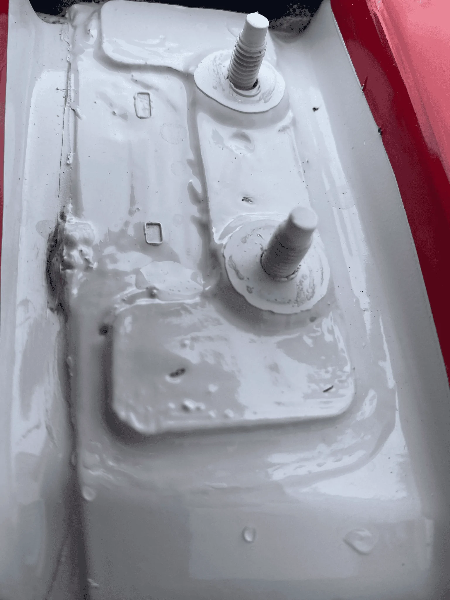

Looks like an obvious place for an enhanced part. Thinking out loud:
A thicker plate, combined with a larger diameter stud.
Not sure if a revised plate could be perimeter TIG welded instead of spot welded (as factory). Would depend on what interior trim is behind/nearby and if it could take the heat.
Also not sure about plating for corrosion resistance as most types can't be welded through and one shouldn't rely on installing a nut over paint like Ford did. Stainless steel could work, but I dislike the way threaded SS tends to gall/sieze.
Should be very easy to slightly drill out a rack or light, etc. to accommodate a larger stud.
