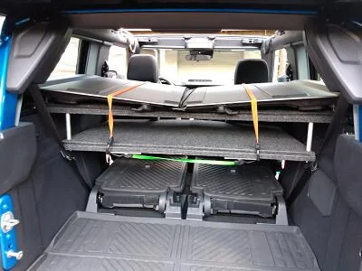

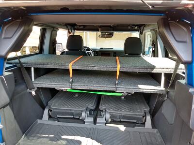

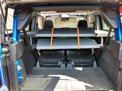

I made up this rack for the panels. I didn't like using the storage bag for short drives and especially didn't want to give up ALL the cargo space to the panels.
It's a simple rack made from uni-strut, plywood, and outdoor carpet. Mounts using existing roof hold down bolts. Someday I'd like to redesign it to fold for easier r&r.
That's very well done. I've always lamented the awkward storage of the 2-door. It's always encouraging when someone finds innovative solutions.
