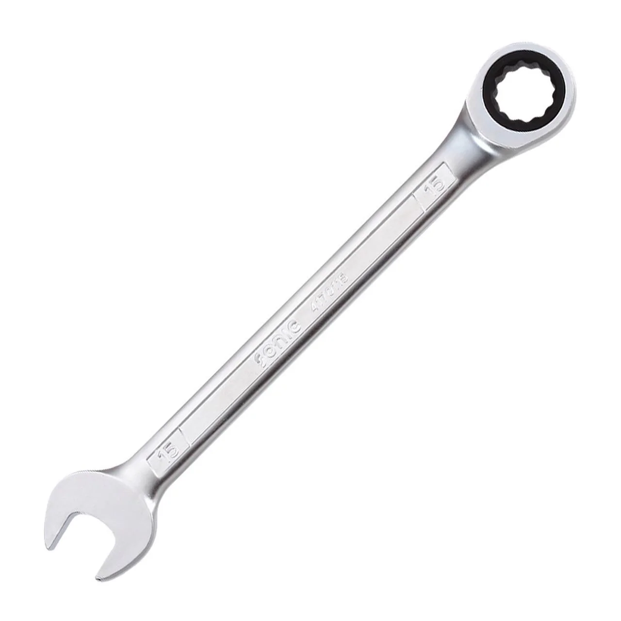

I've had the rokblokz on for about a week (front, 2DR FE, XL Long) with no issues, working great. My one complaint was that installation was a pain in the asshole. Specifically getting the furthest bolt back on the mount. The liner on the wheel well (fender liner?) and tight space made it damn near impossible to get any socket I had on it. Ended up hand tightening it with as much elbow grease as I had in me down and turning it the rest with a socket about 50% on til it was almost down. If I had to do it again I'd remove the liner, but if it's anything like my mustang id buy a set of the castle nuts for the liner first because those MFs break easy as cake.
Edit: I should say the upside is I probably wont ever have to do it again because the splash guard itself detaches with a quick accessible thumb screw, no need to remove the mount.

Two words: ratcheting wrench. Made this a 10 minute job.

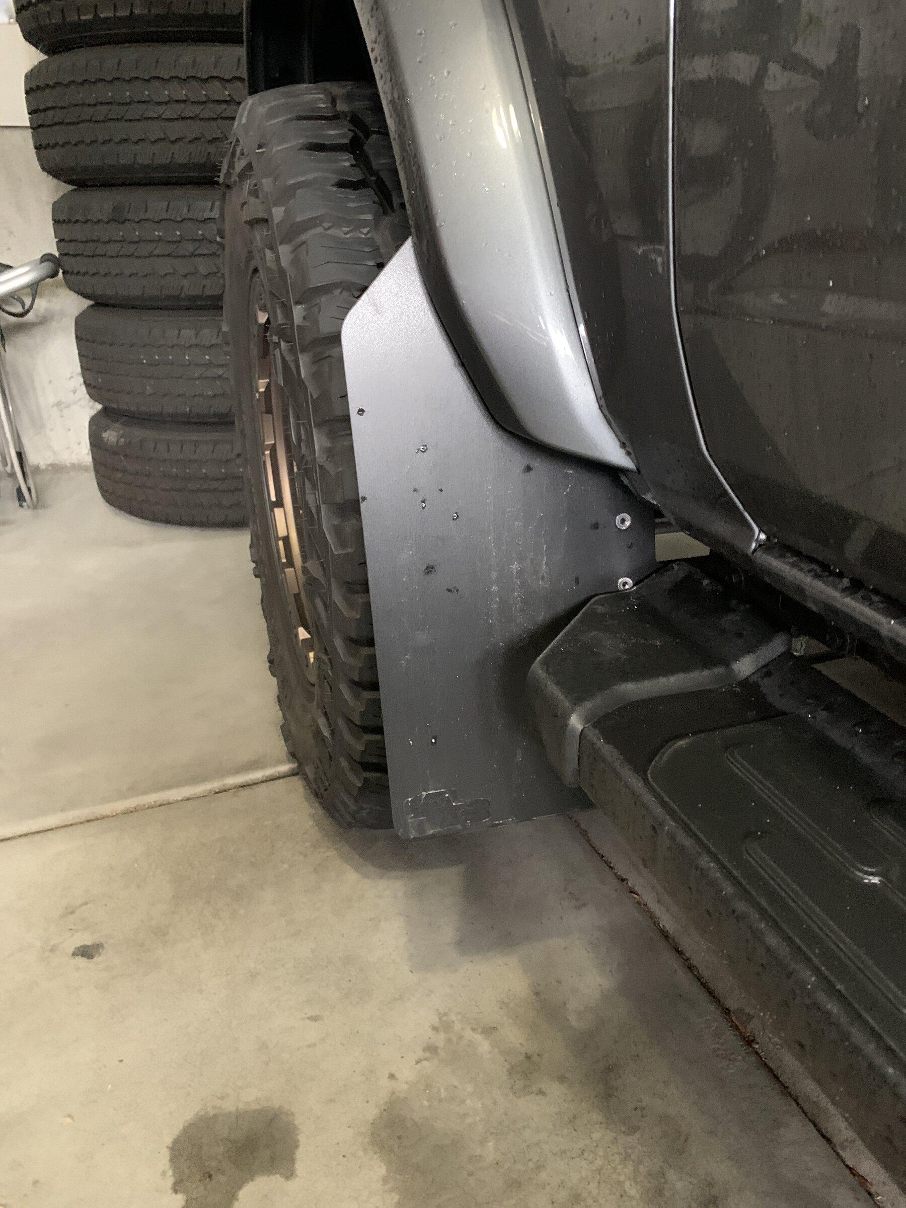

Installed my front only crash bar removed kit today. Super simple. Well built. Fastened tight. No wiggle. And do fit with my OEM factory steps.
Rained today so had a chance to see difference in keeping splash down. Night and day difference. Happy with purchase.
My only complaint/suggestion for improvement would be the silver nuts used to fasten mounting plates to flap. Wish those nuts were black so not as noticeable on back side of flap.

I had the same feeling about the silver nuts, but figured the only one noticing them is me. I love them and they are night and day as far as keeping the side of the truck super clean. I am a mudflap convert, at least on this vehicle. Money well spent.

Easy as can be with a wrench/ratcheting wrench. Just get the right tool for the job :p
