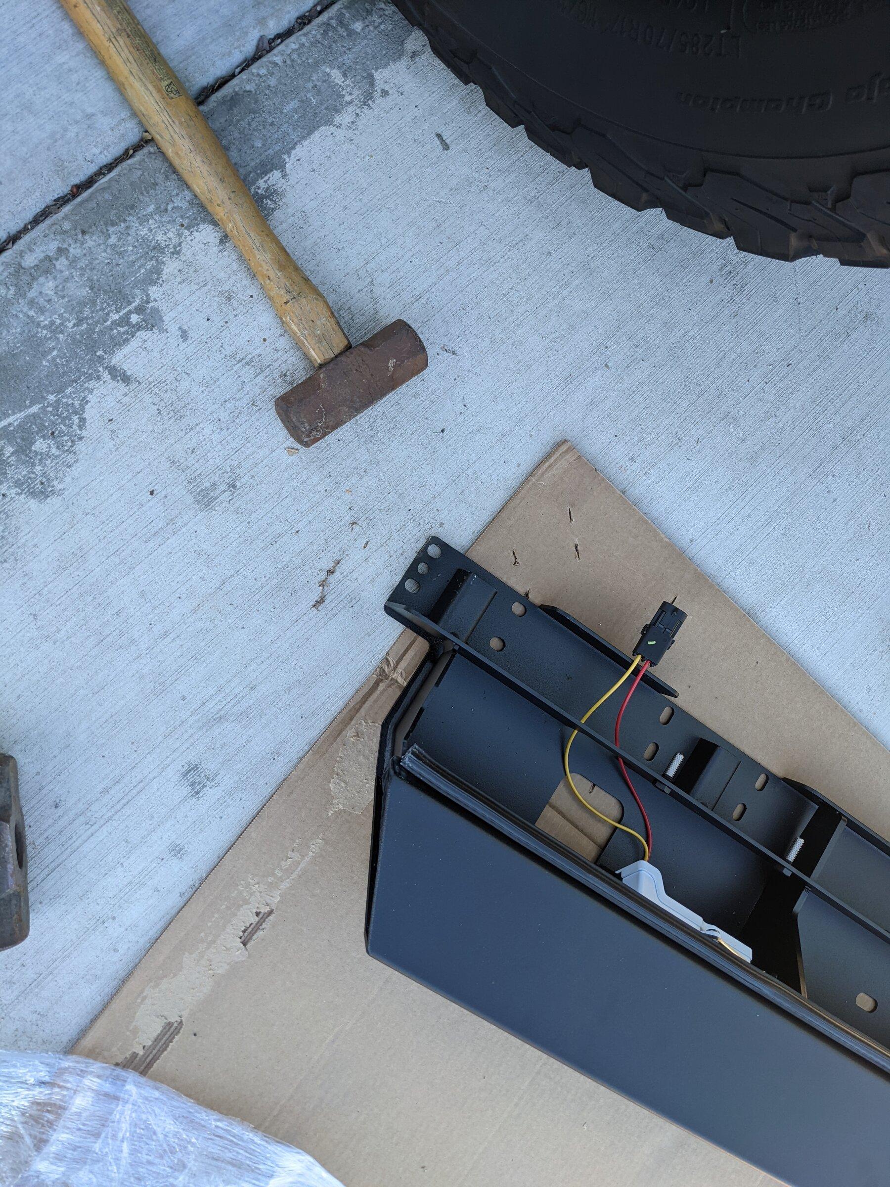

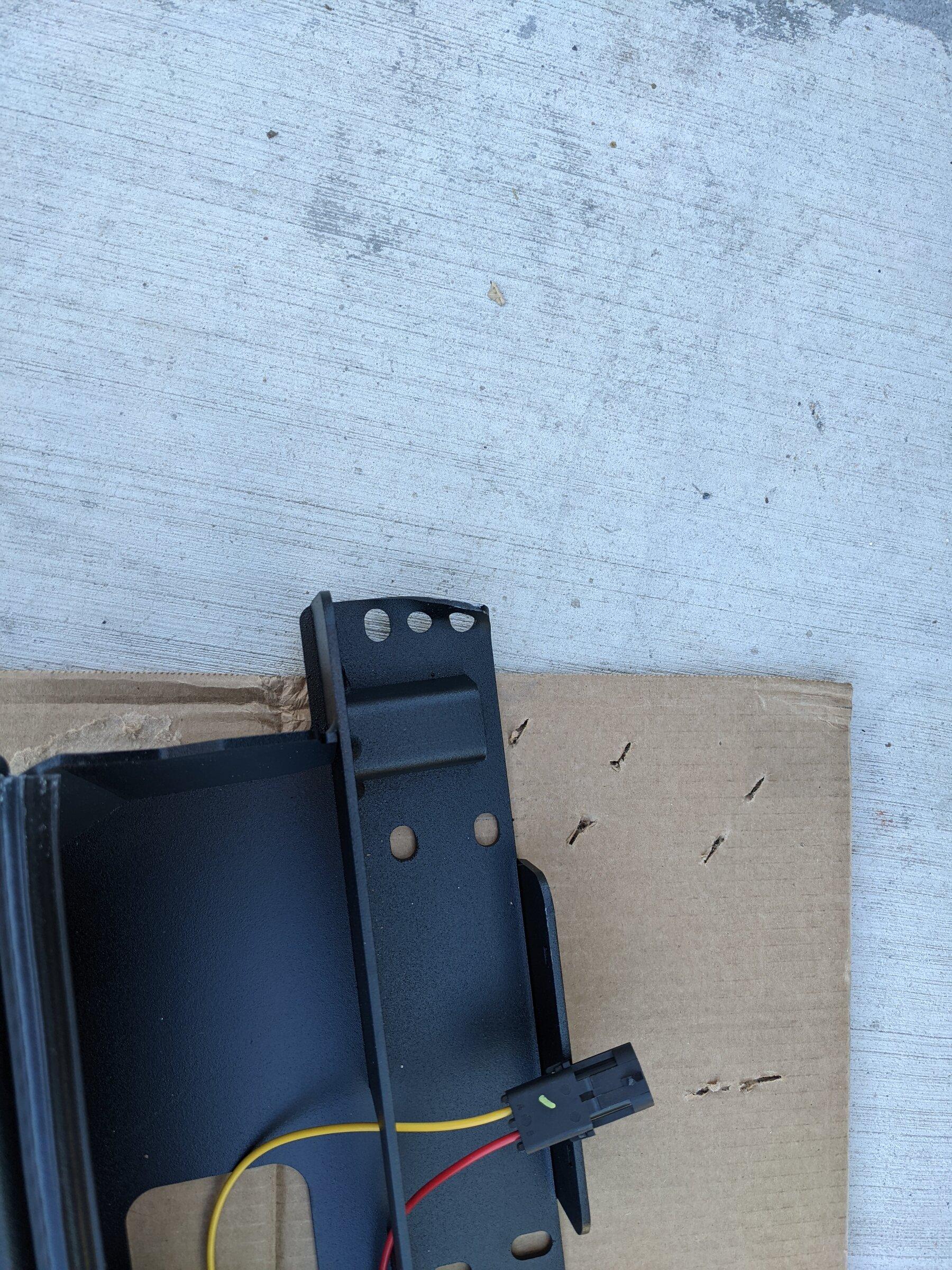

Well turns out they did drop it and the rear bracket was bent.
Ford Bronco Rockslide Engineering Steps - GROUP BUY has started! PXL_20220123_215051576
I just hammered it back flat with two small sledgehammers.

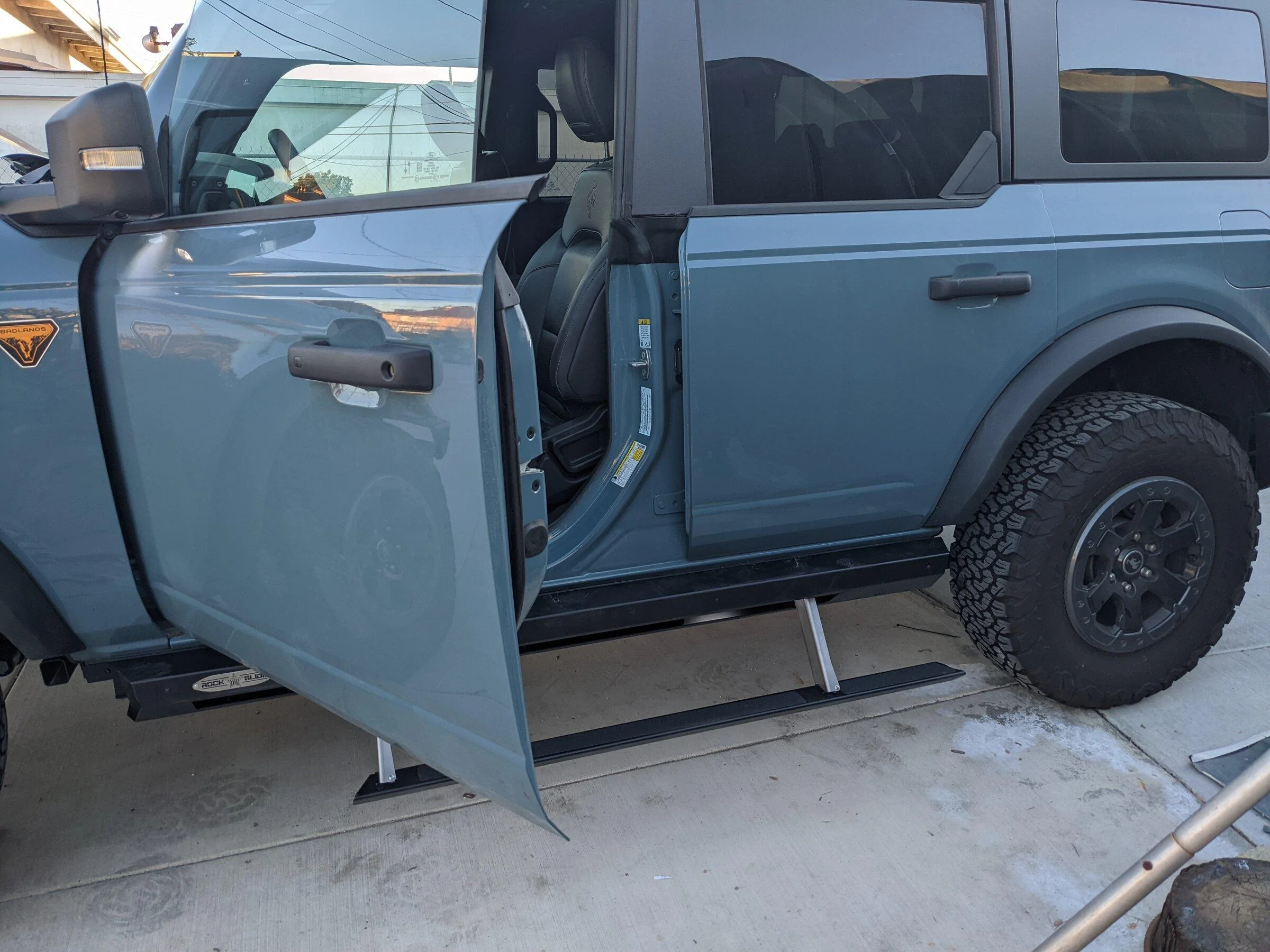

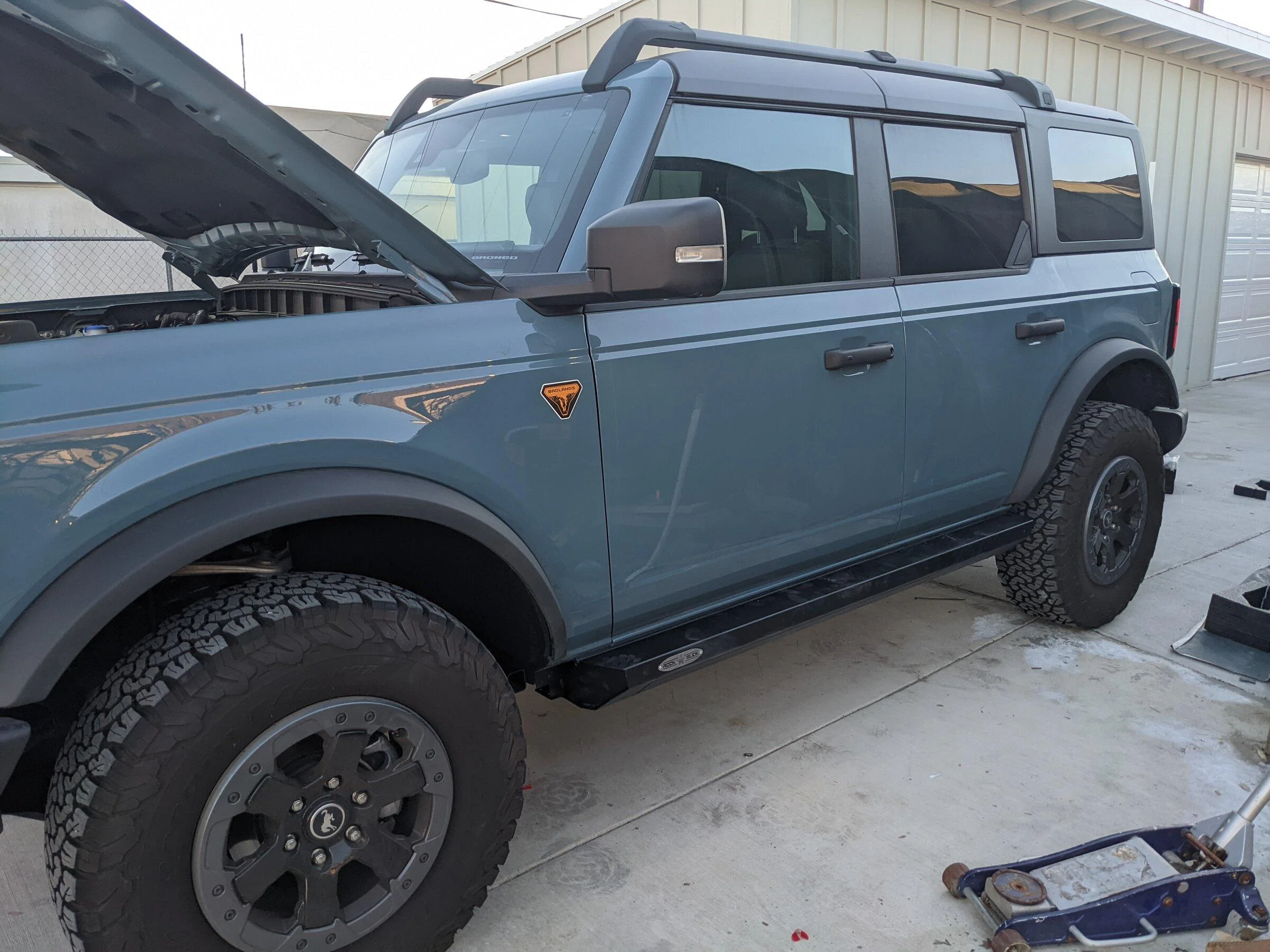

Have a pic of finished product?
Here you go
Ford Bronco Rockslide Engineering Steps - GROUP BUY has started! PXL_20220124_003454024
Ford Bronco Rockslide Engineering Steps - GROUP BUY has started! PXL_20220124_003503364
Count your hardware, I ended up with 38/40 5/16-18 bolts and 52/40 washers soo.... Yeah...
I don't recommend doing the install solo if you're the type to skip leg day. It's heavy and awkward by yourself, you can kind of hip thrust it into place, but easier to get a case of beer and a buddy. If you have air tools break them out, I get kind of lazy cause I don't like unrolling the hose, but there's a lot of nuts to turn.

Damn i was hoping they closed the gap to the front flare.
Hey look at it this way, at least you can apply those lovely mud flaps now.

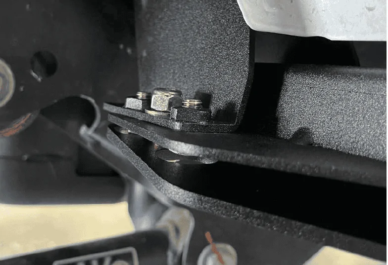

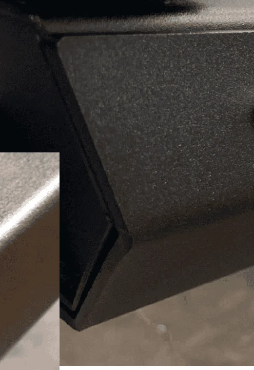

Armor is primarily for people who intend to slide their truck over rocks on purpose, not for an occasional hit.

Is the pic on the left showing the slider inside the armor?
If so., that armor is 2x.
I've read that RSE reduced their step/sliders gauge in an earlier revision.
What is the pic on the right showing?

Both photos are from the install guide and showing step and outer armor shell. Website says steps are 10 gauge (9/64") and armor is 3/16", so maybe the photos do not match production.
