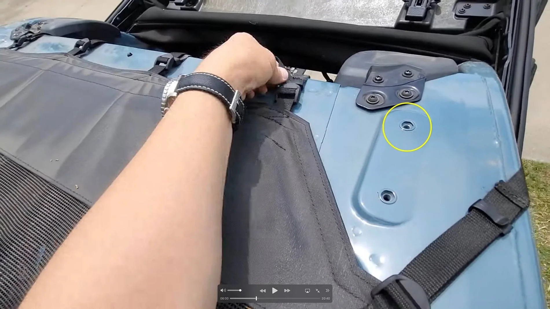

I bought a Mountains2Metal Flip Down Attic Shelf. It's a bit of a challenge to install if you have the hard top but I really like it.
I put some recovery gear such as soft shackles and kinetic rope up there. It's another good location for emergency gear.
Did you end up removing the hard top? I can’t find a way to screw the top brackets. There’s barely any room
CalvinT
Calvin
Mar 15, 2022
2,772
3,546
Phoenix, AZ
You don't have to remove the hard top. That wasn't an option for me as I had installed a Trailrax and I wasn't about to remove it.
It's a tight fit. I have mine apart right now trying to get rid of a creak when I go around corners. I think I'll be successful and will make a post when I'm finished.
About the screws that hold the top brackets. You have to insert the front screws from the back seat and they're a bit of a pain.
I recommend inserting the rear top bracket screws first. They're easier to insert if you're in the cargo compartment and reach between the roll bar and the side window. They're difficult if you try reaching from the back. They're much easier if you come in from the side of the roll bar.
Then the front hole in the top bracket will make it easier to locate the hole for the front screws.
I was getting pretty frustrated until I decided to install the rear screws first.
You'll have to use your finger tips to turn the screws in.
Hope this helps.
Hope this helps.
Thanks for the info. I realized that for the front screws I had to do it from the back seat. Good tip on starting with the rear screws first and to come from the side. Will try that.
Now, what’s the best sequence considering that you can’t install both brackets to the top of the roll bar and insert the attic shelf after? I was thinking to install the driver side top bracket (rear screw first), slide the attic shelf in place, insert the passenger top bracket to the attic shelf and then attach the passenger bracket to the roll bar (rear screws first). Does that make sense? (I already have the 2 other brackets installed, those were easy)

Install both top brackets. Once you have the front screws in, make them finger tight. Then remove the rear screws. You only needed them to make locating the front screws easier. The top brackets will pivot enough you can install the shelf. Slip it over one pin, then the other. Then replace the rear screws and tighten them finger tight.
After that follow the instructions to center the shelf. The latches will still latch. You may have to use some pressure the first few times but this gets rid of one source of rattle.
As others have noticed, the shelf rattles some. I slipped a piece of Harbor Freight Marine shrink tubing over the pins of the rear brackets, the ones you've already installed. You don't need to shrink the tubing.
Even with the shrink tubing the shelf would creak some when turning or going over bumps. I've ordered some teflon washers from McMaster-Carr that I'm going to slip over the hinge pins. The heads of the screws holding the hinge blocks leave marks on the powder coating of the top brackets. Teflon (PTFE) is pretty tough, so the washers should hold up. You only need one on each side.
So there's movement there. My Ace hardware has rubber washers the same size, but they won't slip and may cause binding unless you leave some play. Hope I'm clear. Feel free to ask for clarification.
