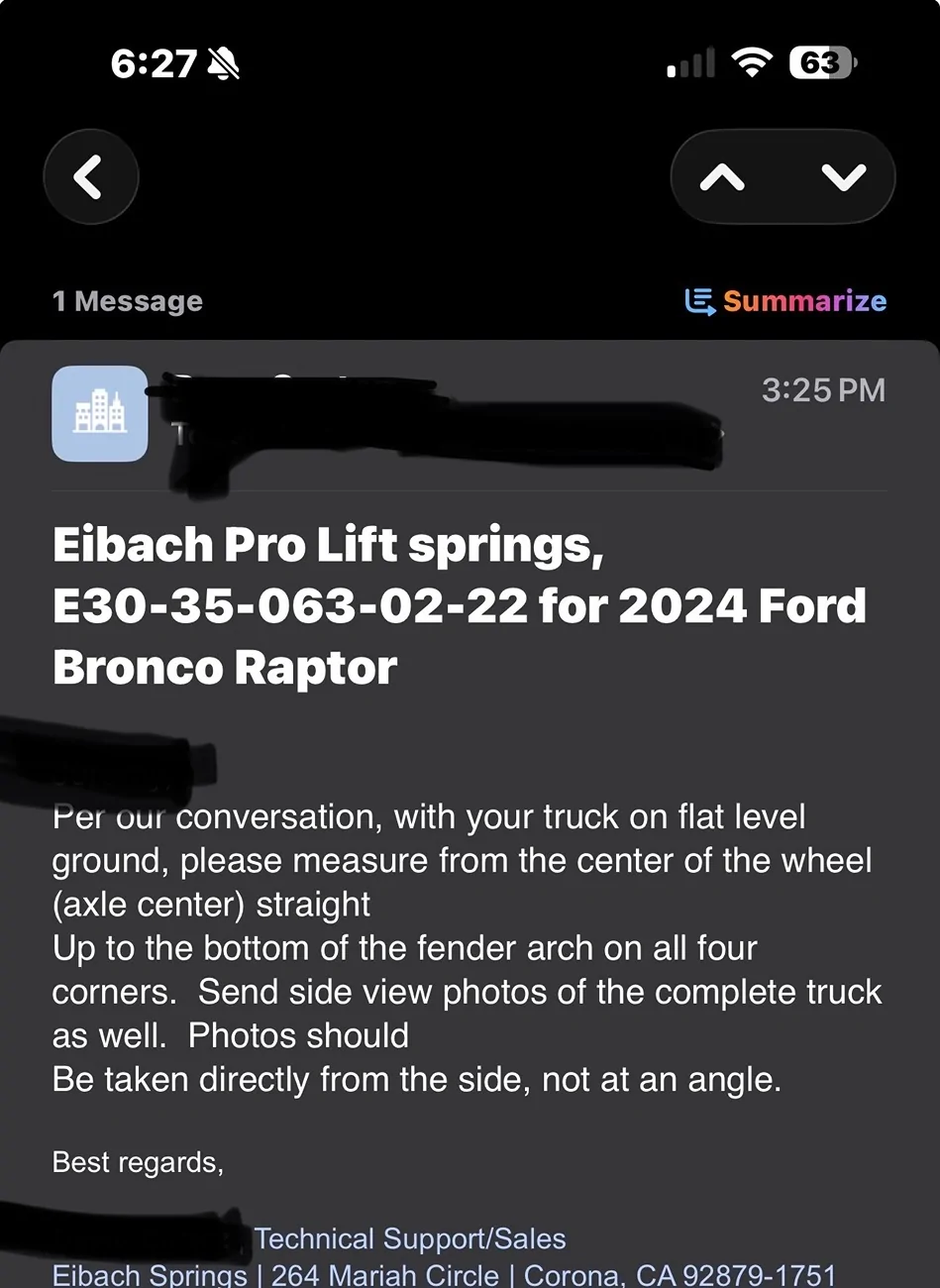

I also reached out to Eibach Directly and they asked for me to do measurements from center hub to the top of the fender. To see if potentially the springs are incorrect. Again I will continue to post as I find out more information.

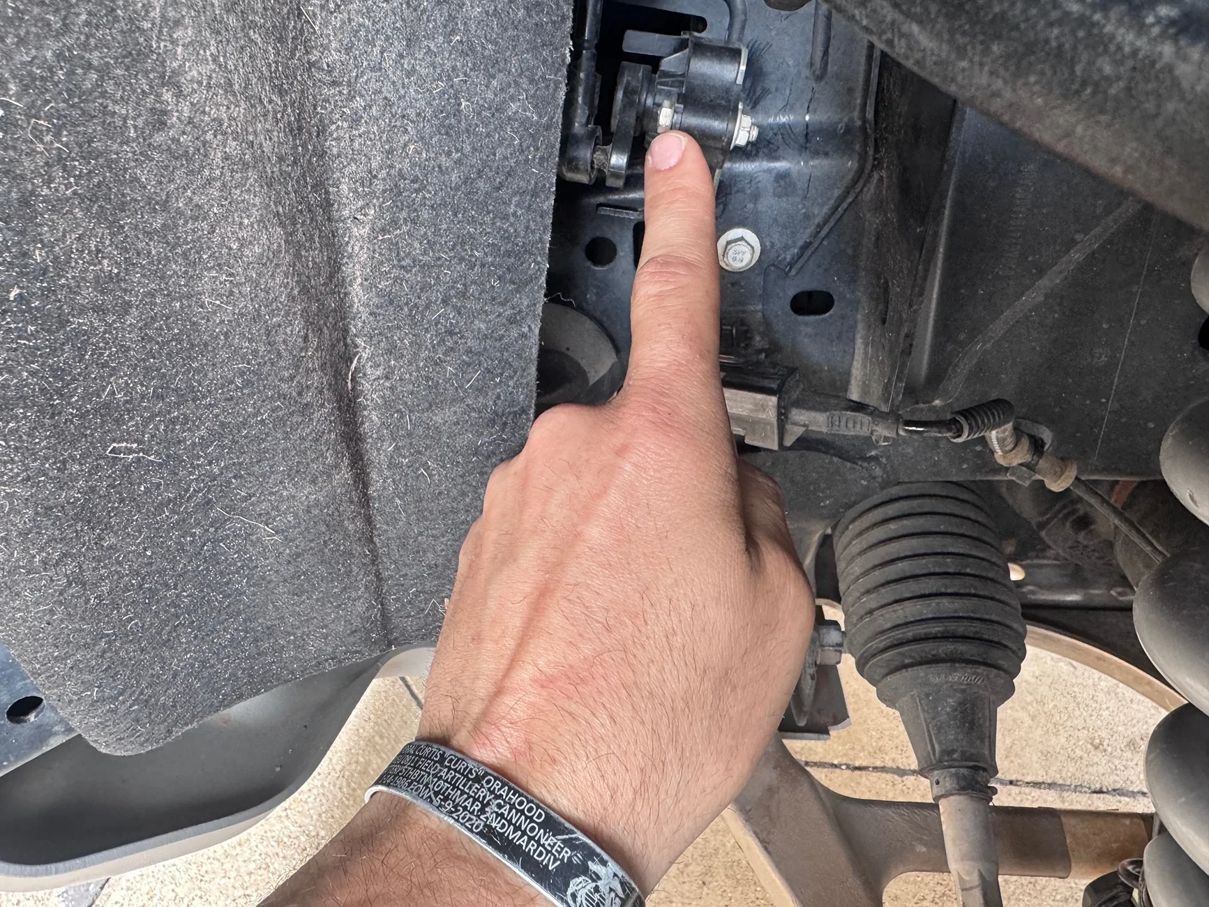

2024 Bronco Raptor
Ford Bronco Ride height calibration issue IMG_7713
Wender85
Wender85
Jeremy
Apr 16, 2025
58
34
2024 Bronco Raptor
This is the front ride height sensor

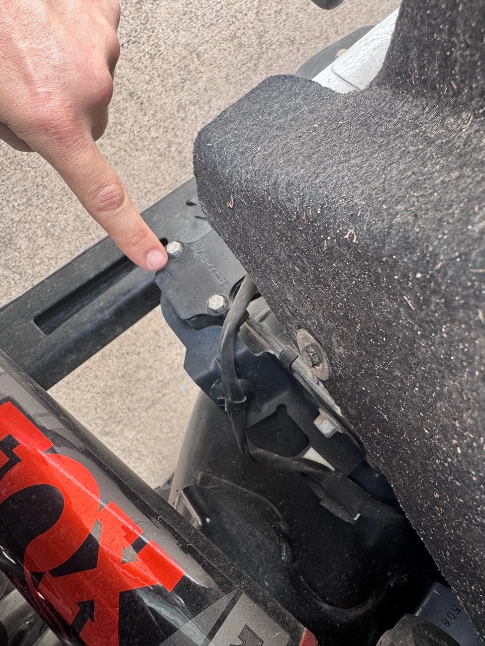

2024 Bronco Raptor
Ford Bronco Ride height calibration issue IMG_7714
Wender85
Wender85
Jeremy
Apr 16, 2025
58
34
2024 Bronco Raptor
This is the rear ride height sensor
