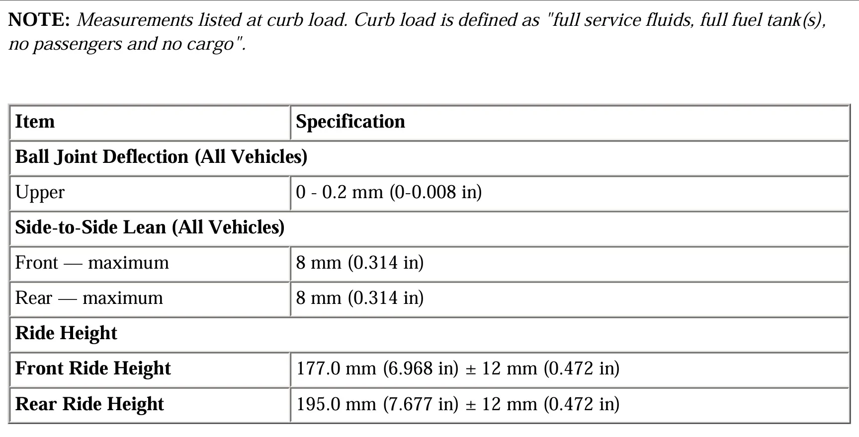

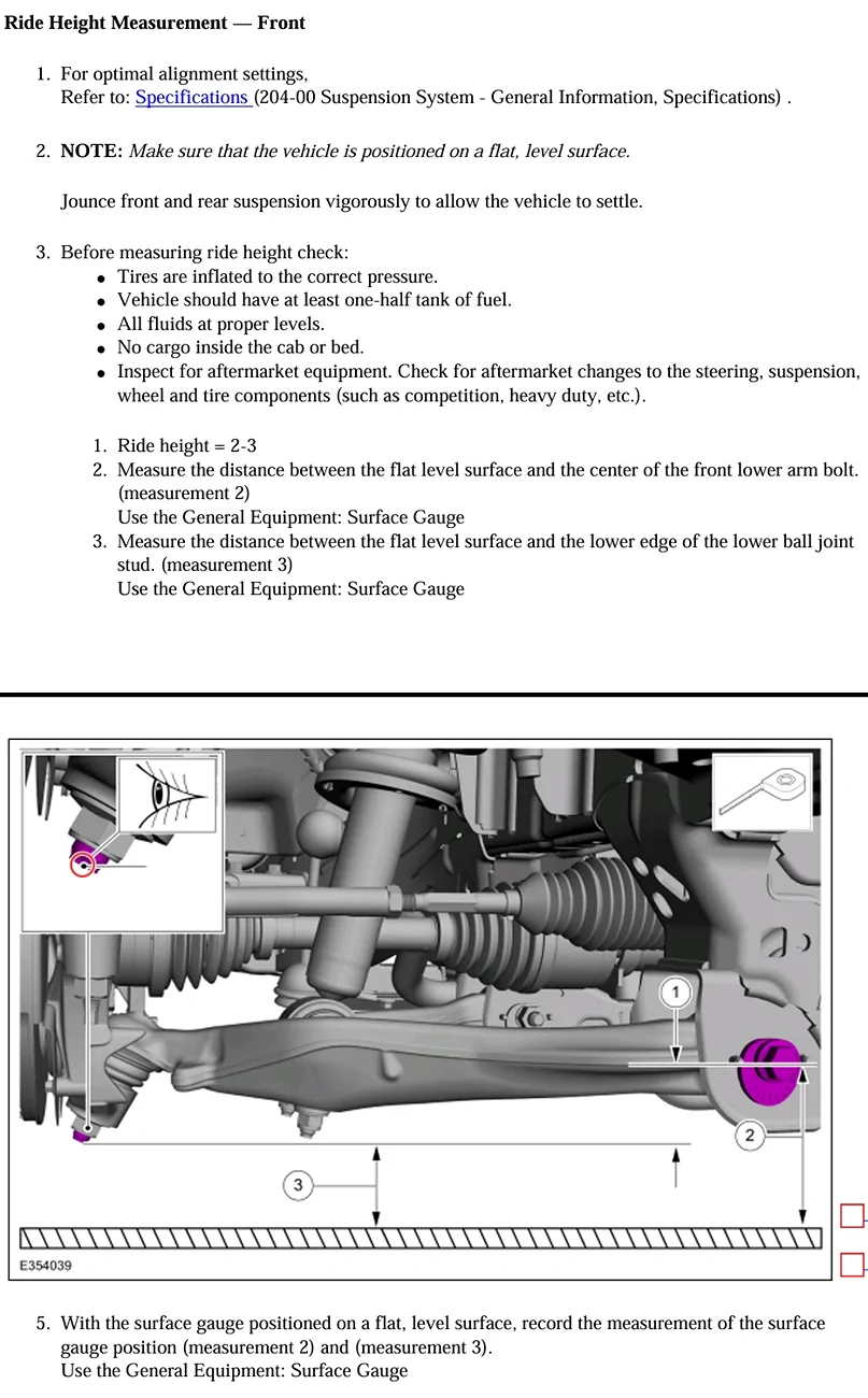

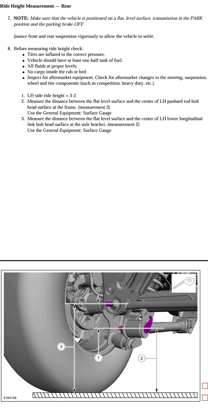

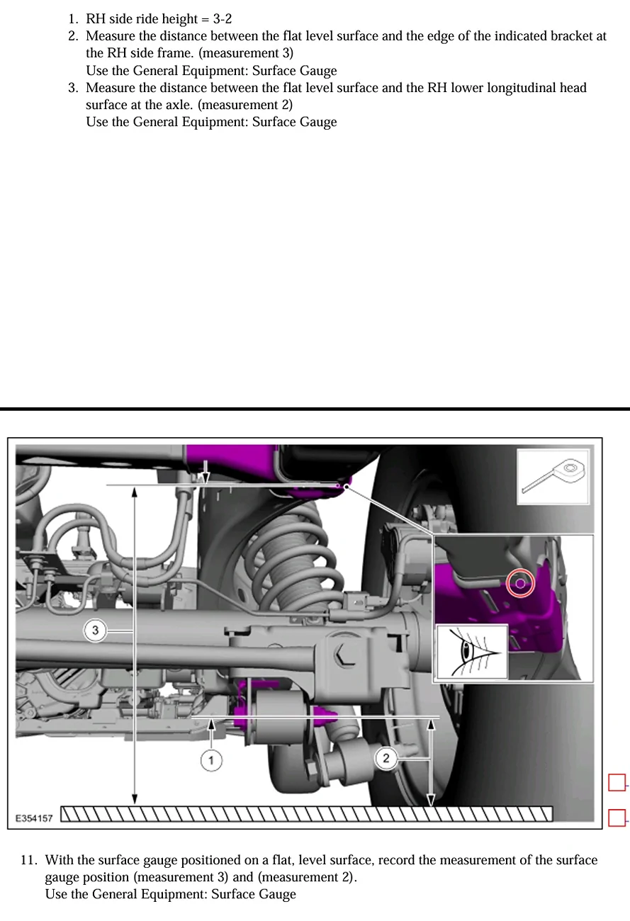

Factory Ride Height Measurements - Method & Numbers

Interesting that left rear and right rear are totally different tecniques but same numbers. I've not measured my own yet but have some likely spring set (factory springs) issues.
Ford Bronco Factory Ride Height Measurements - Method & Numbers Screenshot_20260318-120454
Ford Bronco Factory Ride Height Measurements - Method & Numbers Screenshot_20260318-120644
Ford Bronco Factory Ride Height Measurements - Method & Numbers Screenshot_20260318-120659
Ford Bronco Factory Ride Height Measurements - Method & Numbers Screenshot_20260318-120315
