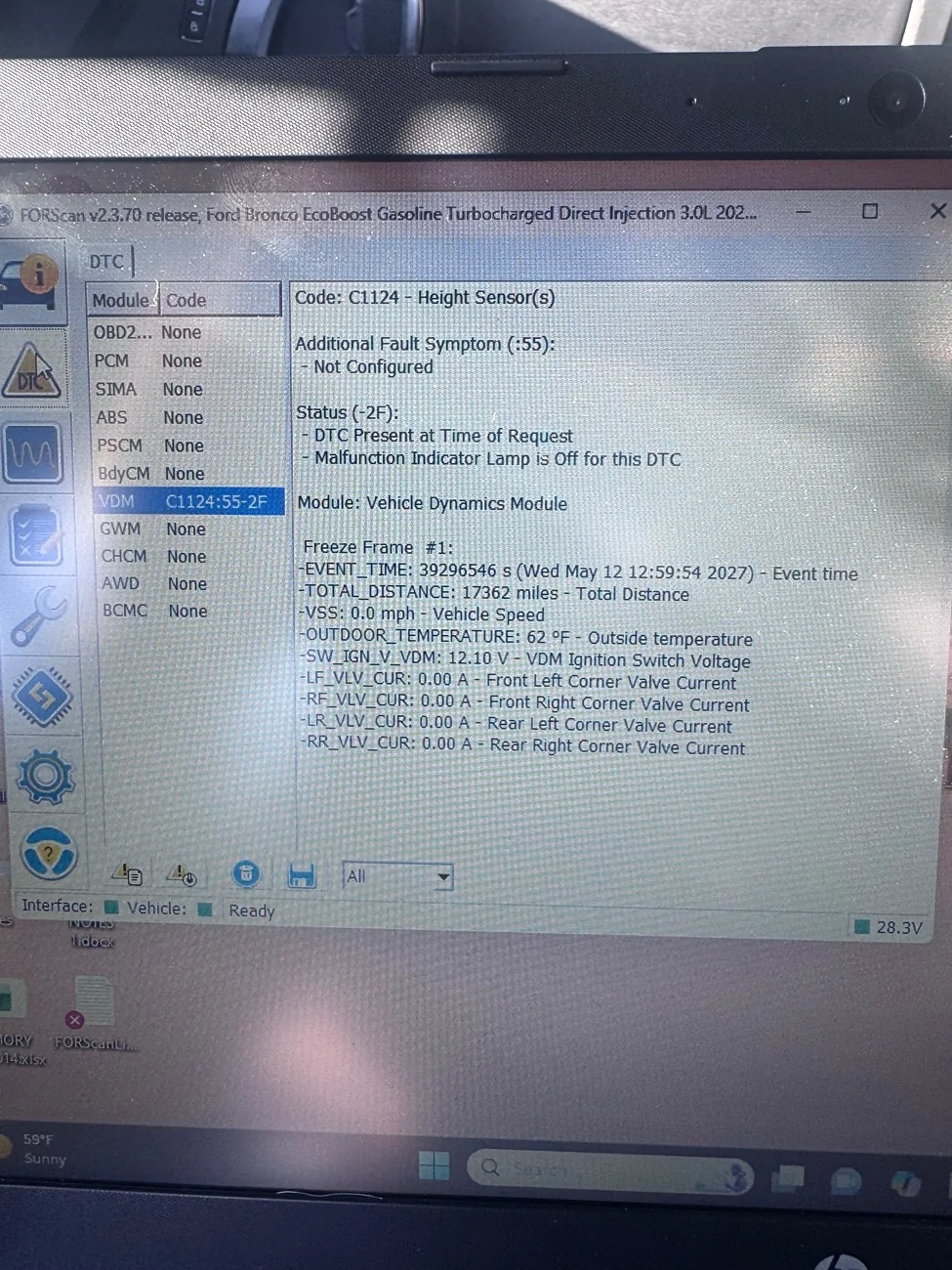

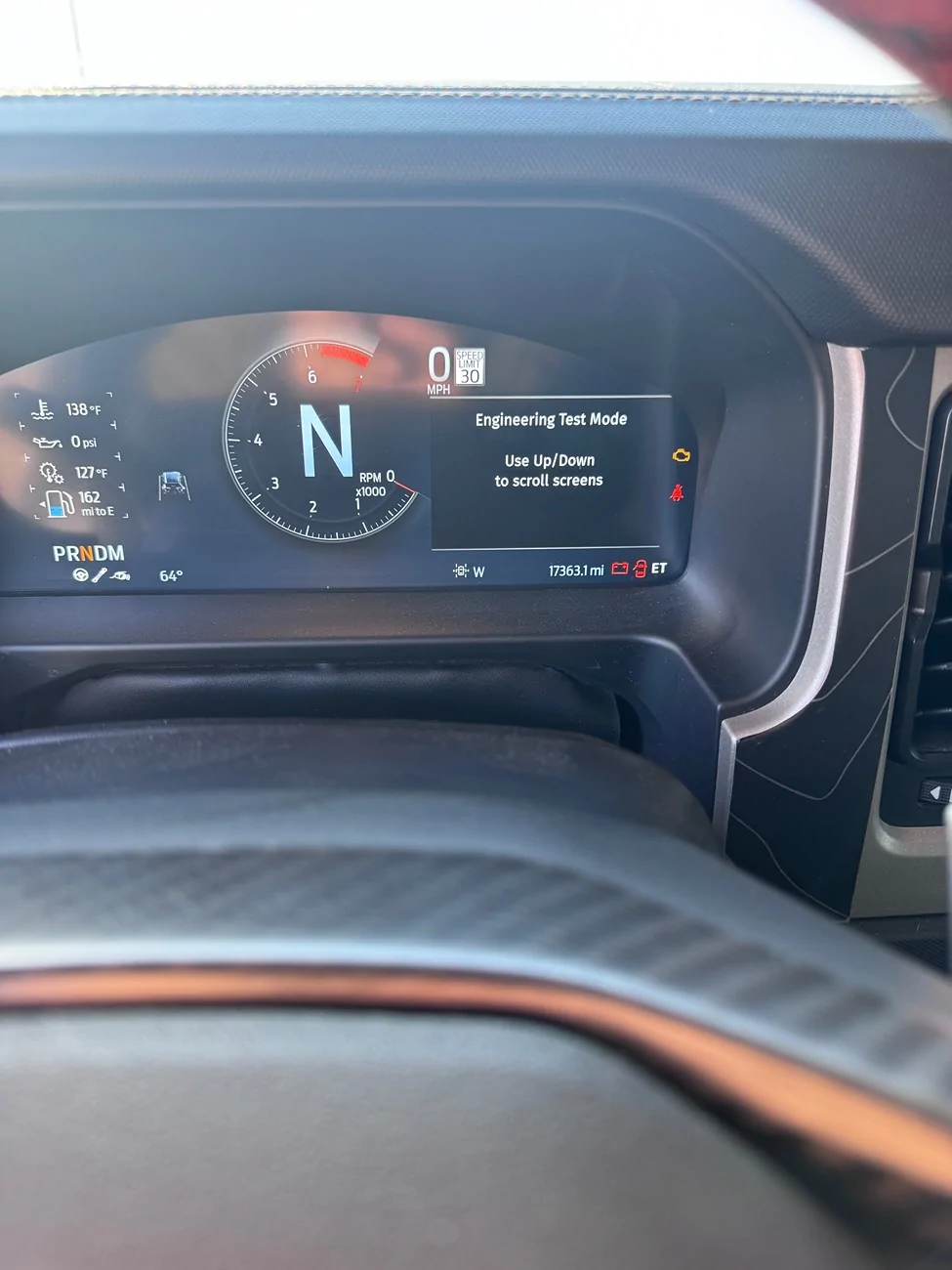

Yeah after seeing that, I’m pretty sure this might be a forscan related issue, not something you’re doing wrong. Because it seems to be going into ET mode fine.

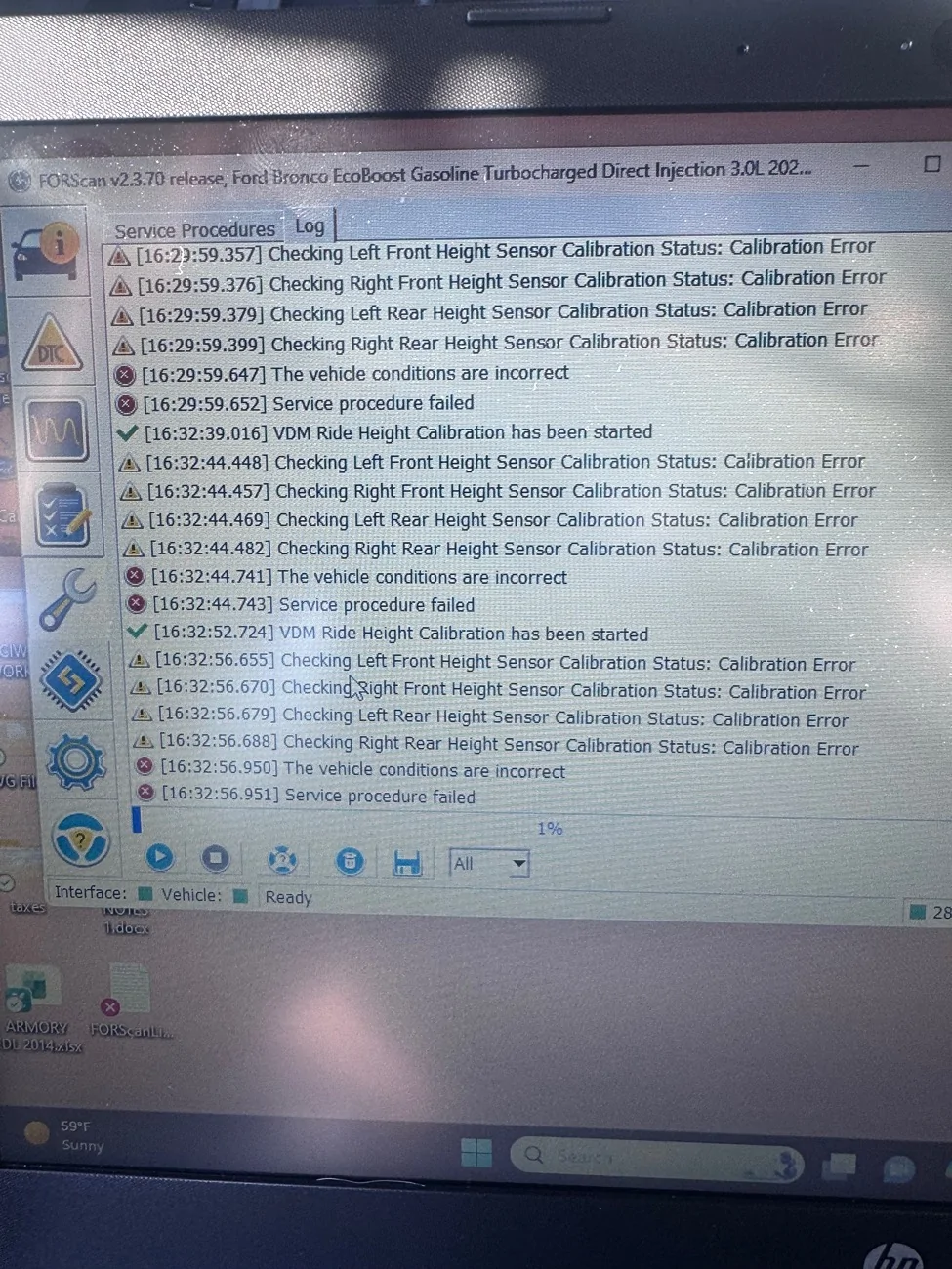

I feel like forscan caused the DTC code. If I take it to the dealership, do you think they’ll be able to clear it and then recalibrate it? No matter how many times I try and clear the code through for scan or my pro cal it stays. Any ideas to maybe clear that code and try it without any errors?

That’s the only other thing I can think of is that it’s not working because of that DTC code. Again that code did not exist until I tried to recalibrate the ride height originally. I do truly appreciate everyone’s help and comments with this!! lol the only thing I have not tried is unplugging the battery for 30 minutes or so. But I will continue to update on here as I start to learn things.
Fun fact, the procedure that you sent me and what I also saw online of putting it neutral and pressing the gas pedal three times did not put it in et mode. I had to turn the ignition on engine off shifted into neutral. Turn the ignition off hold down the OK button on the steering wheel for eight seconds then turn the ignition on once the ignition is on with engine off ET mode came on.

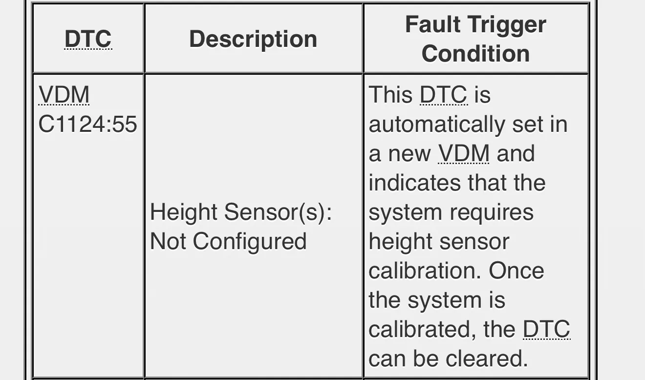

That specific DTC is basically just saying the calibration hasn’t been completed yet. Most likely because it tried to and then failed.
The only thing that will clear that DTC is for the calibration to go through correctly.

For example, and correct me if I’m wrong here @Brian_B, but didn’t you have some type of issue with the parking brake maintenance mode procedure in forscan?
There’s a good chance this simply may not work correctly without FDRS.
That's correct. Forscan is just making a "best guess" based on what they can reverse engineer, and it isn't always accurate, and may very well vary somewhat from model to model. Brake Maintenance Mode was a good example that doesn't quite follow like Forscan thinks it should.
