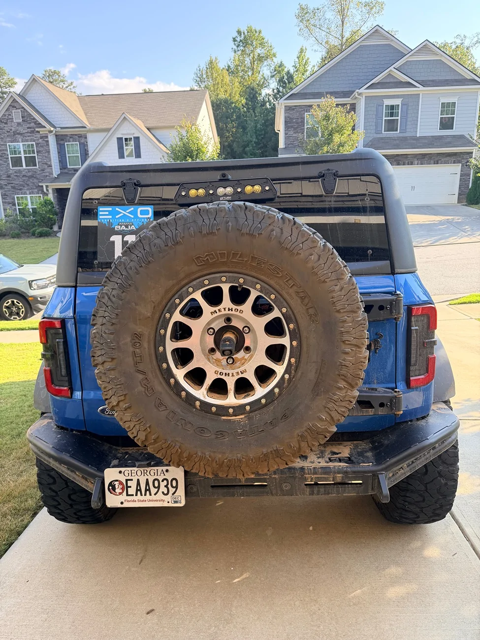

For the rear camera, I struggled finding where I wanted to install. Since I’m running a 37inch spare tire with the Turn off-road reinforcement kit, I wanted to make sure the view wasn’t obstructed. Putting it on top of the brake light was one option and license plate mount the second. I left the wires relatively loose so I can re-asses after a few trips if the license plate mount was the right call. The good news is you can tilt the camera up and down from the mirror so it makes up for the height difference.

Glad you didn't put your rear cam on the brake light like I did.
It shakes so much it's almost unusable as a reliable rear view mirror.
It's also terrible in the rain, and the headlight glare at night also makes things quite hard to see.

I didn’t like the headlight glare at night being so low on the tag frame so I did move it to the top of the brake light which fixed that issue quick. Mine doesn’t rattle very much, which may be from the tailgate reinforcement. I noticed if I lift the camera a tad and tighten it not resting on the light it handles low speed movement better from rattling when I first installed it.
For rain, I sprayed a bit of rainX on a rag and wiped it to on which also helped with morning dew. I did notice an issue with water in the rear connection, causing it to force reverse mode on the screen, so found a tip to add a bit of dielectric grease inside that connection which has done the trick!

Ok, what rear light is that? That this is beefy and pretty cool. Also, are you running 40s? That tire looks ginormous!
