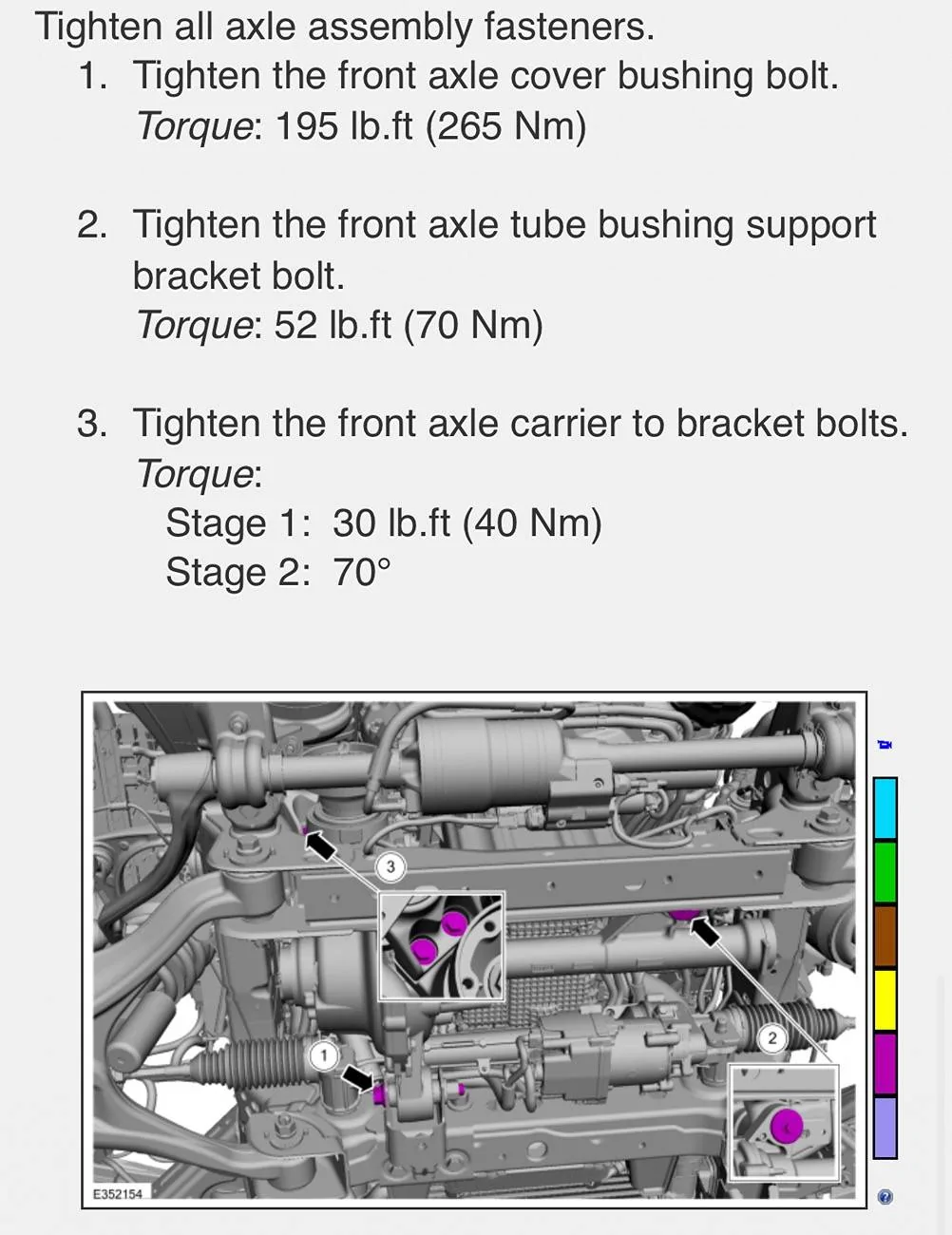

Checking all my bolts underneath, what's this guy's spec? My PDF is corrupt or something for this section. Online ranges from 49 to 106ft lbs. If you have the other FDU mount specs that would be cool, the circled one was only at ~30ft lbs. M210. TIA!

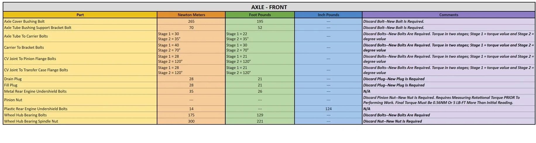

Not sure exactly which bolt on this chart is the correct one - but this is what I got:
Ford Bronco Resolved! - Need a torque spec - M210 FDU bolt Untitled
From this worksheet

Thanks! Yeah, I'm not sure either. Sounds like it could be the "Axle Tube to Carrier Bolts". I'll have to go see what part is what from the chart.

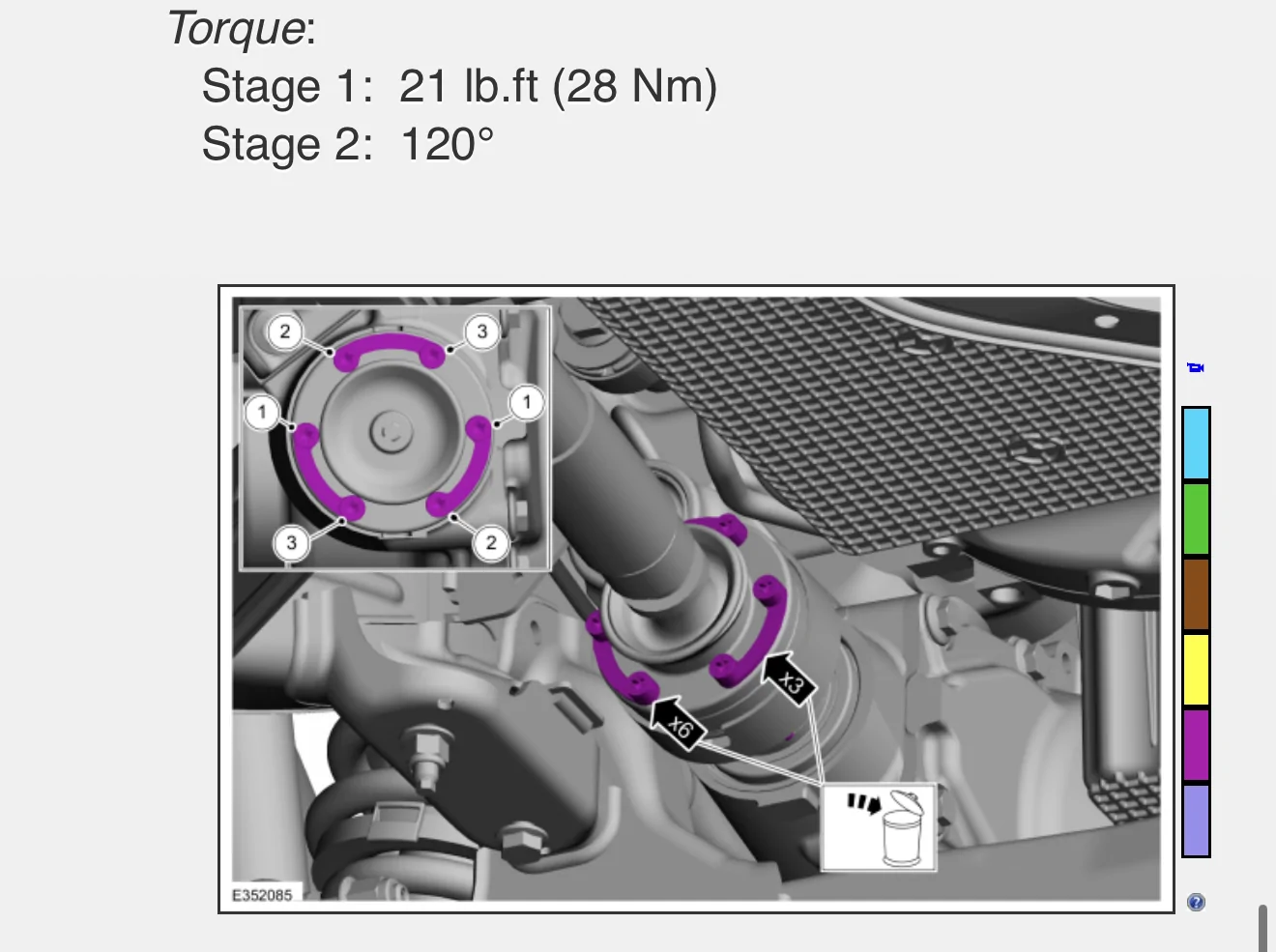

I am in the middle of an fdu swap (m190 to m210). What are torque specs for front drive shaft torx bolts to fdu?

Awesome. Thank you. Wanna get those bolts correct.
