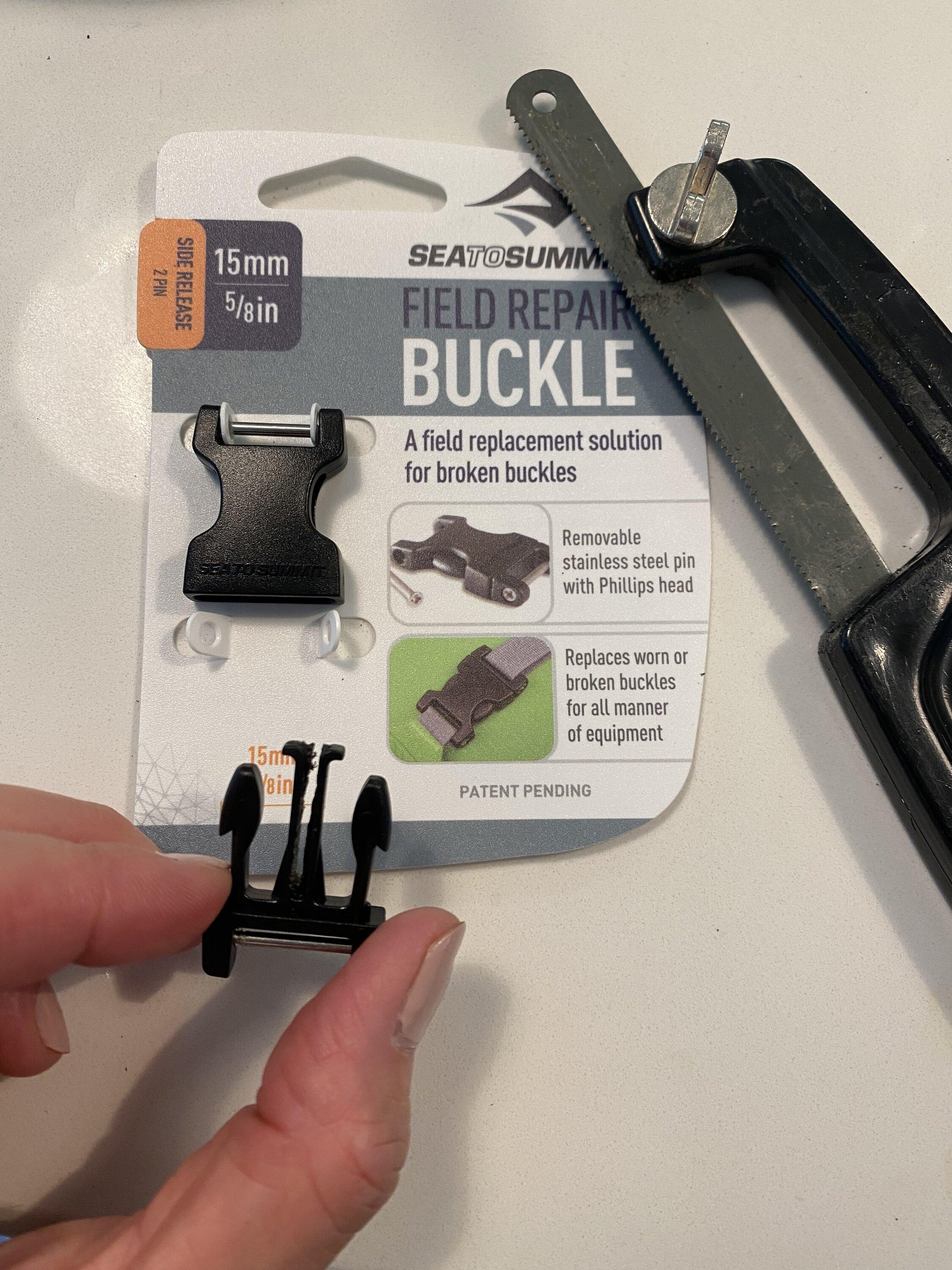

I know this thread is a little old. I am in the same bind with two broken buckles on my soft top windows. But I bought these 5/8 2 pin Sea to Summit buckles from Bass Pro Shop and used a compact hack saw and was able to file down the middle park of the clip and it fits into the female piece of the window!!! It’s not pretty but it works!!!
I need a fix for this as well! I wish someone would come up with something..... I broke one of my clips the 2nd time I removed the rear window... then a a second one broke just last week when installing the side windows. I am not pulling tight or hard... the little middle plastic piece just snaps off so easy!
I need to order some of these but want to confirm the size.... OP says .75 in and you have 5/8 in that you got to work. This shouldn't even be a thing.

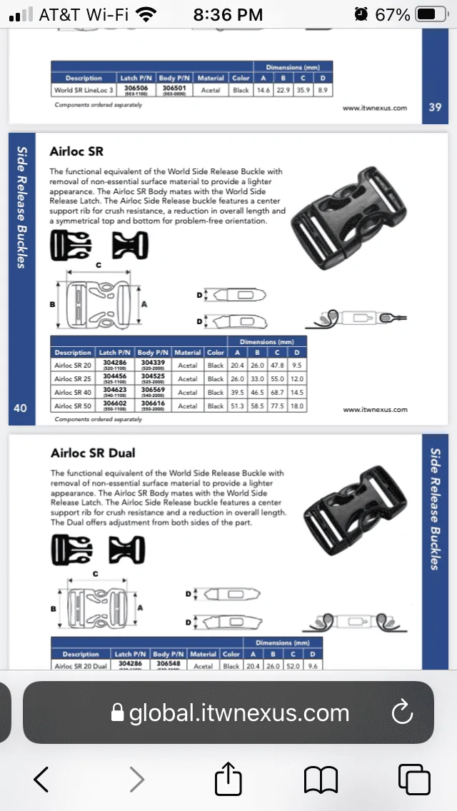

Same issue. The markings on the clip on mine indicate it is made by ITW Nexus Global. Here is what I pulled from the company web site so worth a shot to see if you can order and replace. Looks the same. Does not address the stich issue but work on that next.
For stitching, I would suggest going to a cobbler/shoe repair shop. A lot of those guys fix many things other than shoes, and have the tools and skills to fix it correctly.
