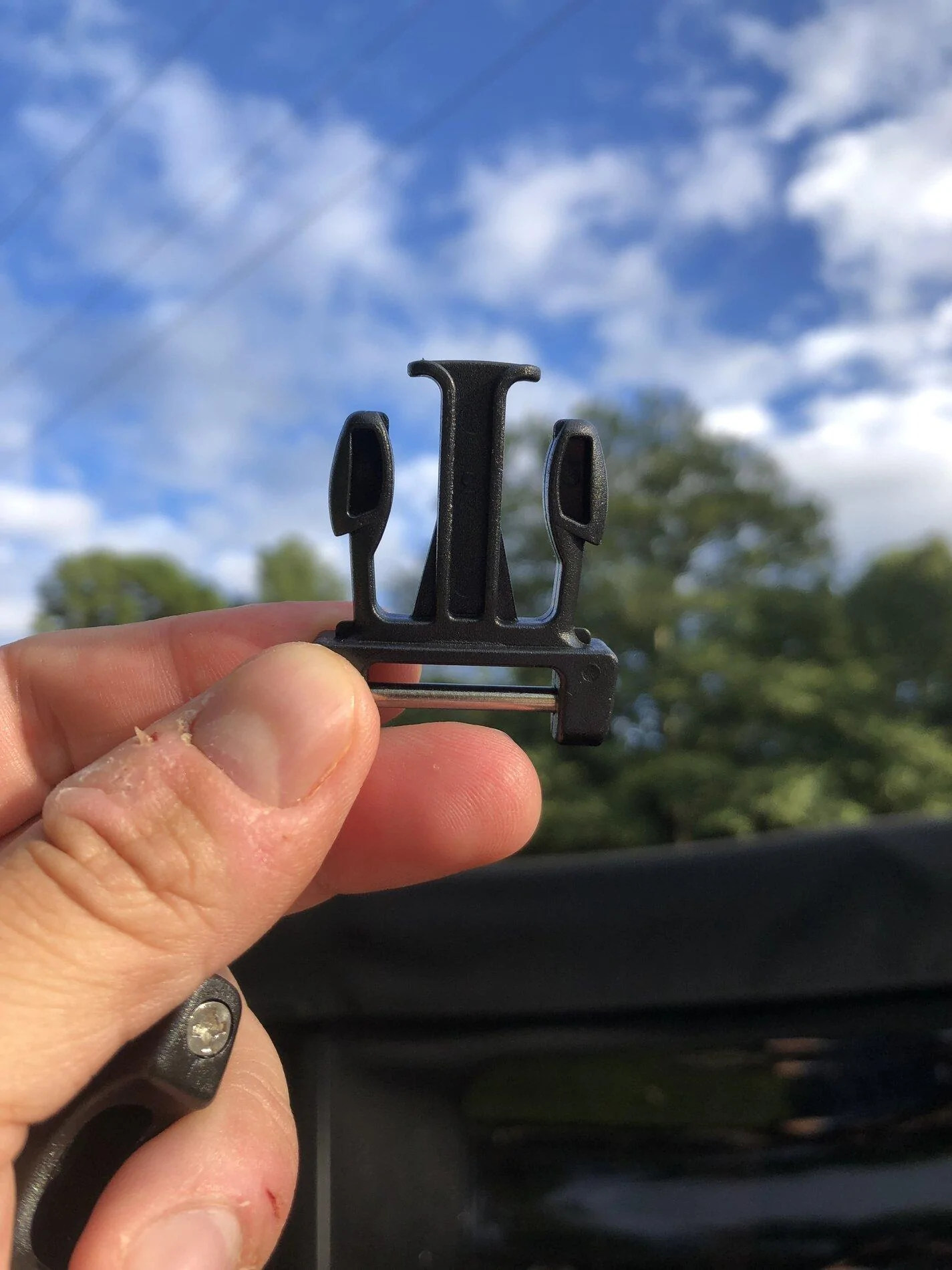

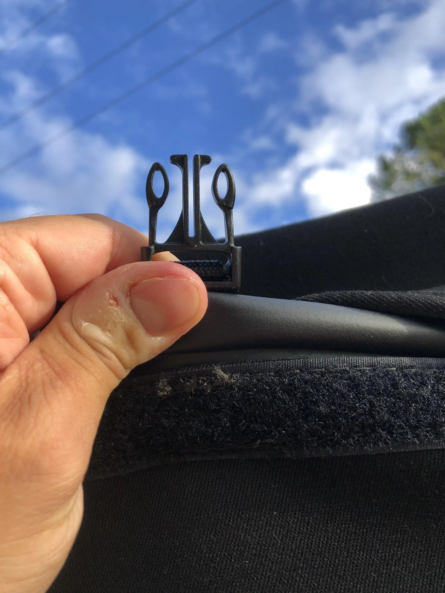

Update: I finally got the right SIZE male pieces, but I have a problem that has put my repair effort on pause.
Here is what the factory male piece looks like. Note that the middle section of the center tyne is empty.
Ford Bronco Repair in Progress: Plastic Soft Top Window Buckles IMG-2395
Here is the replacement piece. The center is solid. Thus, it will not slide into the female piece, which has a little center in it.
Ford Bronco Repair in Progress: Plastic Soft Top Window Buckles IMG-2396
I cannot find any other male piece options online that are empty in the middle and also have a way to put them on like this one does (with the screw) without cutting and sewing.
Any suggestions?

Use your choice of tool to cut/sand/file a slot in the replacement piece so it will fit. A dremel tool is one way to do it. I would use a band saw or a table saw - depends what you have available but watch your fingers!

I don't have saws, and they might destroy this thing. Don't have a Dremel either. I'm leaning toward filing it. It doesn't have to be cleared out all the way down, only about 3/4.

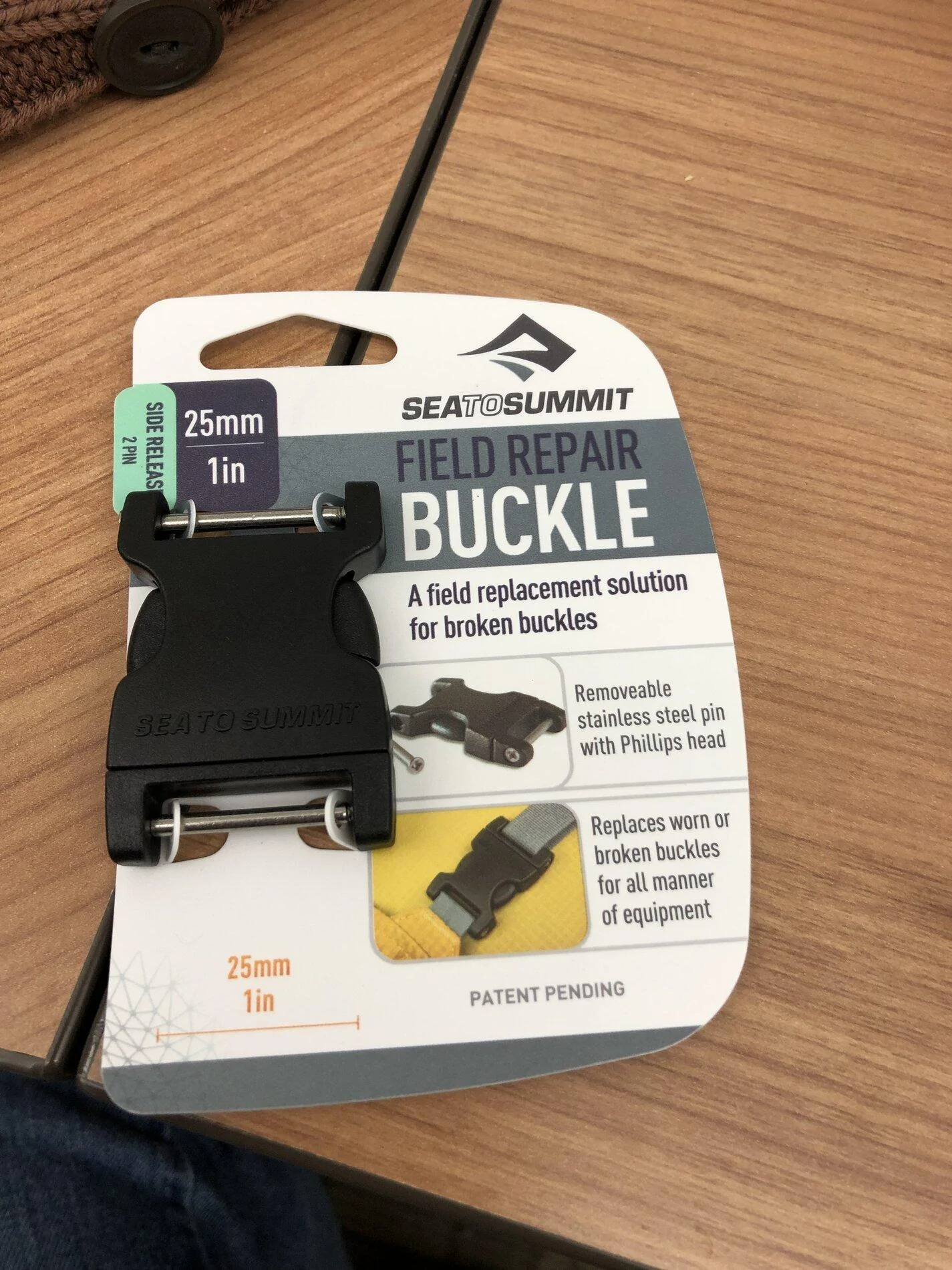

I had a clip break on me. Crazy brittle and defective from my perspective. I have appt for dealer next week but wanted to see if I could have a temporary fix.
I went to REI and bought the Sea To Summit field repair side release clasp. I tried both .75 and 1” and neither work.
Even after modding the center, it would not go in. The .75 male buckle is still too large overall to fit into the female part on top. But this type of buckle is exactly the type that Ford needs to provide dealers.
It is insane to have these connectors without easy replacement option. Still looking for a solution. Anyone else out there with broken connector(s)?

I found a near identical match at hobby lobby - fits a little bit more snug but does clip in place.
