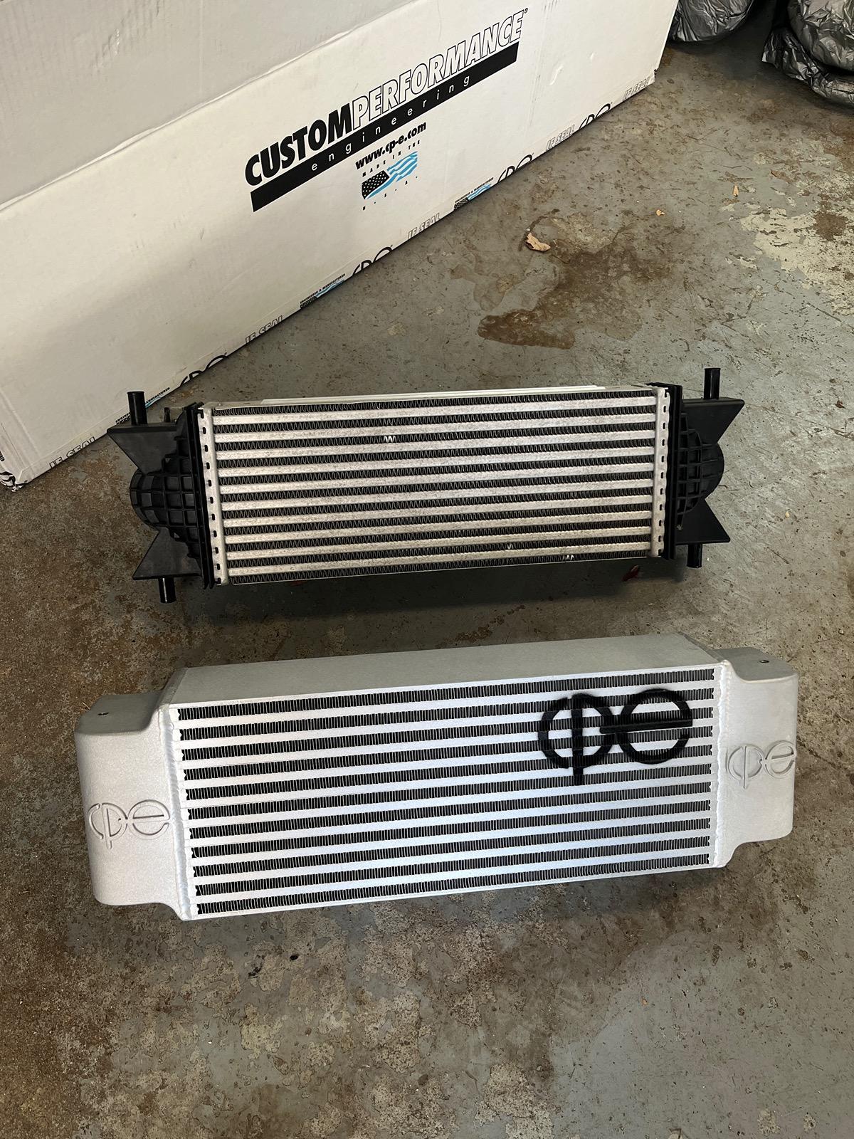

What benefits would I get and how difficult is that process?
Not much use on a stock motor. There are other options that should come before an IC. The "heat soak" trope is overused. The factory IC will be fine. What is almost always neglected with the heat soak statement is; it will always soak sitting in traffic which is where the vast majority of driving is done for many. And once it does soak, and it will, it also takes longer to shed the heat. The advantage to a larger IC comes in to play best when, your engine flows more than stock and you can prove the IC has become a choke point.
Hmm. Usually when I’m stuck sitting in traffic my boost gage is pegged at 0. Nothing for the IC to cool if there is no boost.
I don’t necessarily disagree with the rest of what you say though - you make good points
Hmmm... so how is Air getting into your intake? I understand that the turbos are adding no additional boost But I would think that the incoming air still has to transit the turbos (an even though they are not adding boost they are probably rather hot) and while doing so would pick up additional heat, then transit the intercooler to hopefully shed some of that heat. Unless there is some other path for incoming air when not in boost that I my engine does not have.
The heat the intercooler is removing is coming from the compression of air. 0 boost = 0 compression. It's the same process where air compressors get really hot, but if you are venting an air tank, it gets really cold.
The turbos as a hunk of metal aren't really contributing to the process, as that would get pulled off relatively quickly since it isn't generating any more heat (at least until the next boost event), and the bearings and such are being oil cooled.
If your point stood - then that would be similar to running your radiator fan to keep cooling your engine block after you shut the engine off. Sure, there's some residual heat and you may see a momentary jump in a temp gage just because flow has stopped, but the temp isn't going to keep going up because there's no more heat being added.
So you aren't going to get heat soaked sitting at 0 psi boost. Naturally aspirated cars don't typically have intercoolers.
I am not suggesting you will even come close to heat soak when at 0 boost.... What I am suggesting is that much like your coolant IF you continued running it through the block after you shut down would come out the other end hotter than it went in.... You are right that it is compression that contributes to much of the heat gain when boosting.... But I will contend that the turbos ARE adding heat to the incoming air. The Turbos run very hot. And no they will NOT cool the incoming air they will heat it. The air is not expanding as it would leaving a tank.
Is an intercooler even necessary when at 0 boost? I think you are right... Probably not.
I guess where I took umbrage was the absolute of "nothing to cool." Where in relative terms you are correct...
Hmm.. would make for a good experiment. I may see if I can get the right parameters to data log on my ProCal tuner and see what it does in real life rather than me just guessing based on what I see at work.
You may be right, it may add a very small amount of heat even at idle (I don't think so, but I'm not above admitting it's possible), but I would bet that if that were to be true, the amount would be inconsequential and so much smaller in relation to the size of the intercooler. That, and the original point was someone saying you get heat soaked sitting stopped in traffic... so I don't want to get too side-railed from what my original point was.

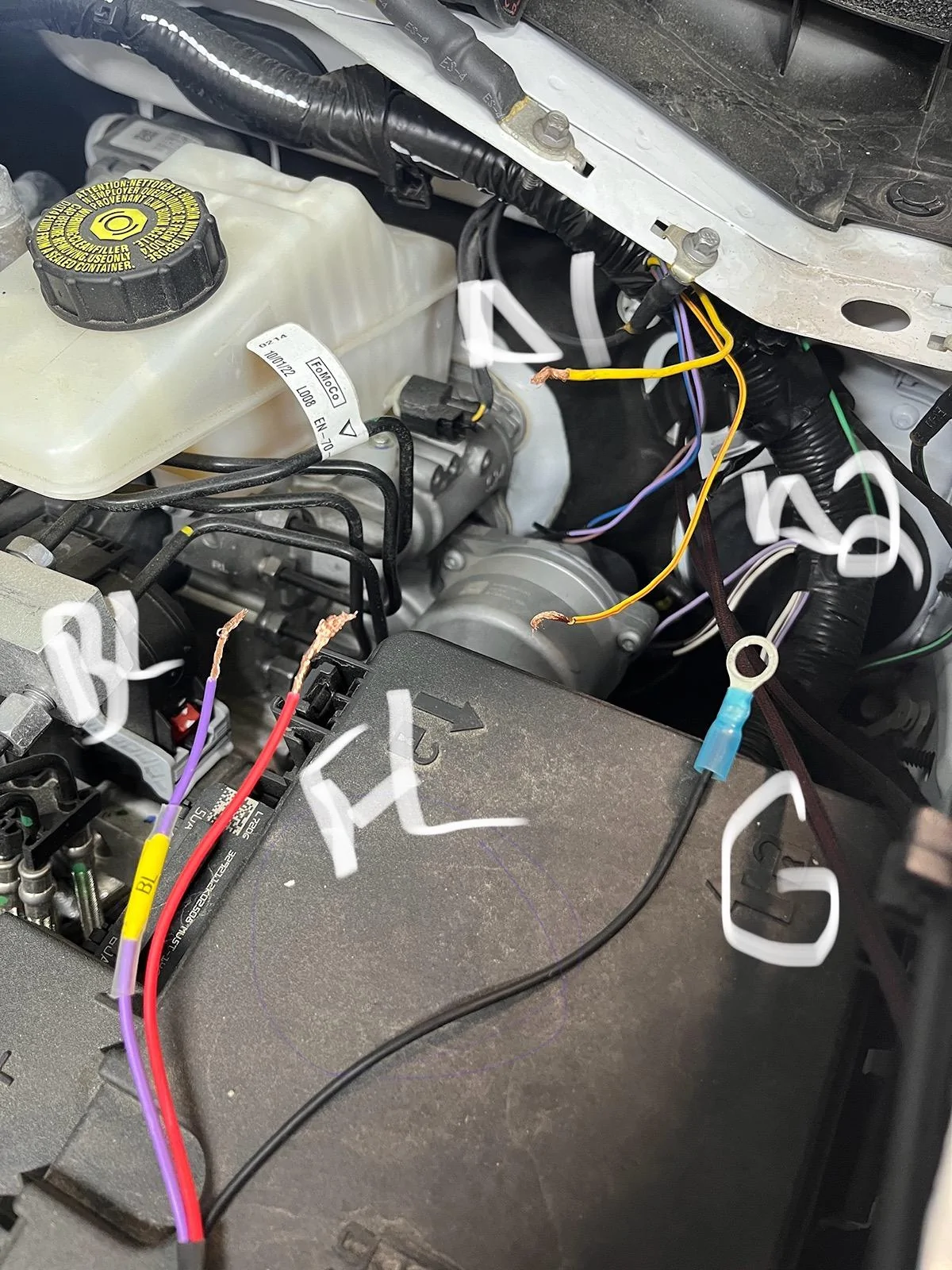

Ok well fellas need some help. Good news is I got the inter cooler in. I also got the dv8 bumper on. I am now stuck on wiring fogs and light bar
I have two fogs plugged into a harness I got from 4x4 leds. I am trying to wire the fogs to aux 1 and the back light to aux 2. Then there’s the ground.
No lights come on when wired this way. With the ground mounted the aux light box doesn’t even light so not sure what I’m doing wrong here
I took a picture. Aux 1 and 2 wires. Fl = fog light , bl = back light , g = ground
First thing I would try - mount your ground up at that ground bolt and then take each wire straight to your battery (+) and make sure the lights work. Just touch the wire. If there’s a short or anything it’ll get hot fast (or pop somewhere) and you can just pull it back off
Once you know the lights work it’s a matter of making sure you have the right wires for the right aux switches, and those fuses are good. And of course making sure you flip the switch on with auxillary power or truck running.
