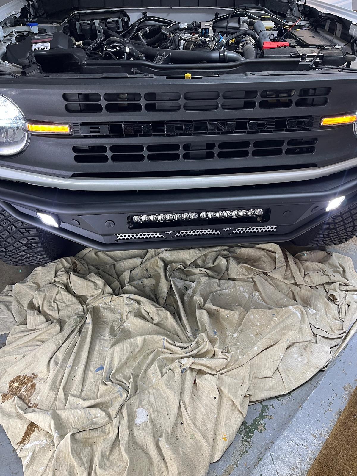

Not sure what I did last night, maybe too many garage beers but i realized I had this wired wrong. Got it figured out now!

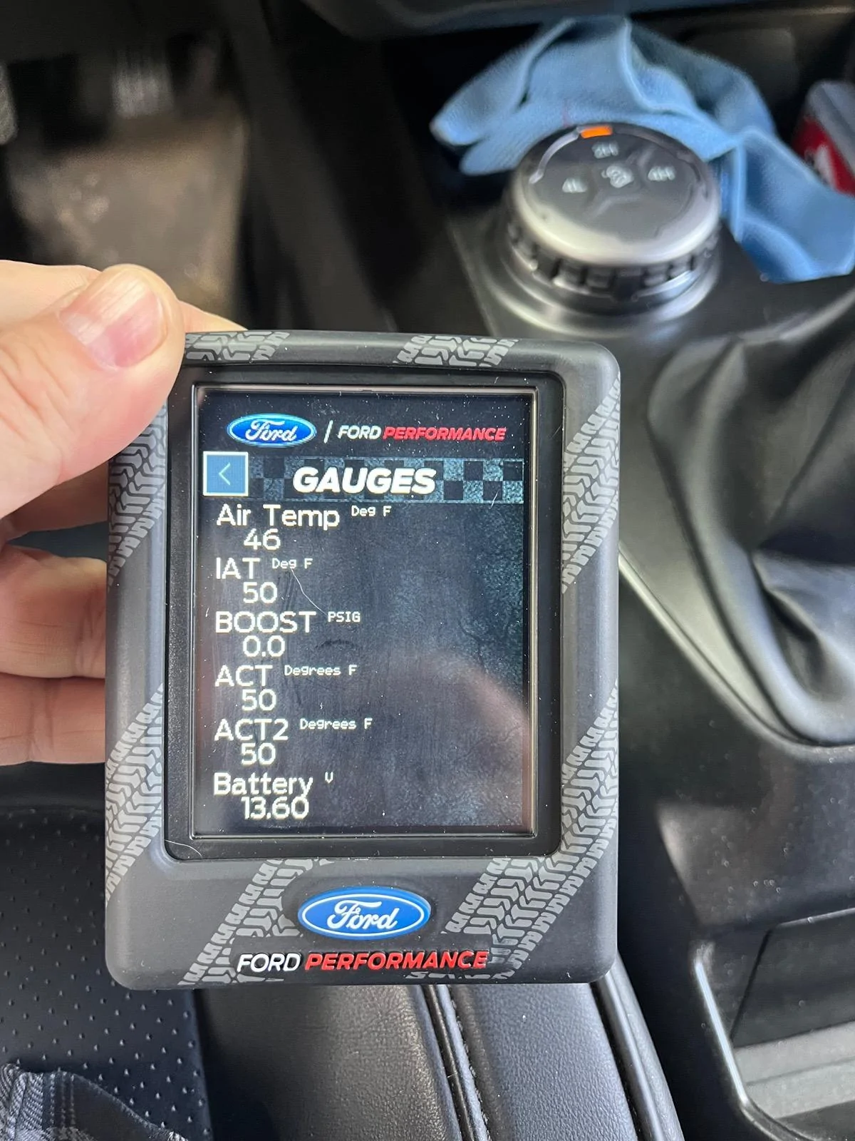

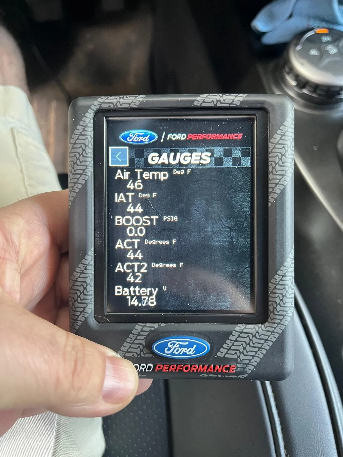

Hmm.. would make for a good experiment. I may see if I can get the right parameters to data log on my ProCal tuner and see what it does in real life rather than me just guessing based on what I see at work.
Got a chance to try this this morning.
Starting with a completely cold engine. I got a snapshot of all the temps immediately after starting it. I let it run idle for about 10 minutes - which is a really long traffic light. The air dams were shut, so no car motion and no incidental air coming from the radiator fan or anything else.
I’ll let folks draw their own conclusions but I found the results interesting. Anyway, I suppose I have derailed a tread about tow hooks enough!

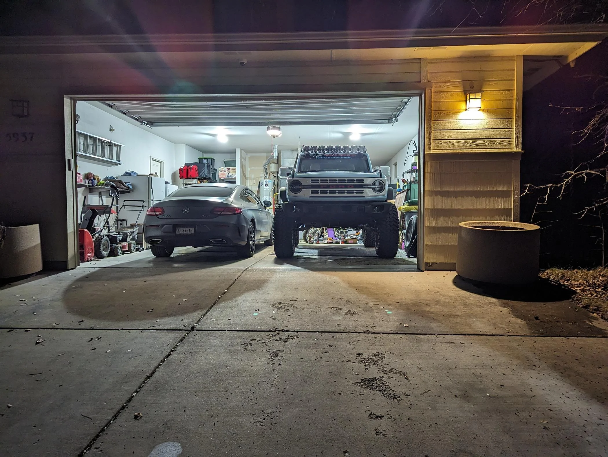

Okay... Look at your axle... front and rear..... see how the axle goes right to the center of the wheel? That is true with every single vehicle there is right?
If you want to increase clearance (the area between the ground and the bottom of the Bronco/axle) you have to get that axle up right? the only way to do that is with a bigger tire. That would make the axle higher off the ground. For every 2 inches bigger tire you raise the axle 1 inch. Now how do you fit bigger tires? the distance from the axle to the body has to be increased. - to do this use a suspension lift, body lift or start cutting away parts of the body....
Now lets look at that axle again.... middle of the axle lines up perfectly with the middle of the wheel.
a portal attaches to the end of the axle.... right where the wheel connects. Now at the end of the axle, instead of a wheel you put a gear. so the axle turns a gear. below the gear you put one or two idler gears. they turn a gear below that which turns a stub shaft that the wheel is now connected to. All the gears go in a housing that is bolted on to the end of the axle......
NOW when you go and look at your axle, the middle of the axle does not align with the center of the wheel... It is 4 or 5 inches above it.... The gear box does make the axle wider (sits between the end of the axle and the wheel) but now you just gained 4 or 5 inches of axle clearance while using the exact same tires.... You also get a gear reduction (at least most portals do a gearing reduction just like a differential does a gearing reduction. This is a good thing. Now you also have more space between your body/frame and the tire... So now you can run a bigger tire as well...
to match the clearance a portal will give you with a suspension lift or body lift or combination... You would have to put an 8 to 10 inch larger diameter tire on..... So to match a portal with 35 inch tires you would have to have a 43 to 45 inch tire.... WOW... but you can put bigger tires on with the portal....WOW!
I have portals and 40 inch tires.... the wheels (not tires) wheels on the car next to me are 19 inch....
Ford Bronco Removing Tow Hooks clears garag
When I am out on the trail I can clear some pretty big rocks......
