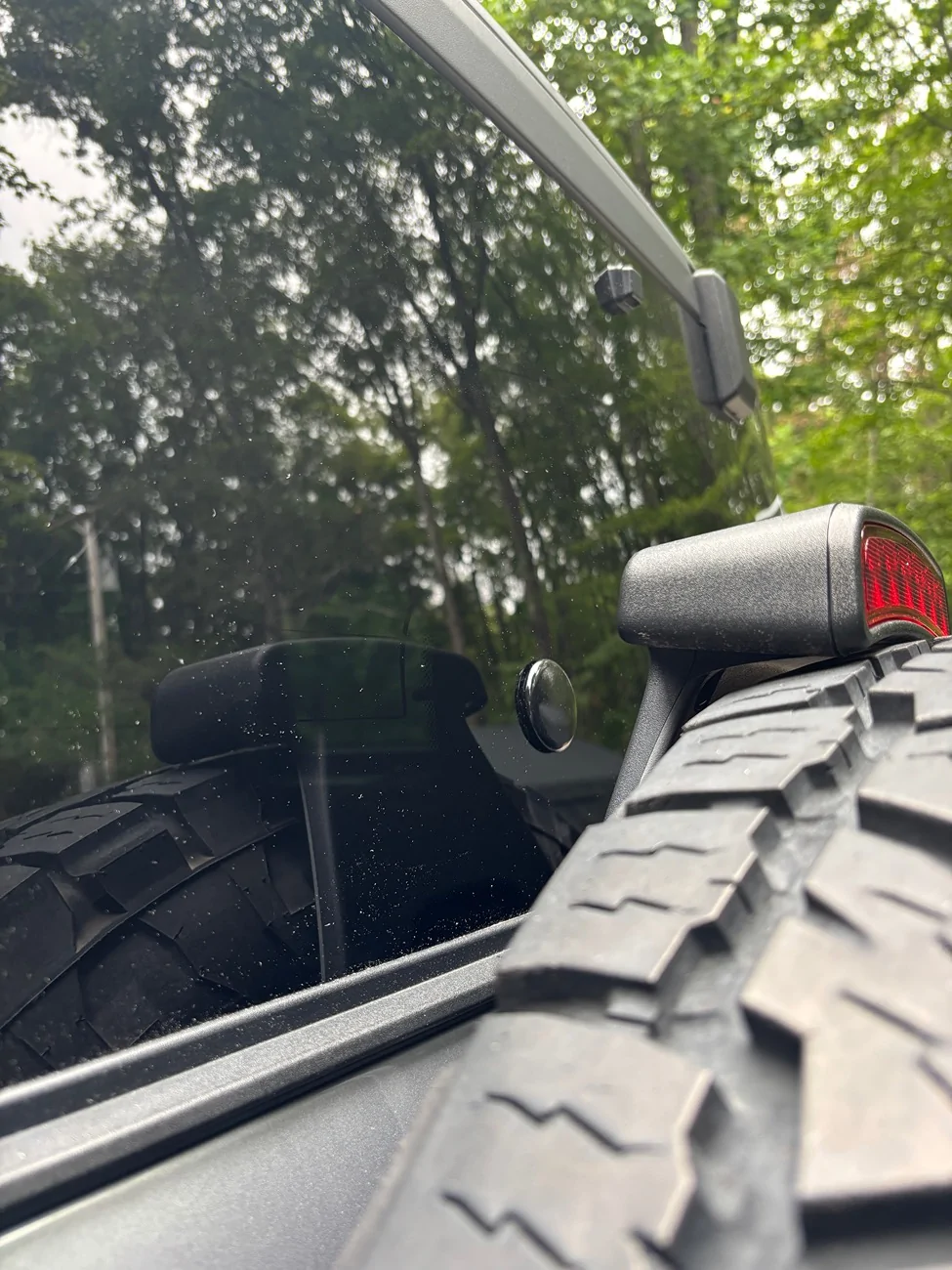

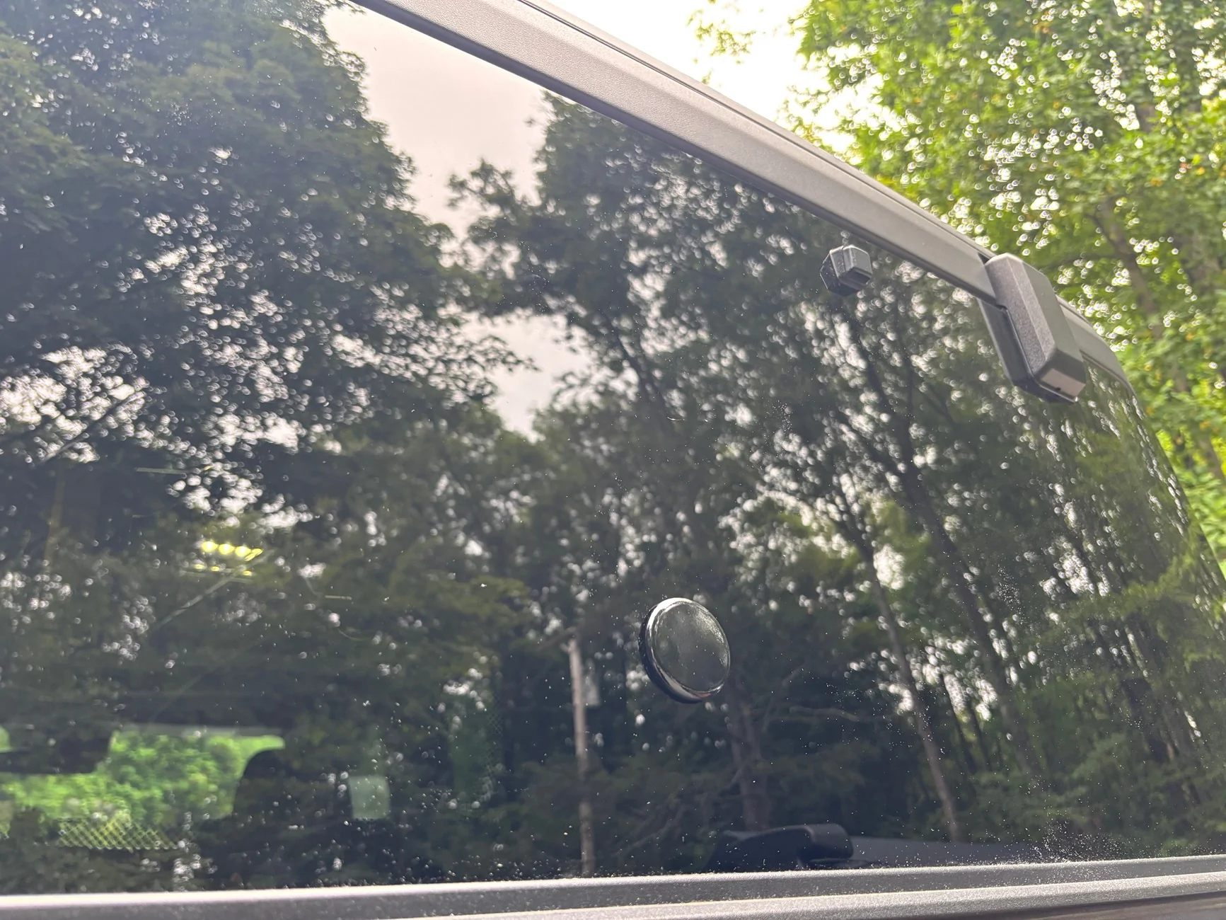

Yes, all came off. Wiper motor / box is held on with an epoxy caulk. Tried a wire thread, no luck. Used a 4" wide puddy knife with a body hammer and just kept working it around till free. I capped the washer feed and tucked the cable in the side panel.
I did not remove the sprayer head on the back window.
Pics will have wait till Friday. If you need the plug for the window I can send later.
Mind posting those pics when you get a chance?
How'd you pry the wiper off? Service manual states using a Two Leg Puller...
