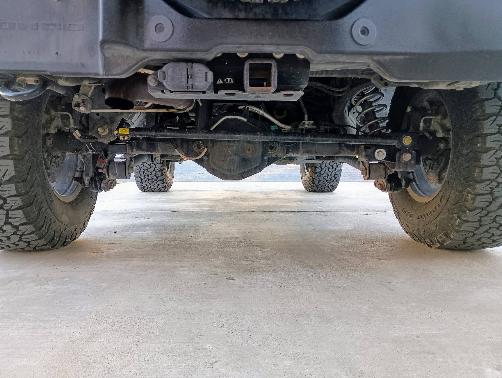

Not very anal... LOL.
Ford Bronco Rear Trackbar Advice IMG_20241119_170614742~2
It’s not perfectly level... But it's close enough.
