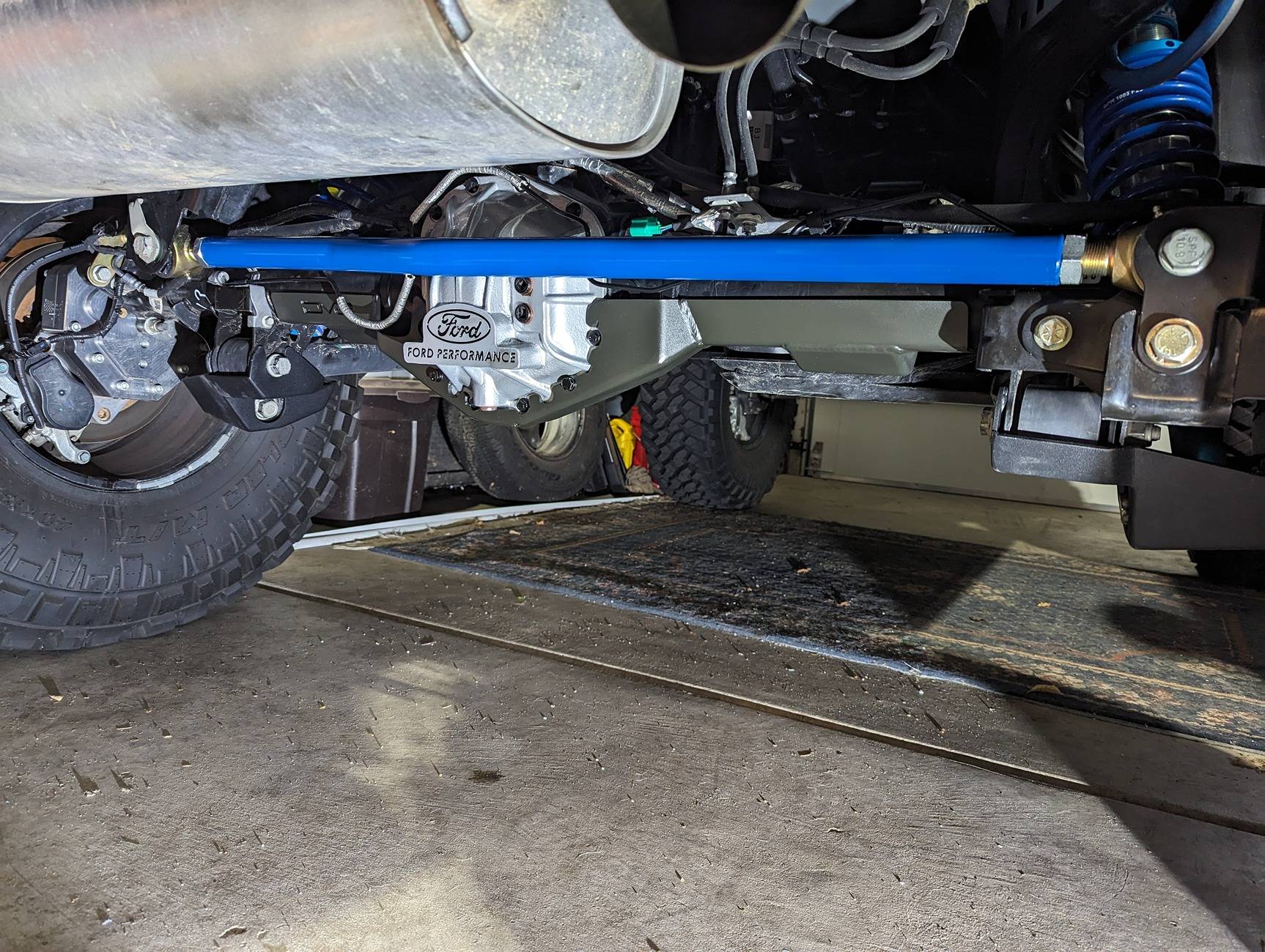

Thanks for posting the pic. I have the Ford HD Diff plate and was looking for something that will work with it.
Be forewarned.... I had to do a bunch of custom cutting to make it fit with that.... NOT that hard but you do have to cut some... I cut a piece of cardboard to match the skid and then marked and cut away at the cardboard until it matched the rear cover.... leaving a little extra room for the drain plug. Once the cardboard fit, I used it to mark and then cut the DV8 skid plate.... Again, not that hard but it does take some extra effort....
