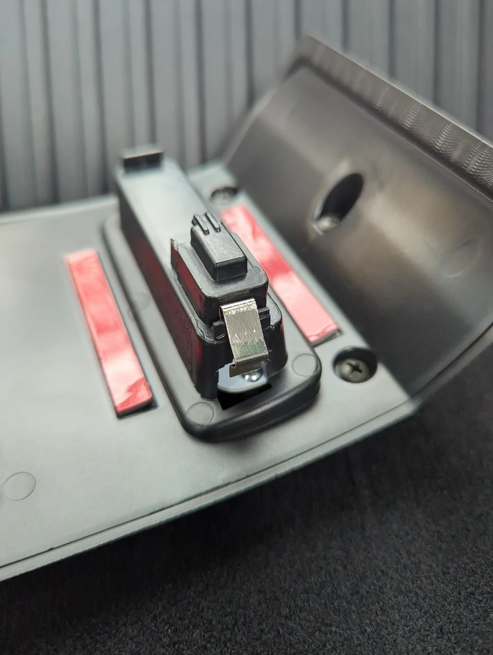

Anyone know if it is possible to order the clips that hold the rear courtesy light?
Removed mine and now it fits loose. Tried using 3M tape, but the tape seems to have issues adhering to the plastic trim.
Seems inexpensive to order the whole light, but seems like a waste.

I'm still looking myself. I'll update as soon as I find something. I'm looking for clips cause I lost it trying to upgrade the light lol

You have to replace the light, M1PZ-13776-CB, Or find a glue that will hold the light in place.
I've only located one glue that will hold reliably, but it's $55. Cheaper to buy another light. Fordpartsgiant has them for $41. I'm sure other online dealers have similar prices.

Can't you just bend the clip out more so it puts out more tension, or am I missing something?
I'm missing the clip on the other side, the tension on the one I do have is just fine

Perhaps just bend up a clip from some metal yourself?

Perhaps something like THIS

Flat spring steel. Go buy a cheap tape measure of similar width. Take it apart and get the spring out of it. Few pr of needles nose pliers and a file. You should be able to bend one up easy enough. Or a cheap pop in retrofit light can. About $10. Another option is to degrease plastic and apply a thin bead of clear Lexel adhesive from Lowe’s. It will hold it in place. Tape in place until cured.
