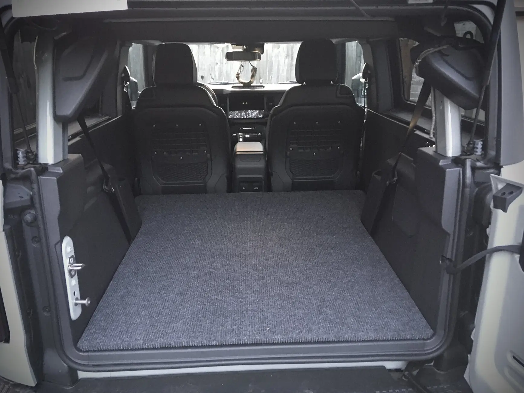

So , you are looking for a liner that goes from the tail gate to the back of the front seats , contoured to fit the floor AFTER the rear seats have been removed ... correct?
I can't imagine that being mass produced, though there are a few storage systems made for the 2 door.
For home made,
You might consider building up the low spots to create a flat platform using plywood etc , and then go from there.
Make the flat bed piece.
build up the front edge and sides (or all four) with a thin strip of wood.
Raptor line or "truck bed carpet" the entire thing.
For examples/ideas, I did a google search "2 door Bronco with rear seats removed" ...
https://www.bronco6g.com/forum/threads/rear-seat-delete-diy-platform-2-door.29166/
