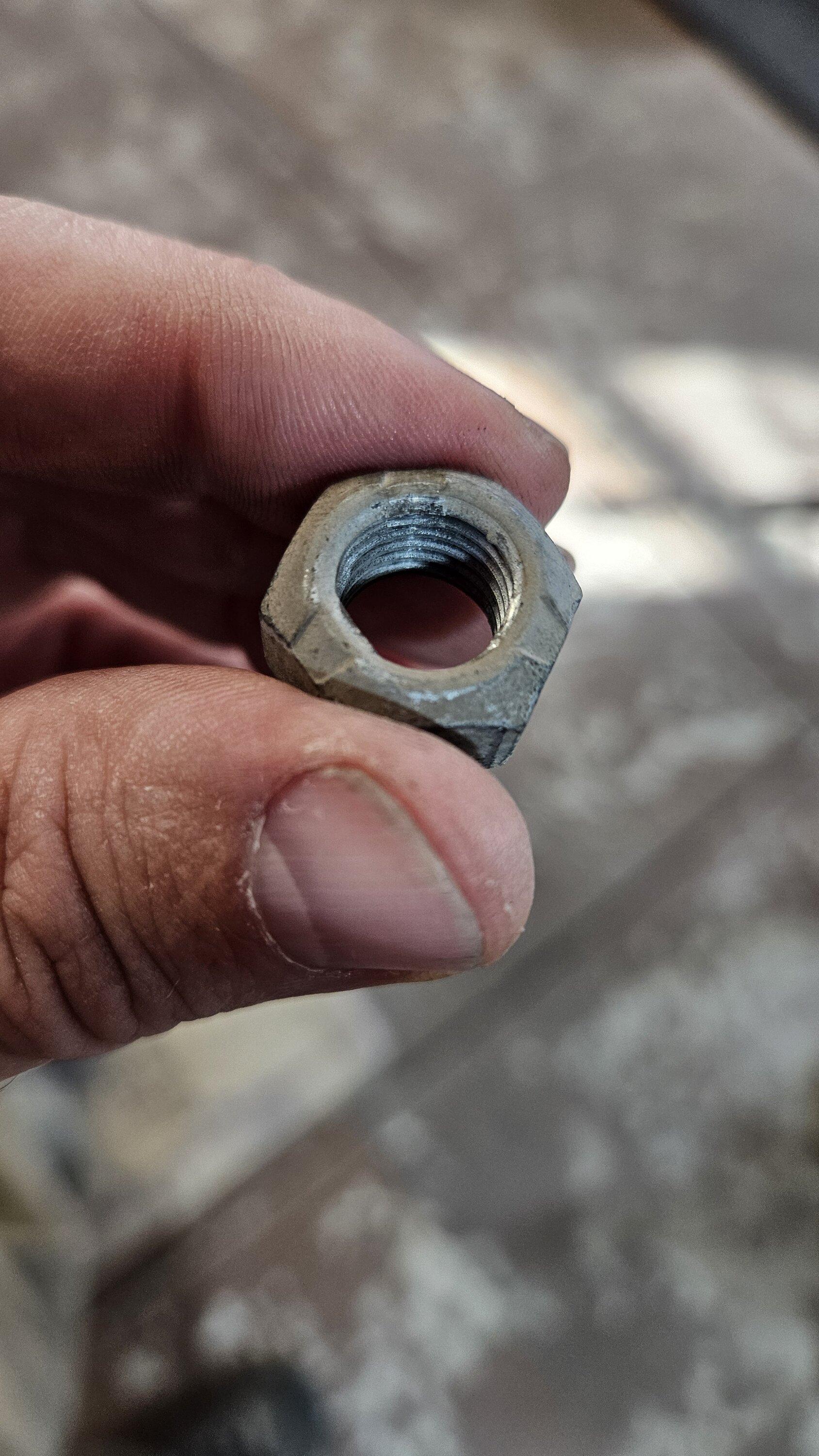

@flip was wondering if you could help me out. The 4 nuts that are not reusable holding rear axle shafts to housing, could you get me the part number for them? I'm assuming that they are a stretch nut??? They're not a lock nut, don't know why they wouldn't be reusable.
Thanks in advance!

That’s a lock nut.

That’s a lock nut.
I take it the 3 pressing squeeze the nut at those locations providing more friction and tighter tolerance? Then backing it off, it's not as efficient for locking the nut on. Therefore 1 time use?
Yes.

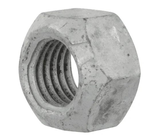

flip
Base Sponsor (Level 1)
Phil
4,838
16,033
IN
www.ruxerparts.com
Fords
NUT - HEX., M12 X 1.5 - 6H (12MM BASE)
