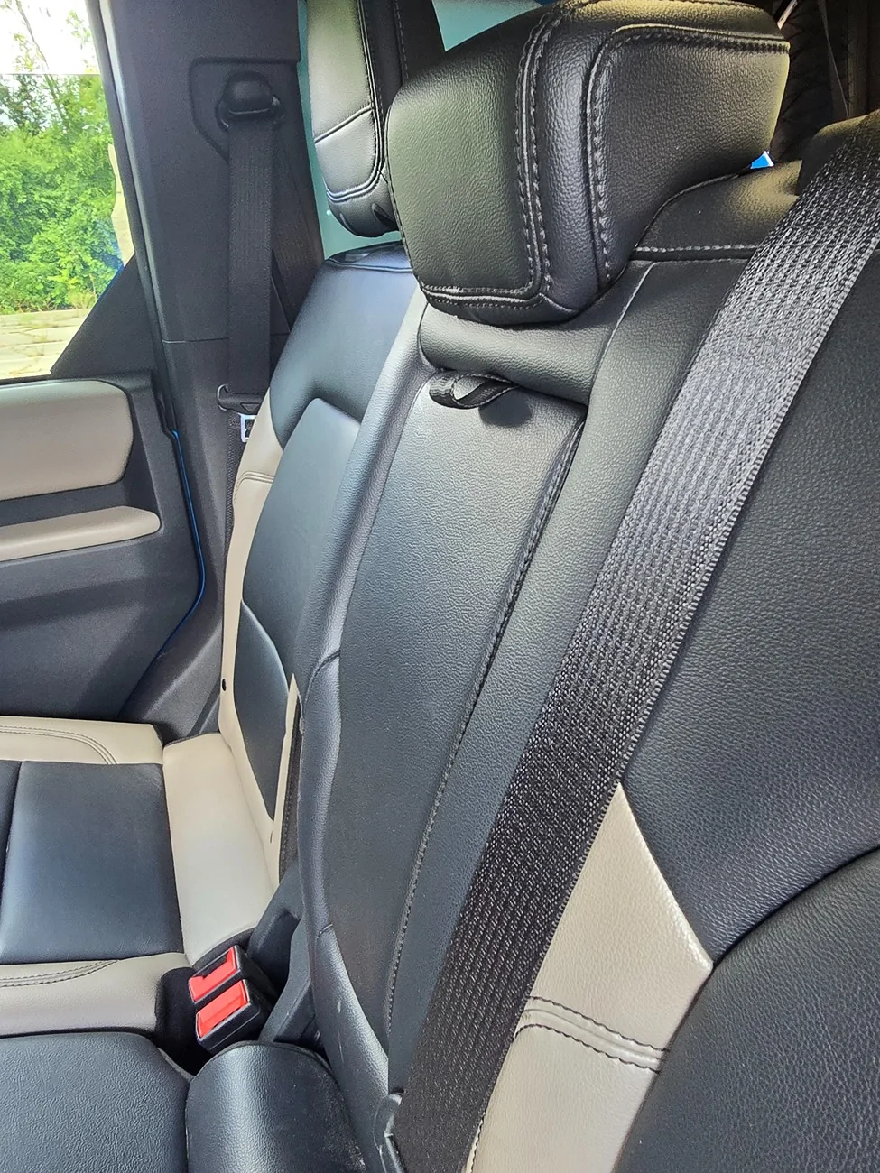

So I got an issue I noticed a couple weeks ago. The rear arm rest will come out a few inches but wont fully open. I was wondering if anyone else has this issue and know a fix for it. I don't have kids or back seat passengers very often. its not a big Issue just curious if anyone else has had this issue.

Has it ever fully opened? Wondering if someone goofed it up at factory.

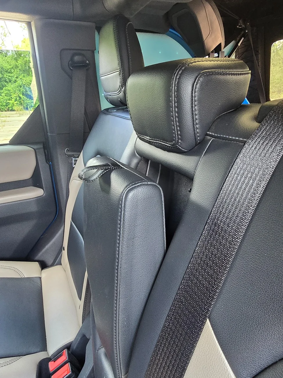

This is as far as it will come out. I cant feel anything in the hinges as well. Im stumped.
Ford Bronco Rear arm rest stuck 20250826_122949
Ford Bronco Rear arm rest stuck 20250826_122946

Update : repaired today. It was debris jamming the hinge. Works great afterwards.

I too have an update. service said there was gunk in the hinges. they cleaned it out and it is now working.
